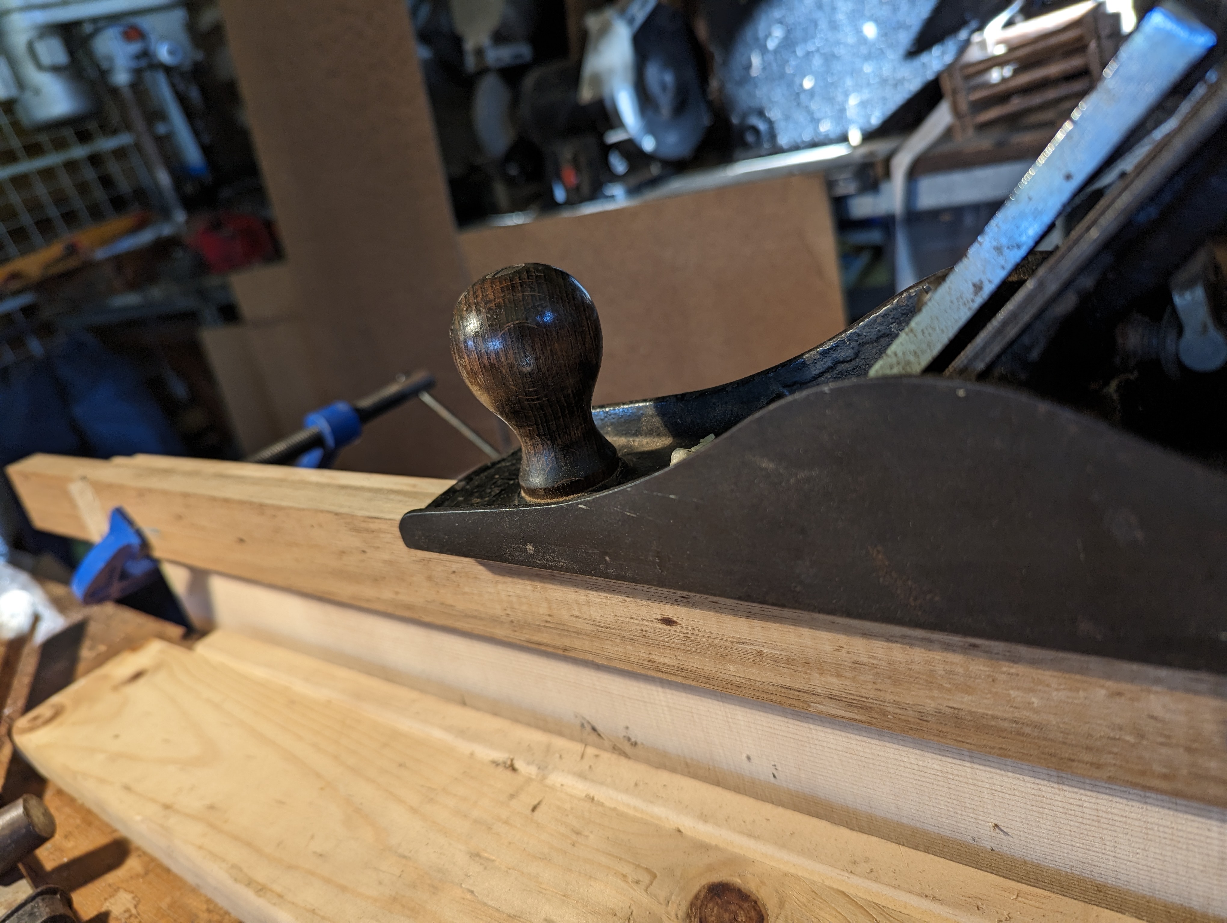

Really helpful, thanks for prompt response. I have a no.6 plane but no shooting board. So I planed a board straight and clamped the two pieces flush and put it in vice. The spruce pieces are on the other side in the pic facing up.
Actually I was on the right track and closer than in his video. But his approach to fine adjustments is better than mine. I may also get a carpenter's level with sandpaper set up since I'll have to do the back also. I'll take a piece of card and sharp pencil into the store, rule lines and reverse to make sure I get one with a true edge."But my body was like a harp and her words and gestures were like fingers running upon the wires." James Joyce

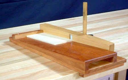

This is probably one of the best designs for a soundboard shooting jig. Available from Micheal OConnors website...Ive got a few of his tools in my workshop.
https://www.michealconnorwoodwork.com.au/page19/
