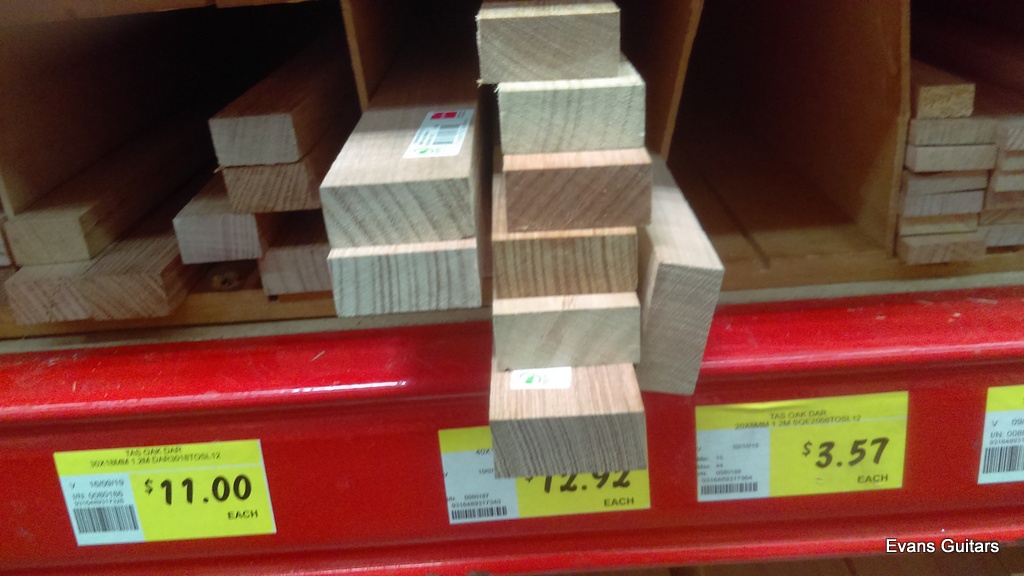

Hi, Tassie Oak from Bunnings, this is what I am looking for, cut on the quarter, and buy it when I see it. It worked well for the cigar box-style guitars I was building at that time, with no truss rod either.
This was a fun build some time ago, all pine, neck as well, still good after a year or so.
Cheers Taff
Cheers Taff
Thank you for that Taffy. The pine electric looks great. I'll definitely give the Tassie oak a go. If I can't find any I'm sure my parents won't miss their Tassie oak kitchen bench top :lol:
