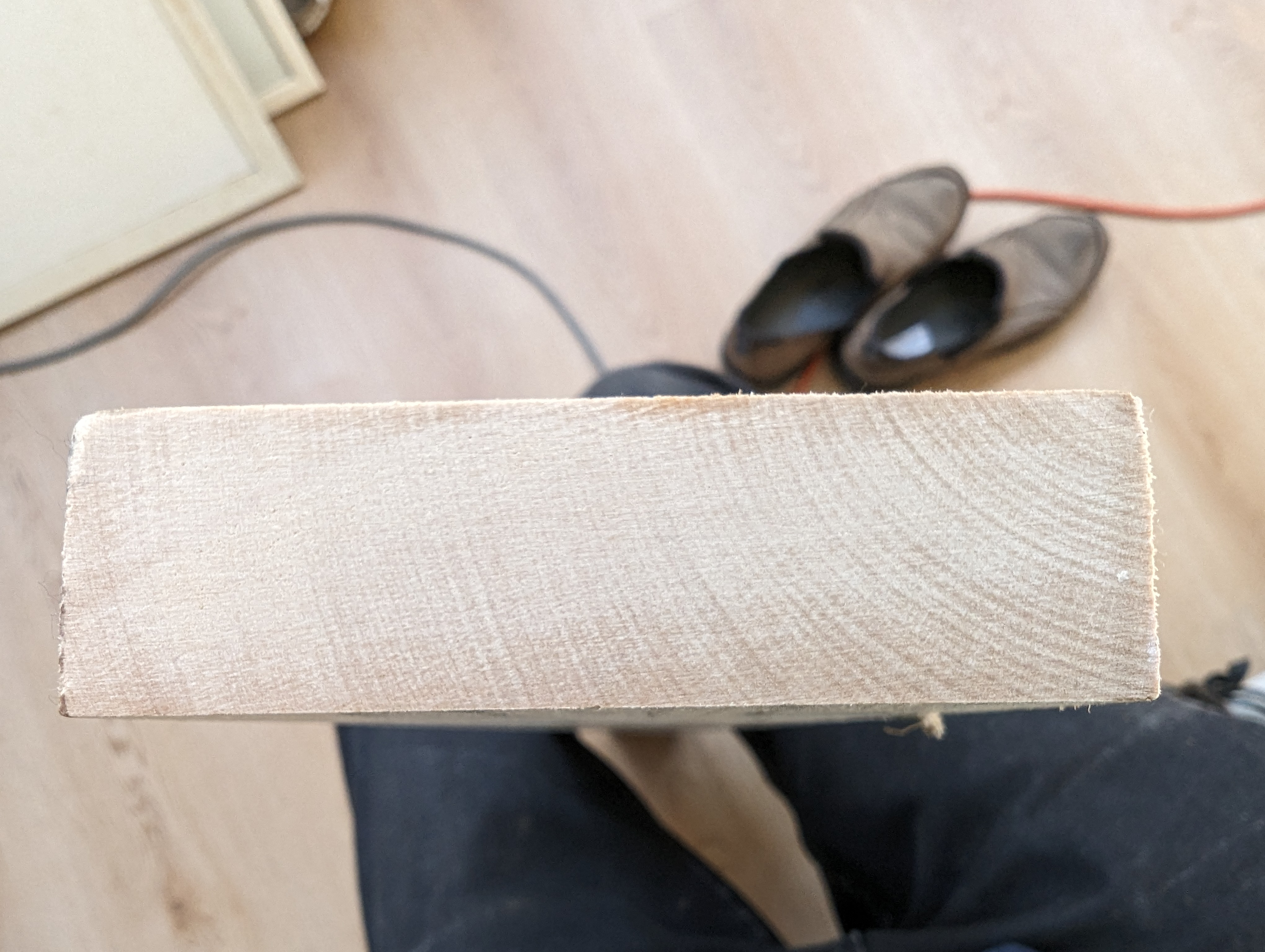

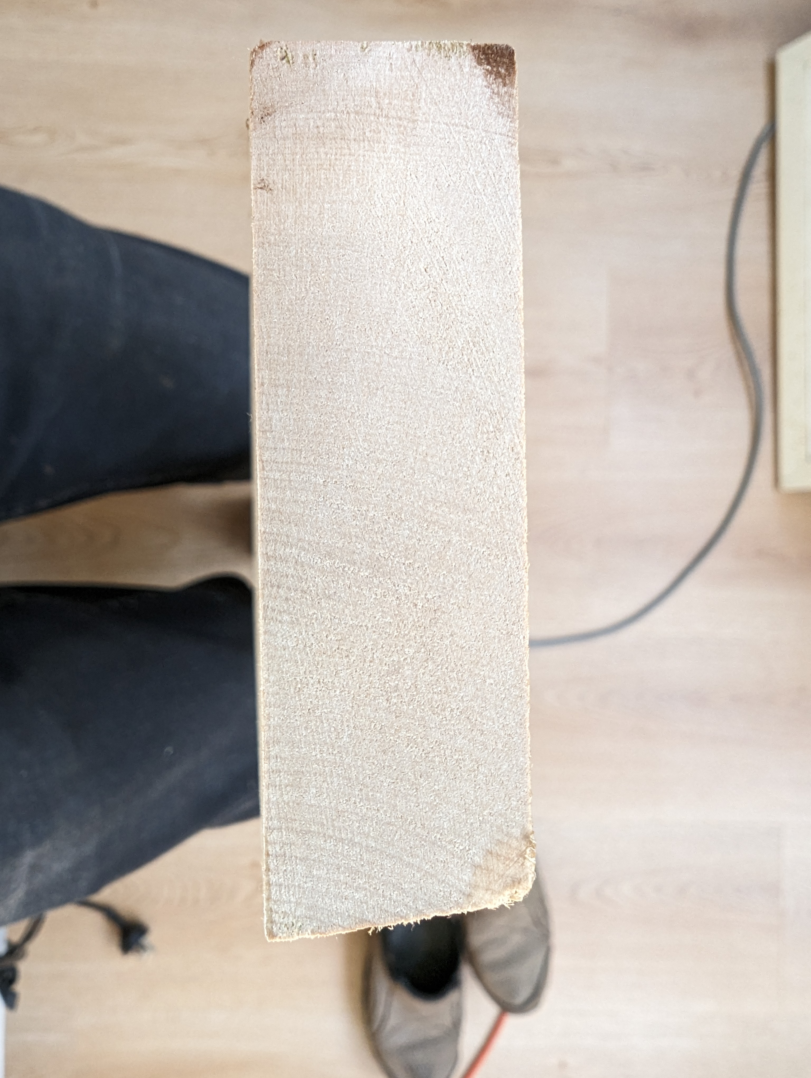

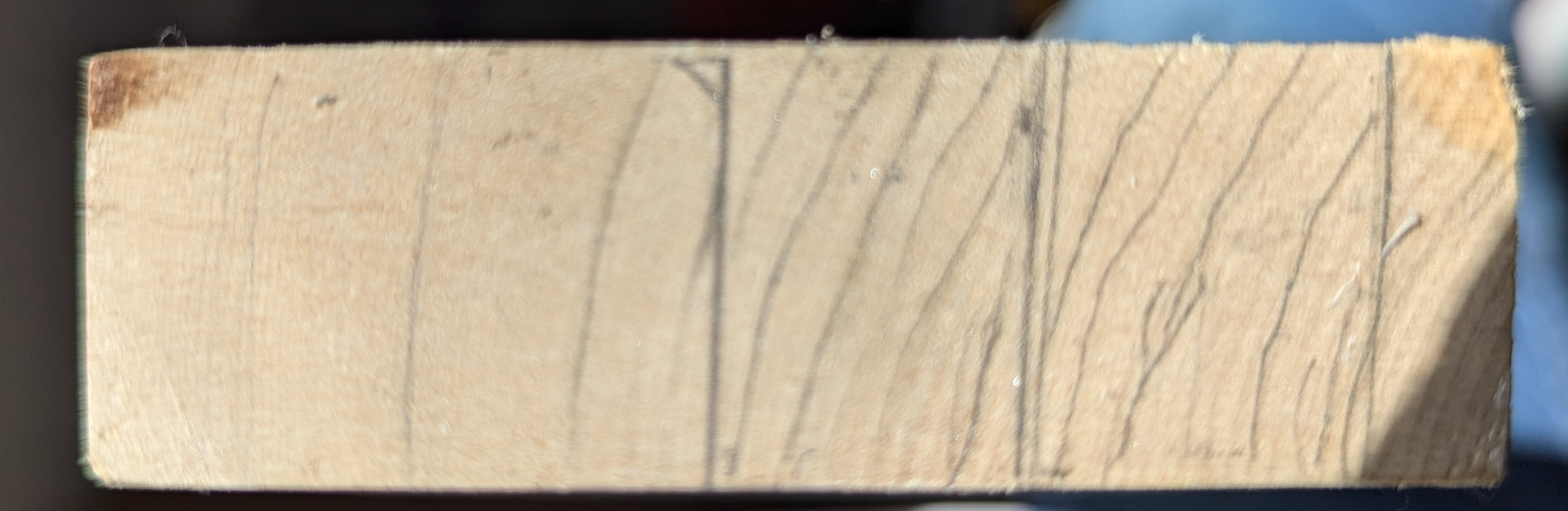

I've attached pics of the two ends of the piece of sassafras. It's 765x75x22mm. Neck piece effectively quarter sawn 40mm then on one side gradually curves a little and the increases by the other end of the board (the horizontal pic).
Does this risk twisting? Truss rod is more for correcting bow is my understanding. I'm not sure how I could cut this piece to laminate anyway.
Also, which side face up to fretboard? I'm assuming side with less curve so I'm removing that timber.

I've used sass for one neck but wouldn't use it again, it's prone to movement. I use CF in all my necks and I'd highly recommend that, it's easy enough to install. Maybe get some QLD maple, NGRW or mahogany for the neck I think they would be a better choice. Wayne

Thanks Wayne, that's quite definitive. Especially with a 12-string with its extra load.

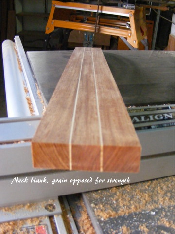

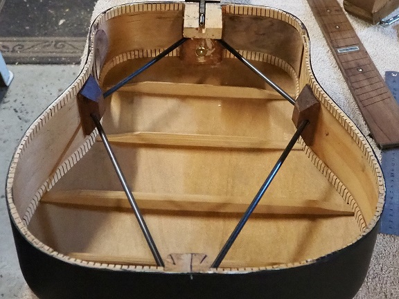

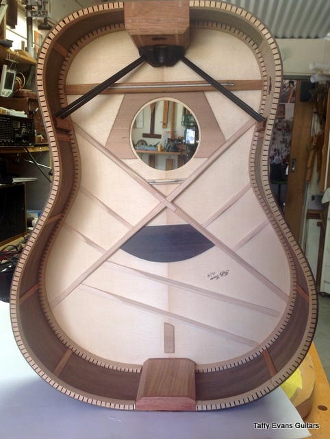

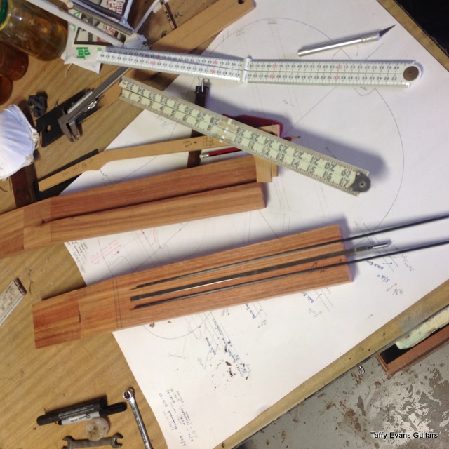

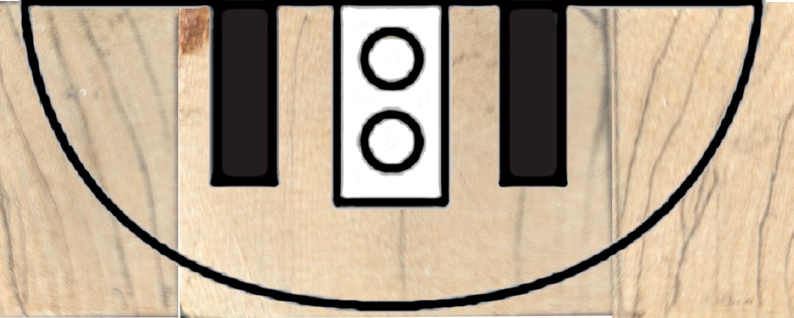

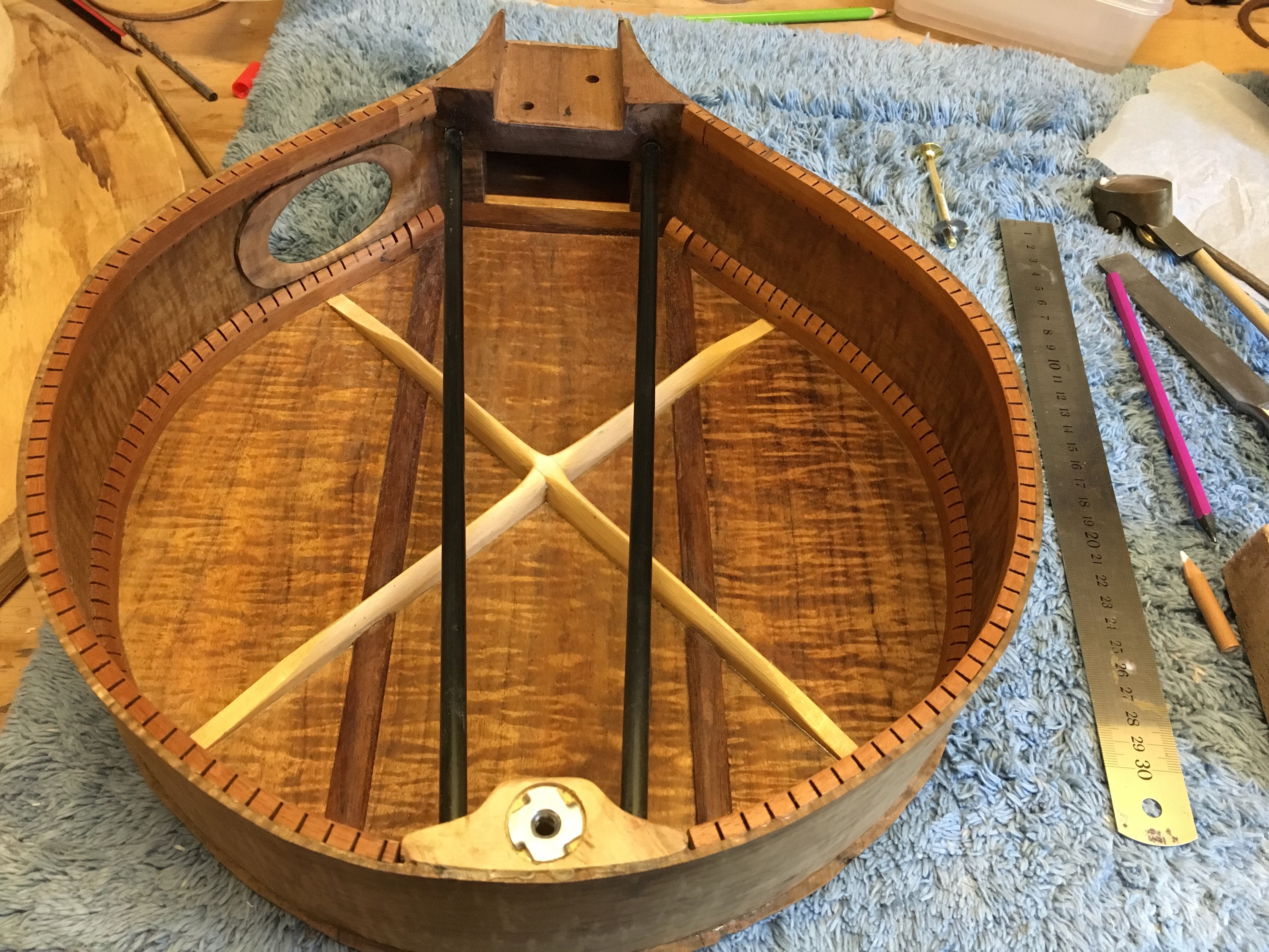

Hi, I have included a few photos that may give food for thought, they have worked well for me.
Neck grain orientation when not on the true quarter sawn. Three pieces with laminations.
Neck reinforcement using adjustable rod and carbon Fiber.
And carbon fiber reinforcement at the neck block to stop the neck from collapsing into the body, as some twelve-string guitars can often do over time. My experience of bridges using one pinhole per pair of strings. I have changed the bridge for a guy who built a twelve-stringer using this method. Due to the closeness of the strings behind the saddle he had to slot the saddle under the strings to keep them apart. Due to his bridge design, the pin holes were too close to the saddle, so there was very little, and a very tight break angle over the saddle. This put extra tension on the bridge, and it cracked.
The idea may be satisfactory with a suitably designed bridge. I replaced the original bridge with one the same but with 12 holes.
Cheers Taff.
Cheers Taff.

Great photos Taffy.

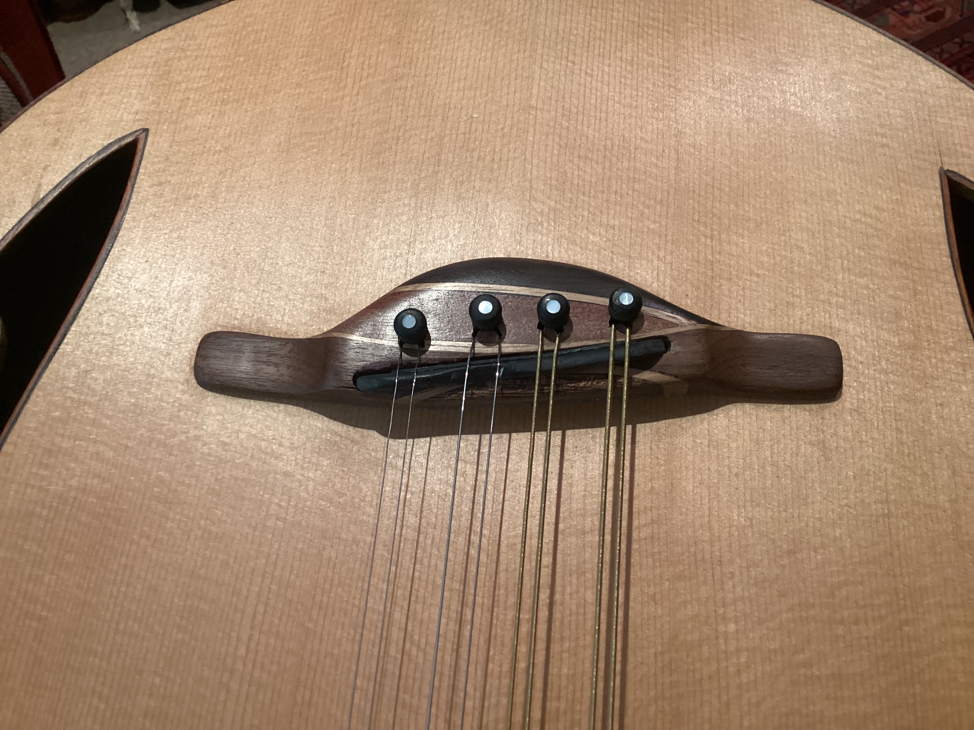

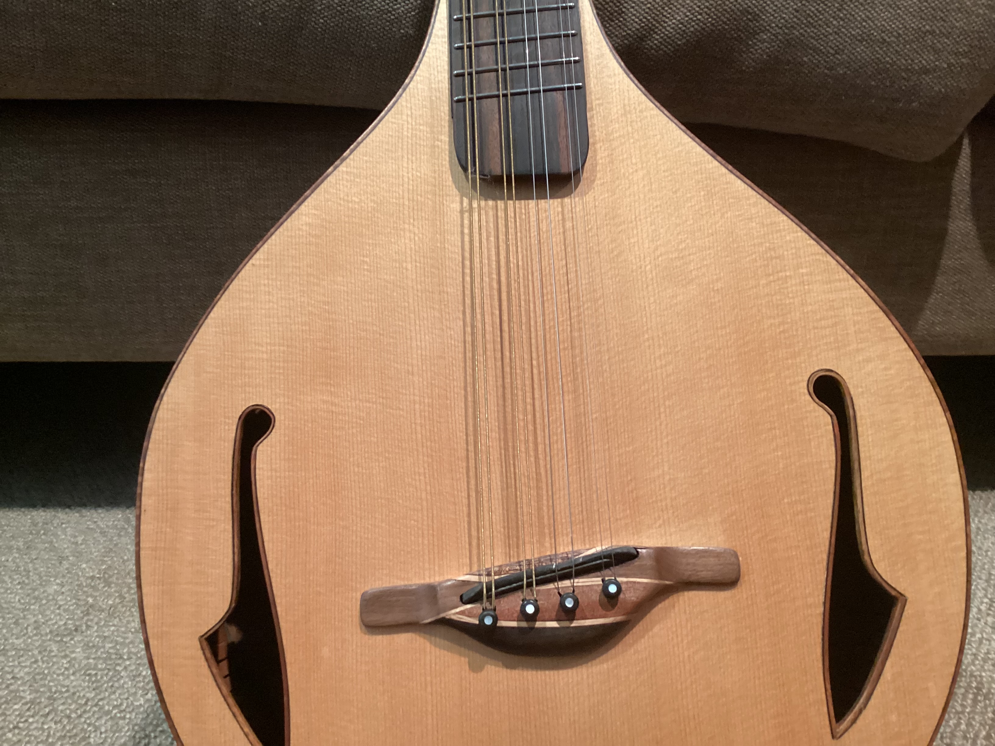

I am a fan of neck block reinforcement too. Regarding 2 strings in one pin. You are right, it makes it necessary to cut two slots from the pinhole to direct the strings in parallel paths to the saddle. They don’t need to be very big slots, but you need the pins to be far enough back from the saddle to have a decent break angle. That must have been a really narrow bridge if the pins were crammed up so close to the saddle slot?
Here is the bridge on that mandolin/bouzouki shaped instrument in my other photo. 8 strings in 4 pins. Disregard the odd looking shape and angle of the bridge as it is a multi scale thing (also an experiment with decorative laminating of multiple timbers in the bridge, which is something I probably won’t do again).

3. Neck laminations - I'm going for 3 laminations as per photo. Is it ok to have a larger (30mm straight grain) centre lamination - with smaller side laminations? This way the curved grain on outer laminations matches better.
4. Truss rod - 2-way adj. truss rod. Anything to beware of? Are they much of a muchness?
5. Carbon fibre:
- What are recommended dimensions for 12 string?
- How much gap between truss rods and carbon fibre?
- Sources for purchase and reasonable price? Are the cheaper ones as good?
6. Tuners - Martin recommended Schaller M6 mini tuners: Seems like c.$500 for 12! What's a reasonable price? Where from? Are there cheaper-but-quality alternatives?
7. Scarf joint => degrees angle of headstock/joint => String break angle. My reading is that the string break angle helps define the headstock angle, and this will depend on tuners. I expect I'll need to draw tuner height onto plans to calculate. I'll go for minimum angle to get optimal string break range.
- What's recommended string break angle range?
- Scarf joint - I'm thinking of using the one that joins under the fretboard for more glue area.

Hi Brett
Here are my thoughts on your questions – but others might disagree.
1. Neck width at the body join (I am presuming 14th fret?). This depends on what string spacing you are planning at the bridge. The plan that you have is quite different from the Yamaha that you are using for comparison, and I suspect this is because they have different spacing at the bridge. A good rule of thumb is that the neck width at the 12th fret should be the equivalent of the distance between the outer-most strings at the bridge. This ensures that the path of the strings is the right distance from the edges of the fingerboard for the whole length of the neck. You can get away with being a touch narrower at the body joint – but not much.
For nut width - many commercial brands of 12-strings use 1 7/8 inch (47.6 mm) at the nut (e.g. Taylor, Martin), some Guilds were a little narrower at 1 13/16 inch (46 mm), some Gibsons as wide as 2 inch (50.8 mm).
String spacing at the bridge is a bit more variable. 2 and 5/16 inch (58.7) is typical, with examples from 2 and 7/16 inch (61.9 mm) to 2 and 3/32 inch (53.2 mm). You should choose the nut width and the bridge spacing first, then set the neck width at the 12th fret in accordance with the bridge spacing. As an example, the current Martin 12-string specs are 1 and 7/8 inch at the nut, 2 and 5/16 inch at the bridge, and 2 and ¼ neck width at the 12th fret (a touch narrower than the bridge spacing number). Something like that will float your boat.
2. Bridge size. I would make it about the same size as a standard 6-string bridge and use 6 holes, 2 strings in each. If you are going to have 12 holes you obviously need a wider bridge for the second row of holes and pins. In the problem example that Taffy mentioned it sounds like the issue was not the choice of two strings per hole – it was the placement of the holes too close behind the saddle. Use something that would be conventional for a modern 6-string (Taylor, Martin, Maton) and you will be fine.
3. Neck laminations. You can have wider in the middle, or outside, whatever number you like. No problem. It is your adventure.
4 & 5. One truss rod – brand agnostic, and two CF rods sounds good. I buy CF here:
http://www.carbonfiber.com.au/index.htm
6. Tuners. The Schaller M6 minis are good. Another way to reduce weight is open gear tuners. It will depend on the look that you prefer. The Golden Era open tuners from StewMac are good value for money if old-style aesthetic is OK. I would not consider a slotted headstock. Although it can look cool and others have obviously pulled it off successfully - it is very crowded, structurally weaker, and a PITA to string it up.
7. Scarf joint. 12 to 15 degrees is standard. I aim for 12. Placing the joint under the neck is more visible. Placing it on the headstock looks better but is weaker, but I put a face plate on the front of the headstock and a backstrap on the back with some CF under both and I think that is plenty strong enough, even for a 12-string.
