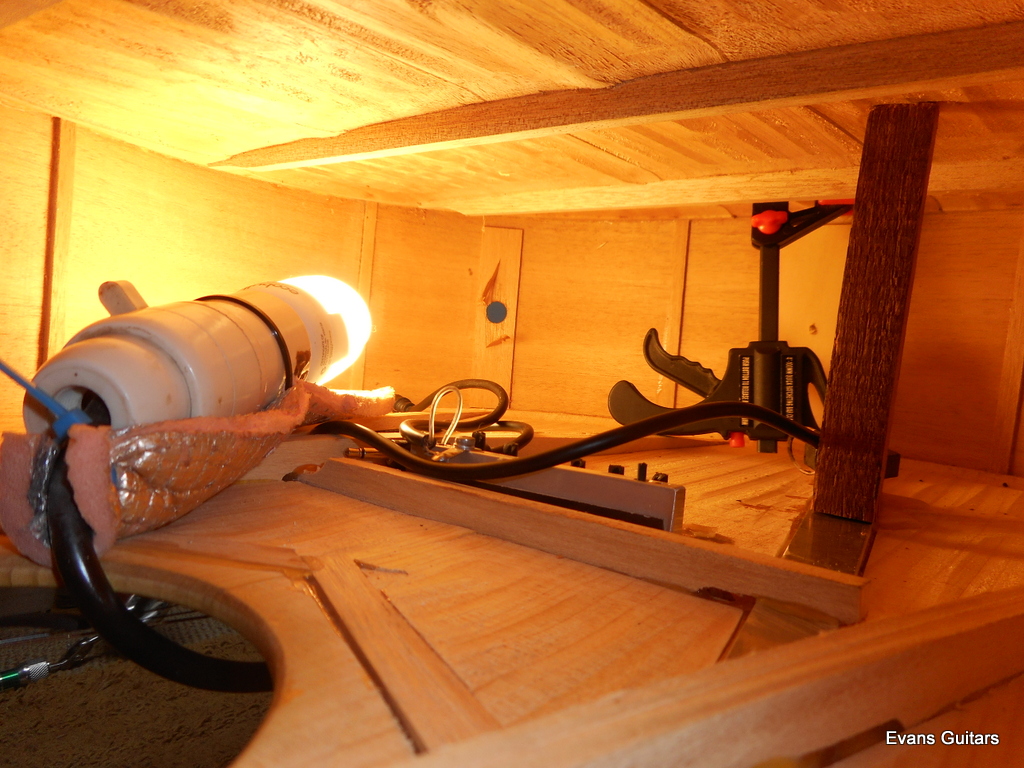

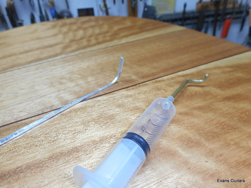

Hi again, I found a heap of photos but no info on the glue. But looking at the applicator I made up I think it was Titebond. It worked ok anyway. The problem was up near the tailblock.

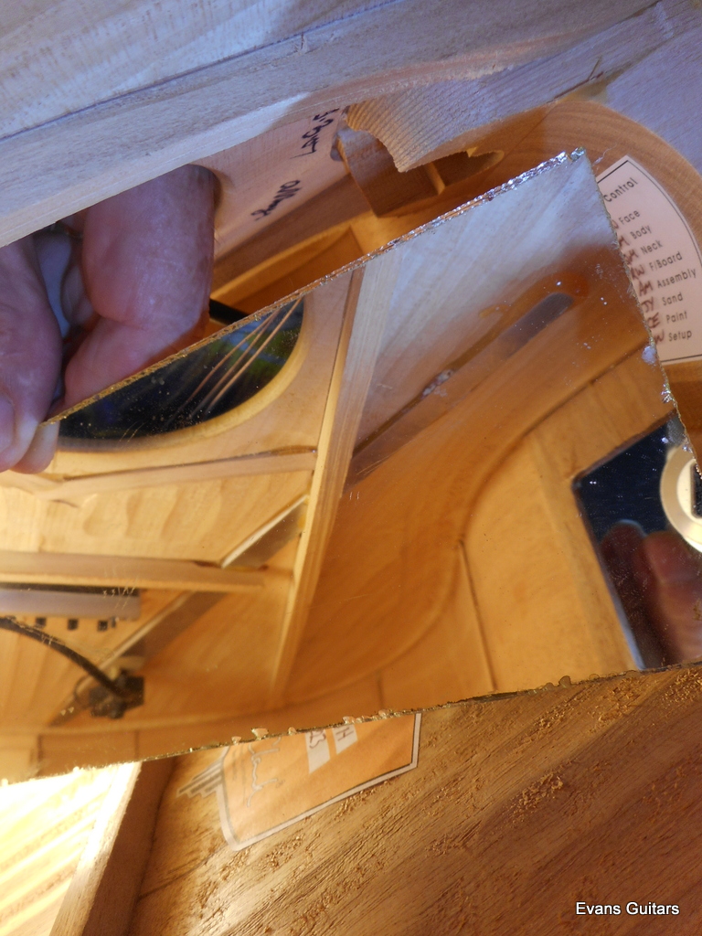

Hi, I should have explained, the strip in this case was firmly glued, I just filled a void between strip and the inside of the top that caused the buzzing with glue. Must have been three years ago now. The original epoxy type glue was still holding the strip.

Hi, at the time I remember I did consider making a couple of spruce saddles to span the strip and tightly glue them to the top. Similar to the checked-out braces in the photos, but I did not have to.

Is it just me or do the braces on that Cole Clark look pretty rough. Looks like they've come straight off a band saw and been plonked on to the top.

Hi Martin, I think you are dead right there. I have done many repairs on Cole Clark guitars and I have photos as you see here of them all. Really bad work and I think at times design flaws that should have been thought through better. As a repairer, I repair but also remedy the problem, which at times means improving bracing.
I often think about how much longer would it take to do a proper clean job. Although they have the same top and bridge issues as Maton, Maton's work is far cleaner.
