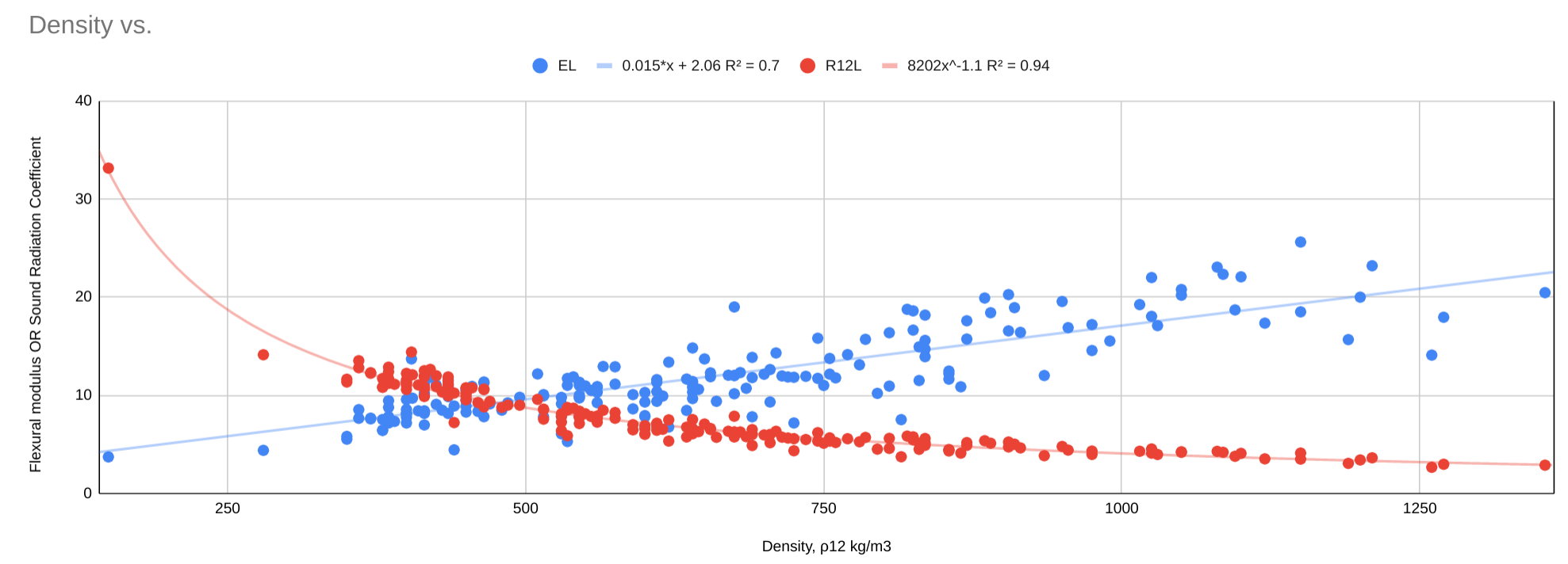

Re: Qualities of Spruce
I don't have data on the spread within a species, or even within Spruces, but I used the averages from wood-database.com to chart about 200 species, both softwood and hardwood. And there is a pretty good fit to a trendline relating density and stiffness. And an even better fit relating density and the sound radiation coefficient, R = SQRT(E/ρ^3), where E is the stiffness (flexural modulus) and ρ is the density.
These species go from Balsa at 150 kg/m^3 to Black Ironwood at 1355. E is in GPa.
E = 0.015 * ρ + 2.06, with a fit (R^2) of 0.70.
R = 8202 * ρ^-1.1, with a fit of 0.94.
It's interesting how tightly clustered the R values are on the red line. R is very predictable from density.
