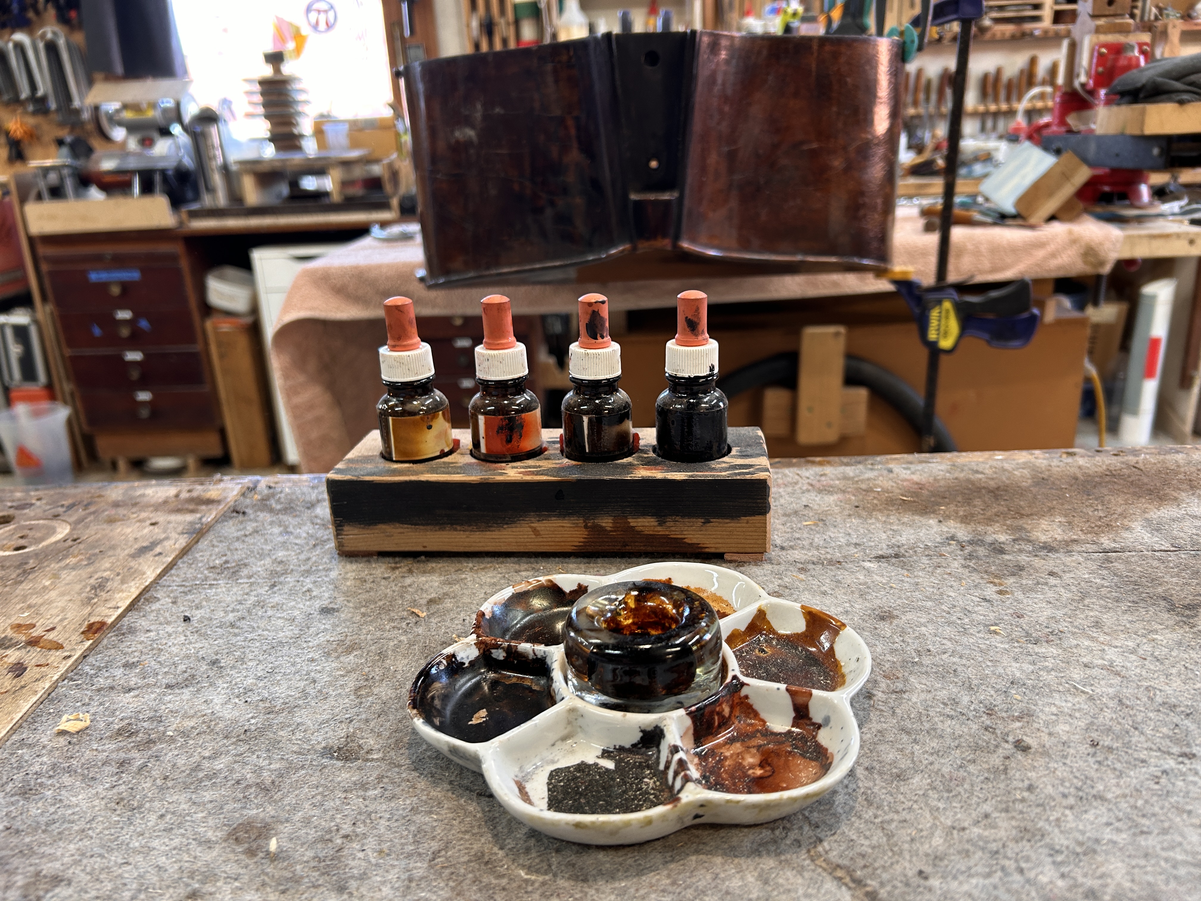

Post by matthew » Sat Apr 27, 2024 3:27 pm
this is an old thread by now and you've probably solved your Amber problem but looking at the recipe you've described I would just be adding a touch of black.
each time you add brown to a mix to make it darker you're actually adding a bit of red, so it's very easy to go too red with a mix that's got red in it already. Black usually has a bit of blue in it which takes off the red and makes it darker.
i do a lot of colour matching and touch up with spirit stains. I can get 99% of the shades I want with these four tints.
