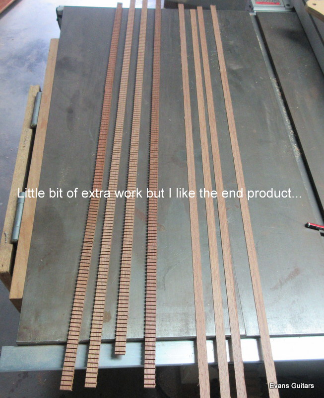

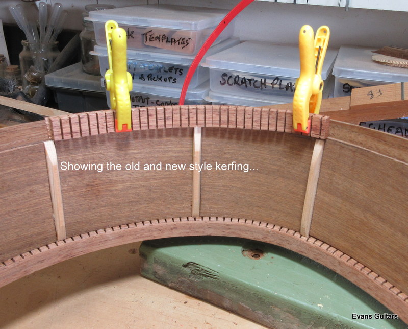

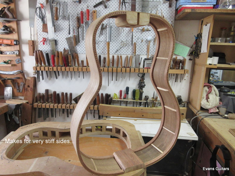

Hi, I'm not sure of the acoustical properties of Merbu, but that is what I am using, I am just trying it out on my latest build. I'm also using a modified kerfing as seen in the photos. I was using reversed kerfing but with the timber I was using every so often showed the saw cuts through the kerfing.
