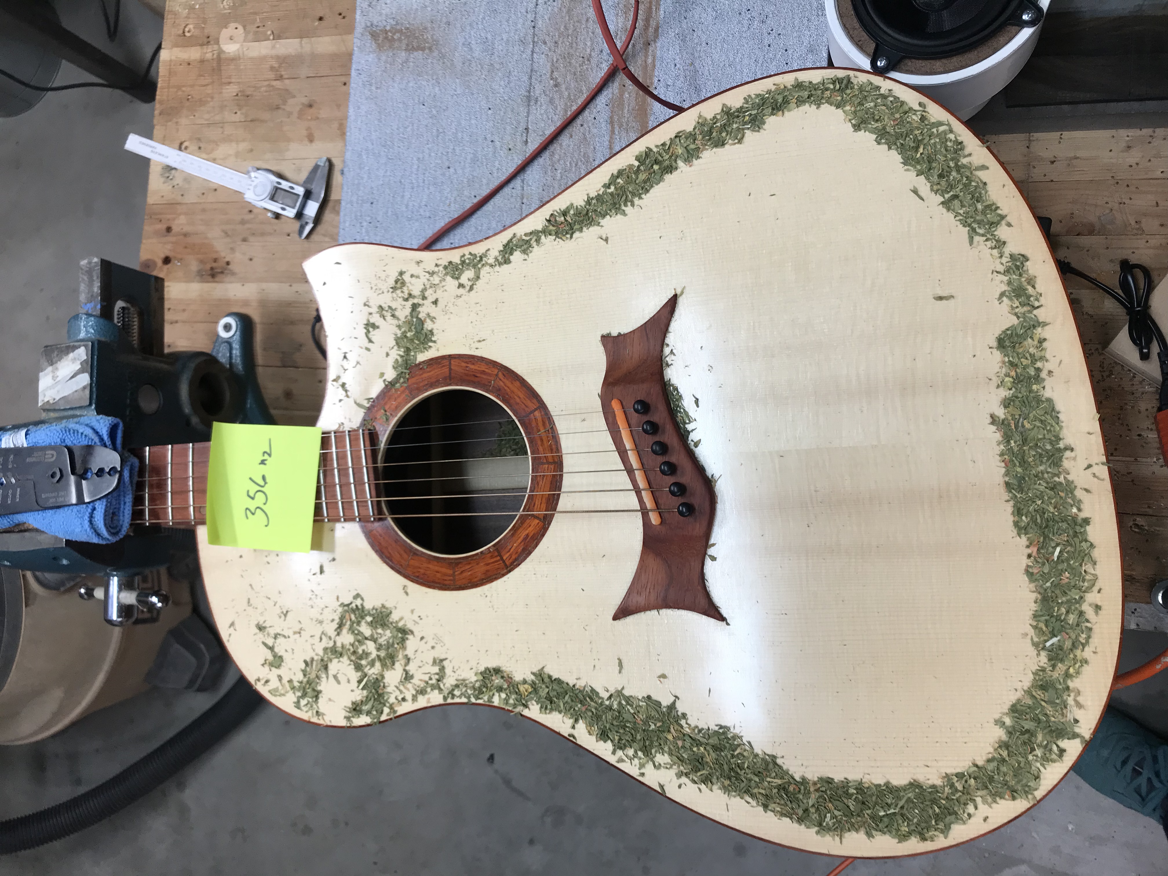

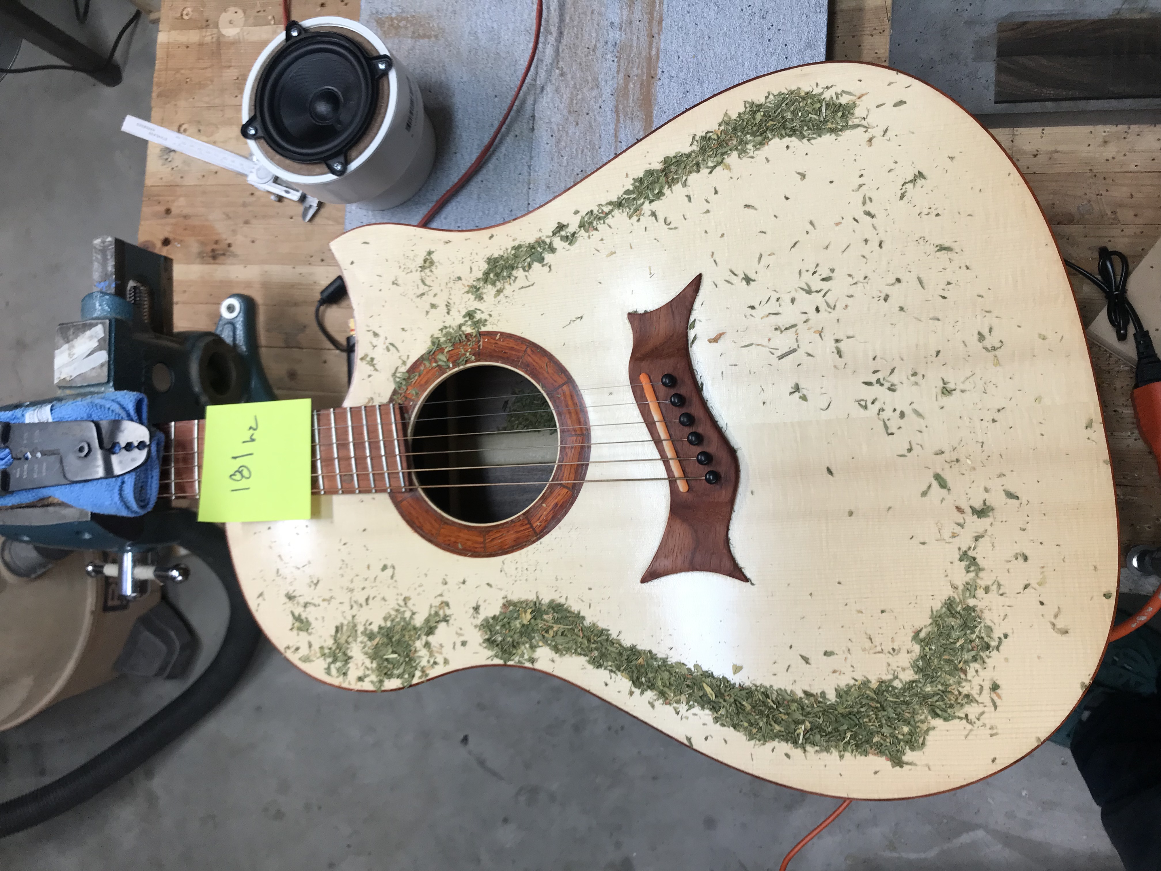

I just got my speaker and amp set up to make Chladni patterns on my prototype Dreadnought
It’s strung up with a towel dampening the strings,, neck in vise and a triangle block with cork on top supporting the guitar below tail block.
Am I going to have null results like this?
After rolling from 20hz to 500ish, (had to stop due to family not happy about it) I wasn’t seeing all the higher frequency shapes,
These are all I got
I need more time vibrating concrete floor, walls my body, etc

Generally, you have to excite where you expect an antinode to be, which helps reduce the power requirement. Google up some pictures of Chladni patterns and that will give you an idea of where those are. There are pics in the book, too, of course.
The monopole at at 356 Hz is unusual. I suspect you are driving the air resonance at ~89 Hz with a signal two octaves higher in pitch.
The neck can be involved in some modes, so its best to have it free. Just support the body on a few (3) foam cones.

I’ll have to run it with out strings,, the reason it was set up like this is the neck is permanently connected.
I figured if the neck wasn’t clamped it would vibrate too.
Thank you.
The neck is permanently connected. It’s like a modern Spanish heel connection I’ve been doing to complicate my life more!
Will test without strings,
Yes sir, I had speaker over nodes snd etc, but I believe the strings like Martin mentioned are stopping the higher modes,
The t(1,1)1 is 97.7 but the G isn’t really wolfing
The t(1,1)2 is 180 , I believe your correct about the 359-360 octave drive
I just need more time to run the speaker, it’s vibrating my body and the house, wife shut it down

Did some stuff today,
First thing was check bridge rotation, got 1.3 degrees,
Then put 10grams of post adhesive on second from tail back brace, which brought top down from 180 to 174, the back went from 223-224 down to 209.
Took it off, I’m chasing the air T(1,1)1 to change it
Slotted the bridge pins and that changed my monopole from 180 to 178.18
Bound the sound hole with 1.26 thick mahogany I originally was going to bind it with, so it was 98mm and now 95.5ish, the Air went from 98 to 96.8,
There has been 128 grams and 138 gram steel weights bolted inside through these tests, they didn’t effect the air and only shifted the Top and back not an entire hz, which I was thinking it’s not enough, also maybe the structured sides being off more mass than usual would require more weight to effect the top, idk, but it’s a blast working through the steps trying to shift frequencies around.
All and all it’s pretty much fine except a pumping, it happens when I play it like I normally do which is bass player problems, if I just ease off and focus on playing it gently it is clear.
Going to put 3 grams and then a six gram ball of poster adhesive on the brace and see what weight brings the back and top dead on three semi tones apart, I believe maybe the back and top need to be in sync more, as my back is the thickness of a live back but braced like a Dreadnought , like you do for non active backs
