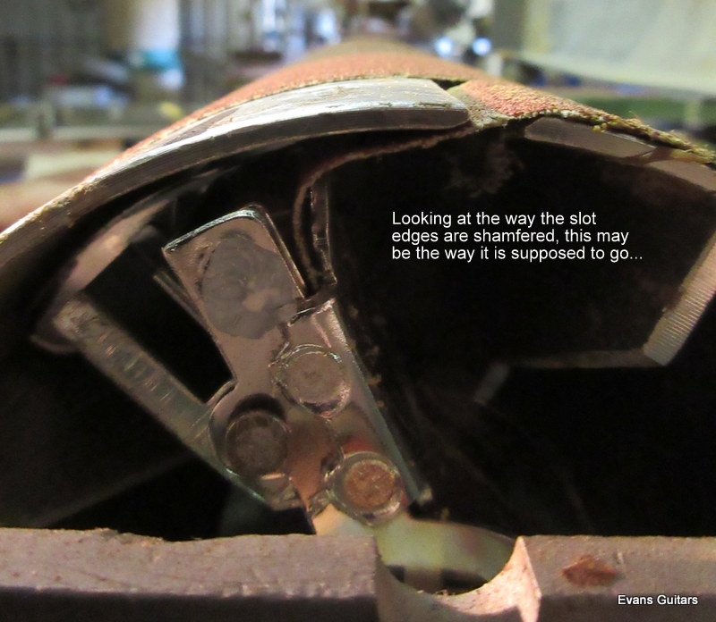

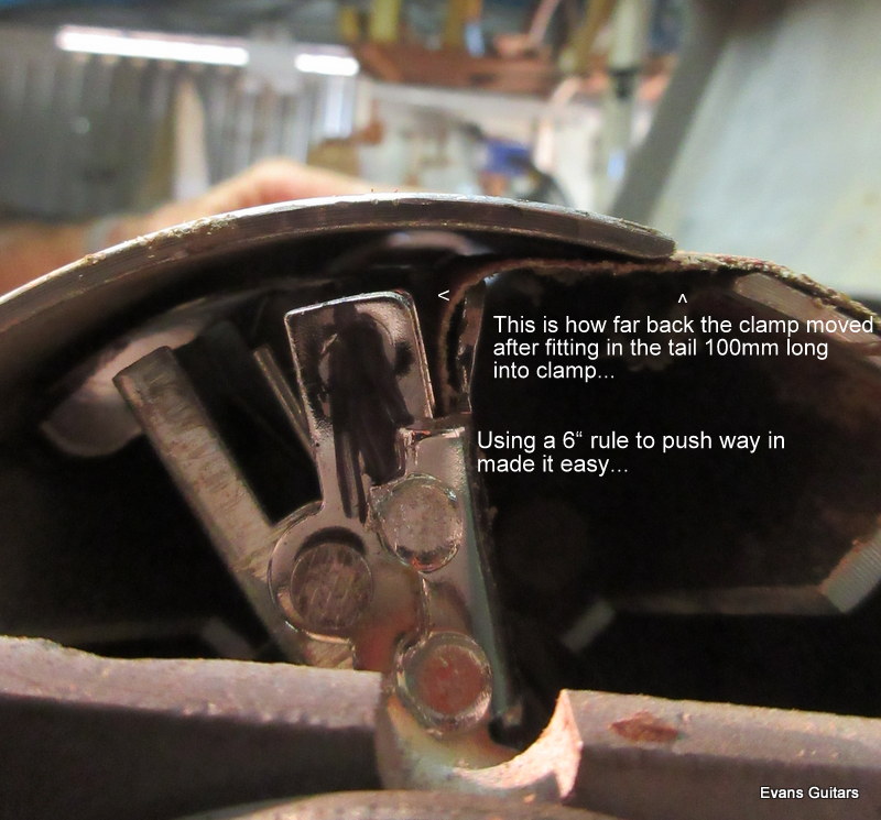

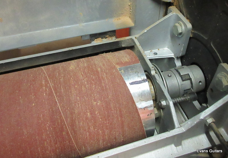

Hi, Frank, your earlier comments are spot on and are in line with my findings and experience.
So today I fitted a new/used paper. I moved the clamping assembly so that the opening sat under the slot, using the aforementioned long screwdriver. Whilst keeping pressure I pushed approximately 100 mm of sandpaper tail down using a steel rule. Then let go of the pressure which allowed the clamping assembly to get pulled back away from the slot. It looked like it was applying more tension.

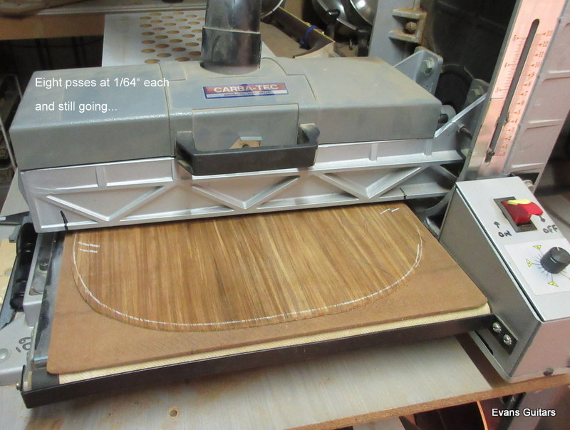

I then passed a New Guinee Rosewood back through for 10 passes at my usual 1/64" a pass, and dare I say it... it's still working.
I stuck my camera in to get a better view,
Thanks all for your help.

The outboard spring clamp is a simple lock to start your wrapping process. The inboard clamp mechanism is both a clamp and tensioning device. Your first depress of the spring is simply the clamp opening, but as you suggested, this does not appear through the slot in the drum. Holding this spring in and pushing further, you activate and rotate against the second higher tension spring, which then brings the open clamp into alignment with the slot. Feed the final end of the paper through here. The purpose of this two-part mechanism is to first clamp the end of the paper, as per the outer clamp, but then when released, the spring returns it to the original position, pulling the drum wrap tight. This should prevent the paper from sliding around on the drum. This is a deliberate design found on many drum sanders and is necessary to keep the paper under tension in use.
With respect to the minimum depth, this too is by design. Although the precise depth varies from brand to brand and model to model, the limitation is in place to prevent you from lowering your drum into your feed belt and destroying that, or worse, the bed underneath. Remember, sanding to such specific thickness (or is that thinness?) the likes of which we work in, is quite a specific task. These machines were not designed for luthiers as such, they are just very useful for that purpose! A sled is always recommended and in fact required, for our work on a wide drum sander.
Finally, yes. The drums are not always level or moreover, move over time and require adjustment/setup. This comes as a result of having such a large/long heavy rotating drum, hanging from a single end, then put under heavy load. Over time, it will move. Some machines the only fix for this is shims, which are usually included with the machine from the outset. Other models have various height/levelling adjustments for the bed - some easier to use than others. This is part of the setup/maintenance of these machines and will require adjustment from time to time. However, there is another work around...
Get a piece of quality plywood to use as your sled - the thicker it is, the more stable and likely to stay flat. Cut this down to the width of your drum sander's capacity and a little longer (say 50mm) than your largest back or side requirements (build two different sizes if your prefer). On one face, mark it with pencil from edge to edge. Feed this into the sander removing very small amounts per pass. When you have a full clean face, you now have both a (nearly complete) sled to use for your guitar requirements, but also one that matches the slight inaccuracy between your drum and bed - therefore giving your stock an even flat cut. Of course, you may need to resurface this from time to time through use, with additional movement of the bed or drum.
