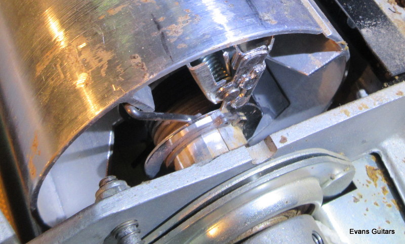

Hi, sorry to resurrect this old post, but in my searches for a solution I keep landing here. Over the years I have been gluing the righthand side of the paper to the drum of my Carbatec sander as I could never find the clamping mechanism. Not good but it seemed to work. As I wanted to start using a different grade of sandpaper often this was not a good idea anymore.
I finally decided to fix the problem. The problem is I can't see any clamping method, or rather I can see the mechanism on the right side of the drum but can't get it to work I would have thought that when I move the actuating lever I would have seen a jaw or foot, or something open up to take the end of the paper. Nothing moves other than the lever I'm pushing.
I've included some photos, but I don't know if they will help. Does anybody have any more ideas since I was last here?

Re: Carbatec 400m Drum Sander Problem
Post by kiwigeo » Mon Apr 10, 2023 3:54 pm
Taff if the mechanism is the same as the Performax machines then this might help. There should be a pair of jaws that grip the tail of the sandpaper strip. One jaw becomes a lever that you squeeze in towards the drum to open the jaws.

Hi Taffy
This continued to be a big frustration to me over all these years. Like you , I recently said - stuff this - there must be an explanation.
One of your pics shows a view from the other end of the drum. It helped me discover a small piece of sandpaper that had torn off sometime below the mouth of the clamp. That was my first problem. Got that out.
What I do now.....
The sandpaper tail is about 5cm long. I use a thin 6" ruler to help guide the tail down. The pic shows the ruler at almost 90 deg to the drum and the sandpaper tail is above the ruler. There is a slit down the bottom of that path that the paper must slide through. The ruler can help get it down there. Then when you release the drum from the that holding bolt, the paper tensions just a bit more.
Hope that helps.
Frank
Post by kiwigeo » Mon Apr 10, 2023 6:09 pm
On Performax the outer end of the drum is easily accessible. The inboard side...I can see everything by sighting through the gap between the height adjuster slide and the frame. I usually have 50mm of tail protruding past the outboard clamp but at least 75mm protruding past the inboard clamp. When I cut my 75mm wide belts the tail taper starts around 320mm in from each end of the belt. When Im inserting the tails into the clamps I give the tail a curl in the opposite direction the curve of the belt on the drum which helps it through the jaws.

Post by Taffy Evans » Tue Apr 11, 2023 7:51 am
Hi guys, thanks for the quick replies. Looking at your photos and comment had me losing sleep last night, so up at 5 am and into the workshop.
On checking, I notice that the clamping device on my drum is nowhere near the slot. There is nothing. In the photo, I show the slot, a black marker, which is an original mark I put there when the unit was new [I just marked over it so it shows up, and the white mark showing the actuating lever. It does not look correct to me. What do you think? Thanks for the help.

Post by Taffy Evans » Tue Apr 11, 2023 9:41 am
Ha-ah, :o on looking more closely I figured something had moved. The black mark I remembered was the location of the actuating lever, back in the day. So I tried, with the help of a big screwdriver, to move the locking device and the whole chrome assembly, back to that mark, and it all moved back.
If held in place with the screwdriver the sandpaper end goes in easily, releasing the pressure on the screwdriver and the tension spring brings the whole assembly back out of position.
Post by Pat.Hawkins » Tue Apr 11, 2023 10:49 am
I've always struggled with this.
I found the lever had two tensions and I was only moving it half-way. I found that considerable force was needed to open the jaw all the way. It's quite hard on the finger and sometimes needs several attempts.
Also,
Is that spring loaded bolt protruding from the rhs meant to give your finger a rest and hold the lever open?
If you engage it fully then rotate the drum backwards it "kinda" holds the lever open - is that it's purpose?

Post by Taffy Evans » Wed Apr 12, 2023 3:17 pm
Hi again, well I might be a bit early making any (positive) comments, but, using ideas gained from this thread I did the following.
I put extra force on the clamping lever and, as I said before, moved the whole assembly so it sat directly under the slot in the drum.
I could not see any way the paper could be gripped but pushed it in to the opening and then pushed it down further with a small steel rule, as advised.
I then released holding pressure on the clamping assembly and let the spring pull the whole assembly back…
I pulled really hard on the, unfitted, test piece of belt and could not move it.
I will try a proper set up tomorrow.
