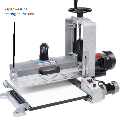

I have a pretty new 400mm Carbatec drum sander - same model I have seen a number of forum members have.
Last weekend, I was sanding 17" joined tops/backs obviously requiring 2 passes for each thickness. I was pretty patient and not biting off too much - no more than quarter turn of adjuster.
The same problem occurred twice, in which paper wore/tore away at the fastening point on the left side. Clearly this is a weak point that is suffering more than other areas of the paper when it first hits the wood and 'settles in'.
Has anyone else experience this? Any ideas? thanks. Frank.

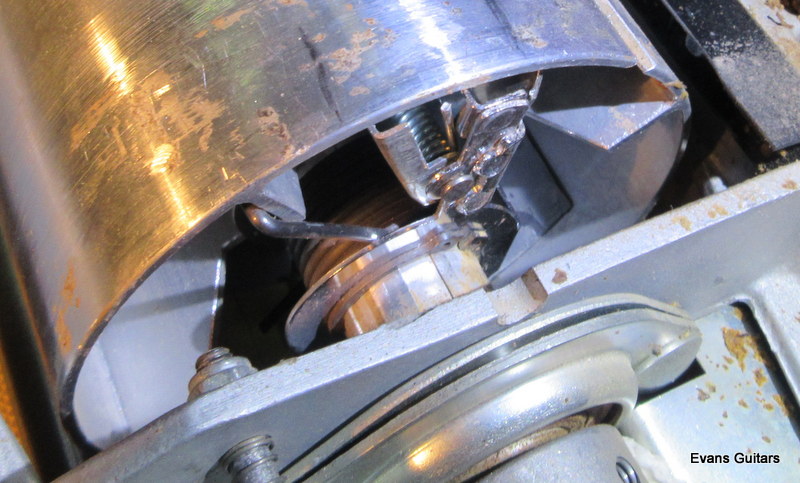

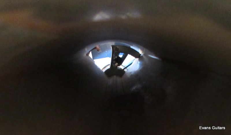

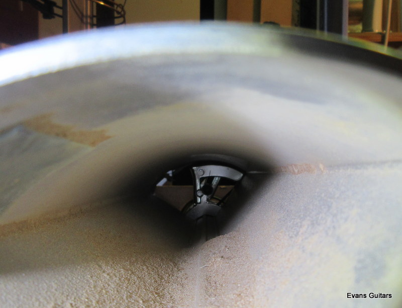

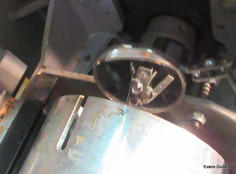

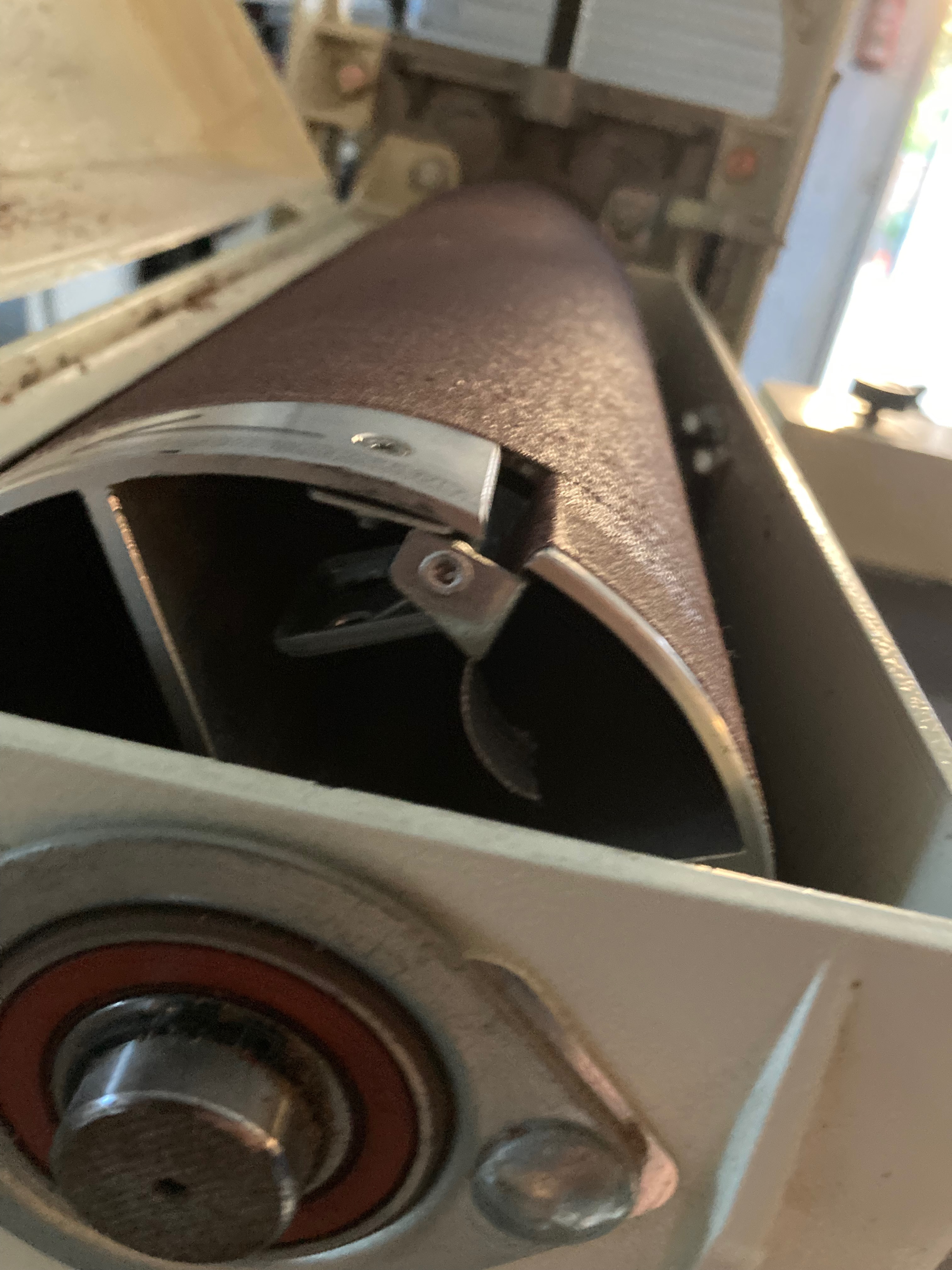

Hi, sorry to resurrect this old post, but in my searches for a solution I keep landing here. Over the years I have been gluing the righthand side of the paper to the drum of my Carbatec sander as I could never find the clamping mechanism. Not good but it seemed to work. As I wanted to start using a different grade of sandpaper often this was not a good idea anymore.
I finally decided to fix the problem. The problem is I can't see any clamping method, or rather I can see the mechanism on the right side of the drum but can't get it to work I would have thought that when I move the actuating lever I would have seen a jaw or foot, or something open up to take the end of the paper. Nothing moves other than the lever I'm pushing.
I've included some photos, but I don't know if they will help. Does anybody have any more ideas since I was last here? Thanks.
Cheers Taff
Cheers Taff

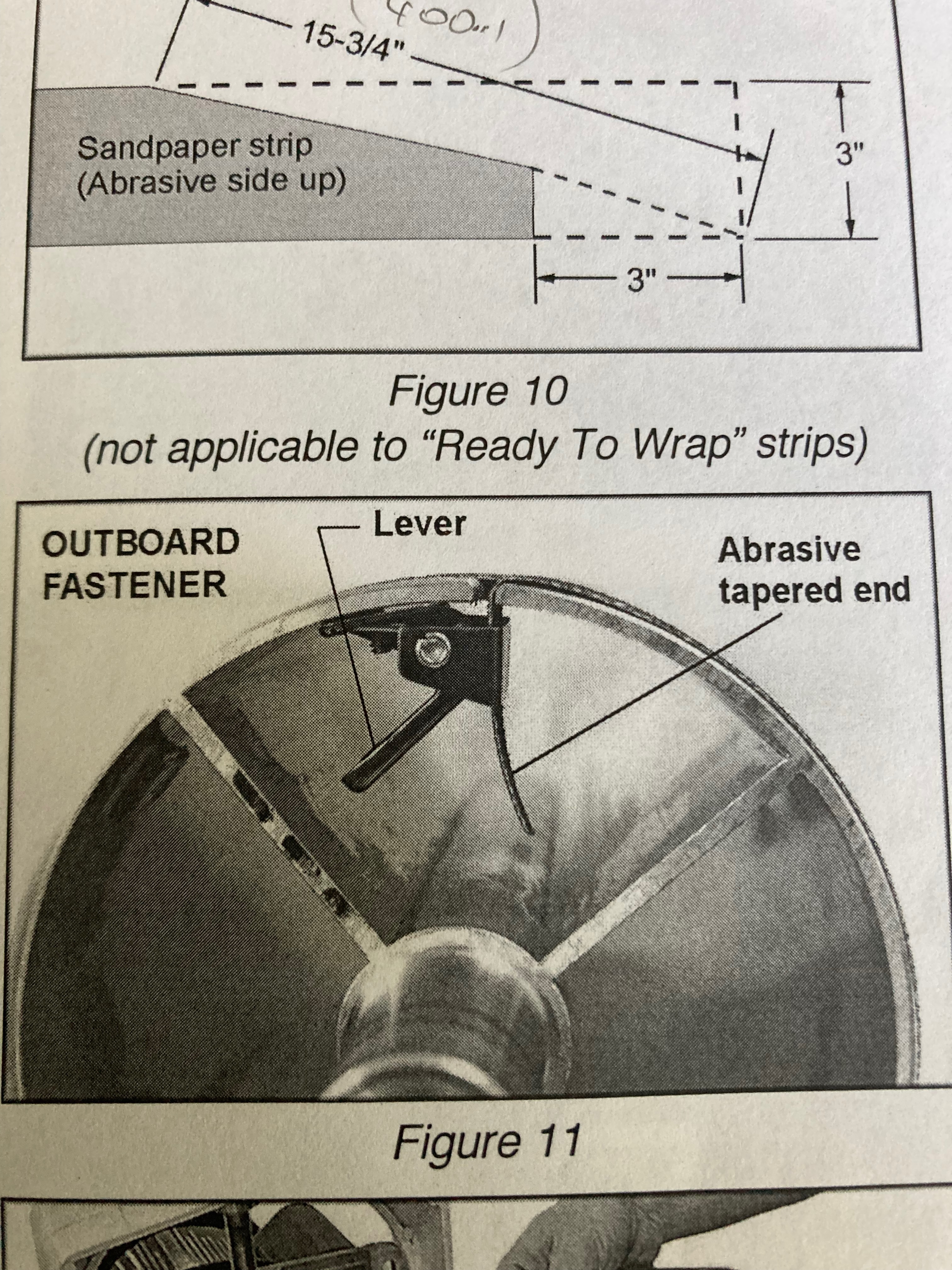

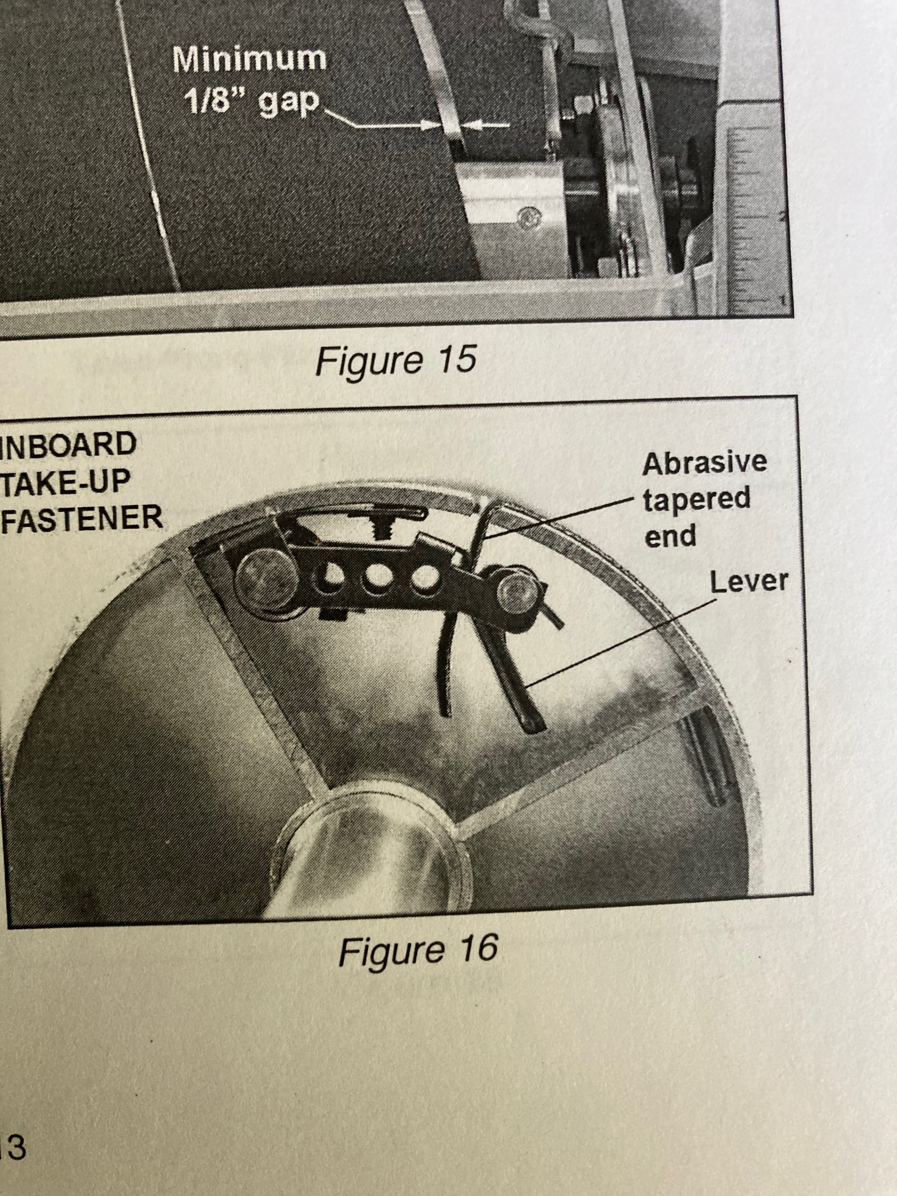

Re: Carbatec 400m Drum Sander Problem
Taff if the mechanism is the same as the Performax machines then this might help. There should be a pair of jaws that grip the tail of the sandpaper strip. One jaw becomes a lever that you squeeze in towards the drum to open the jaws.

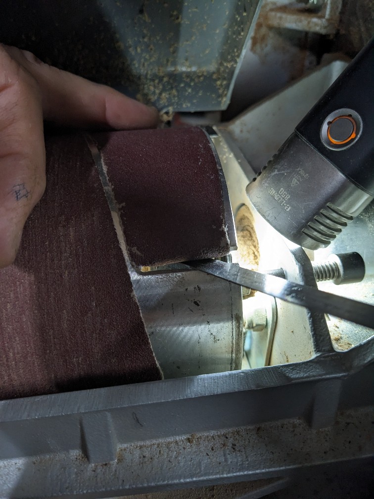

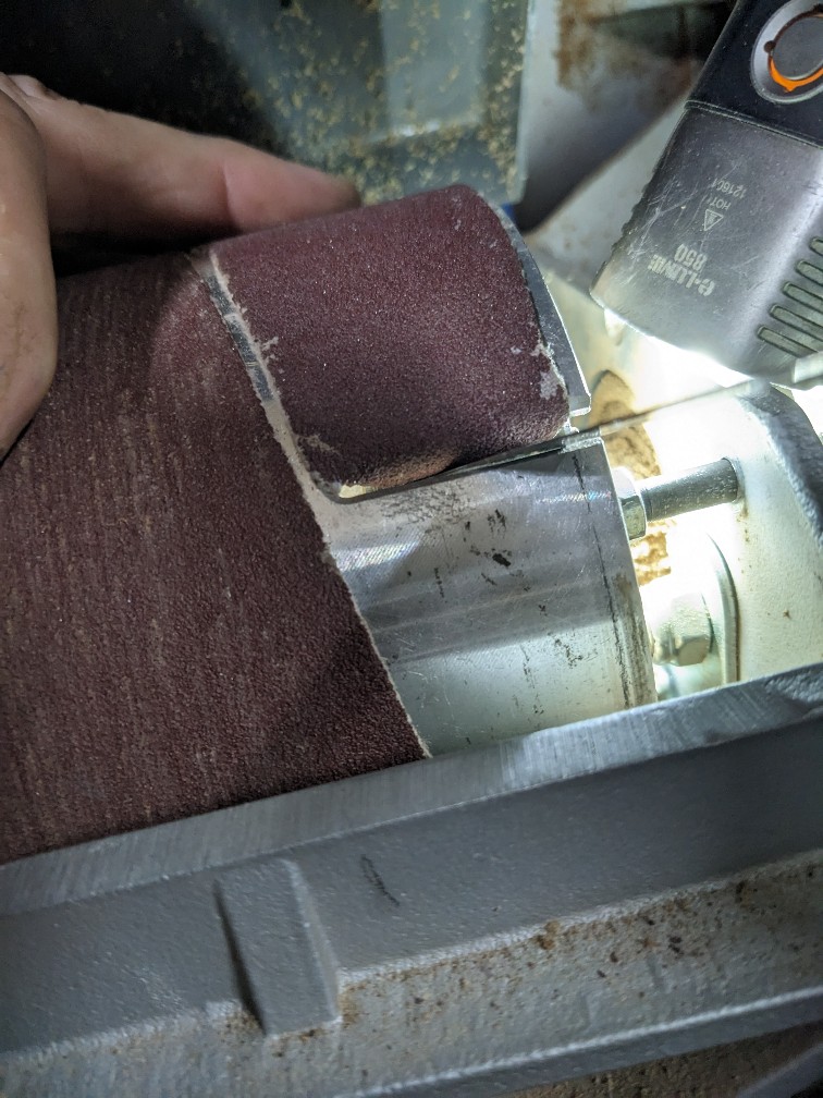

Hi Taffy
This continued to be a big frustration to me over all these years. Like you , I recently said - stuff this - there must be an explanation.
One of your pics shows a view from the other end of the drum. It helped me discover a small piece of sandpaper that had torn off sometime below the mouth of the clamp. That was my first problem. Got that out.
What I do now.....
The sandpaper tail is about 5cm long. I use a thin 6" ruler to help guide the tail down. The pic shows the ruler at almost 90 deg to the drum and the sandpaper tail is above the ruler. There is a slit down the bottom of that path that the paper must slide through. The ruler can help get it down there. Then when you release the drum from the that holding bolt, the paper tensions just a bit more.
Hope that helps.
Frank
What I do now.....
Hope that helps.
Frank
Once I've got the tail through the jaws I grab the end of the tail and give it a pull while releasing the clamp lever. As the jaws close they'll exert a bit of tension on the tail and pull things tight. The Performax comes with a little tool that allows you to hold the jaws open without needing to hold your finger on the lever.

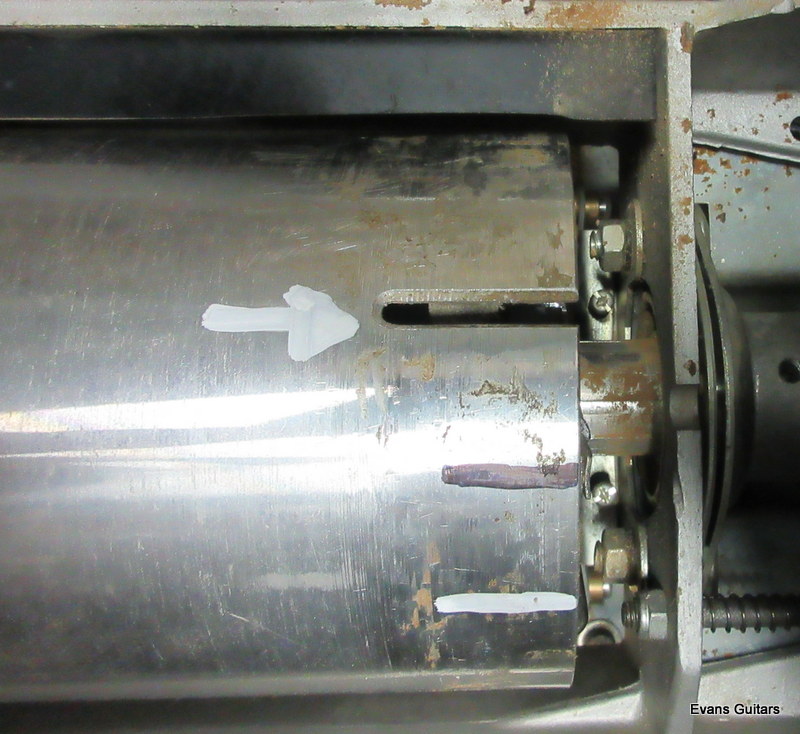

Hi guys, thanks for the quick replies. Looking at your photos and comment had me losing sleep last night, so up at 5 am and into the workshop.
On checking, I notice that the clamping device on my drum is nowhere near the slot. There is nothing. In the photo, I show the slot, a black marker, which is an original mark I put there when the unit was new [I just marked over it so it shows up, and the white mark showing the actuating lever. It does not look correct to me. What do you think? Thanks for the help.
- Taffy Evans
- Posts: 1076
Ha-ah,
on looking more closely I figured something had moved. The black mark I remembered was the location of the actuating lever, back in the day. So I tried, with the help of a big screwdriver, to move the locking device and the whole chrome assembly, back to that mark, and it all moved back.
If held in place with the screwdriver the sandpaper end goes in easily, releasing the pressure on the screwdriver and the tension spring brings the whole assembly back out of position.
So, from one problem to another. I wish I still had my shop-built drum sander.
Cheers Taff
Cheers Taff

I've always struggled with this.
I found the lever had two tensions and I was only moving it half-way. I found that considerable force was needed to open the jaw all the way. It's quite hard on the finger and sometimes needs several attempts.
Also,
Is that spring loaded bolt protruding from the rhs meant to give your finger a rest and hold the lever open?
If you engage it fully then rotate the drum backwards it "kinda" holds the lever open - is that it's purpose?

That's is definitely the purpose of that spring loaded bolt.

The Performax machine appears to have the the jaw assembly attached to the inside of the drum with a screw accessible from outside of drum....a different set up to the Carbatec machine

Hi again, well I might be a bit early making any (positive) comments, but, using ideas gained from this thread I did the following.
I put extra force on the clamping lever and, as I said before, moved the whole assembly so it sat directly under the slot in the drum.
I could not see any way the paper could be gripped but pushed it in to the opening and then pushed it down further with a small steel rule, as advised.
I then released holding pressure on the clamping assembly and let the spring pull the whole assembly back…
I pulled really hard on the, unfitted, test piece of belt and could not move it.
I will try a proper set up tomorrow.

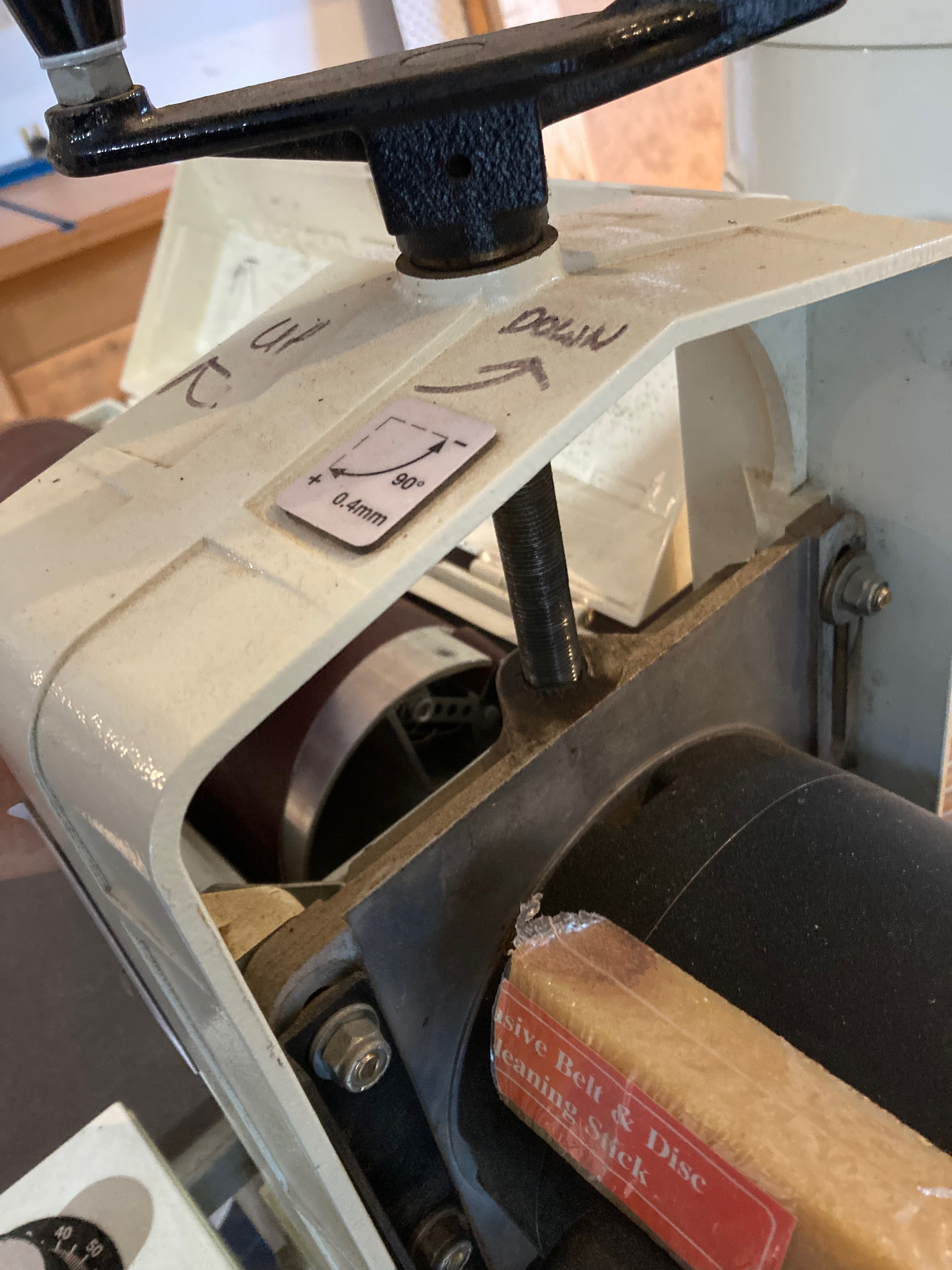

You can add to the sander issues, (from new).
Hight adjustment will not go lower than 5mm so I have to use a sheet of Masonite on top of the drive belt.
There is a few thousands difference on each side of a board. Not a level drum.
The drum rises as timber goes through, so I use multiple 1/64” passes.

Good that you might have found a way of getting it to lock in. Sounds similar to my approach. But I would love to know why that works. Something like a scope camera might provide give a clearer view.
My min height is about 2.5m but I agree the drum height flexes and you need to use tiny increments as you get closer to target.
Another issue with the flexing is that I have to avoid putting two similar pieces through at same time eg. 2 sides or 2 bindings. The piece closer to the open end sometimes loses traction so stops moving or worse still gets spat out.
I still have my home made drum sander which requires manual feed and I can get that as low as I like provided I can manage the feed. I have 80g on the carbatec and 120 on my homemade unit. It's a good combination to have. Despite not having motorised feed, the homemade unit is much more versatile.
