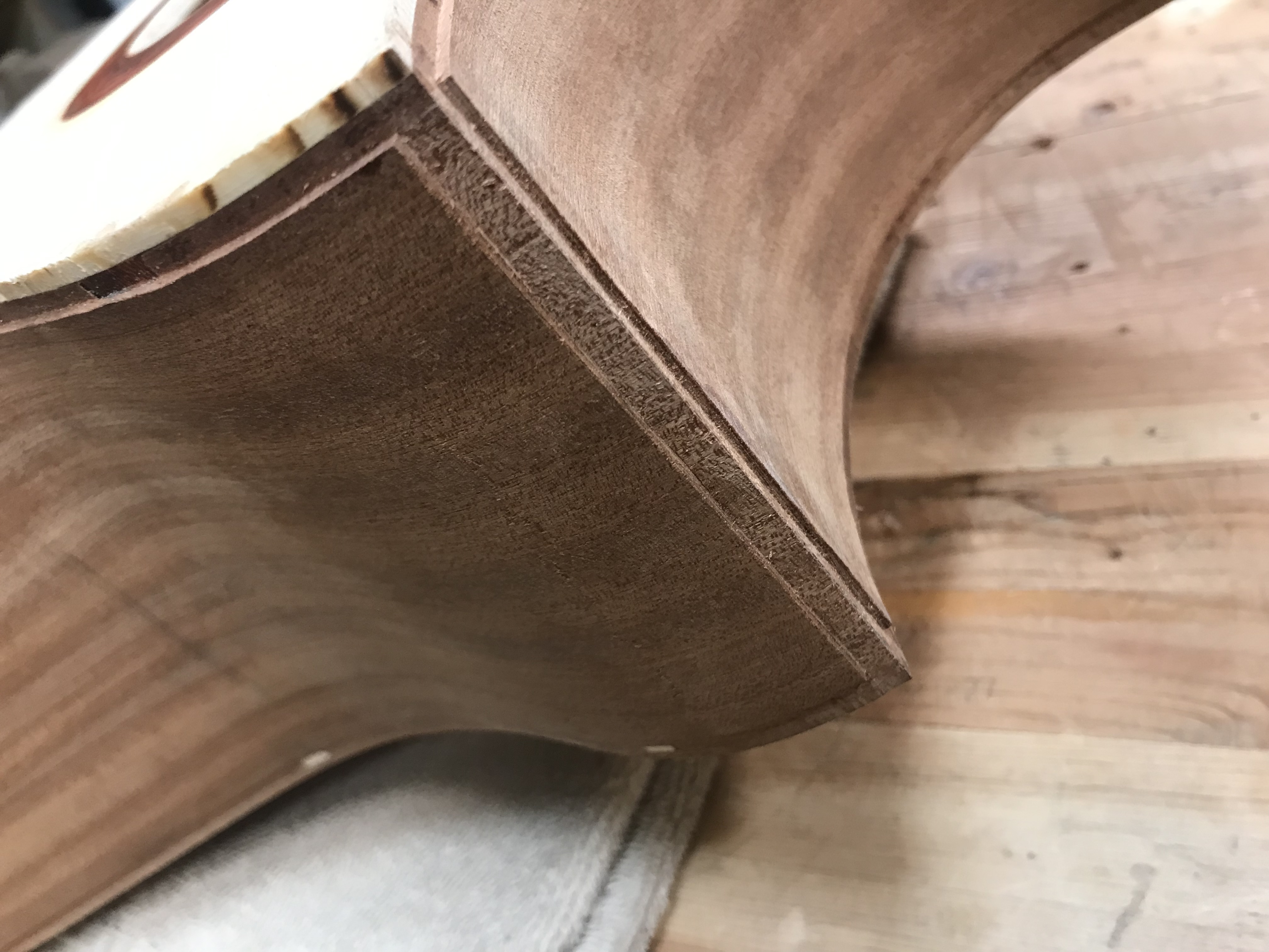

Post by Taffy Evans » Sat Feb 25, 2023 10:02 am
Hi, I have those books, here is a photo of the photo in that section.
