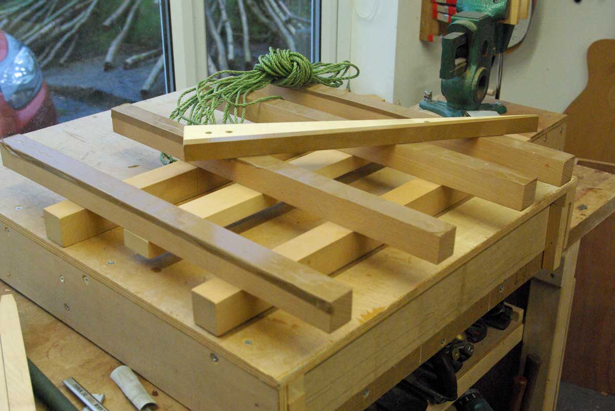

I use the old fashioned string and wedges method - couldn't find a photo of it in use but you can probaly see how it goes or find some other pics. It is a commonly used method.
It will accommodate quite severely non straight outer edges, particularly if you arrange the framework the right way.

Re: Soundboard joining
With a tourniquet style jig like the one I use the outside shape of the plates doesn't really matter as you have multiple sets of rope pulling the plates together.
