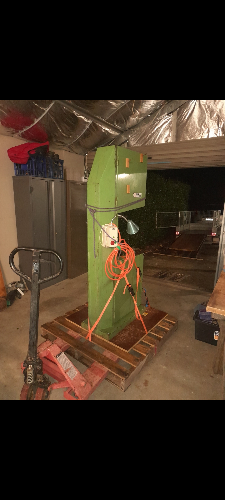

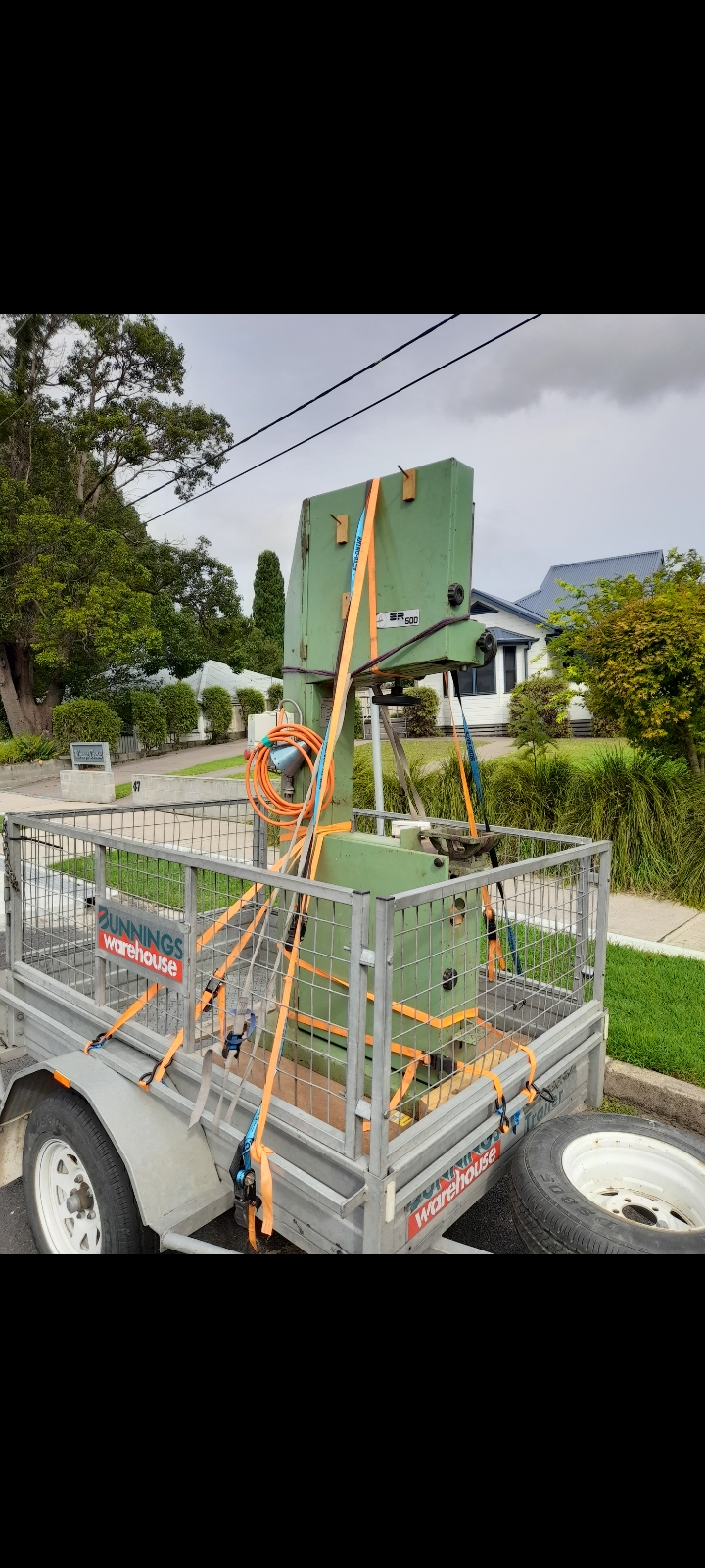

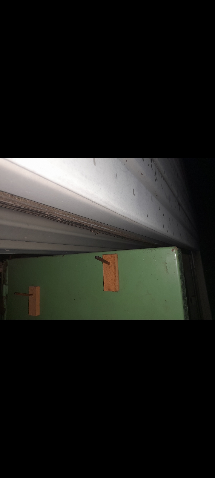

First job was moving it!
Huge thanks to the last owner John who had an engine crane and plenty of time and patience to assist me haul it onto a pallet inside a trailer. I the strapped it down every possible way and drove it up from the sth coast of NSW.
Long slow trip home and finish the day with a rainy night unloading it, with the help of a hastily built ramp, pallet jack and gravity.
It squeezed under the roller door by a hair and I called it a day!
Very happy to have moved 300kg of steel with no disasters!

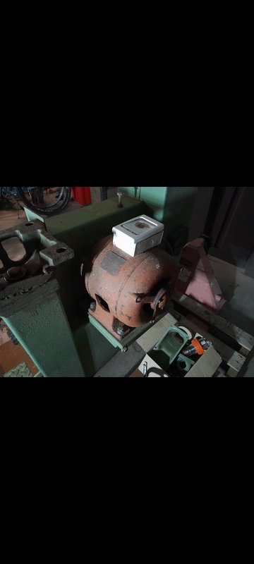

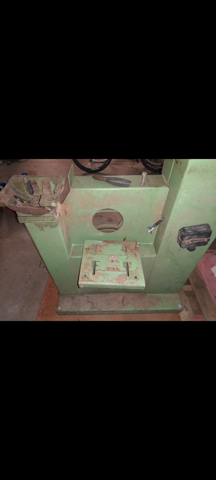

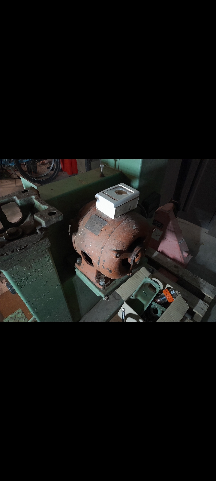

Removed the old 3 phase motor last night, I strongly suspect it is not original, it has an Australian motor stamp, and an Ozzie Stenco pulley, plus the wiring is........... agricultural.
Very simple process to unbolt, cut leads and pull off, leaving a nice clean slate for a single phase motor

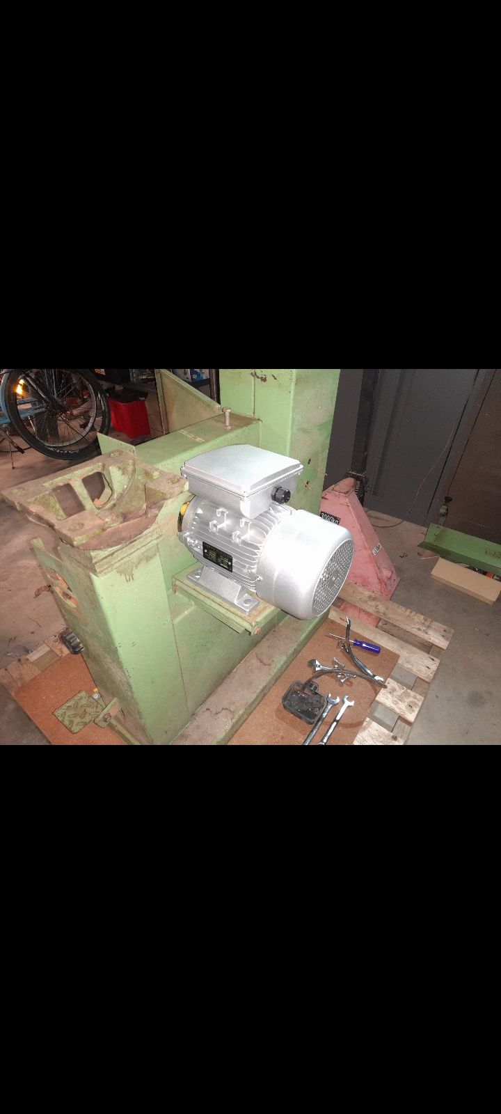

With the old motor removed, I turned to a single phase replacement.
A quick google found a range 2.2 Kw singlephase motors in the 250 - 300 dollar range, so with a few phone calls to check availability I found a suitable frame mount motor, with taper lock pulley, belt and 15 amp lead for $340.
The pulley size calculation brought me back to yr 9 maths, but showed the previous 80mm pulley was far too small and was running a slow blade speed (recommended somewhere between 3500 and 4000 feet per minute)
Finding the original spec sheet of the saw showed a wheel rpm of 720, which showed I needed to reduce my 1410rpm motor by half.
The large pulley on the bandsaw wheel was 280mm /2 gave me a 140mm motor pulley and a final rpm of 705. Close enough! (Actual calculation needed 144mm pulley but that would obviously be hard to find!)

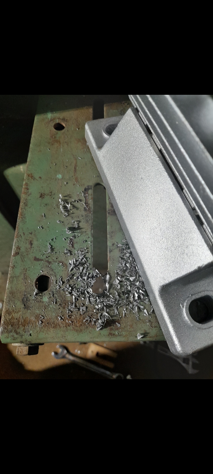

Fitting the new motor was a fiddly but straightforward process, needed to extend some of the existing slots and drill 2 new mounting holes but nothing complex.
Fired it up and it came to life! A few test cuts shows it has serious grunt, but I think the bearings might be due for replacement, will have a closer look after the Easter weekend.
