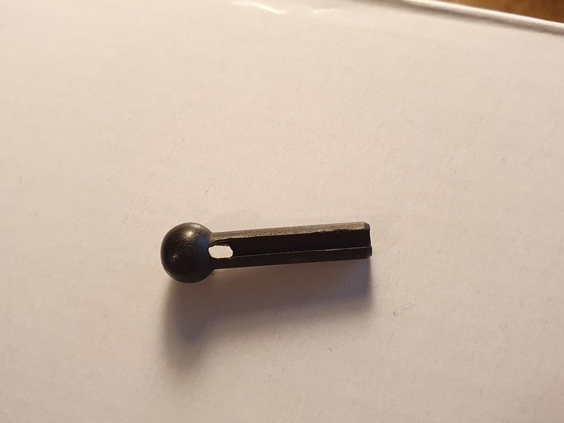

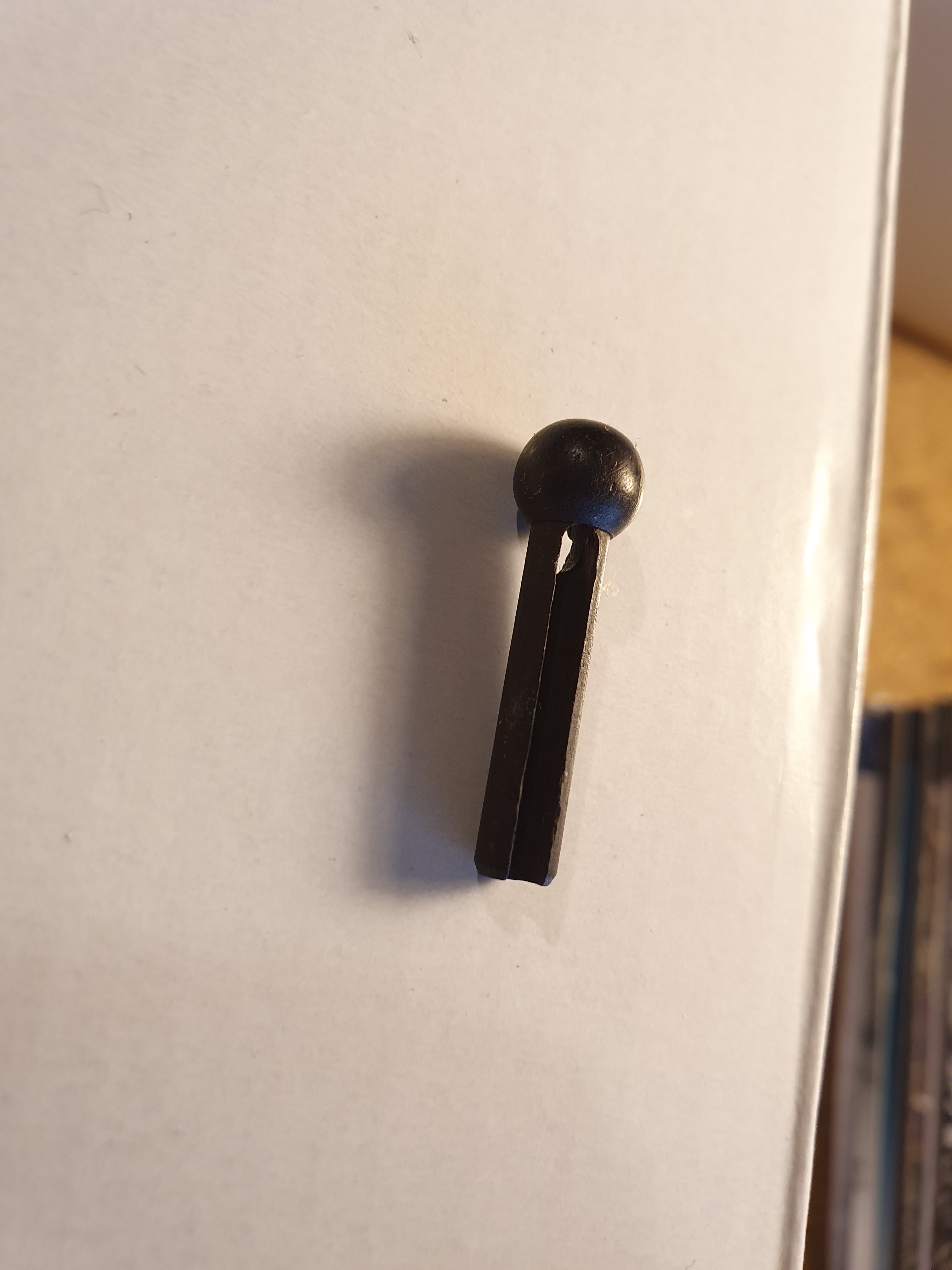

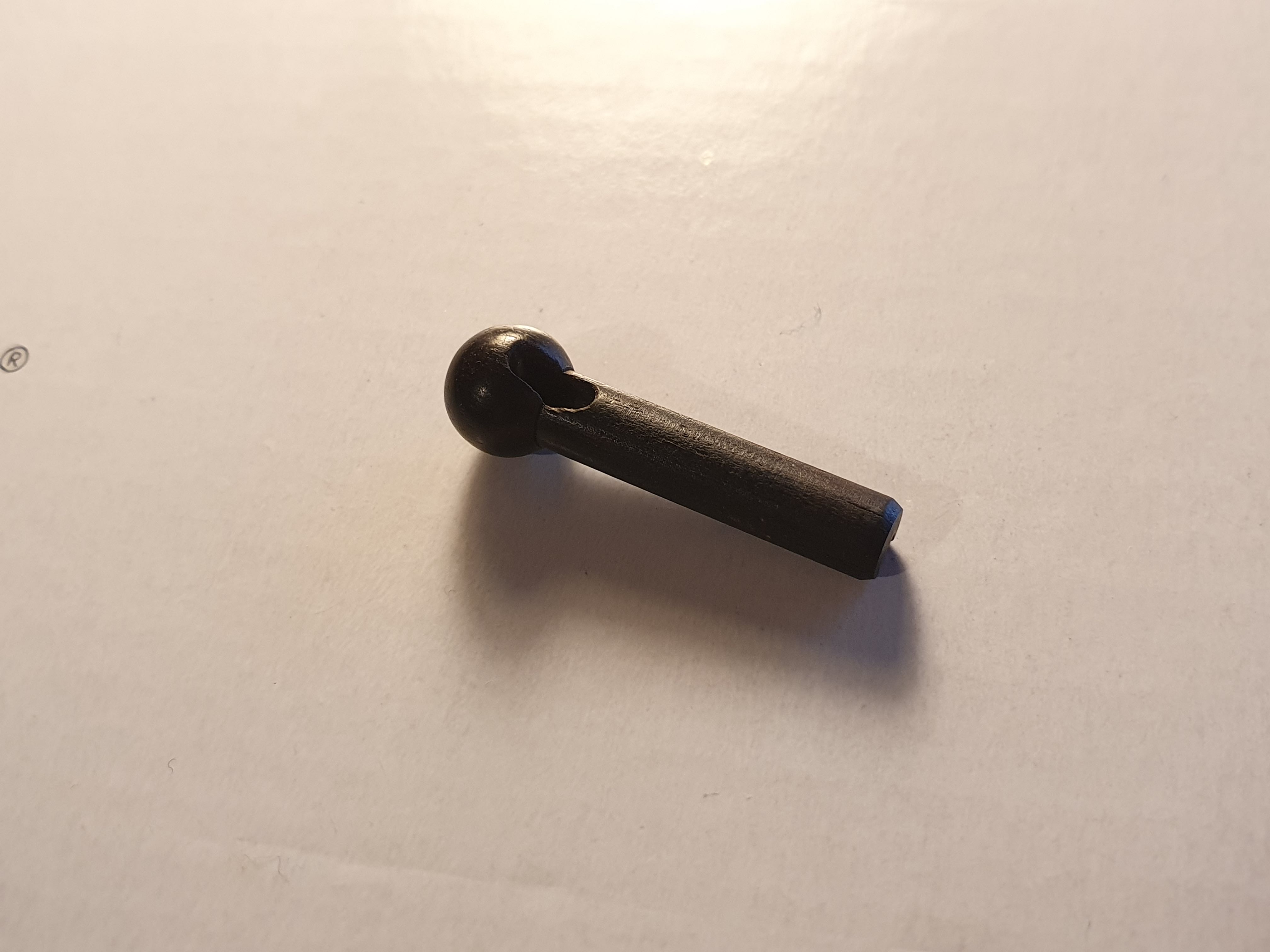

G'day all,
First time acoustic guitar builder here. I searched the forum as best I could and couldn't find anything on this subject so sorry if it has been addressed before.
I'm up to making and attaching my bridge and upon inspecting the pins I was given in the pack I bought, I discovered that they seem to be quite unusual, so far as I can find with my Google searches. They are slotted pins, but they have a hole that continues right through the pin shaft right under the head. They also have no taper at all, the shaft measures 4.7mm the whole length. As such, neither my 4.5mm or 5mm drill bits are suitable.
Anyone have any idea how I would be supposed to proceed with these? Or should I just cave and buy new, tapered pins and a reamer?
Thanks everyone
Thanks everyone

Pins without a taper? Ive never used them....I always use tapered pins and ream out pin holes to fit same.

Thanks Kiwigeo,
Tried them again cropped down so the file size wasn't so large and same issue, I'll send them through to you.
In all my searching online I couldn't even find them available for purchase let alone anyone talking about them.
Looking at the hole in the pins, the first thought that occurred to me was that they were made for the string ball to stop on the other side of the pin rather than inside the guitar against the bridge plate, but if that were the case, they wouldn't need to be slotted on the front would they? I did some searching for people doing it this way and the closest I found were people making them such that the string was fed through the back of the bridge with the string ball stopping there, but no pins were involved of course. The general consensus there seemed to be that it wasn't as strong and the bridge glue joint failing was more likely.
Wasn't able to find a whiff of bridge pins with a hole right through them anywhere.

Ive just uploaded the photos with original post. Dont know what was issue but forum refused to load the original jpgs. I imported into my Mac photo app and then exported them as jpgs and they loaded up.
The pins in the photos......they look like nothing I've ever seen before. I'd chuck them and get some tapered pins and invest in a reamer. All my pins are rosewood or ebony and unslotted and made by Gurian.....got a large stock of them during a forum bulk buy many years back.

4.7mm is 3/16". You should have no trouble finding a 3/16" drill if you want to use the supplied pins. A 3/16" drill is also a good size to use as a pilot hole for a reamer for both 3 degree and 5 degree taper pins.

I've used these pins in the past and they are really, really good! BUT!
They fit 180 degrees opposite to normal pins, - the string runs in the slot which is fitted to the rear, and then goes through the hole and out to the front and over the saddle.
BUT... do be careful when you remove a pin to change a string, because it's too easy to break a head off due to the thin-ness of the pin where the drilling for the string goes through. I'd always use vaseline on them so they don't stick/bind on removal.
Re: 0 Taper Bridge Pins
That's interesting. Do they have any particular name or something? Where did you get them from? I wasn't able to find a trace of them on the internet.
