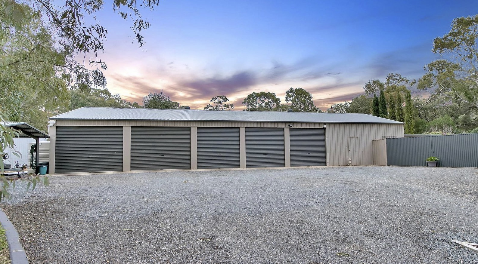

Howdy - I'm lucky to have ended up with a great shed at my new house in rural South Australia. It is divided into two halves and I am setting up the right hand end (12m x 7.5m) as a workshop for instrument building and general woodworking. This part of the shed also has a mezzanine floor 210 cm high against the right hand end of the shed, measuring 7.5 m by 3 m. The shed has loads of power points (three phase), plumbing and LED / fluro lighting.
The shed is not insulated and gets pretty warm when temperature head north of 30, and very unpleasant when north of 40 degrees (which I am told is to be expected quite often in summer). I am considering two pieces of work and would appreciate any advice on materials, insulating techniques, pitfalls etc from forum members:
1. Enclose the area under the mezzanine to create a 7.5m x 3m x 2.1m room for clean work, gluing and timber storage. This would include building a wall with a door to enclose the space, insulating and ventilating it, and possible air conditioning it.
2. Improving conditions in the larger shed for general machine and tool work - I presently have a standing band saw, thickness sander and bench top drill press, fine band saw and several workbenches.
Specific issues I am working through include how to best insulate the enclosed room (eg batts, foil board, moisture management issues), ventilation and humidity / temperature control of the enclosed room and possible approaches to cooling / insulating the larger work space (is it worth the effort?).

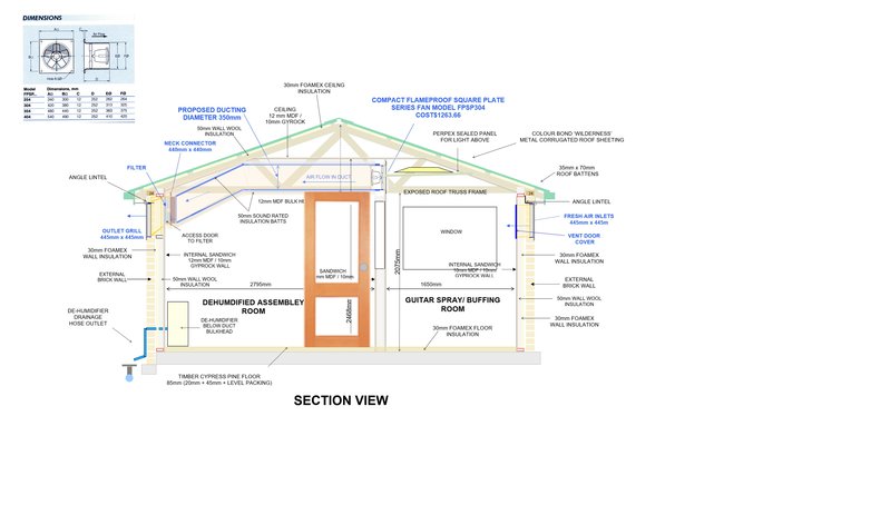

Hi Bob
I converted my old fibro double garage into a guitar workshop. I stripped back to the frame and insulated the roof, walls and floor. See youtube link.
https://www.youtube.com/watch?v=fJG8bx5qLYQ
For insulation and sound rating being in a residential area I used:
- Outer skin foil
- 30mm thick foam panel sheets (for greater insulation 50mm or greater is available)
- Wool batts
- Sandwich internal lining 12mm MDF board and 10mm Gyprock.
- The roof sheeting is metal colour bond sheets and the external walls are brick.
- Raised Timber floor with foam and wool batts on the concrete slab.
- Double glassed windows.`
At my location this installation treatment has proven to be very effective and also controls the noise of machines. No complaints yet from the adjoining residents. The sound rating may not be an issue at your location. I would recommend foil, foam sheeting, batts and gyrock wall lining in your mentioned right end enclosed area as a minimum treatment with air conditioning.

A lot of great information there - I will take some time to look closely at what you have done.WJ Guitars wrote: ↑Mon Jan 03, 2022 3:44 pmI converted my old fibro double garage into a guitar workshop. I stripped back to the frame and insulated the roof, walls and floor. See youtube link.
Thanks, Bob

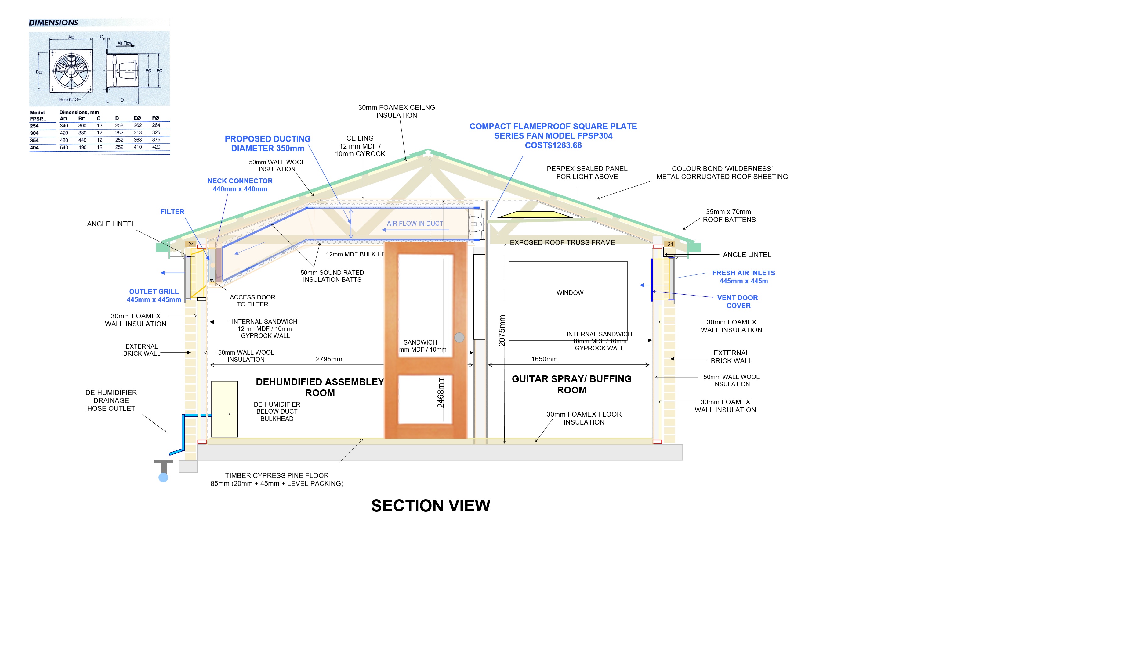

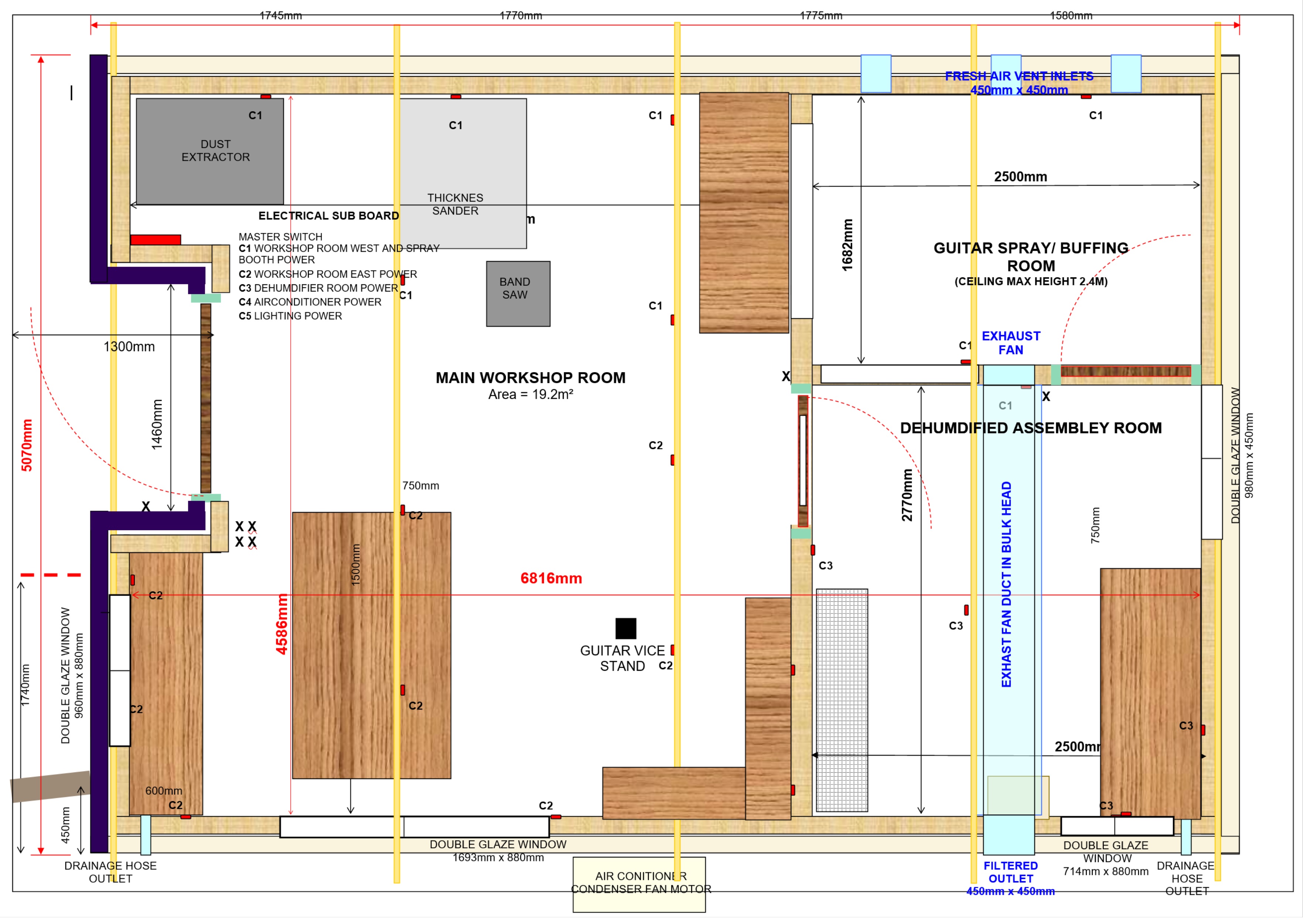

jeffhigh » Sat Jan 08, 2022 7:25 am
Having a small, sealed, dehumidified room for assembly and pre assembly storage is a must IMHO.
All the other things like insulation, ventilation and Air con will make the place more comfortable for you but not necessarily reduce the Relative humidity to accepted levels./quote]
For my dehumidified assembly room (re: Plan and Section view drawings posted), all the doors in the workshop have 'Raven' door seals that are fit around the door jamb and include a drop down seal to the floor. I also used mastic to seal around the lining sheet joints for the walls and the ceiling. I don't run my humidifier all the time. I have found that generally at my location the RH stays between 38% to 55%.
Before starting work with my tops and back and sides I run my dehumidifier for 2 weeks. The RH then stays around 45%. When the box is closed I switch the dehumidifier off. Generally, If there extreme weather changes occurring, to protect my wood stash that is stored in the assembly room I will keep the dehumidifier running to minimise potential warping issues.
