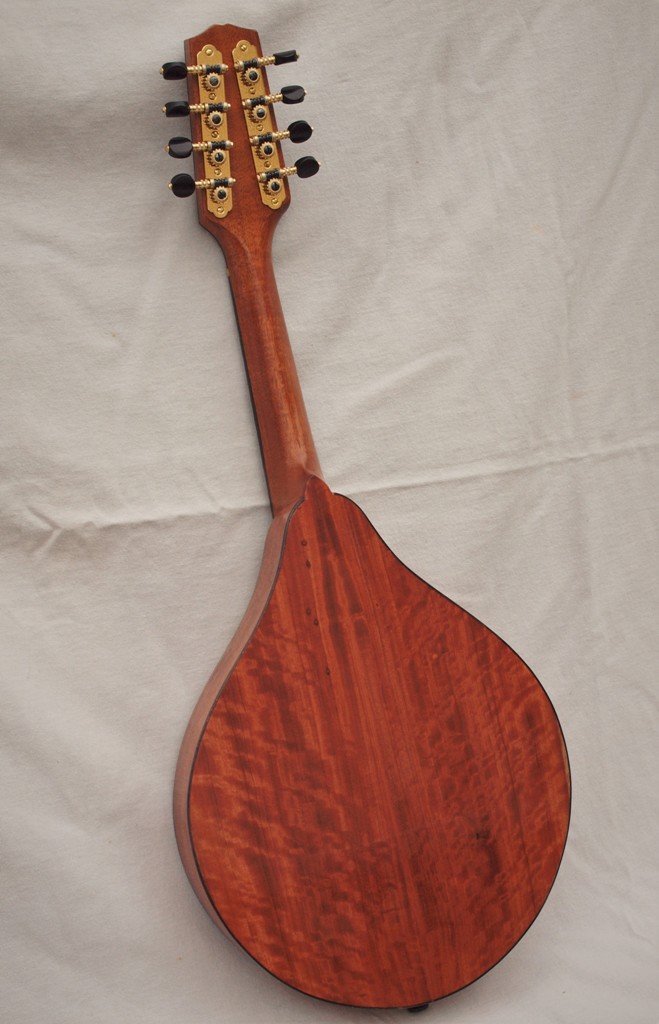

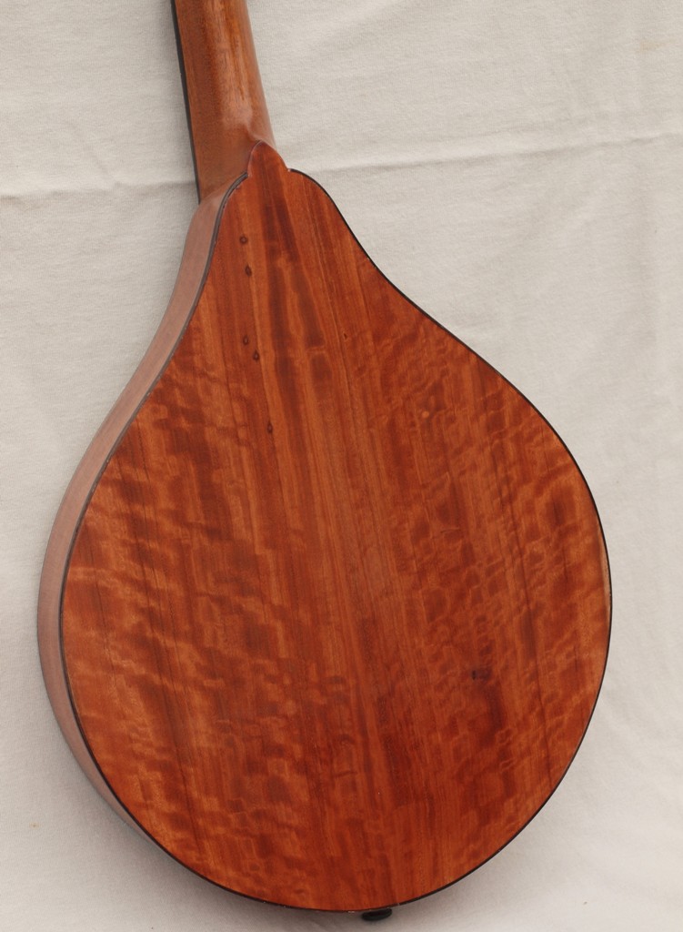

Re: Red gum
Not too shabby under varnish. I am happy with this. Will continue, more later.
- Posts: 1174
Re: Red gum
That does have a lot of life to it!
If it sounds as good as it looks.............
This is tantalizing.
- Posts: 1642
Re: Red gum
Yep, that looks fine. Gerard would have been using nitro over a grain filler, which may well look different from an (oil?) varnish.
- peter.coombe
- Posts: 746
- Location: Bega, NSW
Re: Red gum
That is shellac, followed by Aquacoat pore filler, followed by varnish. The varnish is Target Coatings EM2000, which is an oil varnish in a water emulsion, so it is a water based finish but does not have any of the blue tinge you can see on darker woods that many of the water based finishes have. I like it, no need to wear PPE if brushed on, or worry about weather conditions, and I especially like the way it ages.

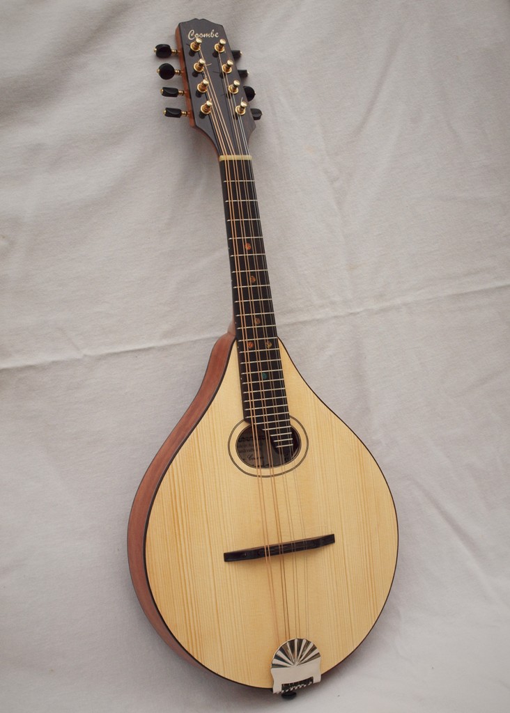

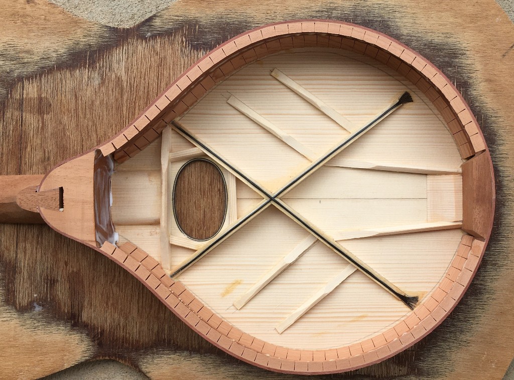

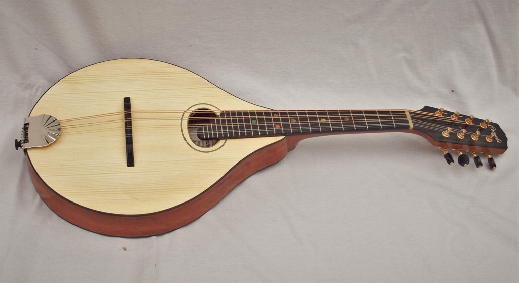

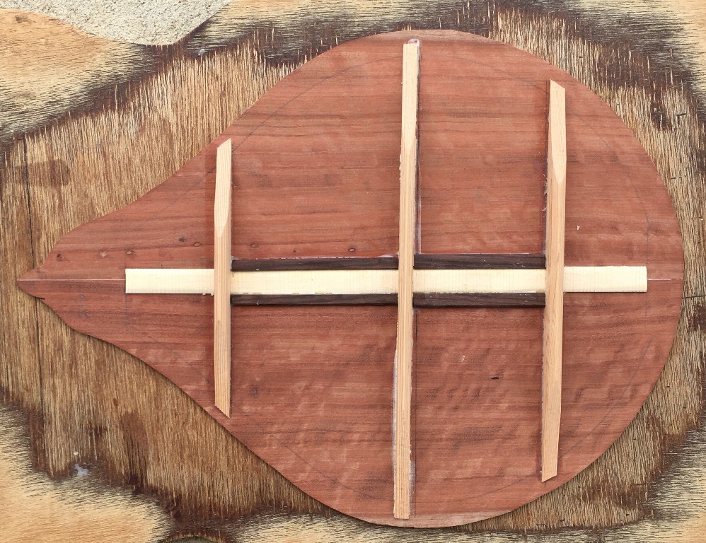

Well the red gum mandolin is finally finished. Took a while because I ran out of bridges and Vern Brekke is having problems at the moment with the CNC he was using so had to wait for a bridge. Was well worth the wait. All the nay sayers on red gum now need to eat their words. This is the best sounding of this style of mandolin I have made so far, but it is not the loudest. In comparison to my Ebony mandolin it has more depth of tone and overall sounds more refined, but the Ebony mandolin is louder. Lovely beautiful sounding instrument. Very pleasing and a big surprise bearing in mind all the negative comments I found for red gum as a tonewood.
Here are some pictures of the bracing and the finished instrument. I have not done any sound clips yet due to my left middle finger having an argument with the bandsaw and the bandsaw won. However, was not too serious and is now not far off being ready to play mandolin again. The red gum is not very stiff along the grain so I added some 5mm strips of indian rosewood to stiffen it up a bit. Seems to have worked. Thickness is 3.4mm and weight is 212gm, so not as heavy as the ebony even though it is thicker. So, red gum has beaten BRW, EIR, sassafras, blackwood, myrtle, rock maple and red ironwood. So, not so shabby. The red ironwood has just been strung up, so is early days yet, but is no match for the red gum mandolin, and red gum is a heck of a lot easier to work with. It is common as mud, but not around here because it does not grow here. Main problem is getting a clear piece that is dry and quarter sawn and with a bit of figure. It is pretty rough stuff, full of gum veins and worm holes, but the sound is great, and commonly highly figured. Whether it would work in other instruments I have no idea. Unfortunately some years ago I sold the rest of the plank where this wood came from because I thought it was too unstable for an arch top mandolin and I would never use it. Bugger.
Woods are Red Spruce top from RC Tonewoods, red gum back and sides, Mahogany neck, Macassar Ebony fingerboard, Indian Rosewood bindings, and ebony bridge and headstock overlay. The fingerboad dots are opal.

Re: Red gum
Excellent result Pete. When you are able I would like to here a sound sample.

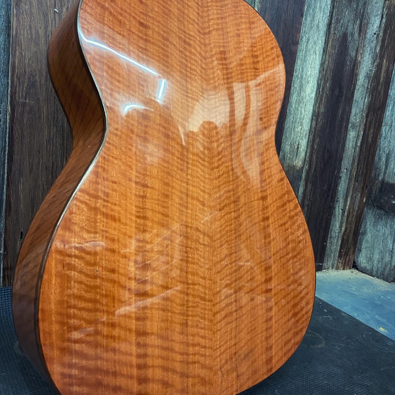

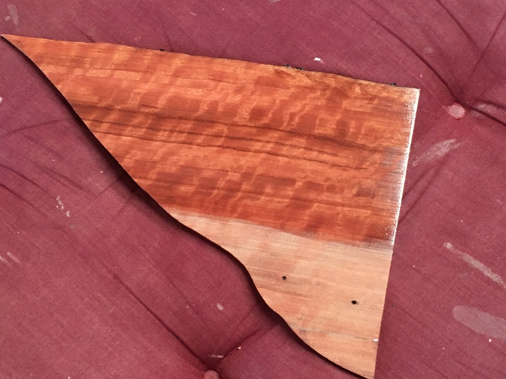

Re: Red gum
I've used jarrah, but it is laminated - veneer. But if you're going for a dead back, this approach may well work for you. There are a few new quirks to using veneer but it does allow you access to beautiful woods you might not otherwise consider because of stability issues.
- Sassafras
- Posts: 46
- Joined: Thu Jul 05, 2012 11:14 pm
Re: Red gum
The first pic is some Regum Back and Sides. It Is also Laminated Back and Sides.
I have been using Jarrah in the Guitar Making School but we always pit a layer of epoxy over it to sure up any cracks and make it stable. I also use Jarrah Veneers for Back and Sides. Looks Beautiful!!
