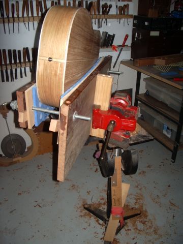

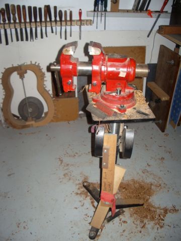

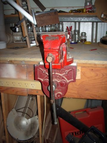

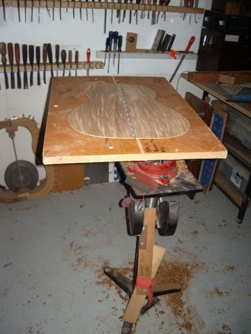

Heres some shots of three of my vices [not the wondervice mentioned earlier]. One is mounted on a grinder stand that is hight adjustable, and I can work all around it or turn the job around to suit the light. I mount many more jigs and tables on it than shown here. Three benches surround the vice for tools, glue or whatever. In another room I have the carpenters vice shown, this also takes and engineers vice that is mounted on timber and clamps into the bench vice, this is removed and stored when not requiered. Hope this gives some ideas.

Taffy, the grinder stand is bolted to the floor isn't it? I'll have to ponder whether or not that's a good thing to do in the house. We are going to have to replace the carpeting anyway.... Other than that issue, I REALLY like the idea.

Taffy's idea is a great one. My father had a very heavy duty vise that could almost double as an anvil mounted on a steel pipe about 6" in diameter that he filled with re-bar and cement. Make it rock solid, and very easy to work around.

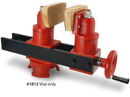

I went with the Parrot vise on Frank's advice.
http://www.frets.com/FRETSPAGES/Luthier ... tvise.html
