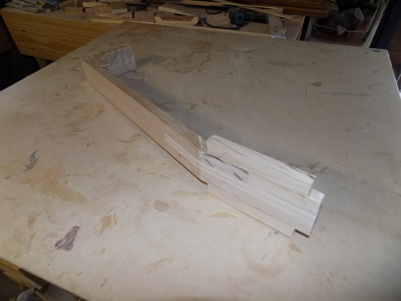

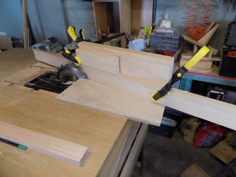

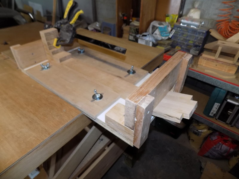

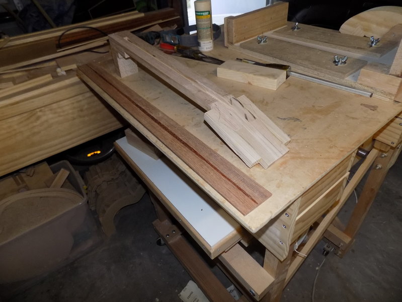

Cutting the neck scarf joint with a jig on my (self-adapted) table saw

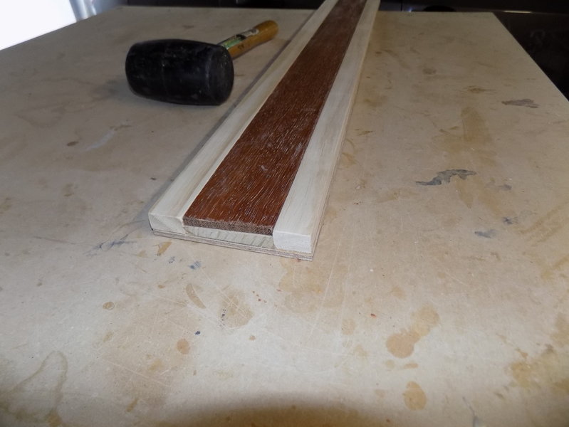

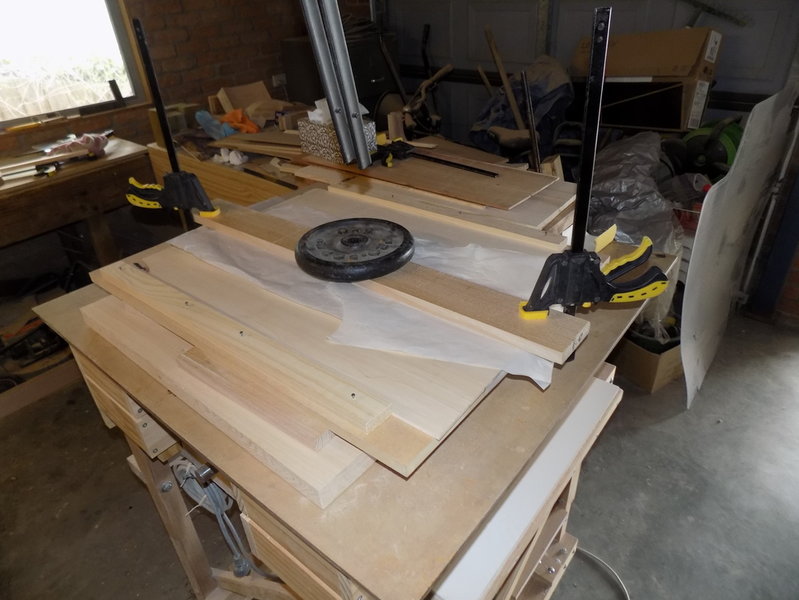

Neck pieces glued up
Cutting the truss rod slot in the neck using another jig

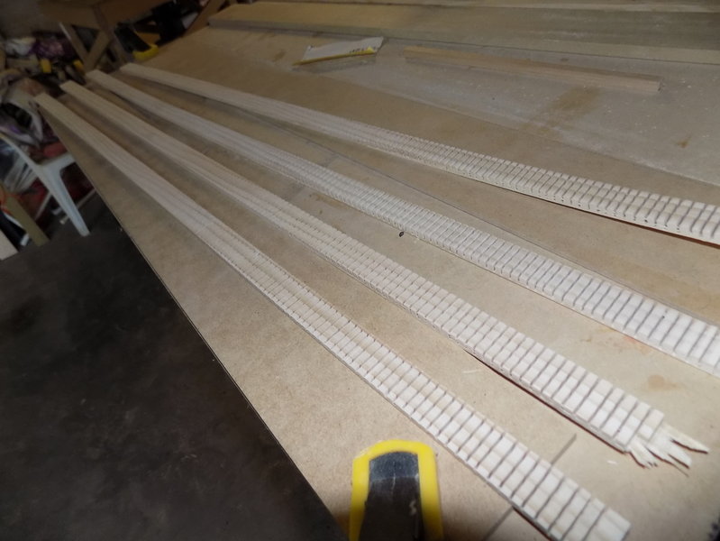

Cutting bevels in the fingerboard prior to sanding in the radius

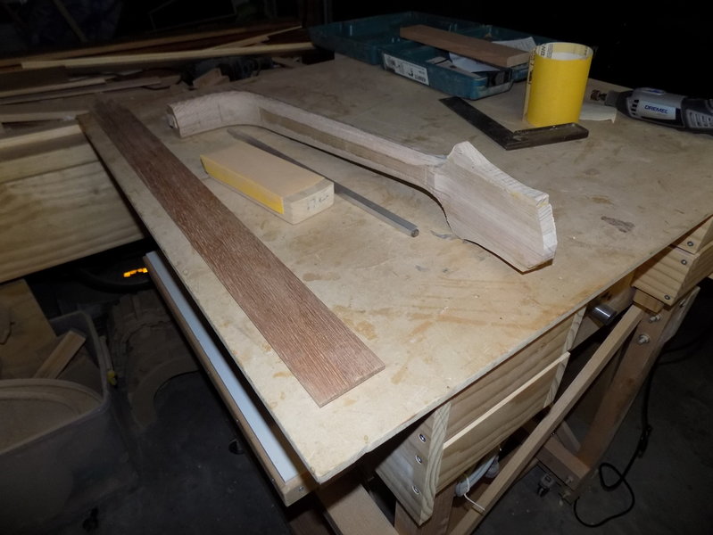

Neck and fingerboard components

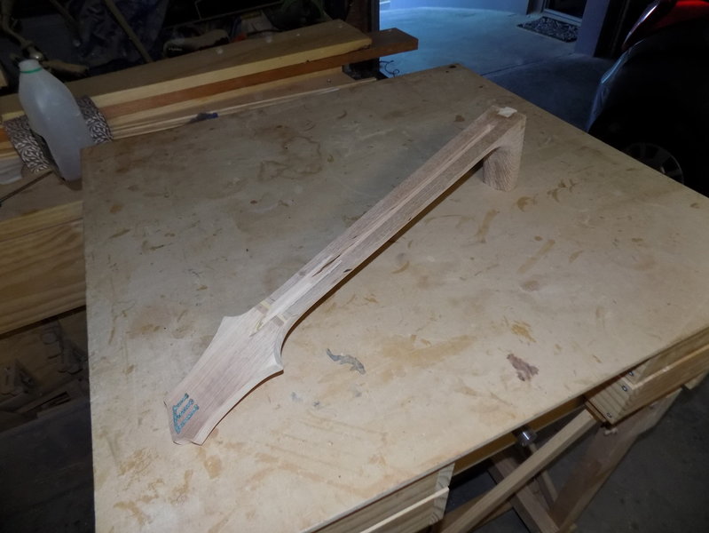

Neck after initial shaping

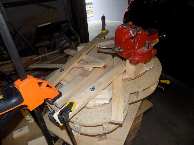

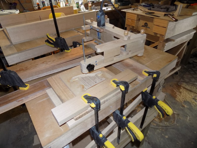

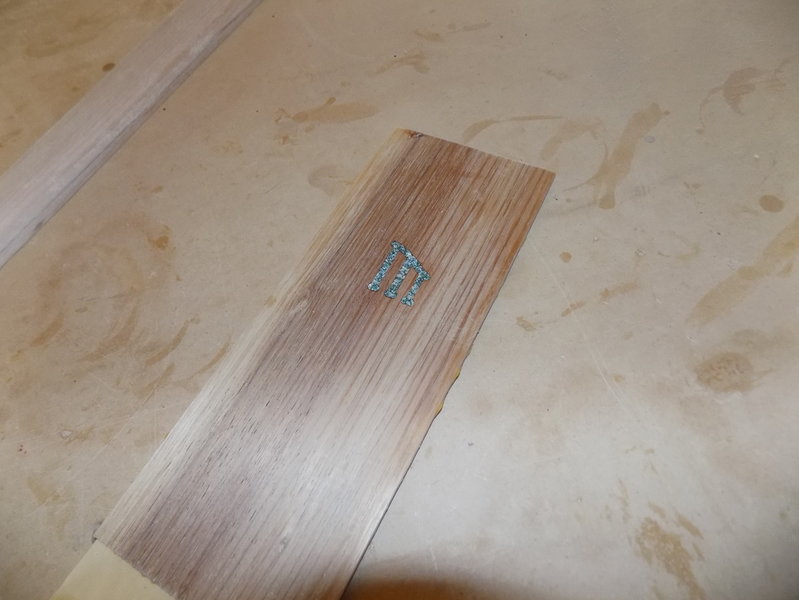

Pantograph jig for Dremel, reduces the template by one third, for headstock inlay channel
Headstock inlay

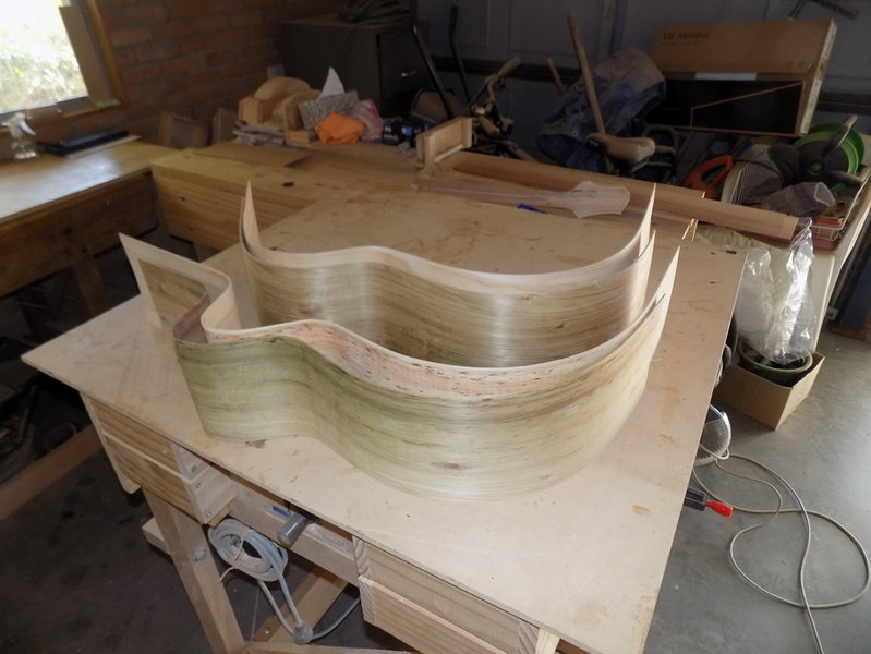

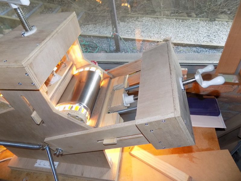

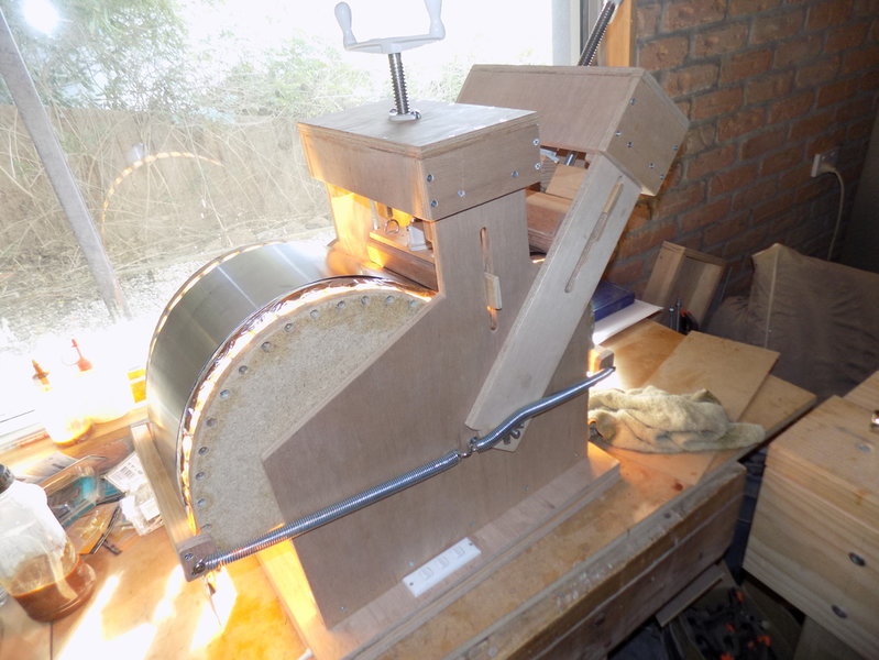

Bending the sides in a Fox bender

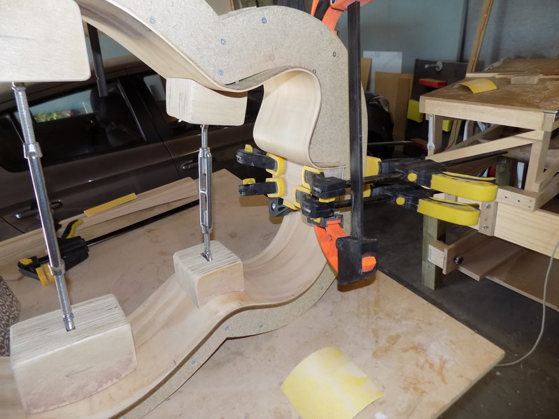

Bending the cutaway curve
Sides bent, ready to be laminated

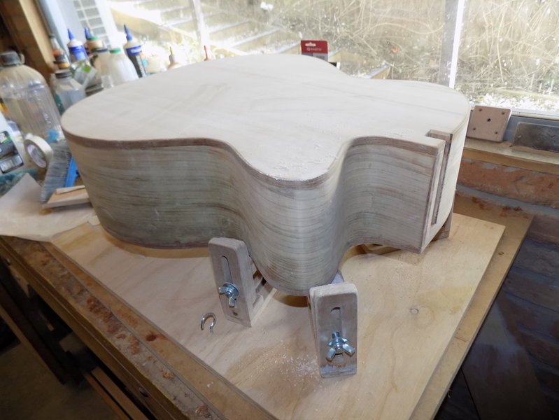

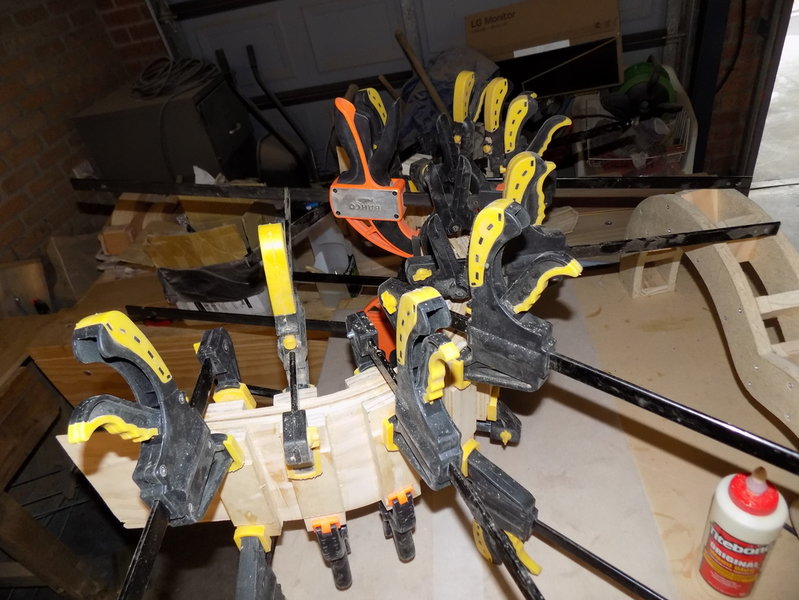

Laminating the sides

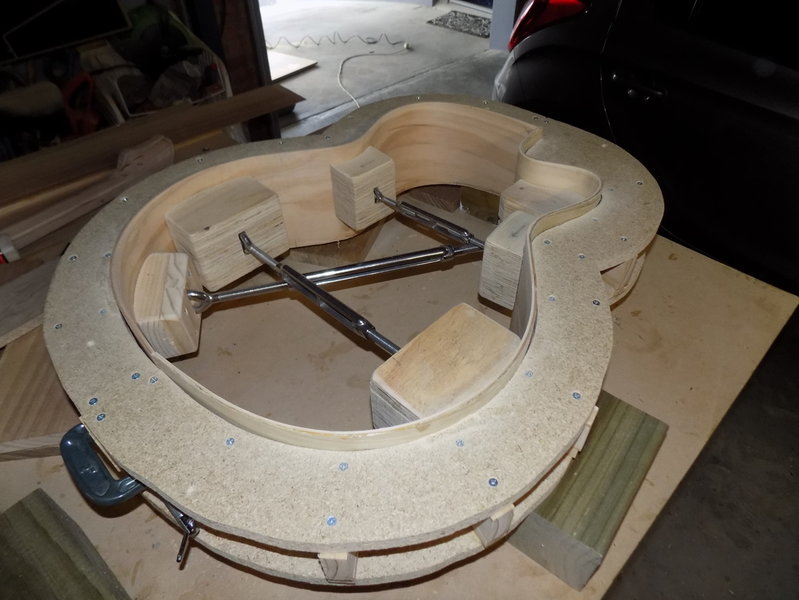

In the mold
Gluing tail block
Gluing neck block

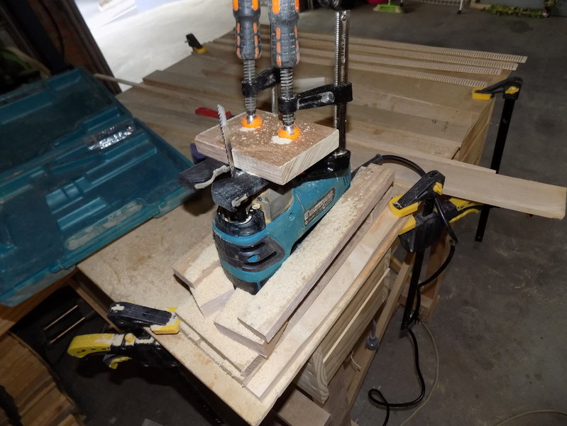

Jig for making kerfed linings. This is hazardous! Think I need a bandsaw!

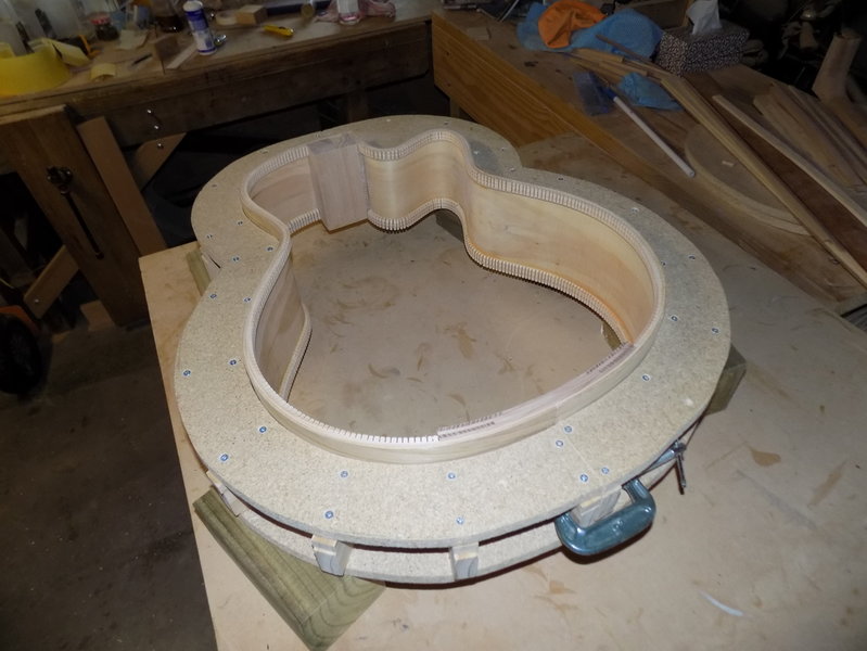

Kerfed linings

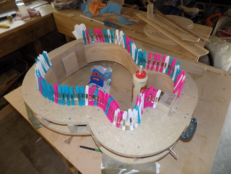

Gluing in the kerfed linings
Kerfed linings done

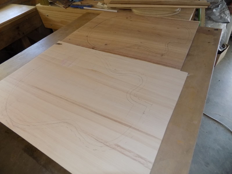

Butt-joining the book-matched pieces of the soundboard
Soundboard and back after butt-goining

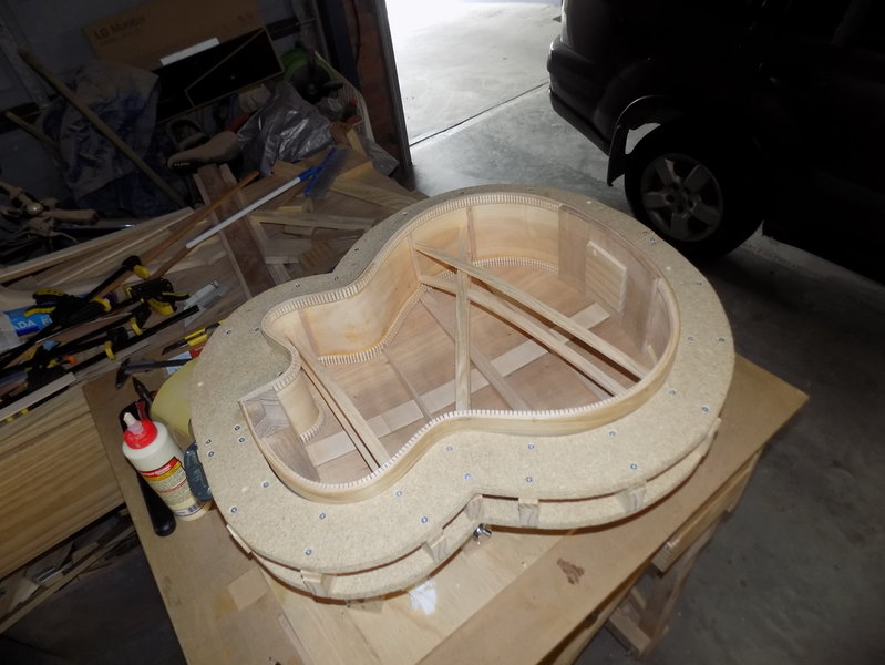

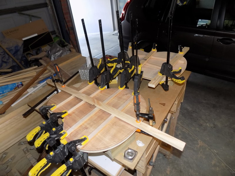

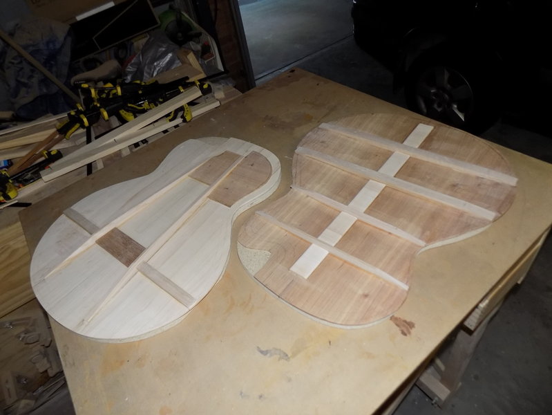

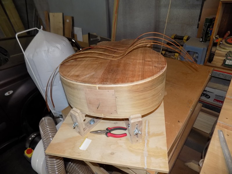

Glueing the bracing to the soundboard and back
Soundboard and back with bracing

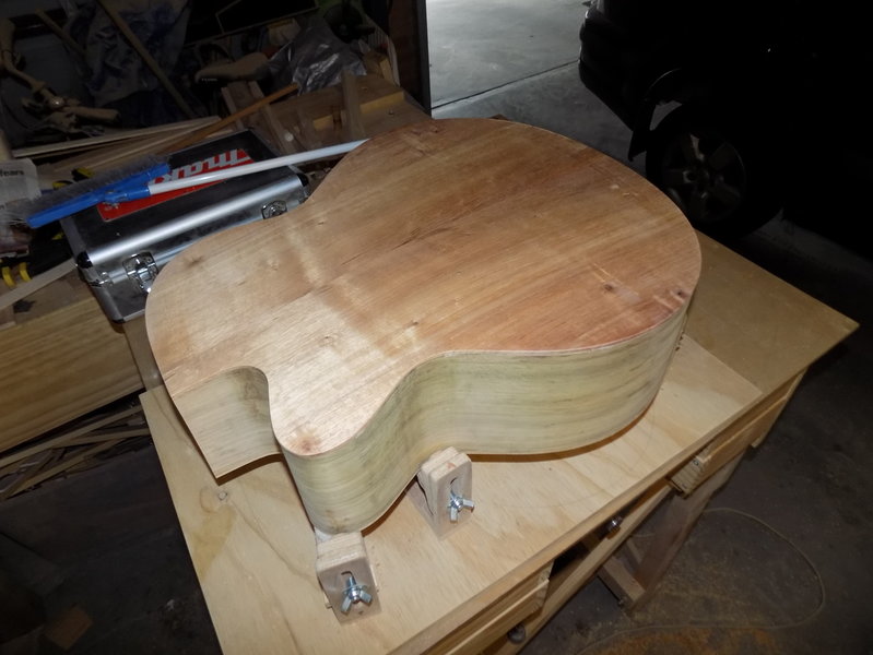

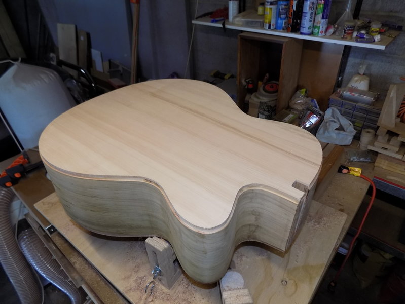

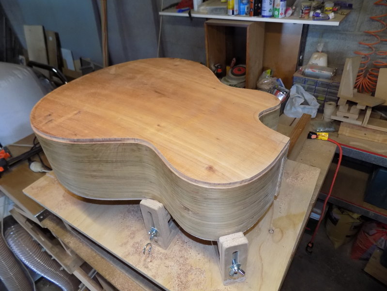

Attaching the back
Side braces

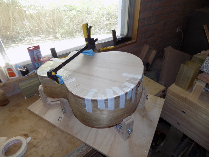

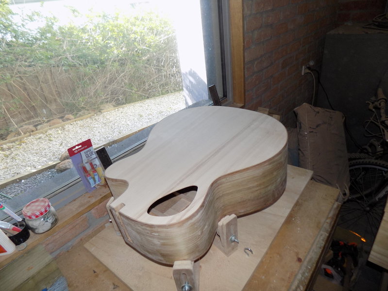

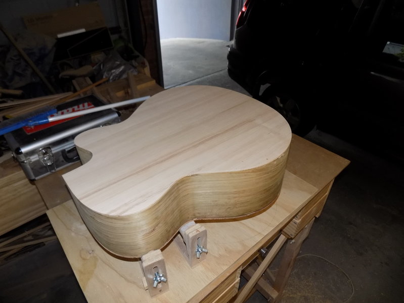

Attaching the soundboard
Soundboard attached
Back attached

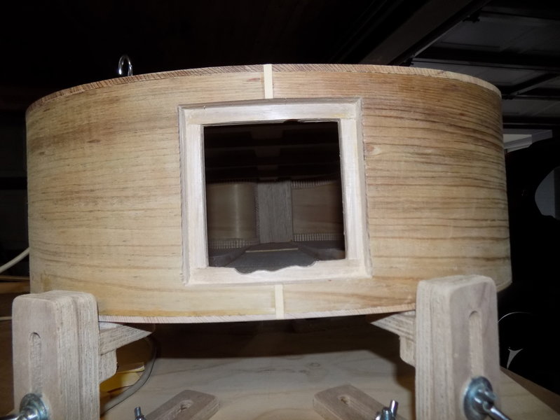

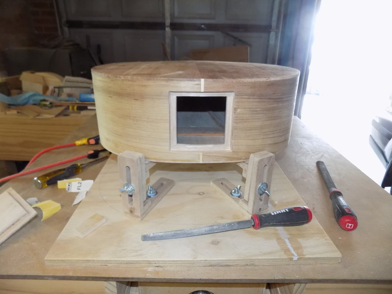

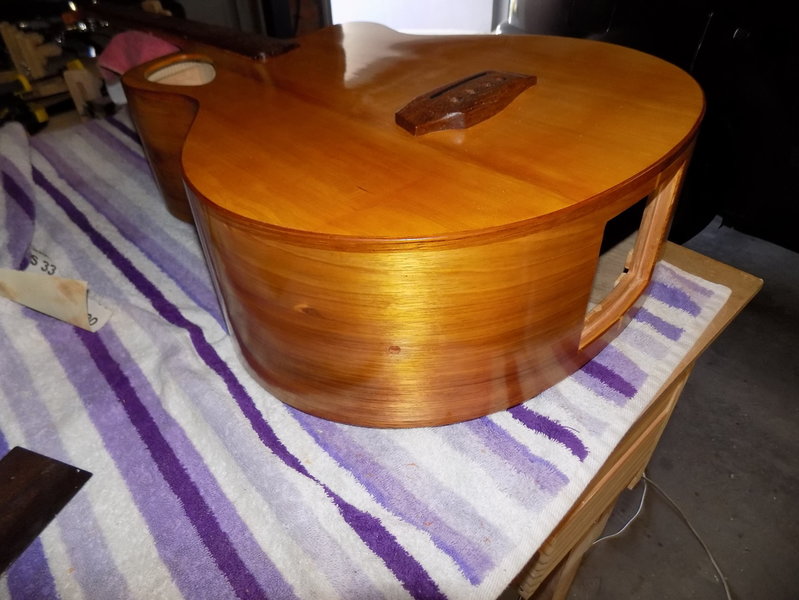

A disaster with the router opening the access port
Partial recovery from said disaster

Attaching the bindings
Bindings attached

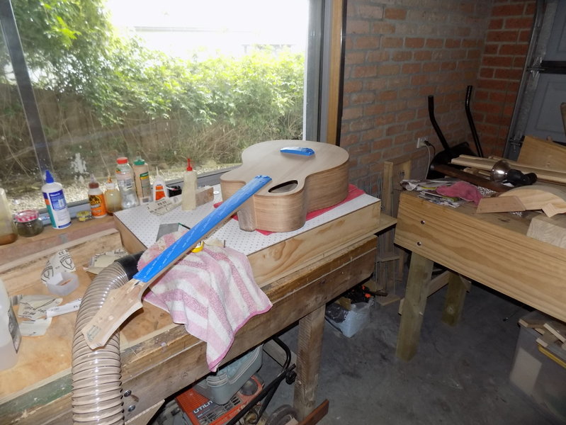

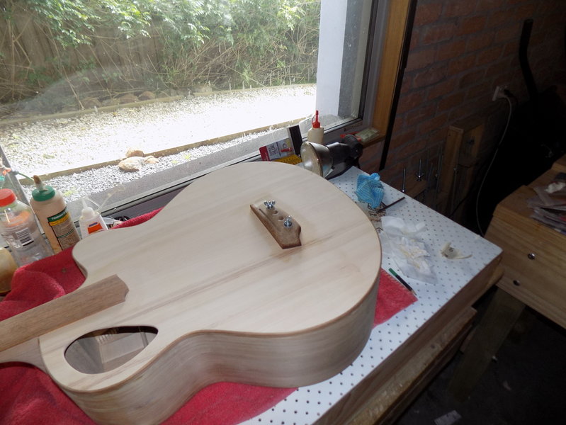

Shimmed and bevelled tongue for neck fit

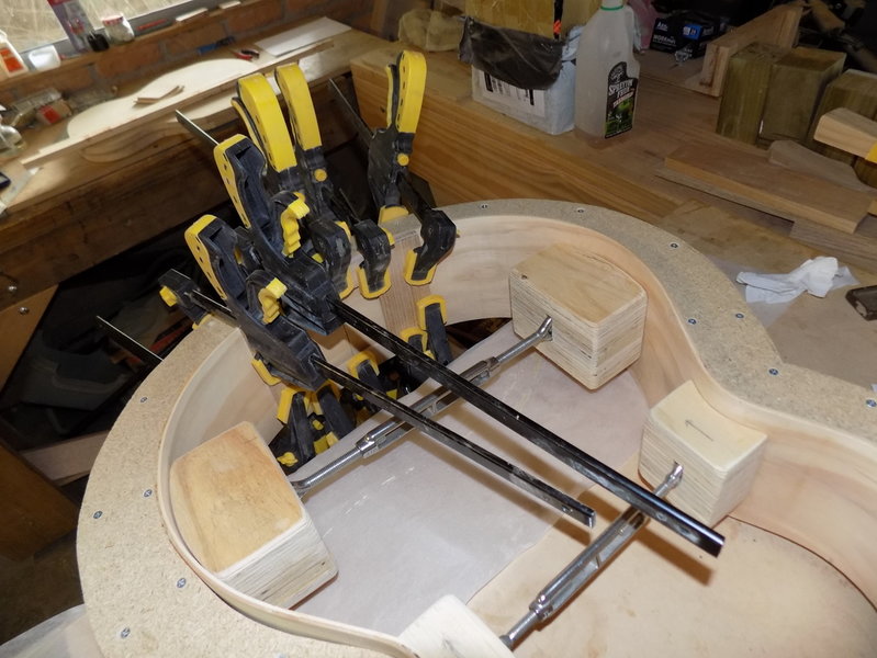

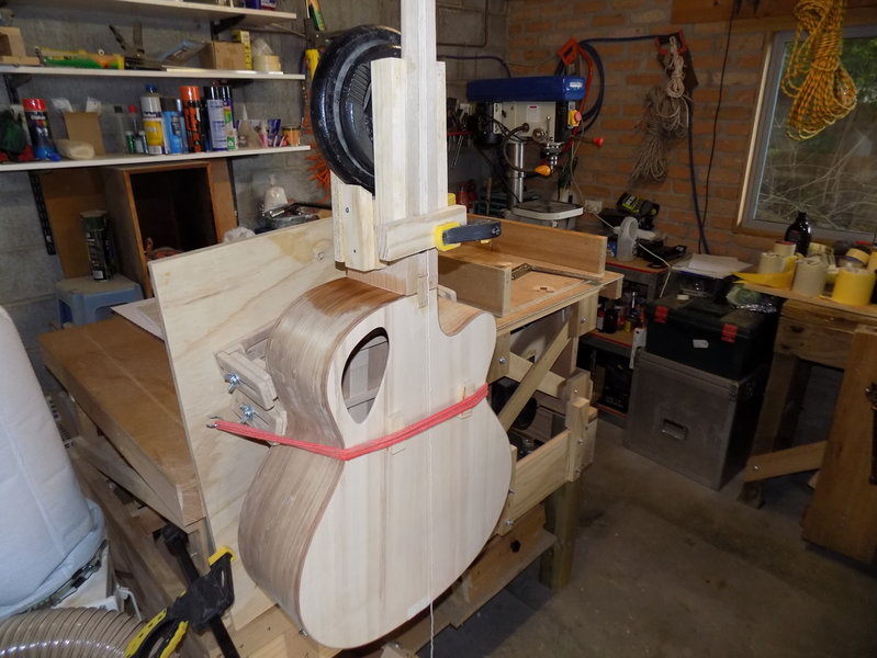

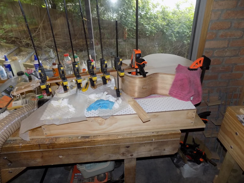

Gluing on the neck - gravity clamping - next time I think I'll use furniture-bolt clamping

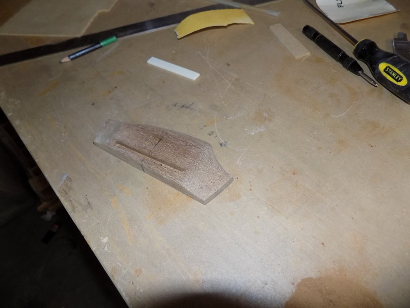

Shaping the bridge
Attaching the bridge

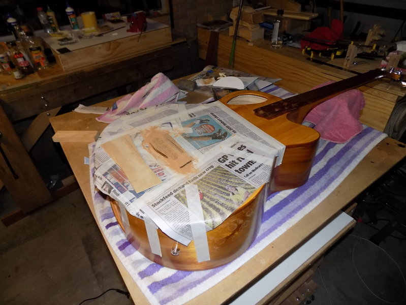

Taped up ready for finishing

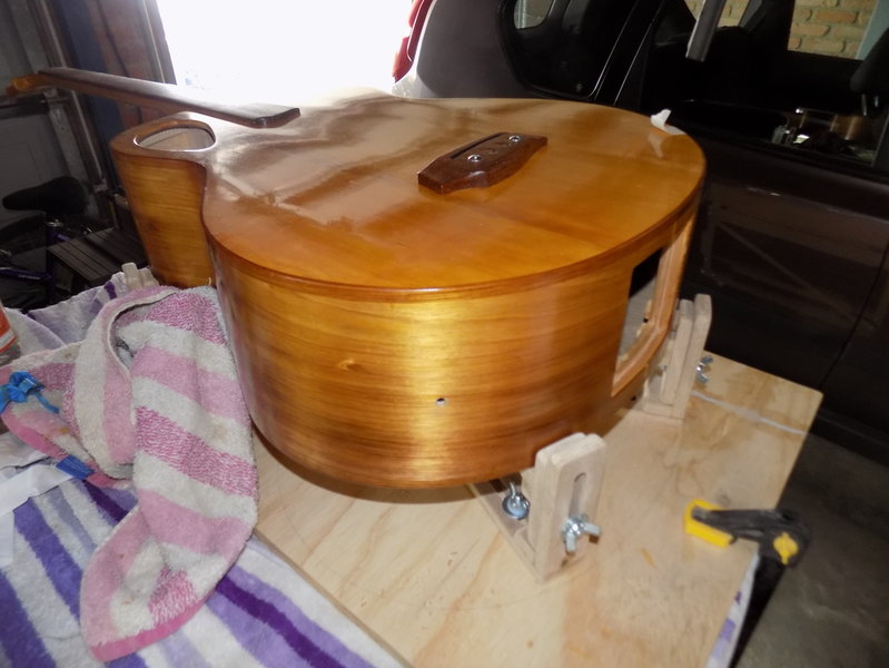

First round of French polishing

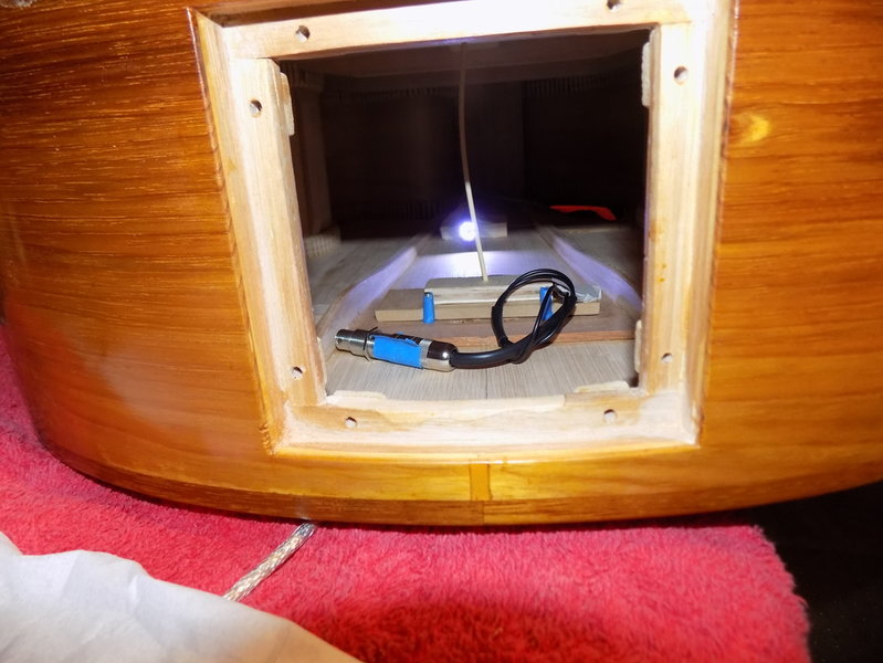

The most idiotic mistake yet - pickup jack on the wrong side...
Cover up
Gluing in the pickup

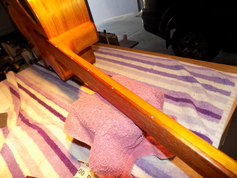

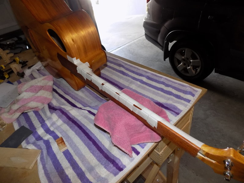

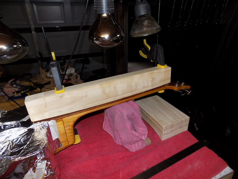

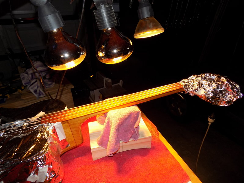

There was a tiny backbow in the neck, but because I used Tassie oak, string tension was not enough to draw it out. Here is how you are supposed to fix this.
Heat lamps and string tensions not nearly enough. Here is how I ended up getting any relief at all!

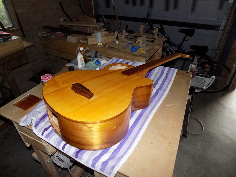

The final result
You can hear a rough'n'ready demo on YouTube at https://www.youtube.com/watch?v=Rbtcs1e2xEU
Here are a few shots:
