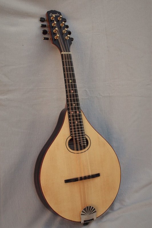

Now the first two mandolins I made with stiff backs are now prototypes, used to prove the concept. I have not been idle, but have been working to try and develop this further. Rather than use a pancake type of mandolin, I switched to what I call my "Classical Flattop" model. This has the same body size and shape as a vintage Lyon and Healy style C mandolin, and has been the best sounding of all my flat top mandolins. It is different from anything anyone else has built in the mandolin world, braced similar to a guitar. The only real difference from a guitar is that it does not have tone bar braces but has two braces from the tailblock to the X brace to resist the rotational force from the string tension on the tailpiece. The X braces have carbon fiber tow on their tops which makes a very strong top because the tow is about 10mm from the axis of bending, and the force is downwards pulling on the CF tow. The fingerboard extends over the sound hole (similar to the Lyon and Healey mandolins) which has the effect of lowering the main air mode to about 1/2 semitone below the G string (lowest note). That gets the main air mode out of the way.
Anyway to cut a long story short I have made 8 of these mandolins to date and have sold 7, so the players have noticed, which is very important. The 8th I am keeping for myself and is the subject of this post. All these mandolins have the same characteristics in terms of sound - unusually clean and clear sound for a flat top mandolin, and very even across the strings and up the neck. I thought the best sounding ones were the ones with Tiger Myrtle back and sides. Myrtle is the most dense of the back woods I used, so maybe the good sound is due to it being more on the dead back end of the live back/dead back spectrum. So why not make something with a really dead back. I have some Macassar Ebony that I purchased 25 years ago and have not been game to use it until now. So I made this mandolin as an experiment. Red Spruce top, Macassar Ebony back and sides, Brazilian Mahogany neck, Blood Wood bindings. The back has 3 hefty braces of Douglas Fir (Oregon). I used Douglas Fir because it is stiffer and heavier than Spruce. The weight does not matter because this is meant to be a really dead back mandolin. The top weight was 75gm, the back was 220gm, so a really big difference. What happens when the back is heavy and stiff. Everything changes. All the modal frequencies go up. The main top mode node moves out so it sits just about right on the rim. The ring node of the main back mode on the back shrinks in diameter. All this means nearly all the sound is coming from the top, so it is a bit like a classical guitar. The frequencies actually overlap the lower end of what I measure in my arch top mandolins which would explain why these things sound so good.
So, the result. The Ebony mandolin is an amazing sounding mandolin. In my opinion the best flat top mandolin I have made to date, and I find it difficult to imagine a flat top mandolin could sound any better than this one. I have not come across any flat top mandolin that sounds even close. I am keeping it, it stays right here, and another one is almost finished. Only problem is these are rare woods, pretty much now wood unobtainium so I can only make a limited number of these. The Bloodwood bindings were difficult and the subject of some bad language, but the red bindings against the black Ebony just looks stunning.

Here are some more pictures of the recently completed mandolins. The BRW and the Tiger Myrtle have already sold, the first and second Ebony mandolins I have not offered for sale (yet) because I am still trying to decide which one to keep. The Tiger Myrtle has arrived with it's new owner just in time for Christmas in the USA.
Front view of the Ebony mandolin
