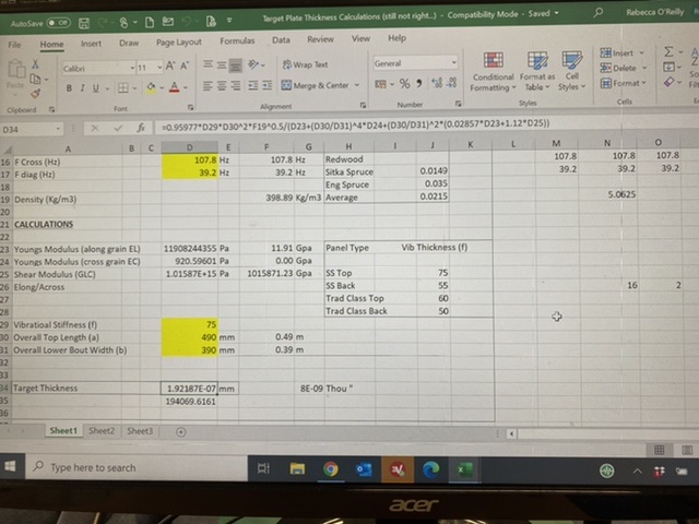

Hello there
Is there anyone who could have a quick look at the spreadsheet I have done as it doesnt seem to be giving out a correct thickness?? I cannot upload but can send directly to some kind volunteers email address...
It was copied as a screenshot form the forum ( thanks Martin!) but formulae is by me and I suspect the thickness formula is the culprit...
I think I have gone as far as I can myself

Hello
I cannot upload my spreadsheet not can I see the formulae in the Google Docs sheet...
If someone could have a look at the thickness formula in this screenshot as I think the error might be there.

Re: Still not getting the sound I want...help!!
Hello
I have now adjusted my excel sheet to match the formula for thickness and I am getting the same result as the screenshot so I cannot hunk I am good to go
I will do a live back now that I am doing the TG method on this guitar so is the thickness spreadsheet ok for that as well????

davidafterwork wrote: ↑Fri Aug 21, 2020 1:01 amHello
Very bad English there..!!
I meant to say I am good to go
I am going to try a live back as well so will use the correct value of 55 as per the book. Really looking forward to this now so hopefully it will go ok even though I am not too sure of what’s next Re the x bracing and if any tests required at that stage so I will be no doubt picking your brains again before this first TG guitar is built!!
