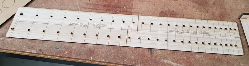

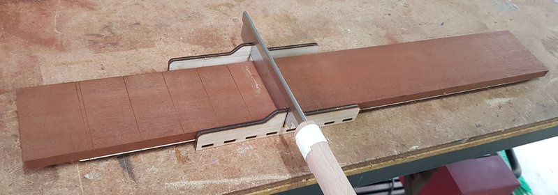

So in the intervening years, one of the things I had done is started up a laser cut thingy side project. More just decorative stuff, so only thin material with a solid state laser, not a co2 laser that could chew through really serious material.
Anyway, i started off trying to make a template that I could use to cut with, but that got awkward.

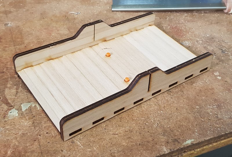

Ended up designing myself a little mitre box with 3d printed spigots to hold a scale template in place. Worked a treat!
Photos to follow in a sec...

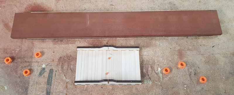

Post by nicco » Sun Aug 02, 2020 8:53 pm
Here are pictures of the mitre box. It worked a treat. Much better than I'd managed to do with any other method I could think of!
The orange rings were spacers to put under the far ends of the board while it was being cut to stop the whole lot over balancing

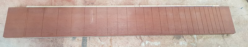

Post by nicco » Sun Aug 02, 2020 11:04 pm
Yeah, thanks Steve, very happy with how that turned out.

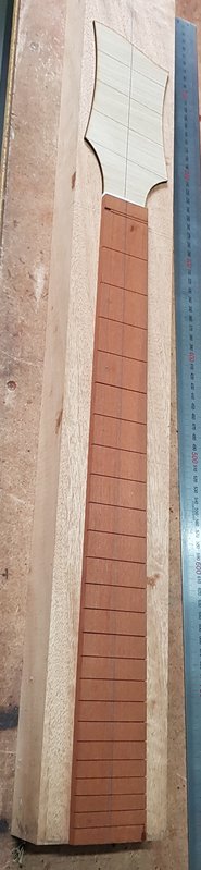

Next step was to thin it the fret board; the blank was a bit over 10mm thick when i started. I realise it would have been more logical to thin it out first, but cutting fret slots had me bluffed, so I figured I might as well cross that bridge first before bothering to go any further.
Then got the taper sorted and the get dot locations marked out.

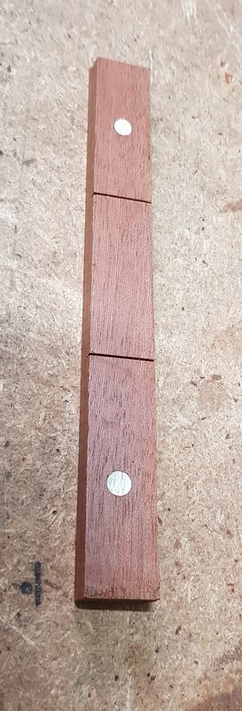

Today I managed to do a couple of test dots; using the laser cutter timber for the dots so I don't need to buy any. Ha ha. The contrast actually worked well, I'm really happy with them.

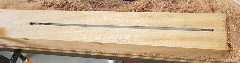

Last step to catch up to the present time was getting the truss rod slot cut into the neck blank.
I'm only getting a couple of hours here and there to work on it, so it'll take a while to get done, but I'm super excited about working on a guitar again!

I have a friend who has offered to do some laser cutting for inlays but I was worried that the burn marks on the edges might be visible.
I can't tell from your photo, which is a good thing, but is there any burning or black outline on your dots after they've been placed and sanded flush?
I use a couple of clamps either side of the blade to hold the fretboard and jig fast to my bench.

Hi Steve,
If you really look at it you can just see a dark ring on the dot, but I hadn't noticed it until you asked. I don't think it's going to be massively obvious under normal circumstances. Light wood on light wood would (how much wood would a wood chuck chuck, lol) probably show it a bit worse, but then you'd have no nice contrast.
Martin, yeah, clamping it would have worked. I ended up just holding it, it moved as one unit anyway

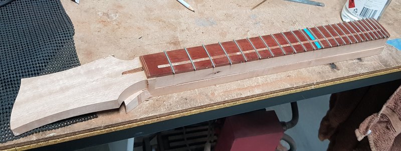

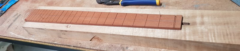

Managed to steal a couple of hours over the weekend for working on the neck. I've now cut and planed (poorly) the front and back of the headstock angle and about 50% through the back of neck cut. Next step is to stop that once before it's right the way through then rough cut the side tapers of the neck.
I've not got any power tools to do these cuts (i could maybe find some appropriate jigsaw blades i spose, but none on hand), so using a normal, bunnings timber saw to do these rough cuts. Slow and steady, but I'll get there eventually.
I've also positioned the fret board on the neck with a couple of 1mm drill bits, which was suggested by this forum last time I had trouble with the fret board moving around while it was clamped.

Making more progress on the neck, got three rough cuts all done, ready to stick the fretboard on them start shaping the neck. Going to play around with a little bit of inlay stuff first though... if I'm going to make it hard for myself, I might as well make it properly hard. 🤣

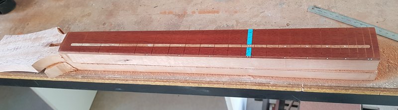

Post by nicco » Wed Sep 02, 2020 9:53 am

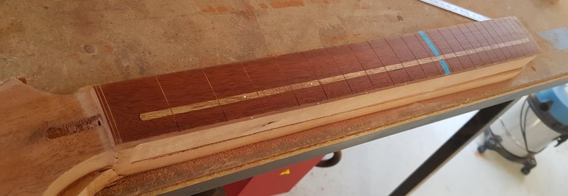

I took a couple of days off work last week to make more progress on the guitar (and, you know, just not be at work too, which was nice. Ha ha)
I ended up deciding that my little timber inlay dots were going to look a little boring, so I went and found some inspiration for something more interesting and made it happen. It was my first time doing any inlay work, so while not perfect, I was very happy with the result. The light, lengthways strip is an off cut from the neck blank, its provided a really nice contrast with the feet board timber.
Unfortunately I didn't do the best job of radiusing the fret board and ended up sanding through one of the blue inlays. I had to dremel it out and go again. Anyway, all fixed now.
So I'm now up to the stage of finishing the fret ends, then I can start shaking the back of the neck which I'm super excited to get to.
