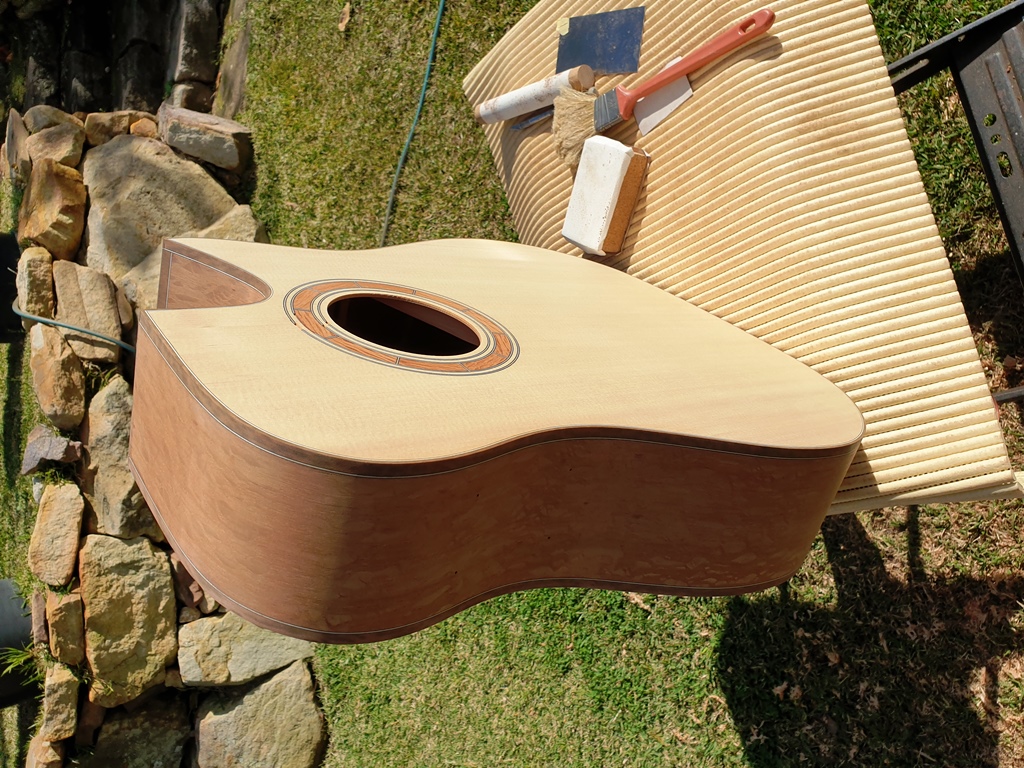

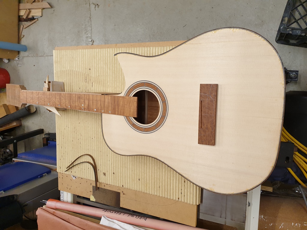

Here's a mock up of where it's at right now, just working on the bindings and getting the neck ready for a dovetail.

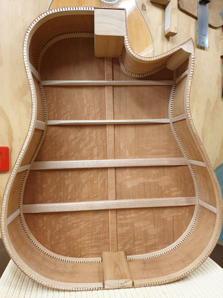

Re: Long time no build
Apologies for dropping photos out of order.

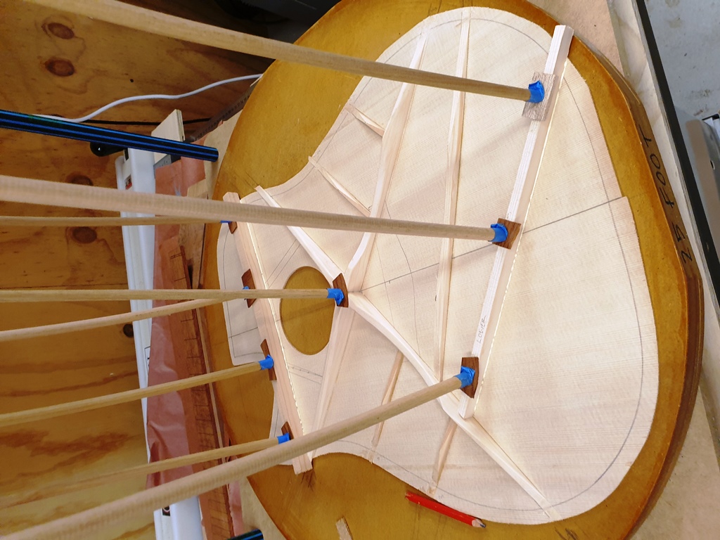

Having spent a few nights browsing the forum and looking at current builds it's obvious I'm about 8 years outta date with my soundboard bracing...
Lots more reading to do it seems.
Nothing wrong with a scalloped X-bracing system! Yes, there are some new ideas around and you might want to try some of them at a later date but what you are doing now looks great. I expect it will produce a really good instrument.

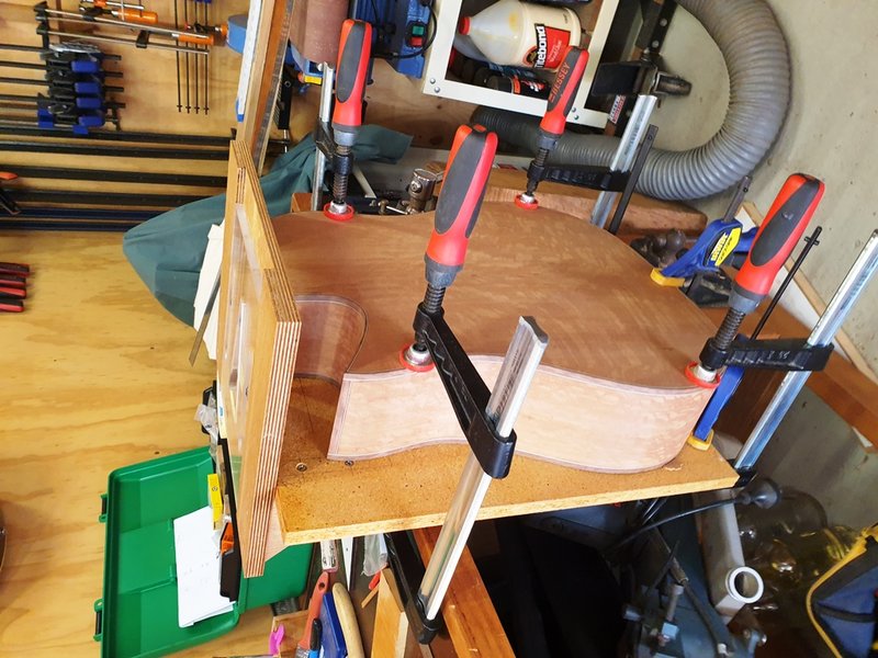

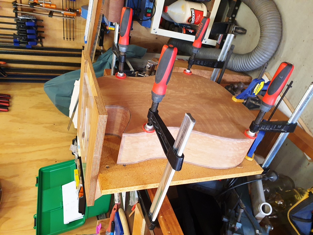

Got the bindings finished off today, I think gluing the bindings is my least favourite part of the build. Didn't turn out too bad this time, I've done worse!
Just a couple of areas where I stuffed it so not a whole lot of fixing up to do.

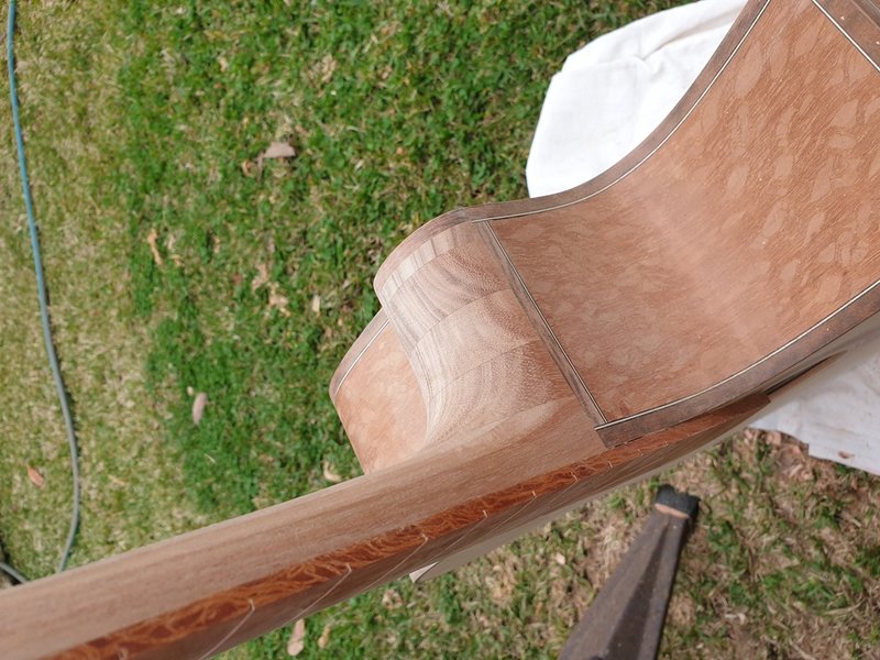

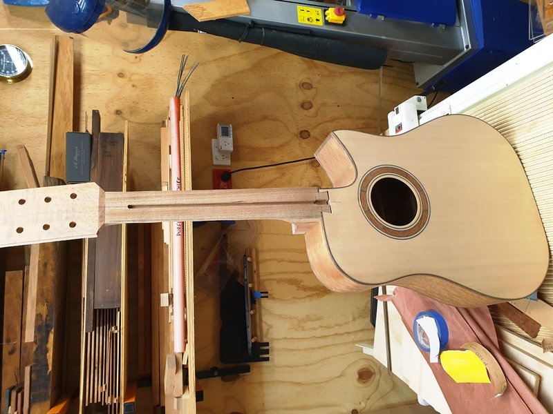

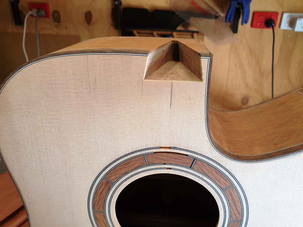

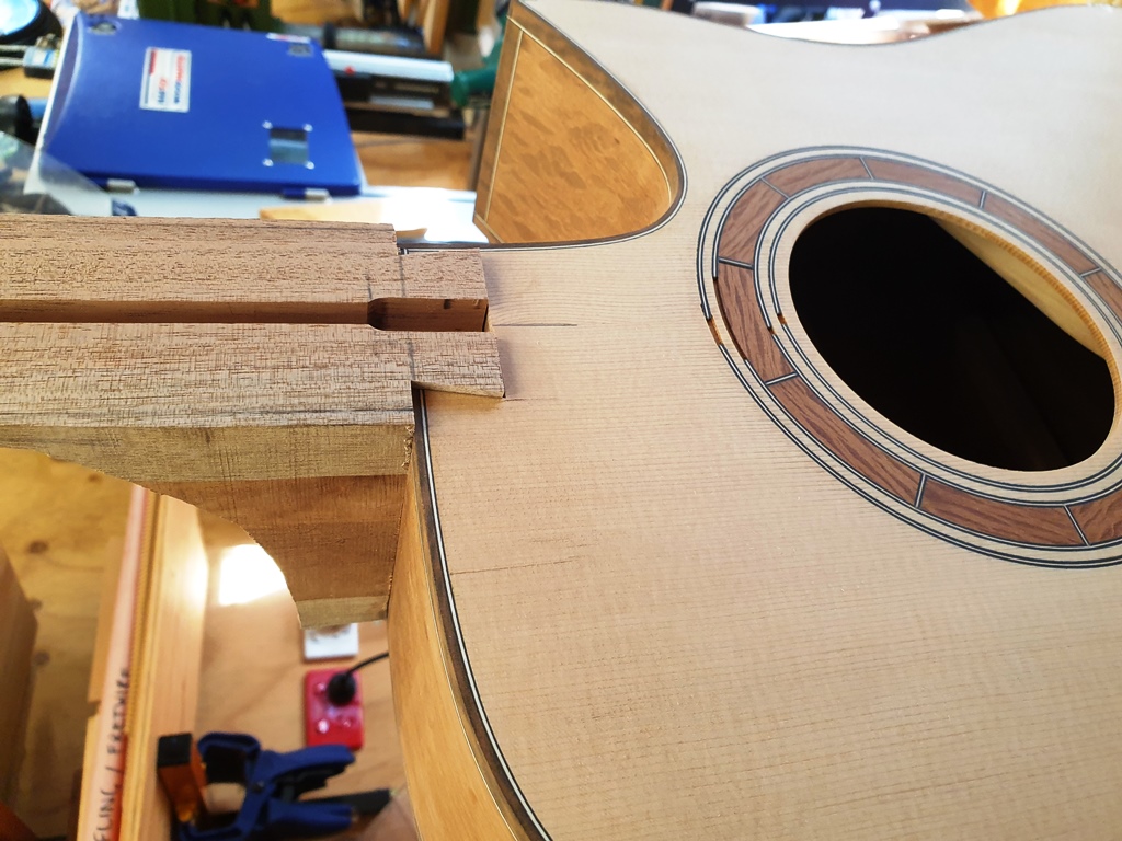

Worked on the dovetail today, the cutaway presented some problems with alignment in the jig but got it mostly sorted out.

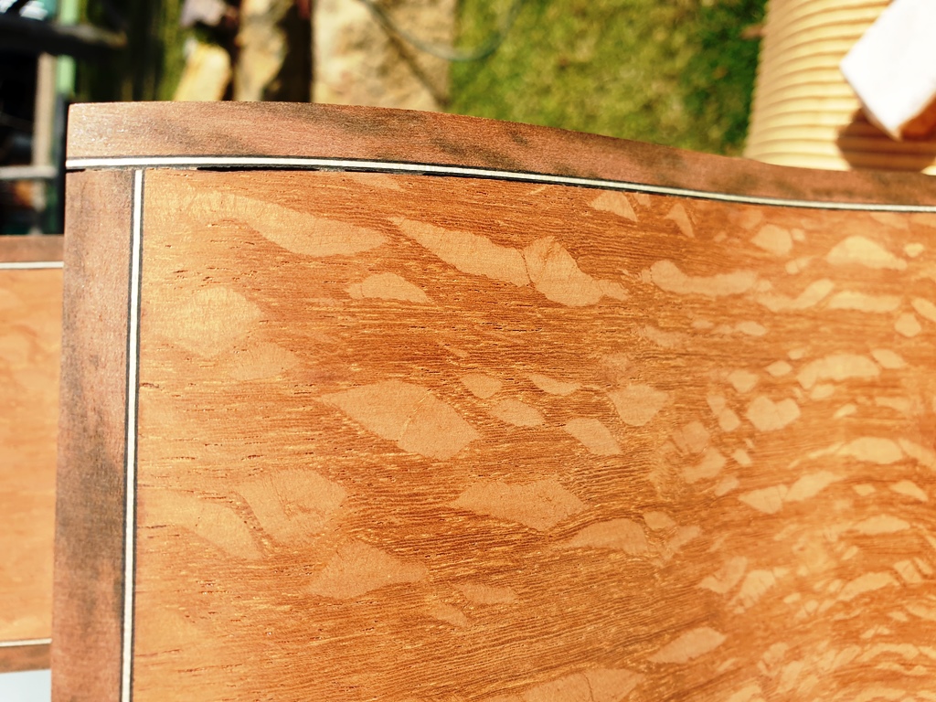

Can see some damage here where the binding tape took a strip of the grain out, then I sanded dark Tiger Myrtle dust into it. Not too worried about it just now, will try clean it up before finishing.
Slowly nibbled down the dovetail tenon with the router till it got close and will finish it off with the chisels.

If you haven't flush scraped your bindings, if you get some heat on that binding either with an old clothes iron (pro-tip, don't use the house iron!) or the bending iron you maybe able to clamp them into place
I was very lucky Mark in that I tooled up for guitar building when our dollar was worth more than the US dollar. I've been woodworking for a long time but the specific tools and jigs make it a much easier process. I just made my first Stewmac order since 2010 last night and paid almost double for the same tuning machines I bought back then.
Thanks for the idea on fixing the bindings Trent, would definitely have given that a go but I've already trimmed them off so it's no longer an option. I think I'll just have to fill it with tinted epoxy.
I spent the day getting the neck lateral alignment sorted out and the dovetail fitting nicely. Didn't get a photo but the final neck angle to the soundboard face (not sure what it's called) is much shallower than it should be. I know how to fix it with the dovetail but it'll be a right pain the arse to do so I'm thinking I might get away with a thinner bridge and very low saddle. Probably should have done a bolt-on neck...

The best way to fill those gaps is to raise a bit of sawdust from your back or sides and pack it into the gaps, then wick in some CA glue. Overfill it a bit and then sand flat. The gaps will completely disappear.
That sounds like a pretty good idea, I'll give that a go.

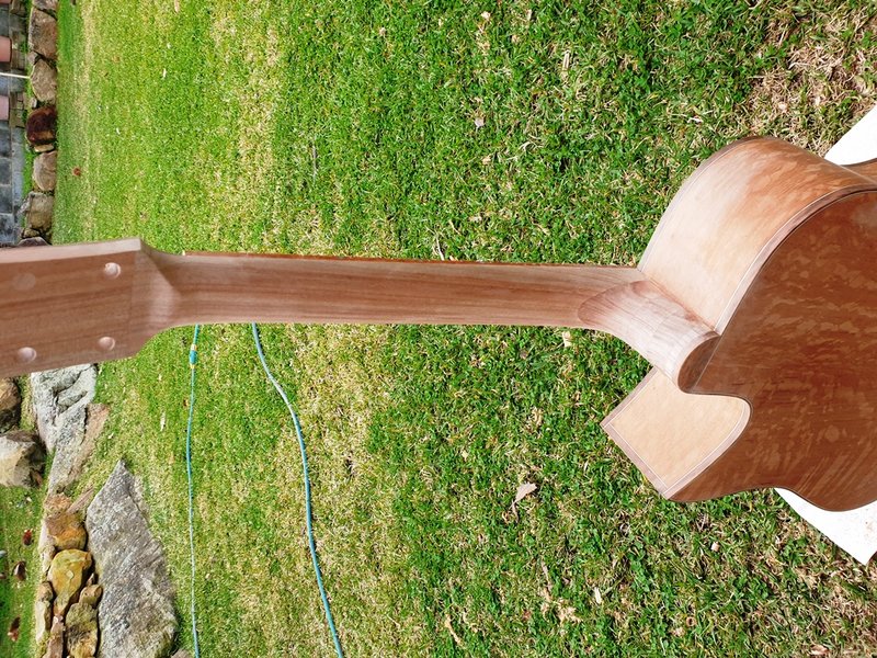

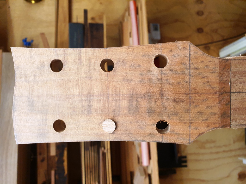

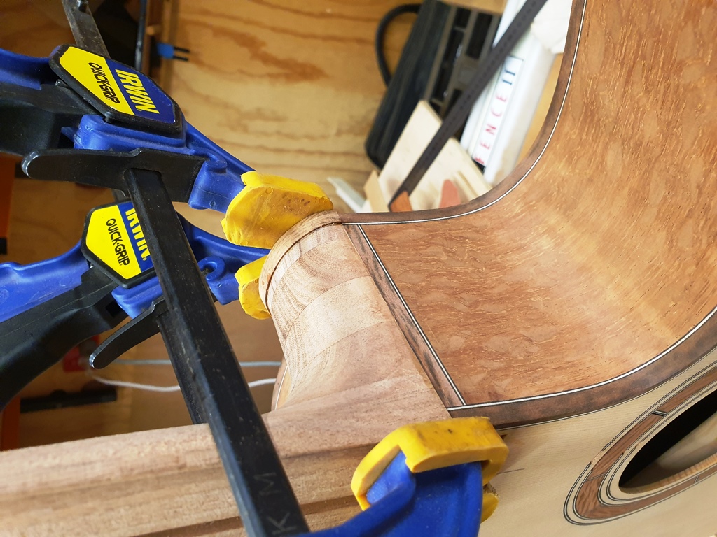

Spent a couple of days working on the dovetail and got it somewhere close to where it should be. I've glued it up and I think that will be the last dovetail neck I do so it's time to get stuck into the bolt-on neck research.
A heel cap of Tiger Myrtle is glued on and a tuner hole was plugged. I didn't think it was too far out at first and figured I could live with it but after looking at it for a while decided the 3 minutes work to plug it up and re-drill was probably worth it in the end.
Shaped up the fretboard end and hopefully get it glued up tomorrow.

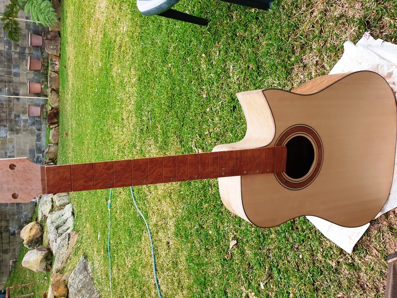

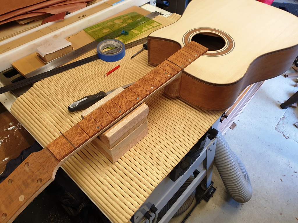

Got the fretboard glued on and the neck shaped up. Still a few areas to work on but it's fairly close to final shape now.

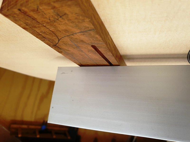

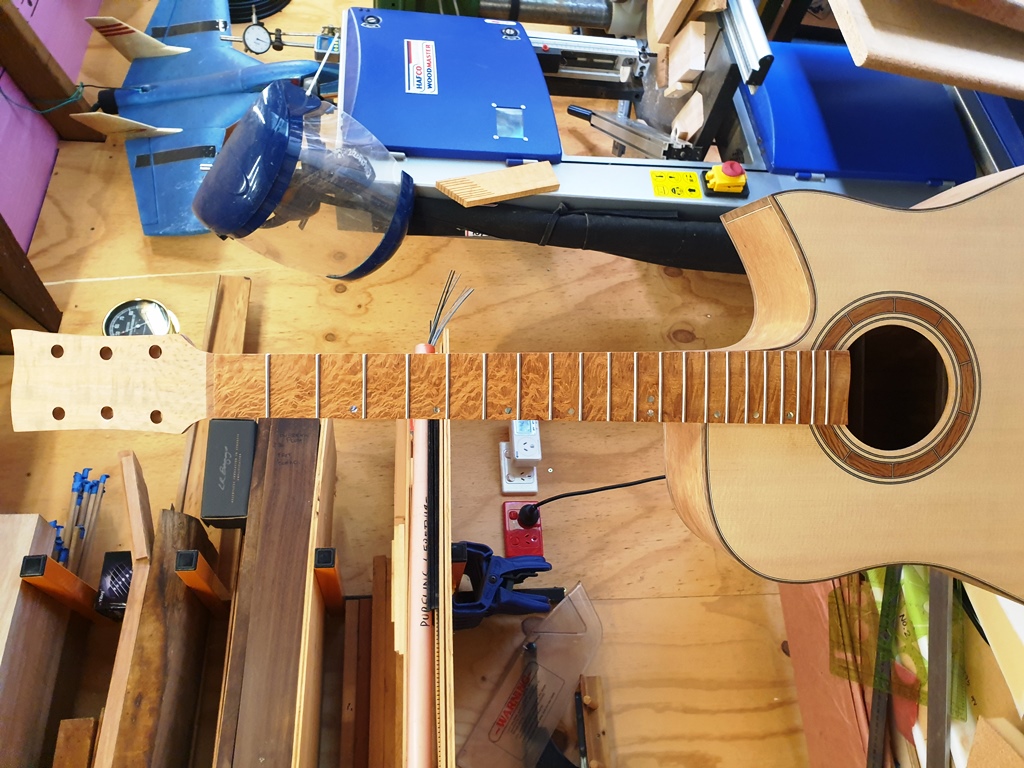

Fretted up today and might have a bit of a problem. The frets felt sort of loose when I was filing off the ends in that I could feel them vibrating when the file ran over them, I don't remember that from last time. I also noticed that a couple of the ends were not holding down in the slots and might need some more glue?
What's the gauge of the fret tangs and what is the gauge of the saw you used to cut the slots? Do you put a radius into the frets before knocking them in? if the ends of the frets are popping up then this may be the problem. I have a block of MDF with a radiused top matching my fretboard radius. I lightly hammer a curve into the fret before fitting it into the fretboard.stevemc32 wrote: ↑Mon Aug 03, 2020 8:06 pmFretted up today and might have a bit of a problem. The frets felt sort of loose when I was filing off the ends in that I could feel them vibrating when the file ran over them, I don't remember that from last time. I also noticed that a couple of the ends were not holding down in the slots and might need some more glue?
I think you've nailed it Martin, I just went and measured the tang width on the fretwire I used and it was 0.4mm where the saw (and my usual fretwire) is 0.6mm.
I'm guessing they've all got to come out, which is a real pain as the Sheoak suffered some damage when I took the two out I was using for neck angle checks.
