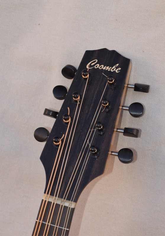

That sounds familiar, although the reasons are slightly different. I wanted to get away from shell so I could avoid the paperwork involved when sending to the USA. I looked at decals and tried a couple but they really did not work. Maybe there is something that works but I could not find it. I went down the CNC route. Bought a small Chinese CNC and my name on the headstock is now in wood. It was not an easy road, the Chinese CNC was a pain to get working properly. Problems with one controller not assembled properly so did not work, slippage, problems with the junk spindle and so on. I spent a lot of time fixing all the problems and modified it to take a Dremel, and that works, but I need to use a really small bit so it cuts slow so as not to break the bit. Broke a few bits before I got it working properly. Next was buying the software and getting that to do what I needed. Spent a lot of time on that as well. Once I got it working I cut a number of inlays and it has already paid for itself, although maybe not for the time sorting out the problems. A more robust CNC with a decent spindle may be on the shopping list for the future, but I am still going through the inlays I made in the first run.
Here is the end result, the wood is European Maple. I actually like it more than the shell which is getting to be expensive.

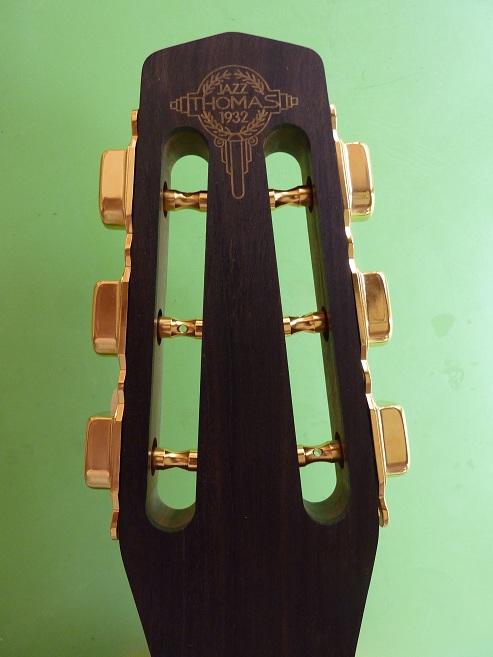

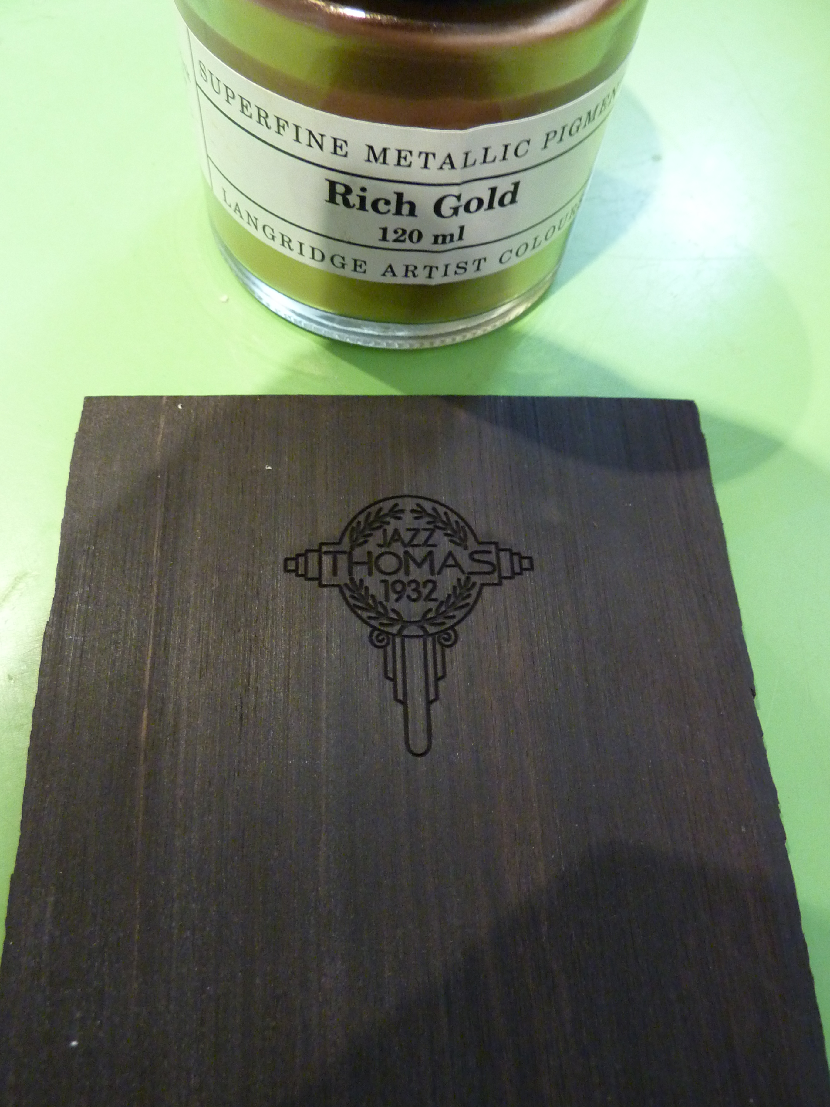

I have used the laser engraving method that Blackalex refers to. I copied the design file onto a memory stick, took it together with a few ebony headplate veneers to a local trophy engraver, and he had them ready to collect in a couple of days. It was a few years ago, but I think it cost me less than $10 each. I then filled the engraving with a powder pigmented West Systems epoxy mix. It worked fine.

Nice and clean

Mike Thomas, I found the el cheapo nail polish gave a better result than the pigment which I tried first.The gold nail polish is shinier! Cheaper too! Cheers! Ross

Didn't shrink Mike, but my method is to give several light coats of polish with about a week to off gas. I used Chemist Warehouse nail polish, and I'm pretty sure that it's nitrocellulose anyway. If it's not, it has been fine. The first guitar I used it on was in 2015 and it's still ok. I tried the pigment you suggested at the time ...it was difficult to source and was both expensive and not as bright. I got the idea from an electric guitar builder in Melbourne who said that it was his girlfriend's idea! I grain fill with layers of shellac on the headstock veneer first, then I fill the laser cutting with nail polish followed by levelling with sandpaper prior to spraying nitrocellulose. It's important to clean the excess carbon left in the engraving process with a pin first. I've also used red nail polish on bluegum, maple or other light coloured woods. Lots of colours available, including black.
