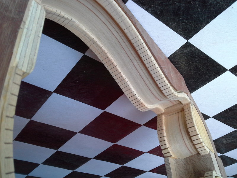

I've had this idea for an acoustic for quite some time now,
Decided to finally build it.

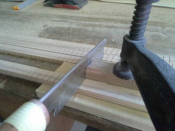

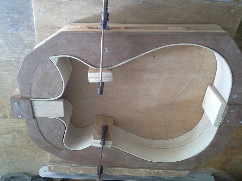

Camphor Laurel sides have been bent on a bending iron and top / bottom blocks installed.
Bunya pine linings, I don't use circular spinning saws so no other option than to cut it by hand.
I actually prefer to handcut it anyway.
Looks rather nice against the Camphor Laurel sides.
A few photos upside down, lets just say its intentionally arty....

Added a few side supports made from the offcuts of the Silver Quandong top.
Having a look at how the grain matches up on the back and sides.
Making great progress.....

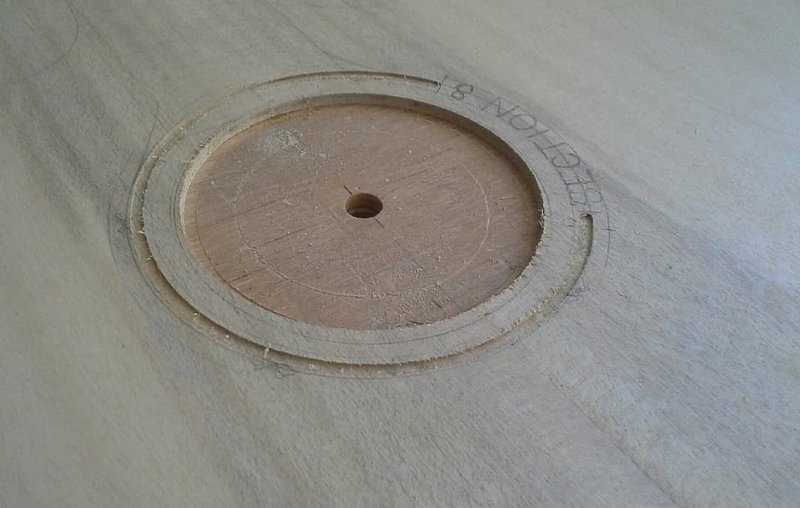

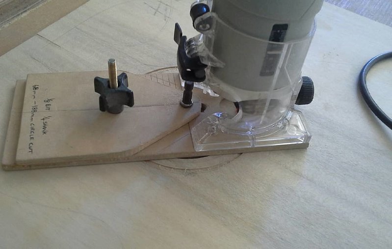

Made myself one of those circle cutting jigs,
Cuts a really nice rosette trench and soundhole.
That laminate trimmer is one of few powered tools I use, mainly binding channels but it comes in handy for jobs like this.

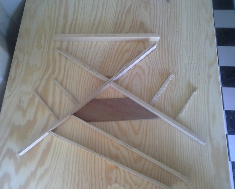

Time to make the tone bars...
KirbyMD
Posts: 39
Joined: Wed Jan 23, 2019 4:23 pm
Location: Dalby, Queensland
Re: Double cutaway acoustic
Post by KirbyMD » Fri Dec 06, 2019 2:55 pm
Okay, tone bars are made.
Handcut and shaped from Bunya Pine.
All internal areas have been sealed.
I guess it's time to close it up.

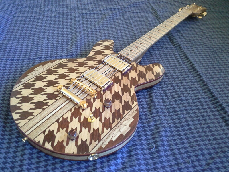

Take our Houndstooth guitar....
All Tasmanian Oak and Jarrah , chambered body.
Thanks for checking it out.
