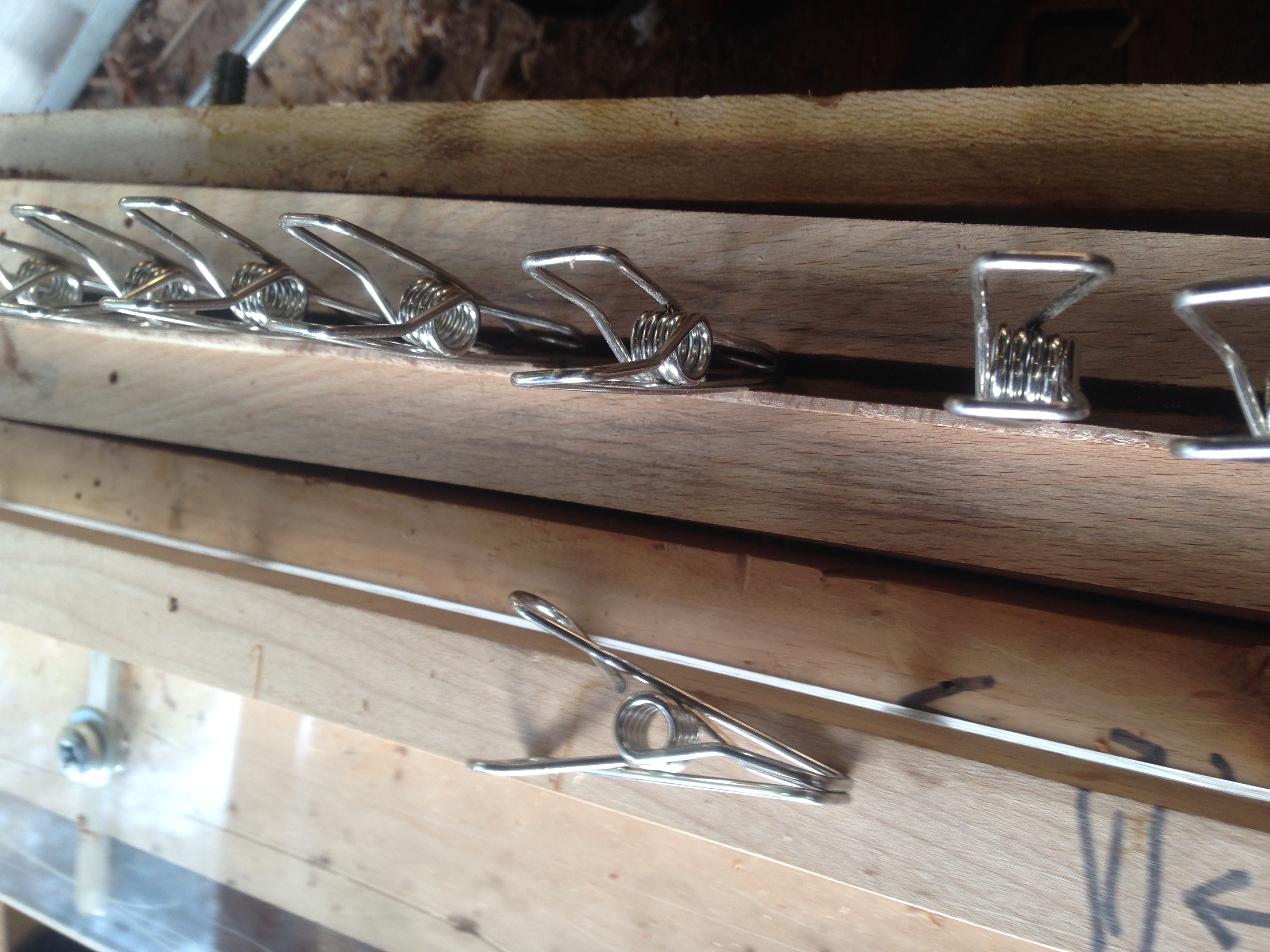

The stainless steel clothes pegs here in the photo are useful for liners if they are modified with a kink in the right spot so that they exert an even pressure for clamping. I just used them upside down ie using the spring pressure to apply an outward force in order to narrow a truss rod channel with a filet of wood prior to re routing. In the pic you can see a pretty rough looking jig which works ok for a job like this. But using the clips to press outward works quite well for this job of clamping the fillet whilst glueing. Cheers! Ross's
