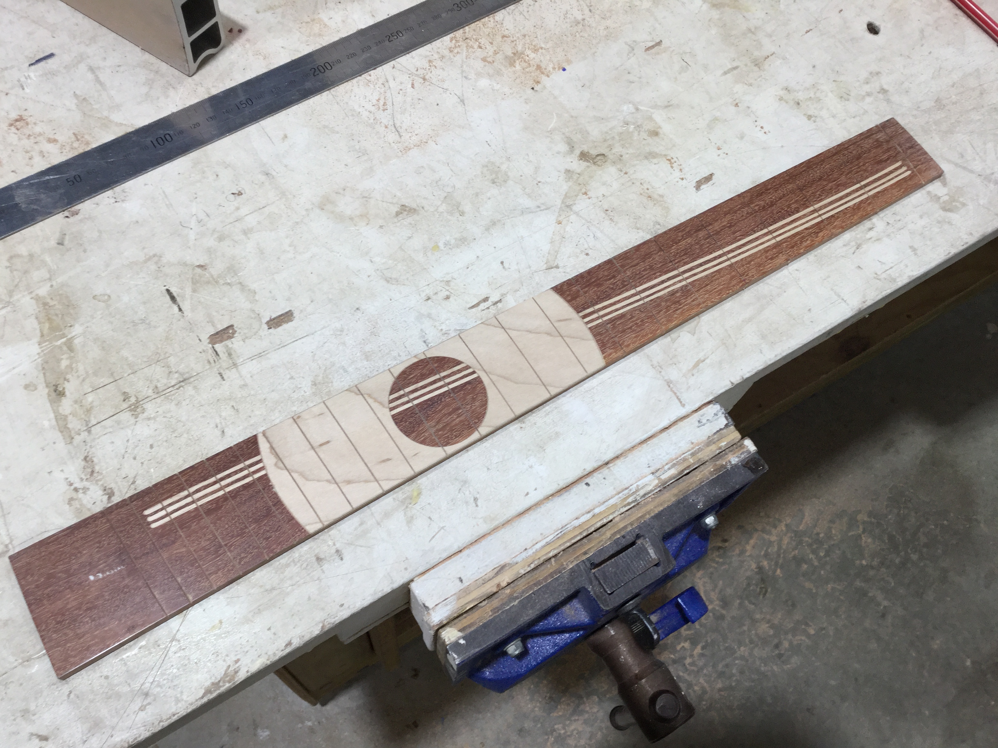

I've recently used just that sort of bit to radius my fret board.
No problems with chipping or chattering, but I went quite small on the increments - so wasn't taking much off per pass.
I still used a radius sanding block to finish though.
My fret board is cook town iron wood with maple inlay.
