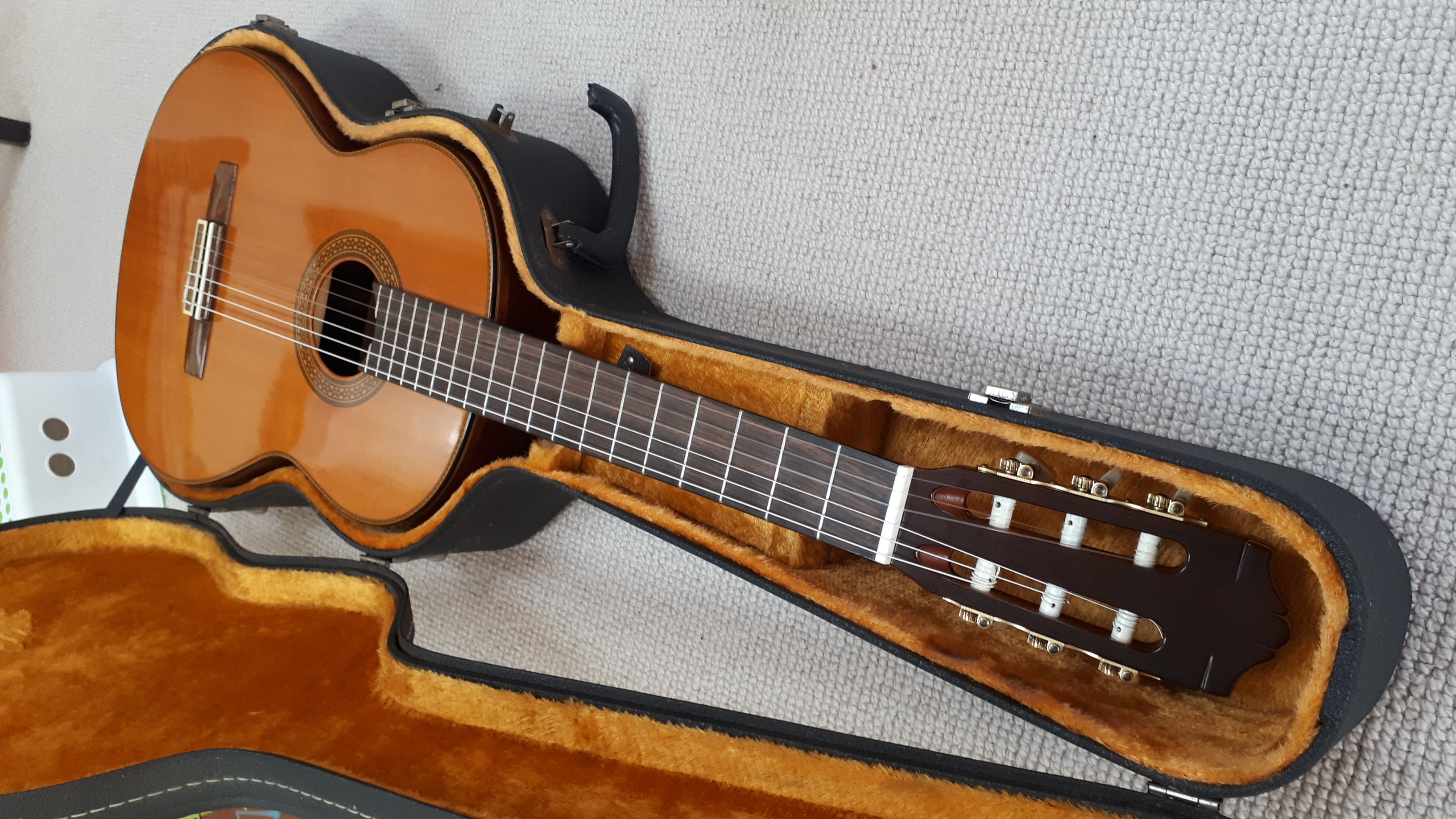

Its easy to get distracted though...found a nice old Yamaha (1983) on trademe and I couldnt resist it. It cleaned up nicely. There's a fair bit of wear on the frets but they're ok. This might replace the one I keep at my guitar teacher's place.

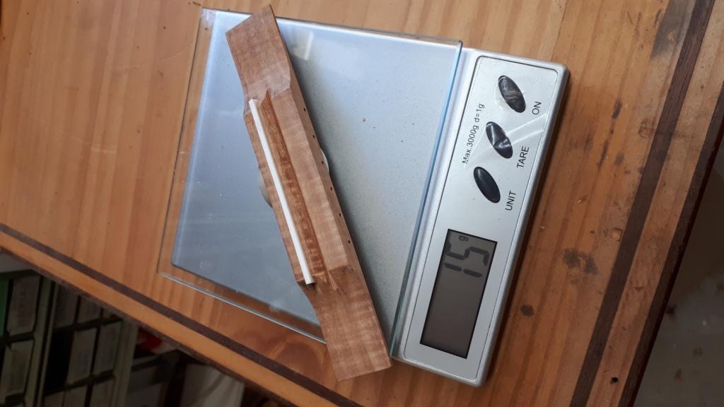

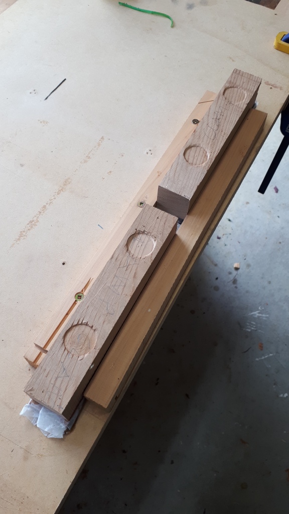

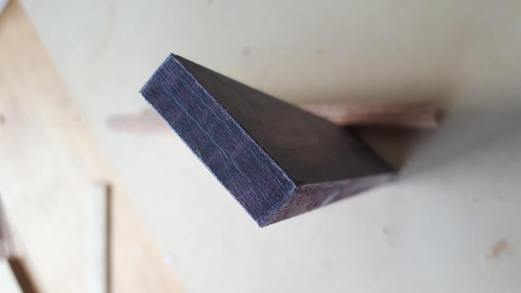

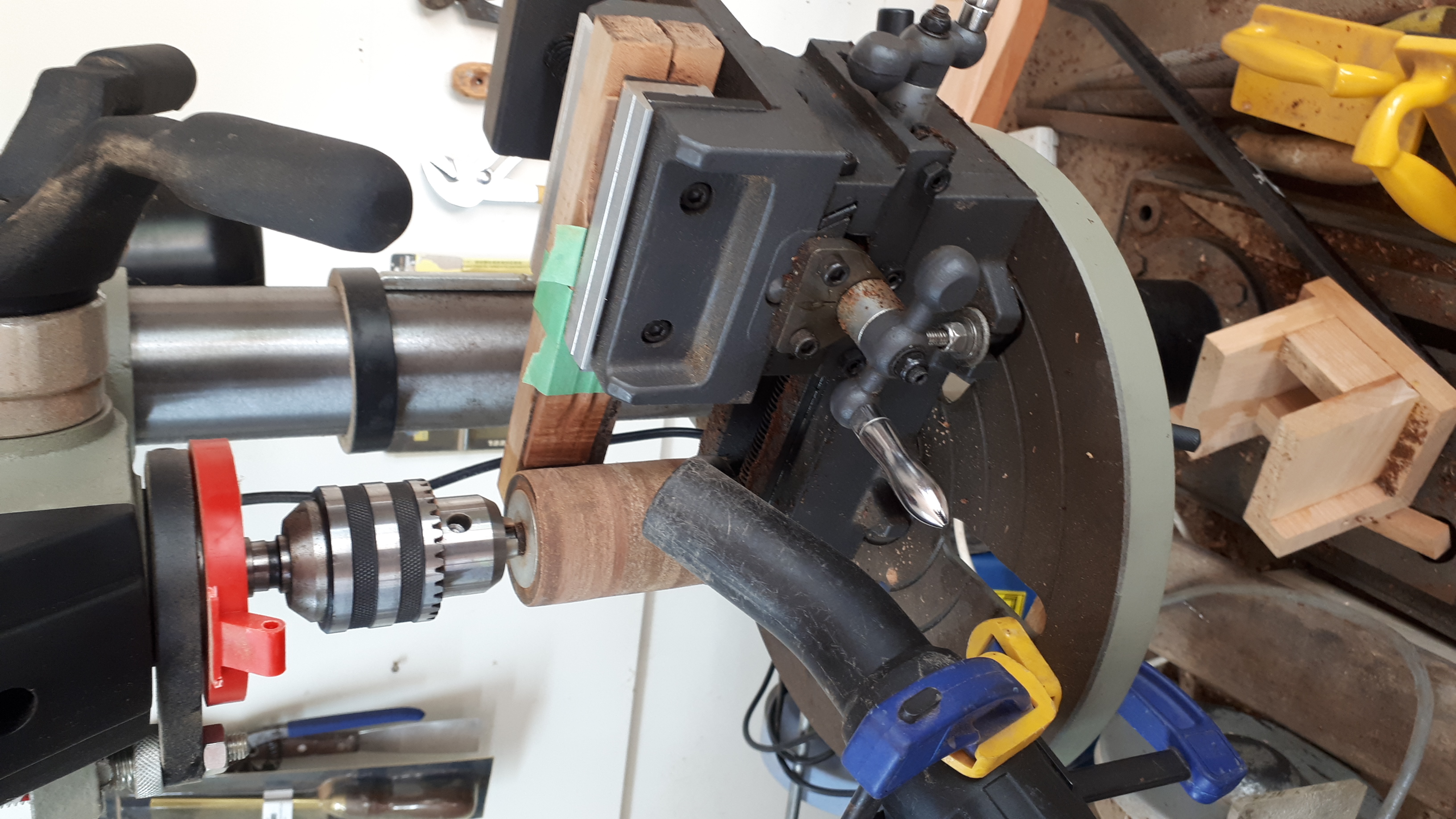

I spent today finishing my "control" bridge, an unreinforced classical bridge at the Gore Gilet dimensions using Tas Blackwood, to see if I could get close to the target weight. This turned out OK.
Apologies for the wonky photos, Ill work out how to fix that one day.

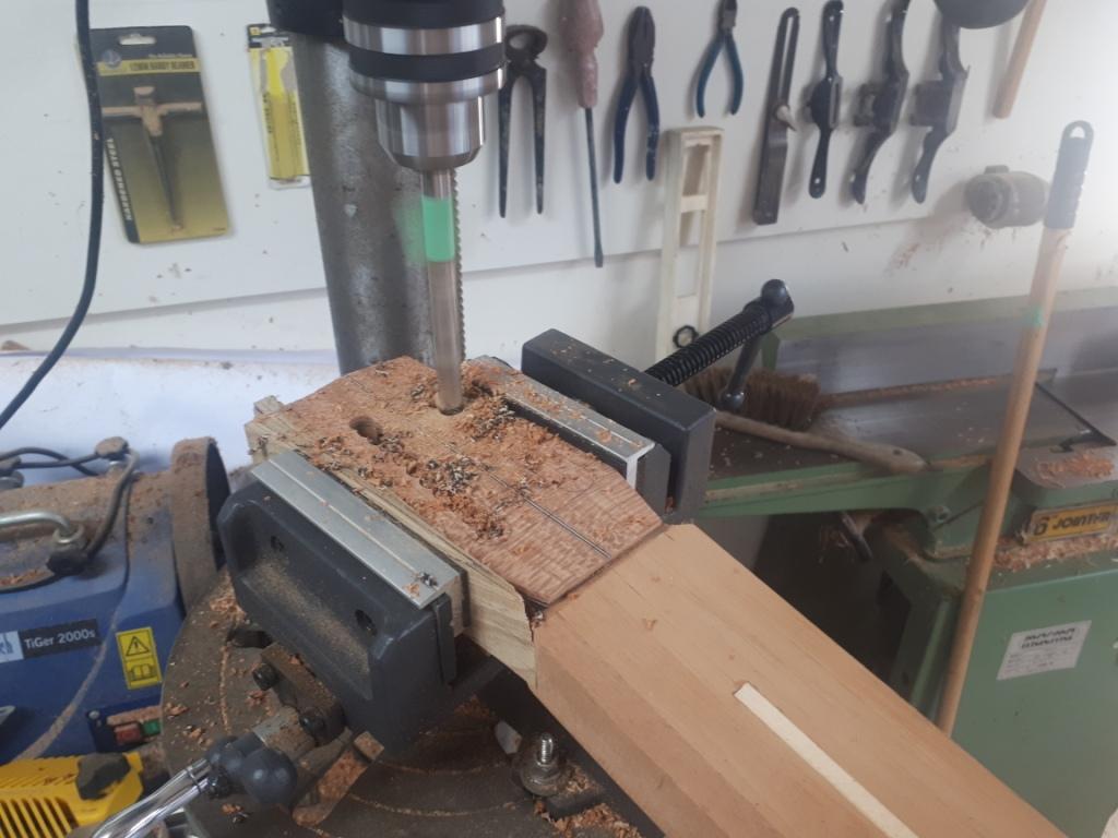

I was going to make up a sanding jig like the luthiers friend ones but realised I could use my compound drill vice to do the same thing, only better.
I also used this to get the string holes as accurate as I could. By using the graduations on the handle, I could move the bridge exactly 11.6mm on a perfect line. Worked well.Apologies for the wonky photos, Ill work out how to fix that one day.

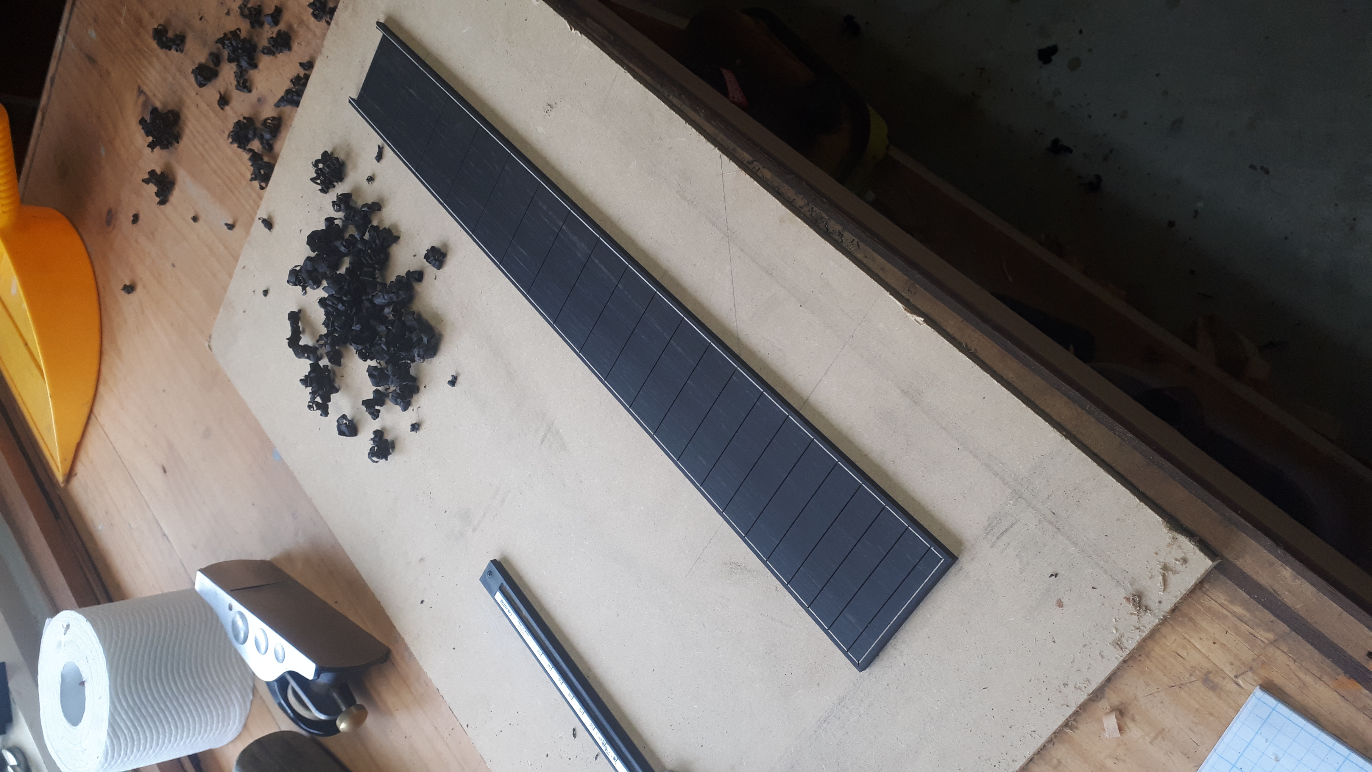

Re: Classical Build (s) - Hopefully falcate!

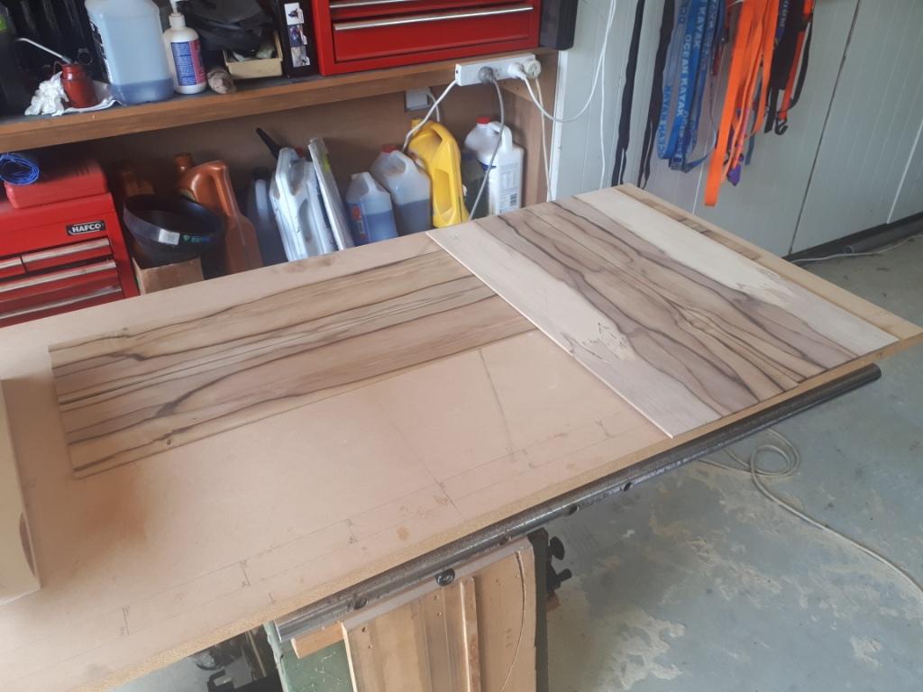

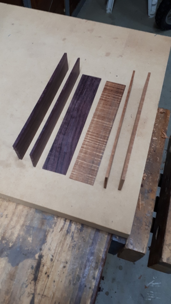

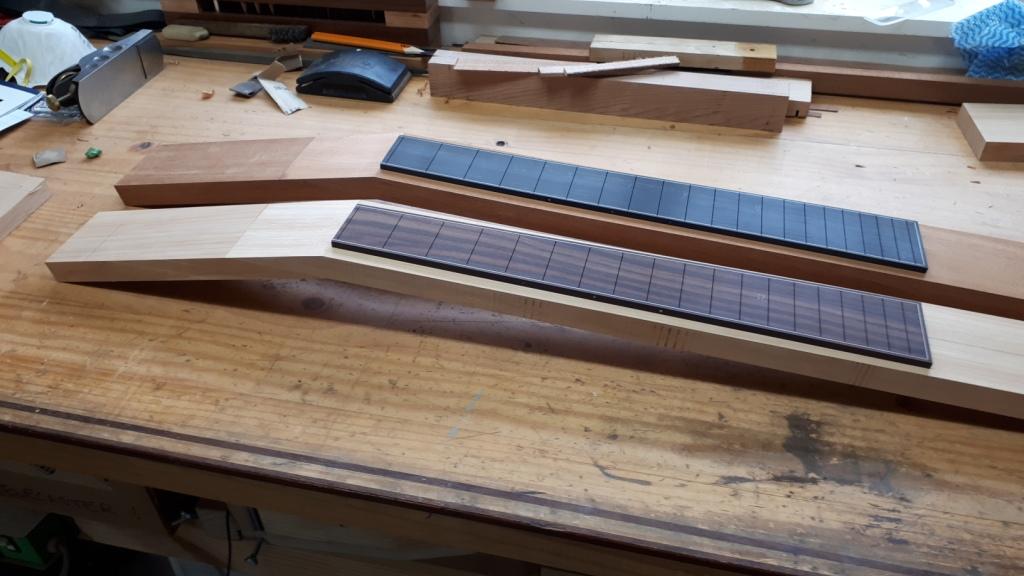

Some progress tonight after all.
Shot of the fret boards on their respective neck blanks. Plies for the bridge blanks. I thought this was going to be a mission but was not hard. On the Rosewood one the fine ply is under 2mm so I won't have to worry about that bridge being too thick I cut the CF tape to size and set up a clamping board so I can keep everything together. Glue up will have to wait until the weekend

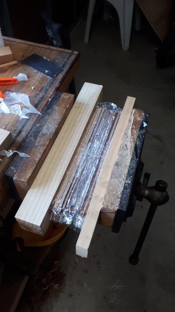

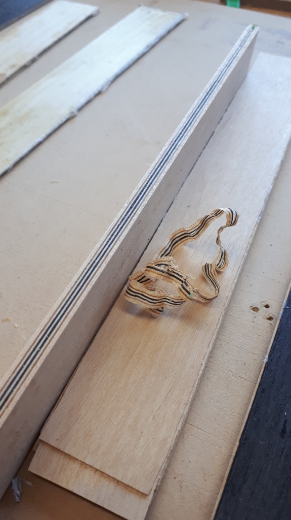

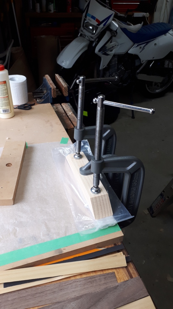

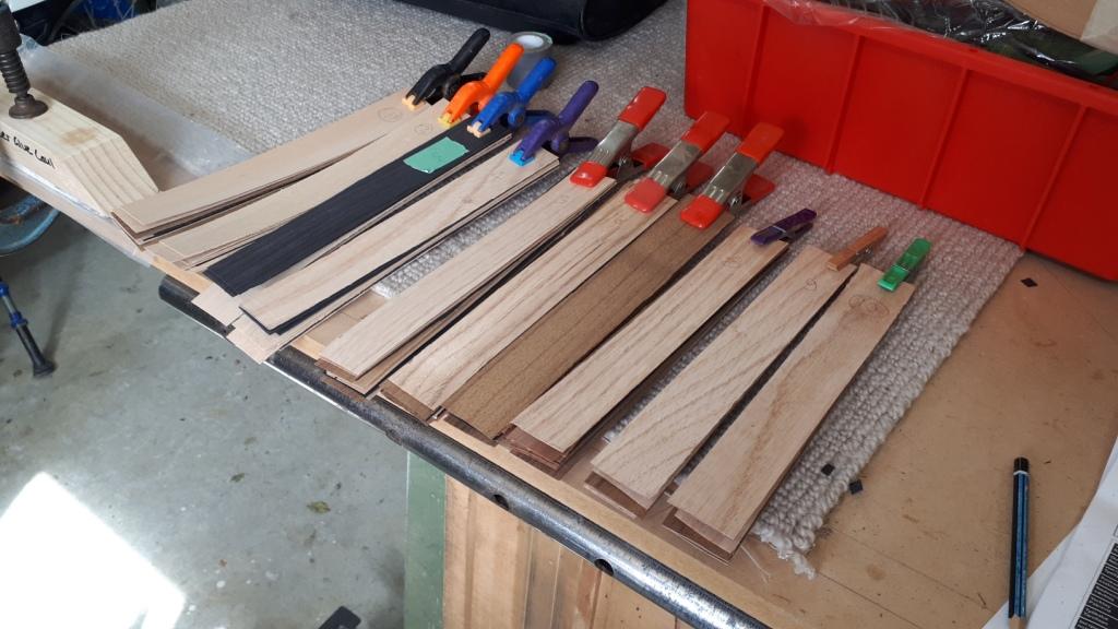

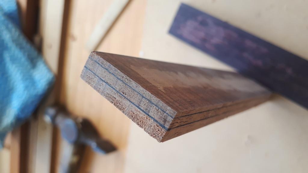

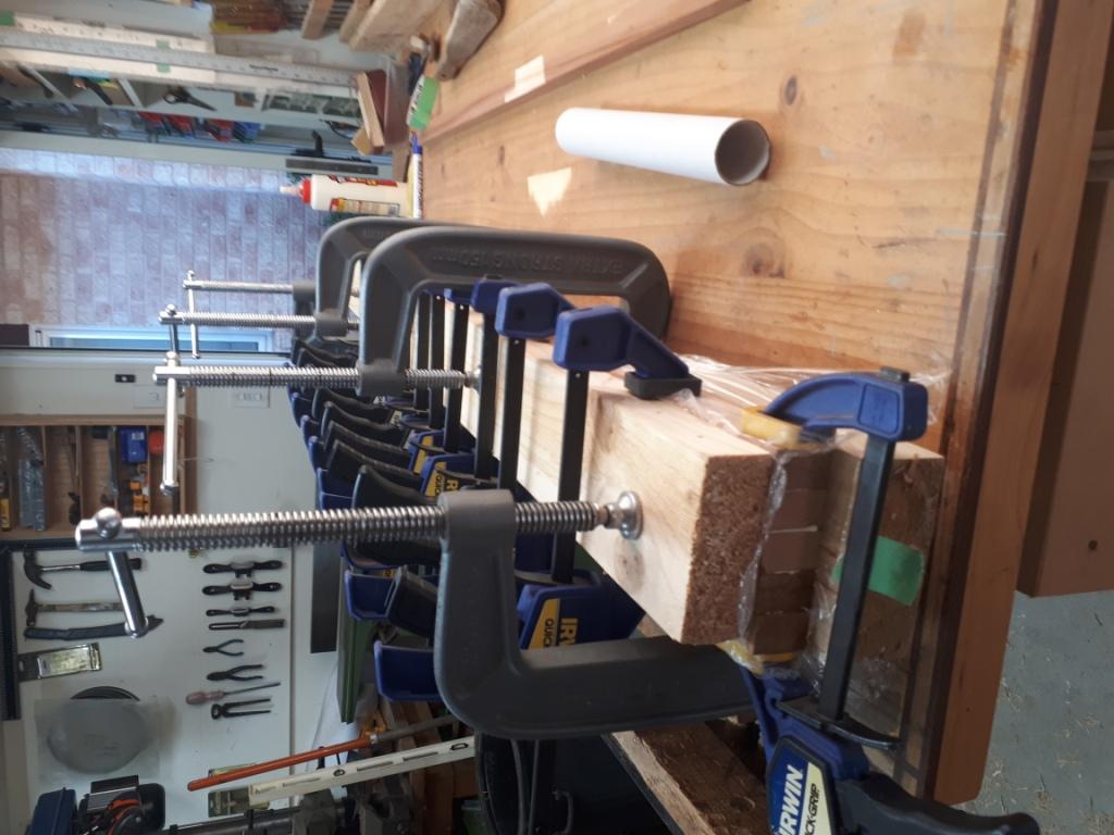

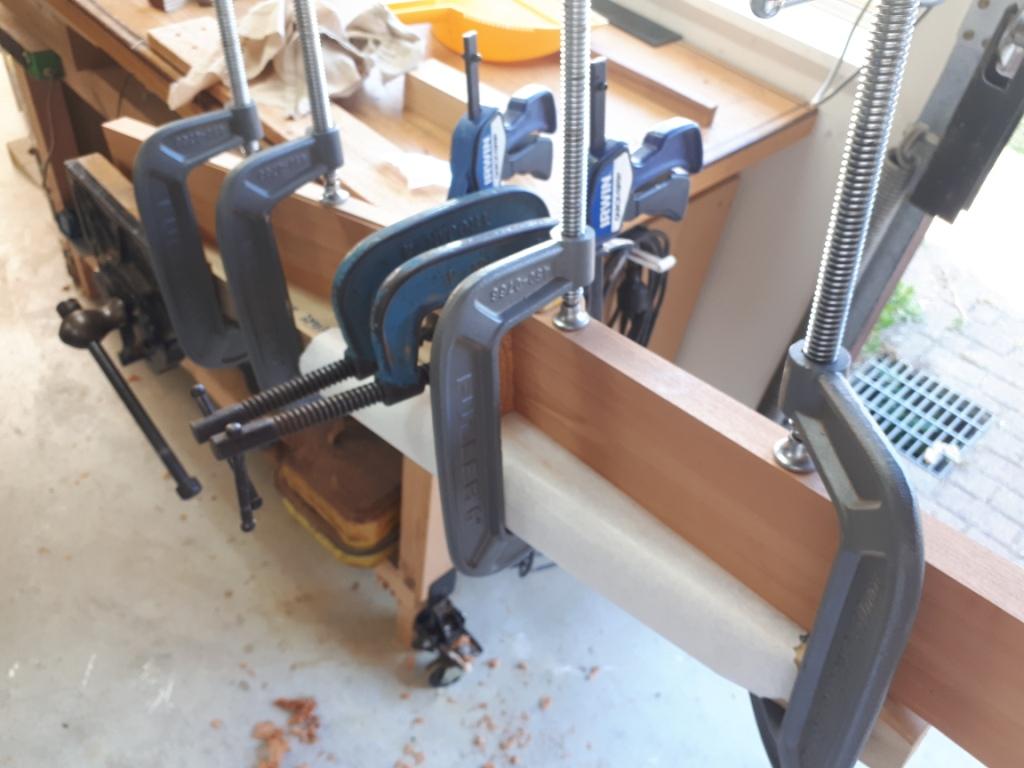

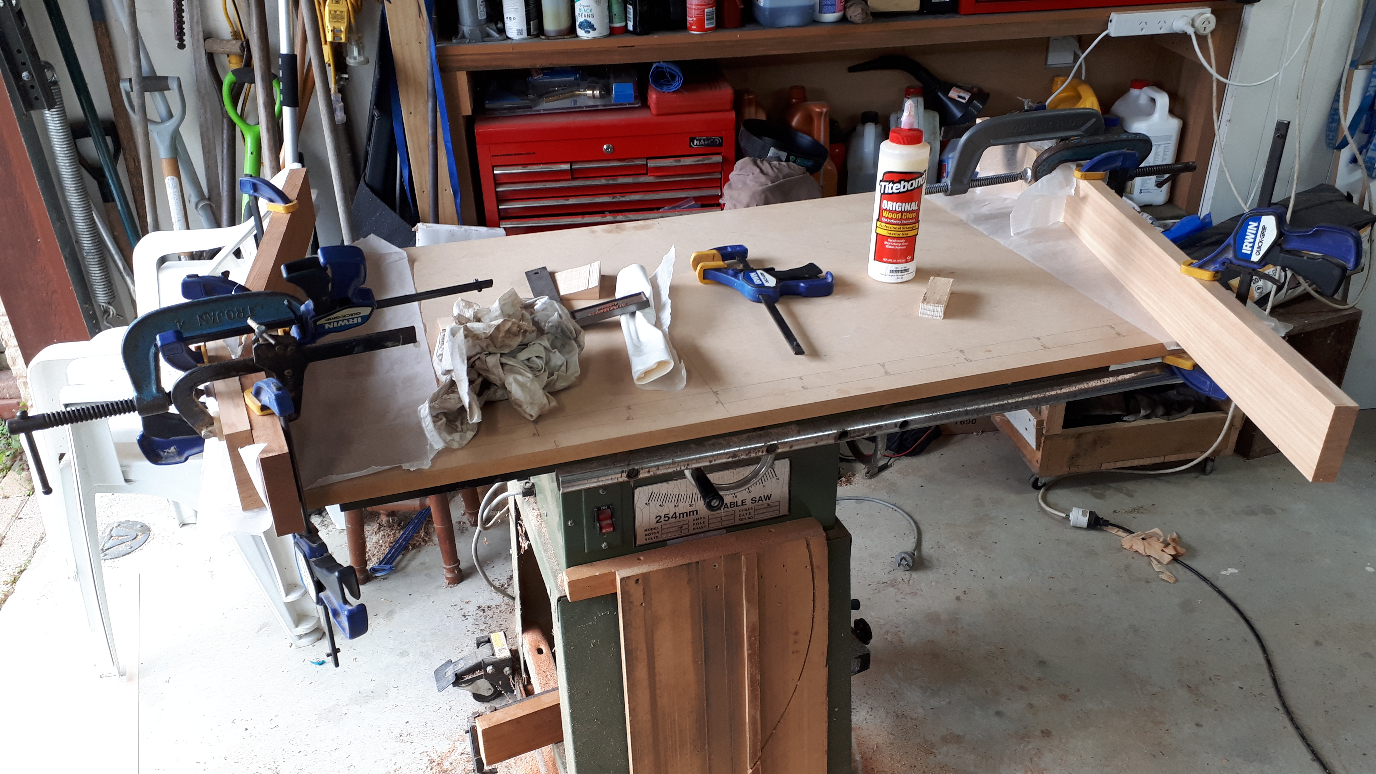

Bridge blanks glued and cured overnight. Cleaned up nicely though I suspect my planes will need a tickle up after cutting the epoxy and fibre.
That should have been enough clamping pressure!! Greaseproof paper worked well, that just peeled off. Rosewood blank Blackwood blank

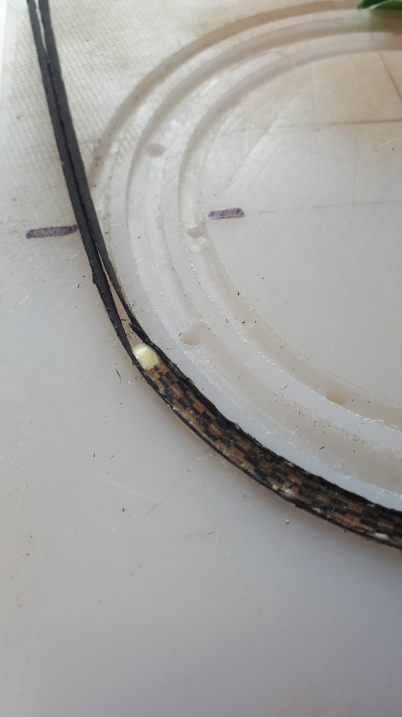

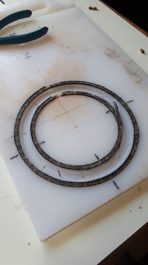

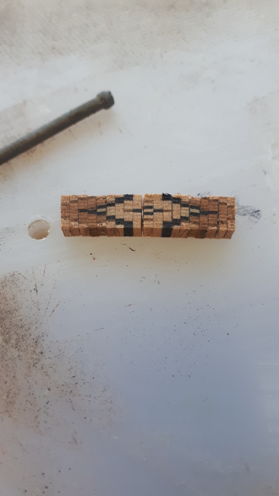

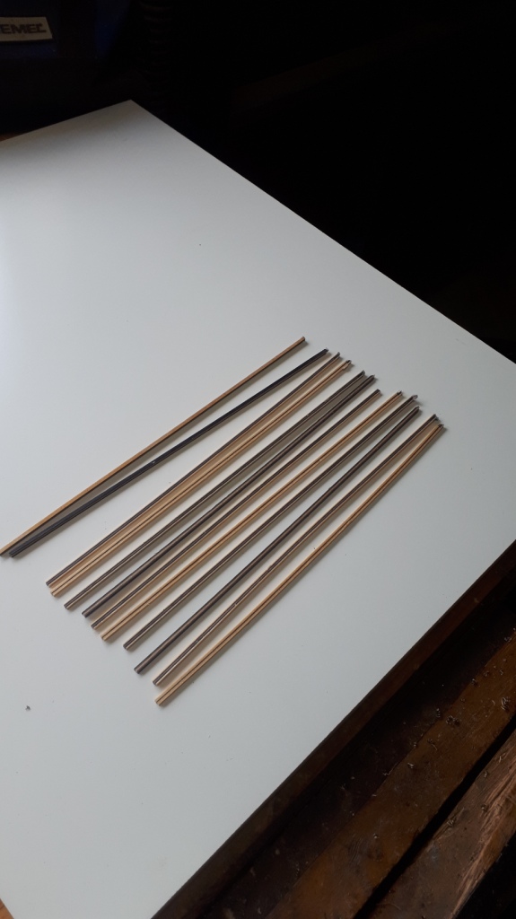

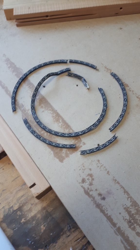

Started making my first rosette....
I learned a few things. One of which is I need to put more holes in the nylon form to push out the finished product.
Another is that those small hand sized Veritas block planes are are incredibly good value for money. That thing is amazing.
I did not learn that bought rosettes are actually fairly cheap if you make any consideration of time involved, because I already knew that. I just wanted to have a go.
After planing, far from perfect. Bugger, but all is not lost. We can rebuild it.

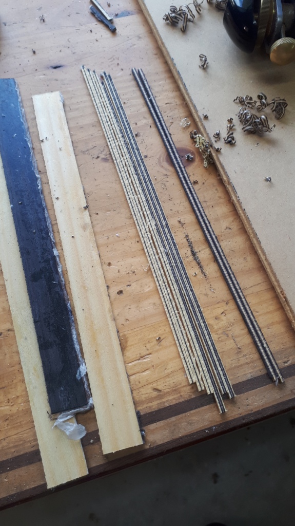

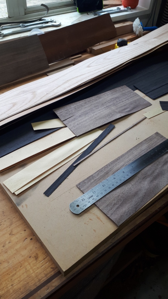

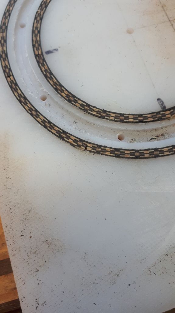

Next the more intricate inner ring. This is as far as I have got. this has taken me around 4 evenings and one solid day. Lots of hand work with the little plane but ultimately very satisfying, when it goes right. and there's an element of fun in doing something you have never attempted before. Just happy I don't have to make a living doing this!!

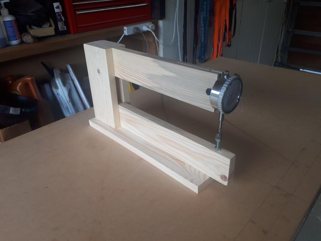

A bit of an update, first having re-read from the beginning, I realise the first paragraph of my first post doesn't actually make sense. What I meant to say was that having started classical lessons, I needed a classical so built one. Having done that, most of my time went into playing and not building. All of which you would maybe have gleaned from what I was saying but, just in case anyone was confused.....
Last post was in November and I have not been doing too much. Of the two under way, I’ve been focusing on the guitar for myself to work through some trial methods. I have sorted out the neck side of the neck body joint, using t bolts, much like Trevor's design but with 4 of them in the neck plane. I will bolt through a plate in the top to secure it. I’m still working on what that assembly will look like.

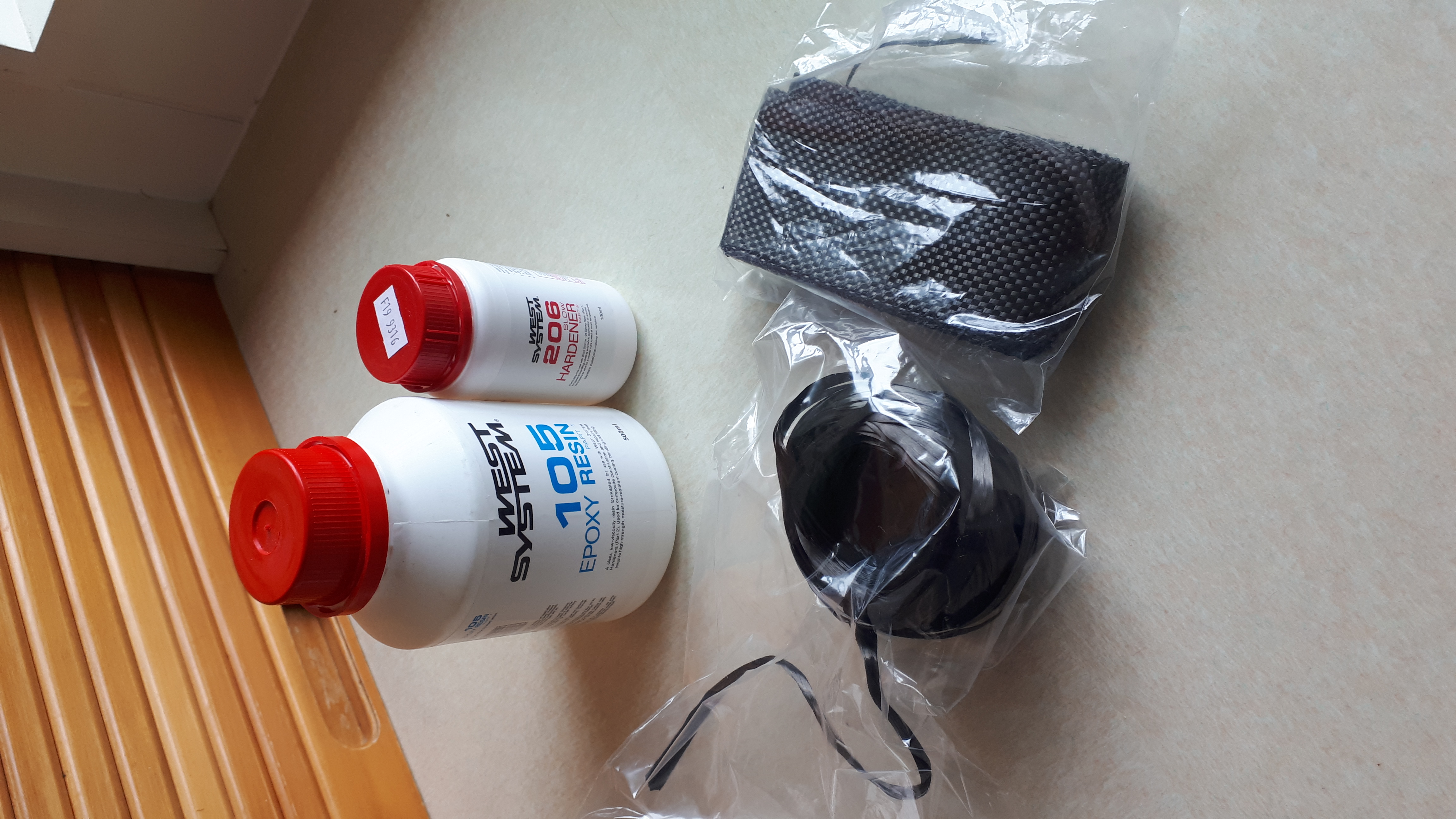

I've routed the neck for a truss rod and will use one of my stock of Allied Lutherie ones, longer form, so I can reach it through the soundhole. I have some short ones that were supposed to be classical ones but I don’t see how you could adjust them unless from the peghead. The neck is a piece of very nicely quartered macrocapa and fret board will be rosewood. I used solid CF bars before to stabilise the neck on my classical and so far so good but I thought I would follow Trevor’s recommendation in case I need to put some relief into it. I do have a very, very minor buzz issue on my current guitar and I'm thinking I need to be able to correct something like that if it happens on these guitars.
I made up a head plate laminate but that warped as it dried and is so stiff it probably won’t flatten onto the headstock so I'm going to reject that, may be just use a rosewood head plate instead. Currently toying with the idea of planetary tuners so I can get straight string pulls but boy those suckers are expensive, if you want better than 4:1 ratio gears, which I do.
While all that's happening of course I am approaching the all important top thickness decision and have been re-reading the gospel according to Trev and reacquainting myself with all those equations and pretending I understand them before flipping to the end and playing with the ones I can actually understand in section 4.5. I built the spreadsheet today and reproduced the right numbers so decided to start tap testing some wood. This feels like significant progress as I have been putting this off until I had been back through the books to refresh my memory.
Of course nothing in life is simple and the whole interpretation of the tap test results on the top blanks is a bit of a puzzle. I’ll get there but will shortly be attempting to pick the collective brain in the Contemporary design thread. I’ve been doing a lot of searches there and there is a wealth of information there, it really is impressive.
Anyway, nothing much to take pictures of just yet but hoping to make some headway over Christmas while I am not on Grandad duty.

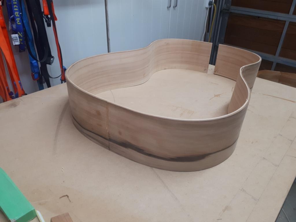

Some progress made over the Christmas break, currently a bit stalled but hoping to get past that soon.
Here's the back and sides prior to bending. BHS ex Mr Spittle. I have bent the sassafras sides, they did not behave them selves. The waist bend did not want to go where it should and it was a real struggle. I made sure I left the iron to warm up for a long time and it was actually too hot as I have some burn marks to deal with. Because I have almost always had trouble with the waist radius I have ended up easing it slightly and its now more or less the same radius as the upper bout, which I never seem to have any trouble bending. I had decided I was was going to laminate the sides, as I havent done that before and that, plus a lot of clamps helped tidy up some of the uneven-ness in the bends. The final shape doesnt actually look a lot different, change is very subtle.
I also made the top linings up, from three pieces of macrocapa (same as I used for the inner laminate), laminated against the sides and the mould. I have tidied them up and they are ready to go in once I sort out what I am doing at the neck joint. I finally got round to making a thickness gauge, I've had the dial gauge sitting on my shelf for a while.

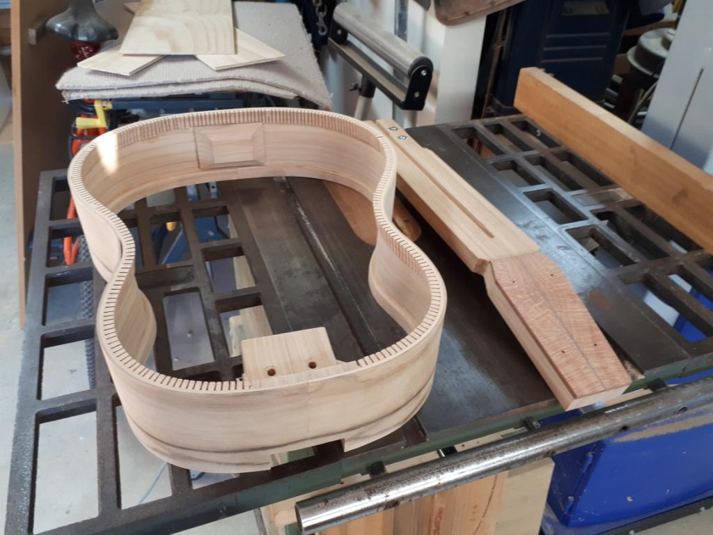

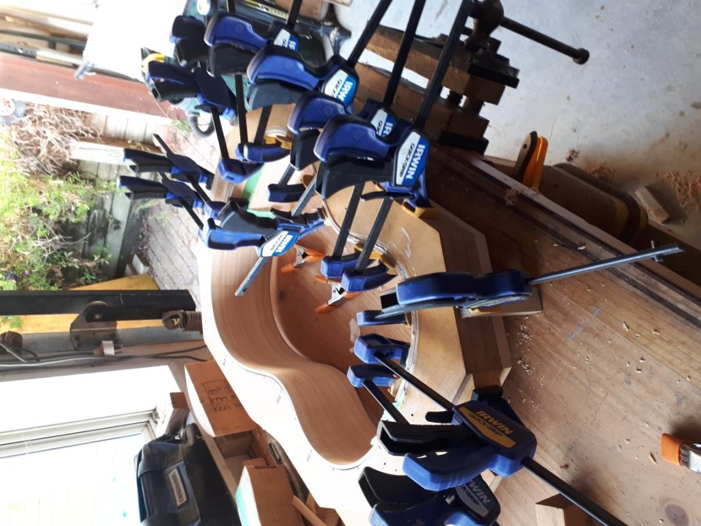

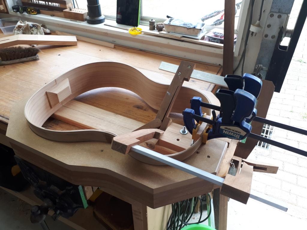

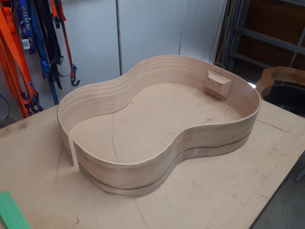

Lots of lockdown progress has been made..

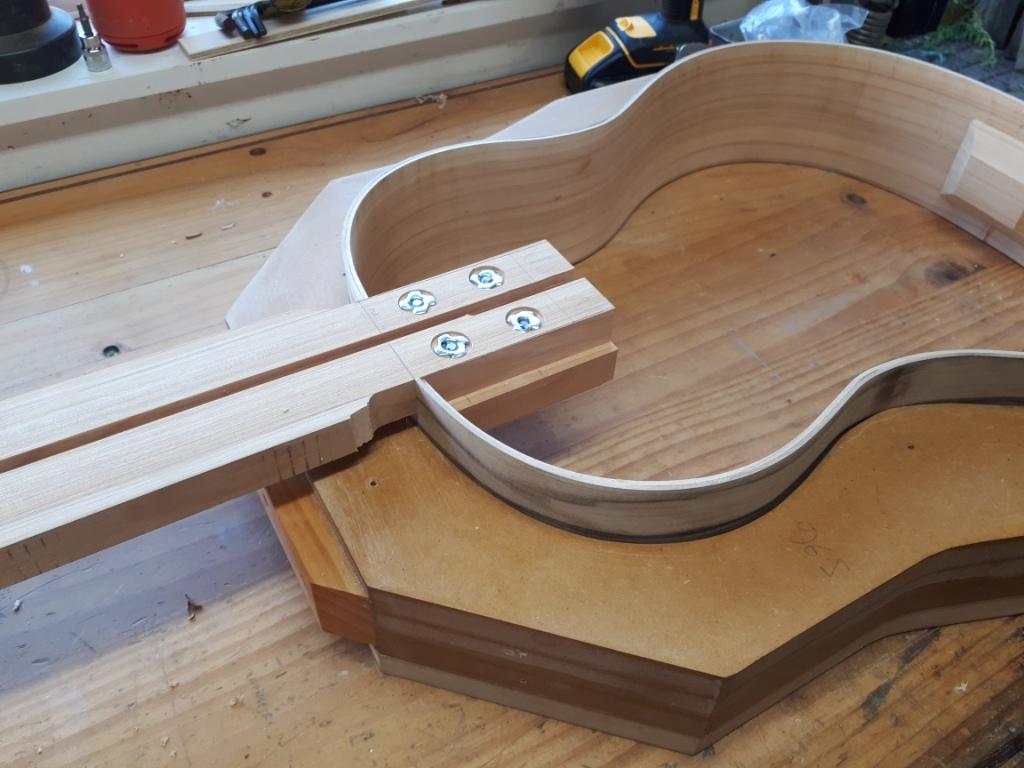

Since my last post I have decided on the neck joint and built it
Glued in the linings for the top
Glued in the kerfing for the back
Put in the side splints and T nuts for added mass if and when required
Started work on the original neck, had a disaster and had to bin it (I blame the router but we all know who stuffed up)

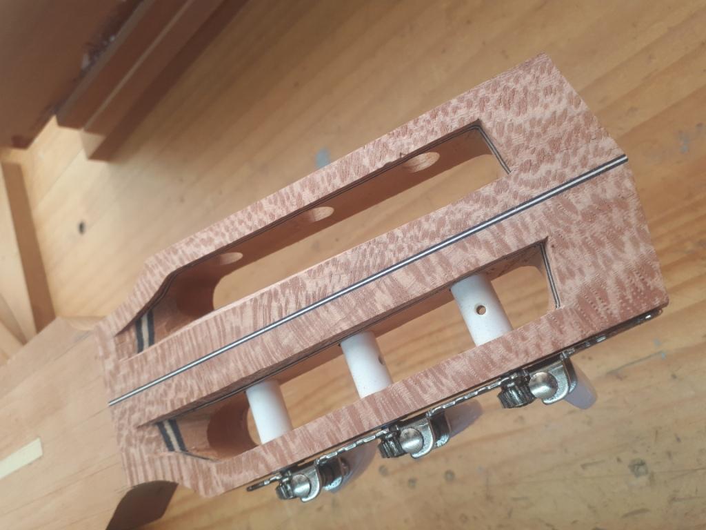

Made a second neck and finished the headstock and body joint. Finishing that is awaiting the later stages of build.
anyway progress shots

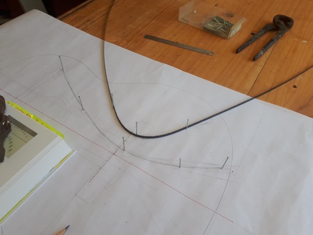

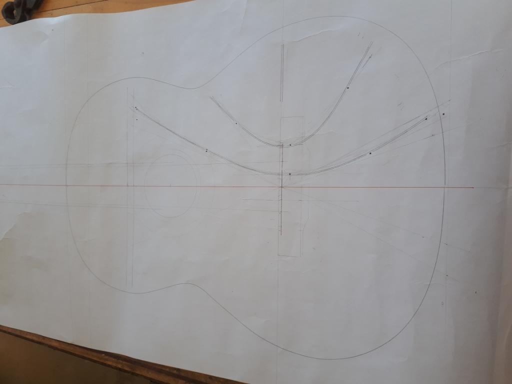

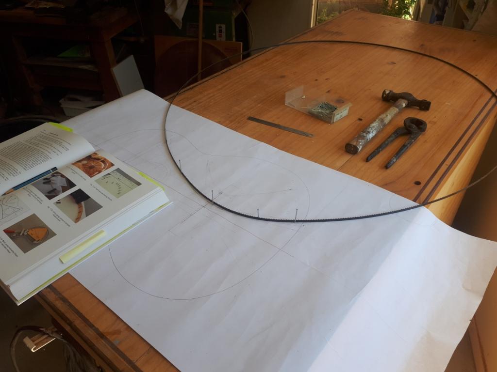

With the rims complete next job is the plates. I want to make sure I have all the braces ready so that once joined, I can brace the plates and get them on to the rims asap. I find the longer they sit around the more they lose their shape. The falcate braces are all new to me so designing those was Job#1 today. I sat and re-read the build book on braces and falcate ones in particular. There are no plans for a falcate classical in the Books but its not going to be radically different to the steel string layout given that all guitars are pretty much the same shape and size.
So following the guidelines at 7.3.2 I had a go at setting out braces. The only thin whippy thing I had to hand was a bandsaw blade so that’s what I used. It all seemed a bit easier than I was expecting but that usually means I have something wrong. I’m hoping that, if those who have built a falcate classical see anything obvious, they will sing out.
I note the book says the braces should divide the lower bout equally but Fig 7.23 shows a wider gap between the primary braces at the heel – is it just a matter of eying it in???? Or have I missed a formula somewhere??
Having set out the curves I made a couple of routing templates. I intend to use these to make a form to glue up the laminates against.
Any comments on the brace layout and location?????? I accept its hard to see from photos.
King Billy Pine bends like butter but check stiffness of the wood before using it for braces. I used KBP on my first falcate build and the stiffness of the braces ended up being too low and I ended up re-topping the guitar with spruce braces. The stiffness of KBP seems to be highly variable. If you've got some KBP and it's stiff then use it....if you don't then use spruce. Three laminate strips works fine. I bend the strips on a bending iron and then glue up on an MDF form using picture frame (strap) clamps to hold the laminates strips together while the epoxy glue is curing.
Your brace design looks ok. The important things are to get roughly equal top areas between the braces and also to pay attention to where the lower bout ends of the primary and secondary braces run relative to the bridge. Secondary braces should run under the wings of the bridge.
Thanks Martin
No I don't have KB pine in NZud. I was thinking of looking for alternatives (as suggested in the book) but think Ill stick with spruce as thats what I have!! I was hoping someone would say they had built with spruce and its fine, so thanks.
As drawn the secondaries run just under the transition section of the bridge. To get the bridges really light I end up with super thin wings, so they wont have much torsional stiffness. Is there a particular reason to not put them under the main part of the bridge?, other than spacing?
