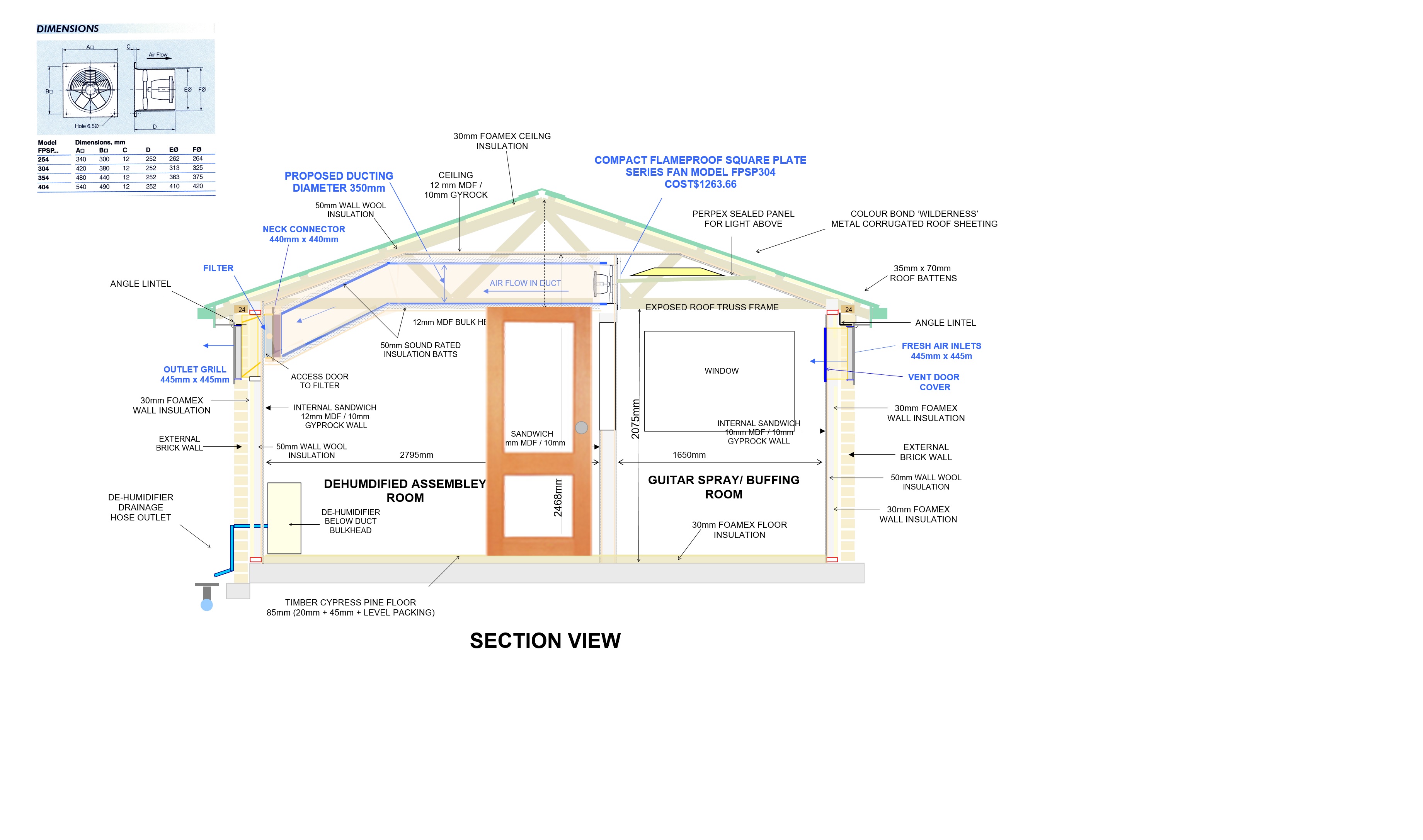

Nigel FYI, not sure whether this appropriate in your location. I insulated my guitar workshop (brick wall with colour bond roof sheeting as follows:
1. Foil skin
2. 30 mm thickness industrial foam sheeting (Very efficient insulator, can be purchased in various thickness, depending on the level of insulation required)
3. 50 mm thick batts
I also wanted to improve the sound rating being close to other residents. This involved including sandwich sheeting: 12 mm MDF board and 12 mm gyprock. This may not apply in your location.
Refer to section view attachment. On my website there is a youtube of my workshop construction from the more drop down link.
