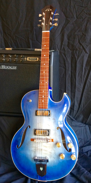

I'm finishing these two up right now in French Polish and it sticks just fine. I am using a dark amber button shellac so it does change the color considerably so that might be something to consider. I think it looks good but you may not. BUt otherwise Shellac sticks to everything well.
Also don't forget to wash coat the bindings first, especially if you are using rosewood back and sides. The rosewood will bleed color into the ivoroid.

awesome thanks for the replies, that archtop looks marvelous! And I love the colour of amber shellac so I'm not to worried about that. your polishing looks great by the way. also how do you go about putting a wash coat on?
