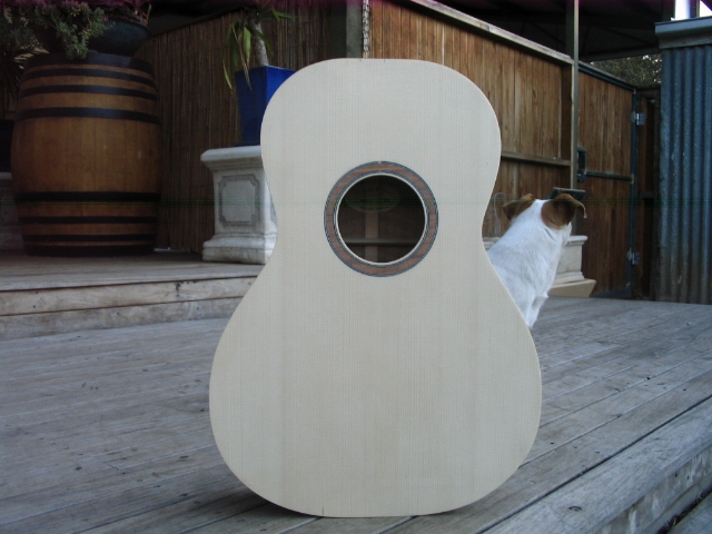

This is where I'm at with a nylon string O-16NY for a bloke here in Geelong whose name happens to be Cook so we've nicknamed the guitar Captain Cook's Classical.

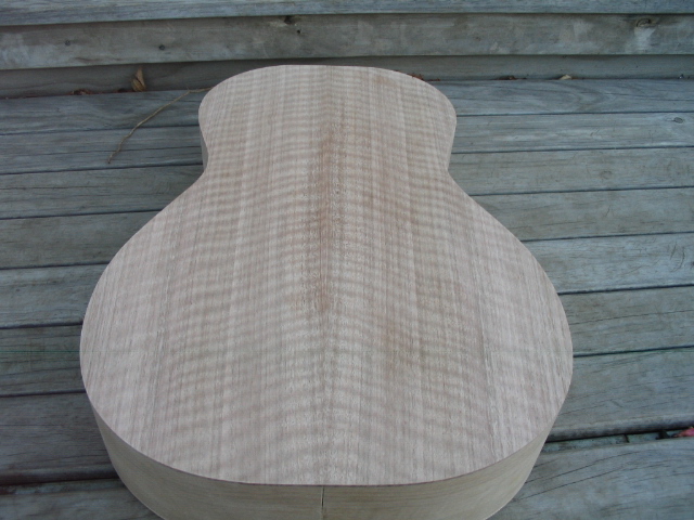

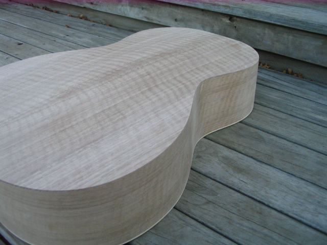

The back and sides are Gum Tree - more specifically Eucalyptus Delegatensis (Tas Oak, Victorian or Alpine Ash)
It has a really nice bright tap tone but the bottom end is huge.
Bending this stuff was easy. In fact the sides started out being bent for a dreadnought but were a little short so I ironed them flat. When bending them into the O shape one of the sides slipped in the bender so I had to iron it flat for a second time. (slow learner me :D)
The form in the Fox bender is solid (all our other shapes are slatted)
Once I had the top glued on I flattened the sides with a sandpaper block and I have to say that it was the quickest I've ever done it. So I'm sold on the solid bending form to stop cupping in sides and I'll be building more solid forms for our other shapes
The top is Engelmann and it'll get bound with Ebony (which I'll do tomorrow.)
Instead of the diagonal lower tone bar that's typical of the O-16 I put in 3 fan braces like you'd see on a classical. ( all under 1/4 " in height) The rest of the bracing is typical Martin.
The soundboard is 2.45mm thick.
I've got a Spanish Cedar neck blank from Uncle Bob that's going on it. Slotted headstock and ebony fingerboard will finish it all up - hopefully sometime next week.

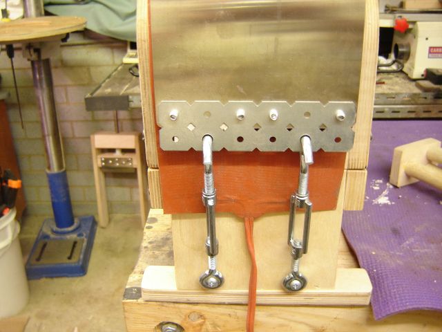

I have just made a new bending form for an MJ and i made it solid for the same reason as you, to help keep the sides flat. It would also help to contain the heat which can be lost in a slat setup.
Another thing i have done to help keep my sides flat is adapted from one of Mike Doolins ideas. i have these on both ends.
I crank down the waist most of the way, then bend both bouts, put on the turn buckles then crank the waist all the way. That way there is nowhere for the wood to buckle.

Cute looking little guitar Bob. If its not too much trouble could you throw up a better pic of the bending form.

Dominic, that's a fine looking bending set up, how about you show us in your own thread a closer look at your take on the Doolin system.
Mine is a solid form but ids much more agricultural than yours :D

I'll get some pics of the new bending forms today and throw some pics up later today.

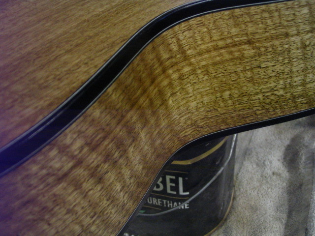

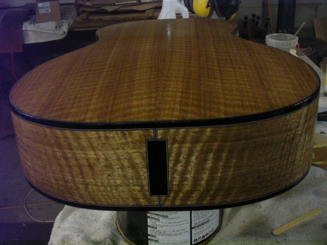

Post by Bob Connor » Sun Jul 06, 2008 5:12 pm
Got the bindings (Ebony) on today and some Z-poxy, so it's the neck to do next.
Post by Allen » Sun Jul 06, 2008 5:23 pm
Looking lovely Bob. The wood is really showing off that figure now.
Never seen and end graft like that one before. I really like it. Gives all kinds of possibilities as is, or as a canvas and frame for some inlay work.
Post by Kim » Sun Jul 06, 2008 5:32 pm
That looks fabulous Bob, it is surprising the dramatic colour change from beige to honey blond. Very noice :D

Allen wrote:Never seen and end graft like that one before.
And you won't see another one from me for a while. It was a prick of a thing and I'm still not overly happy with it. :lol: Still - only took a day's work. :cry:
Those fibre purflings we got from Gurian a terrible things to get a nice mitre joint with. Much prefer working with real wood purfs - they don't seem to compress as much when you're trying to cut them. I ended up making a jig and cutting these on the bandsaw.
That's just some Z-pozy Kim and yeah I was really pleased with what it did to the Gum Tree. Gives a it a nice champagne tinge.
