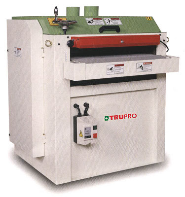

I've been eyeing this one off as an eventual replacement. It's about $900 more than the 16-32 but 635mm (25") wide and has dual sanding drums.

I got a funny feeling that your Carbatec is a re-badged Trupro.
I was looking at one identical at Woodworking Warehouse with the same serial number
The pic that I posted was from Trupro's Taiwanese website and I think is the new model which is a 5HP twin drum sander whereas the single drum is 3HP.
The only thing that concerned me in the specs was the minimum thickness was 6.5mm. You can easily get around this I guess but I wondered whether you'd ever sanded anything thinner like an acoustic back or top.
Anyway my point is that if it is the new model, there may be some deals going on existing stock.

Yep you're on the money there, Bob.bob wrote:Hey Stu
This machine is rebadged by many other companies, Carbatec and Hare and Forbes to name just two.
As far as minimum thickness sanding goes, I can shoot down to thin veneers by using a flat 16mm mdf board to carry the 'to be thinned goodies' through on. Works a treat and have had good results with it.
The mdf board also keeps the workpiece flatter, instead of the risk of bending/cupping to the shape of the notched rubber feed belt.
I bought this machine last March as I use it for lots of home-made bindings, veneers and the like for solid chambered builds. Not to mention run of the mill sanding/thicknessing.
Although I really got it for acoustic builds which I'm very excited about getting into.
I got this one for $2000 in one of Carbatec's sale. The extraction was around $600 and worth every penny
