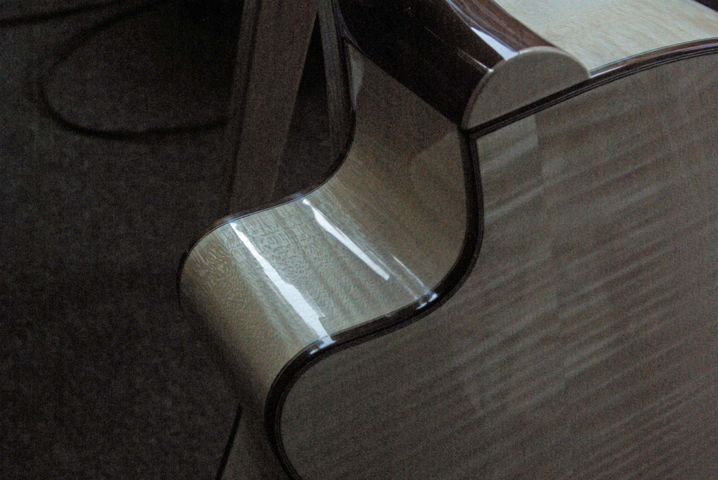

It was you who designed that bldi cutaway OM with that cutaway horn with a radius so tight that the blackwood bindings started trembling in fear whenever I got them close to the mold!!
Yep, and they just submit to their fate as soon as I point a bending iron at them!

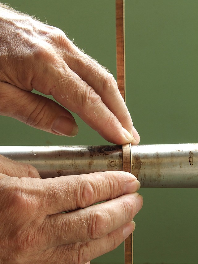

:D I must have done dozens of those cutaways and never really had a problem. In terms of binding, the figured blackwood and figured sycamore/maple are the easy ones, because the wood is pretty floppy. The tough ones are the bloodwood ones (Brosimum rubescens) because that stuff is so stiff that the bending has to be nigh on perfect, because there is no way you'll pull in any misfit even with filament tape. The stuff just doesn't flex once bent. Here's another blackwood one (from over ten years ago) and a bloodwood one.
And here's the instrument of torture. I made it from thick walled aluminium tube, 38mm diameter, 3.2mm wall, squeezed a bit in a (big) vise to form a short flat on it. It has a very similar shape to the "point" of the cutaway, as it happens. It has 500w of heaters in it. More details in the book, of course.

Trevor, you look pretty close to burning your fingers...I use good quality leather riggers gloves and an apron to do my hand bending on an iron I made then installed eBay Chinese ceramic elements, and an eBay PID controller.I had an aluminium casting works in Port Melbourne pour the aluminium from a craftwood shape I made specifically to do the Selmeroid cutaways. I shaped the first piece of craftwood then kept screwing the subsequent pieces in, using a bandsaw then a pattern following bit to refine, followed by a little sanding and squaring up. .....
Then I refined the aluminium on a belt sander, and drilled 10mm holes for the elements. I also had them pour some aluminium into a couple of pieces of stainless tube which I also drilled and installed the creamic elements in. I used fire cement from the local hardware shop or Bunnings...it's used for sticking new faux asbestos woven door seals into wood heaters. A sparkie gave me an offcut of the fibrous material that electrical switch boards can be custom made from then mounted the whole shebang on some timber which can be clamped to the bench or held in a vise, either vertically or horizontally. The reason I use the apron and gloves is because I was merrily bending away and got a bit hot, only to find that I'd melted the zipper on my jumper permanently closed. :mrgreen: I use a lot of figured plane and Silky oak for my bindings. No problems there. If I have a problem with bending by hand I spritz the wood. Don't even have a bending strap which I'd like but a ceramic element will be before that and a fox style bender, I guess....ahh luxuries! I'm going to try bending some bulloak bindings soon for a tight Selmer style and will of course, report here! I also hand bend solid liners, I have been using Japanese Beech for that but also have some Hawthorn which is related to boxwood. Solid liners are essential for the Selmer style guitars, particularly the tops. The Selmer projects have stalled for a while due to health reasons, winter in the mountains, an OM build, a Gibson L-00 flat top, and numerous restorations and repairs which I have decided not to do anymore... So keen now the warmer weather has returned to get right into the projects, my ones, for me! I'll soon be able to spray again in the warmer weather. It's cold in them thar hills, just below the snowline! Cheers! Ross

Well, that shot was posed for the book. I was operating the camera at the same time as posing for the shot. But I don't wear gloves when bending wood anyway. I haven't burnt my fingers yet, but that's perhaps not a recommendation for others! Not wearing gloves certainly keeps you focused on what's going on, lets you feel the temperature, the wood and how it's moving.
I frequently get asked what the trick is to bending wood. My normal answer is there isn't one (other than patience). Maybe this is the trick: don't wear gloves! :mrgreen:

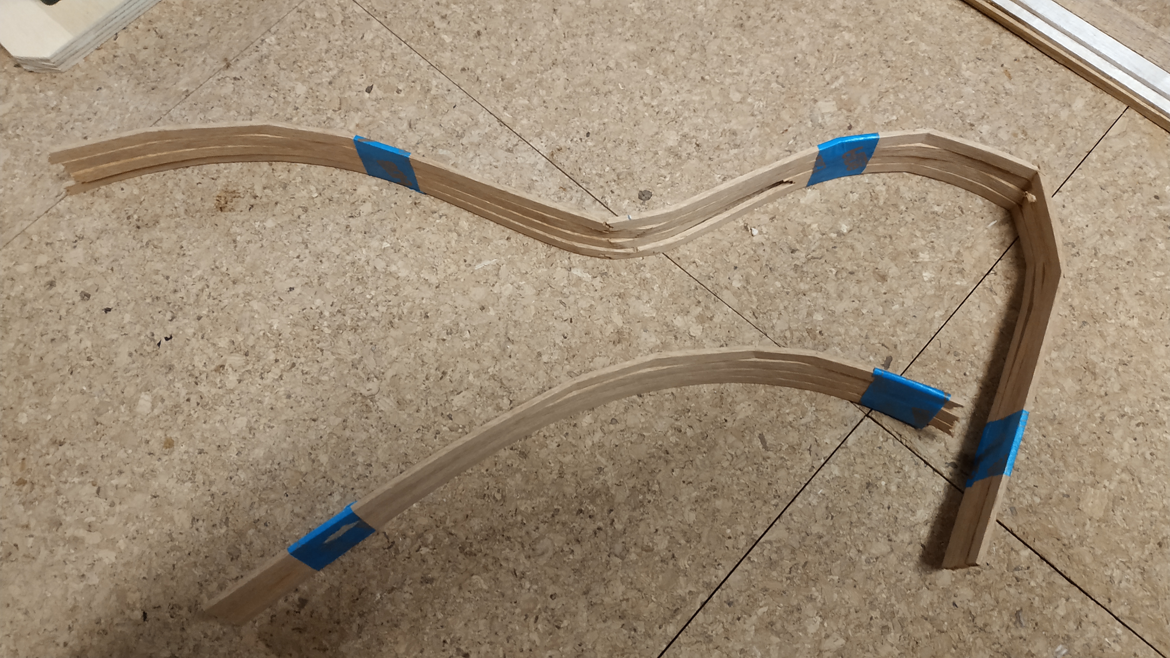

And of course it isn't just the bindings it's the side as well. But we persist because we like the shape and because we love the cutaway, even - actually - especially on classicals. I haven't been quite as sharp on this one but I do like it.
