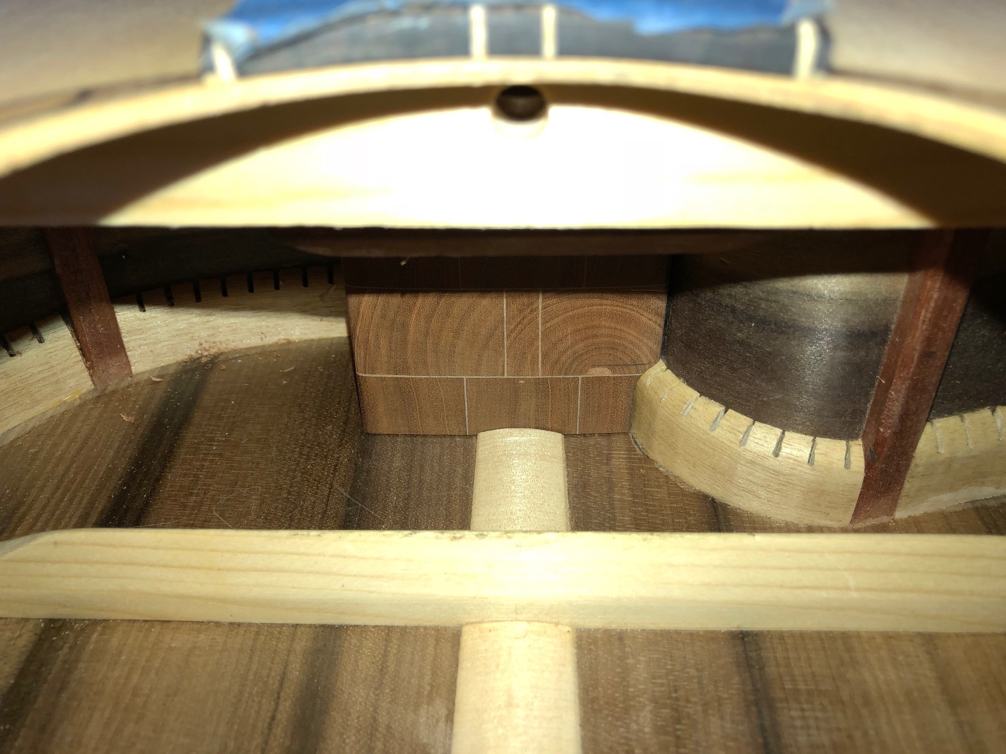

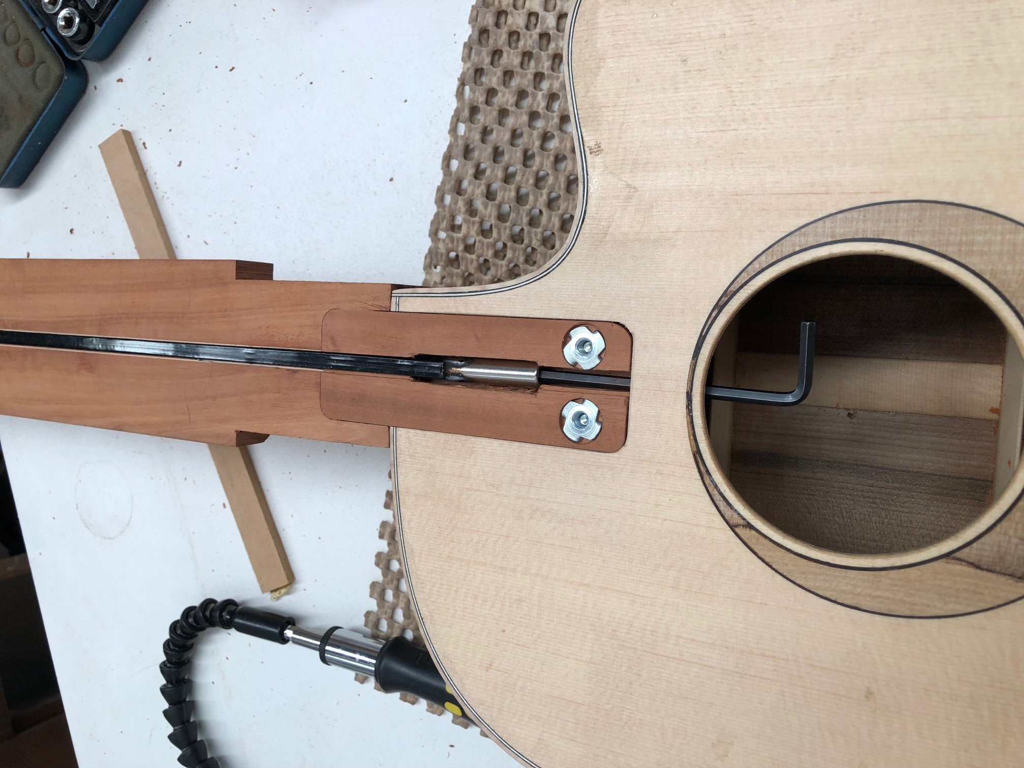

Hi,
Yesterday, installed t-nuts and bolted the fretboard extension, which left like a milestone I was pretty happy about.
However as the head block plate is 45mm deep, you can easily see the bolt head through the sound hole, which I am unhappy about. I have used M5 bolts/t-nuts but after 2 washers they are clear as day through the SH. Anyway, I don't have an appropriate reverse countersink bit and the 5mm hole will likely be an issue for finding something commercially available.
Does anyone have any ideas about how I might countersink them?

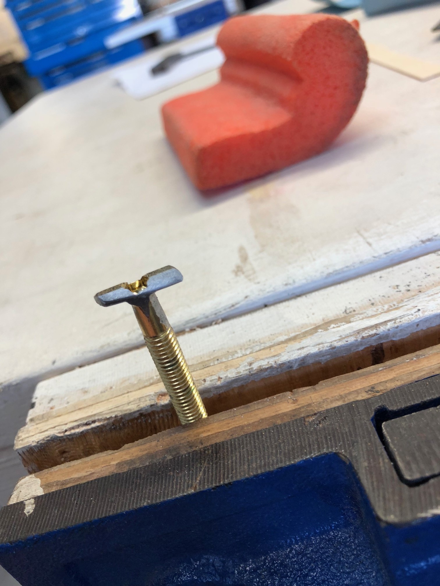

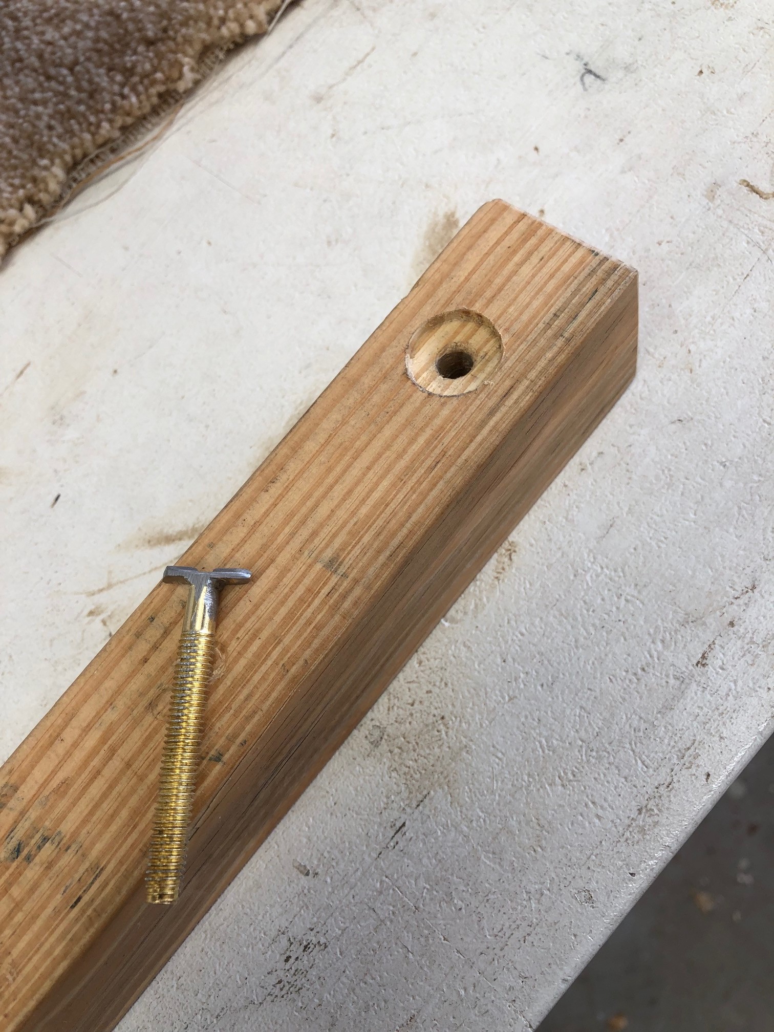

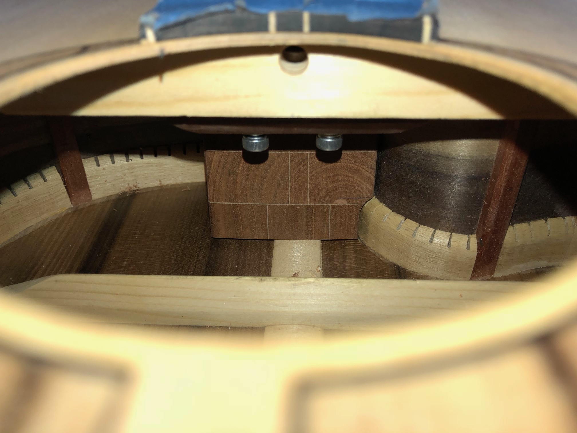

So I ended up widening the holes in the neck block to 6mm and them making a bit by filing to shape and sharpening with a diamond stick. Worked a treat! Thanks everyone. A few photos and a before and after:

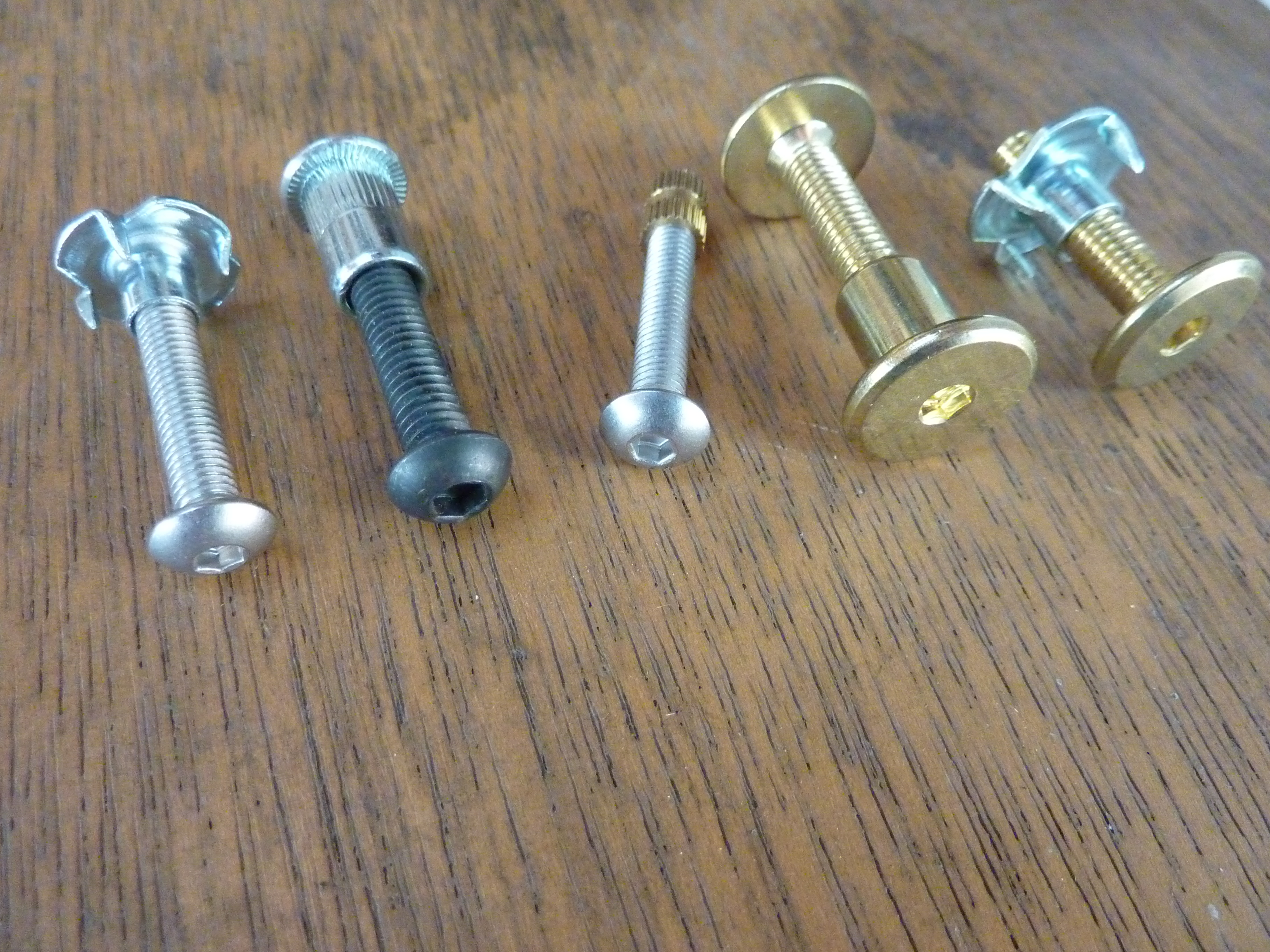

A connector bolt like this one shouldn't require any counter bore. The low profile keeps it out of site.
Hardened and plenty strong.

Hi Ken, do you know if they're available in M5 and if so where can be bought. These are normally M6 which is too big for this particular application.
Re: Counter sinking bolts BO/BO fretboard extension
I use m6 or, 1/4" even, for this exact application with no problem. You're right, the m5 version probably won't be
found in your neighborhood hardware store but a quick Google search turned up several vendors. A search from
your neck of the woods might turn up something more applicable to you but here's one online site.
https://www.fastenright.com/general-fix ... pe-e1/ff06
I haven't bought from them, don't know if they ship your way but m5's are available.
Regards, Ken

If you use this type of fastener, be sure to get the hardened ones. Most of the furniture grade ones aren't and the hex socket will round out if used a few times with a ball end hex wrench. This was the reason we moved to the M6 socket head cap screws, which have a larger socket and are normally hardened, but will hold up even if they aren't.

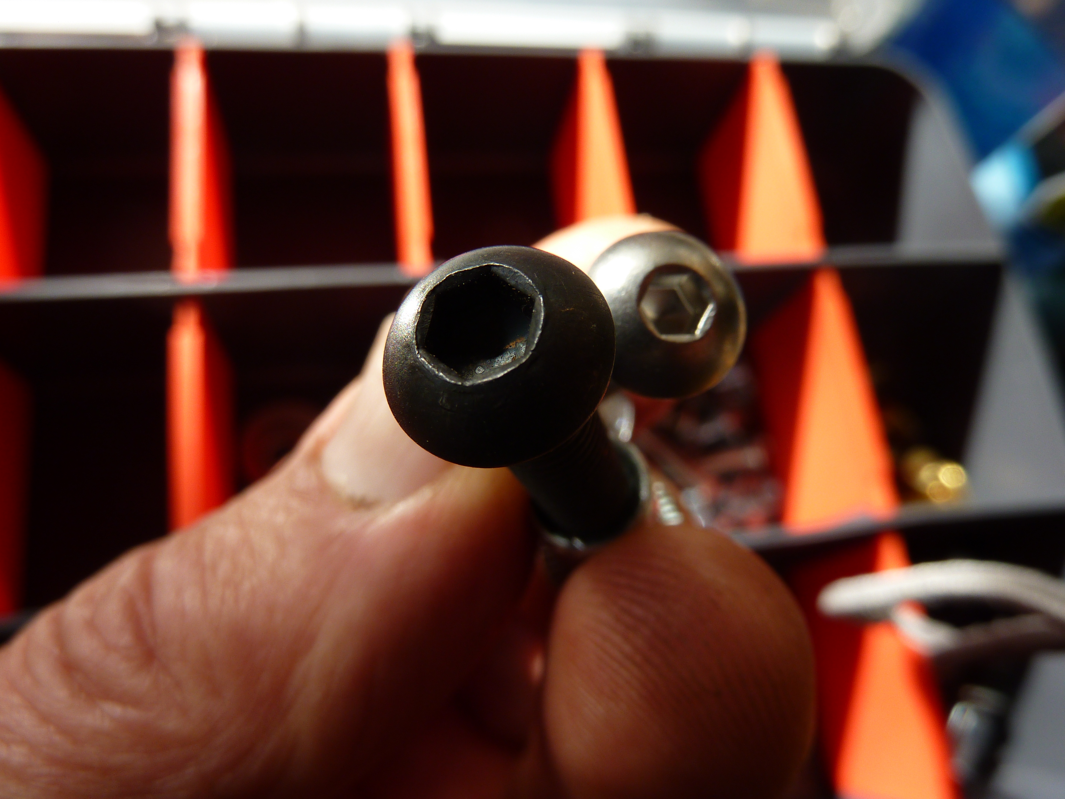

Ross, I tried those round headed bolts and found that with the frequent working of the bolt during neck fitting the socket edges started getting quite worn. I went back to the bolts that Trevor specifies with the thicker head walls. I also find the heads of these bolts easier to turn with my fingers.
Can we see this bolt you speak of Martin?
