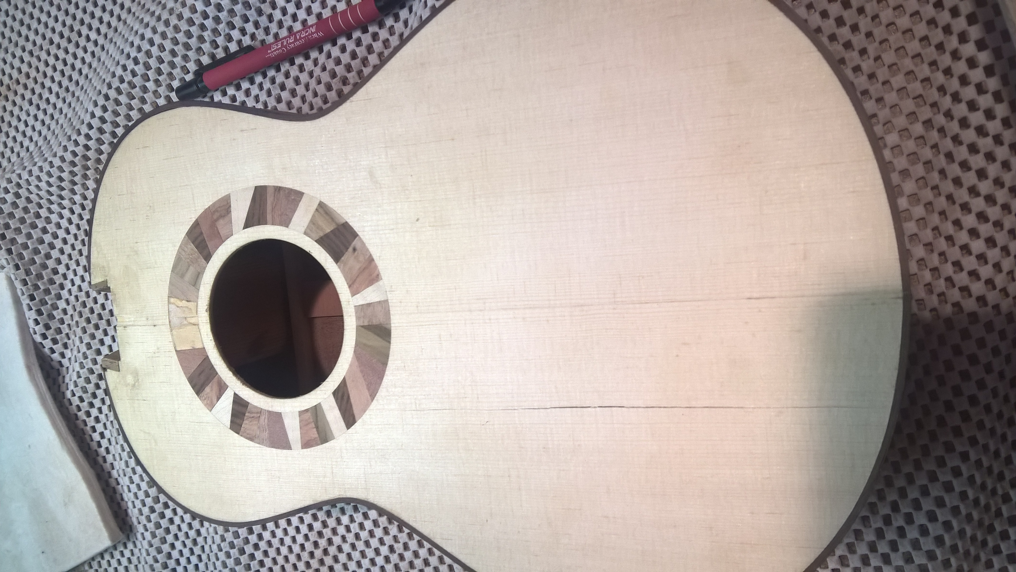

Hi Folks,
my son is slowly building his first tenor ukelele and I'm still in single figures.
We've had a bit of a soundboard disaster (as the image shows).
I think we'll try some cross-grain cleats underneath pulled up with some fine wire and a home made winch using a tuner - but we're open to suggestions.
I have three main questions....
the crack seems a bit reluctant to close back up. Should we dampen/swell the joint along with side clamping to "make' it close up?
or fill the joint with a slither of spruce?
If we use a slither, any advice on getting it right would be appreciated. eg how to make them, one section or several (As there's a slight kink in the top half.
also,
what's the best method to hide the holes left over by the wires?
the top is still raw timber so I guess that's an advantage.
Thirdly, this is in Tassie. Is it likely that humidity was the cause?
I didn't think is was a concern down here.
(I've ordered one of those endoscope cameras to help out).

http://www.mirwa.com.au/HTS_Splint_repair.htmlPat.Hawkins wrote: ↑Wed Jan 17, 2018 12:24 pmShould we dampen/swell the joint along with side clamping to "make' it close up?

Steve's tutorial above is a really nice walk-through of a splint repair. If you are going to do this there is an additional trick that can be used to get a tight fit. I have only done this once (it worked for me) - so more experienced people might advise. You cut the sliver a little thicker than the width of your crack and then squash it flat by lying it flat on a hard surface (something like a ceramic tile) and rolling the shaft of a screwdriver over it. You are compressing the fibres of the wood to make the sliver thinner. Then coat it with a heat-soluble glue - hide glue is ideal as it dries clear and doesn't discolour the spruce. Titebond original will also work (and is what I used). Then let the glue dry on the surface of the pancaked sliver (you haven't inserted it in the crack yet). You can squish it again if the moisture in the glue made it swell a bit. The trick of this is that when you place the sliver in the crack you then reactivate the glue with steam (put a wet cloth over it and use a clothes iron). It is like the trick to steam out dents - if you know that one. The heat and steam swells the crushed fibres of the spruce so the splint expands to tightly fill the gap. At the same time the glue becomes activated - so it gets glued it in place. Of course you want to do this with a piece of spruce which is thicker than your top, so it ends up a bit proud of the top and you can then scrape and sand it down for a flush finish.
If you think that you are immune from humidity issues where you are - think again. This looks like a classic case of a top which was glued to the rims at a time when it was relatively swelled by high RH (did you close the box on a rainy day?). It has subsequently dried out and shrunk across the grain. RH is an issue for all of us I am afraid. Most (including myself) have learned this lesson the hard way! Pay special attention to the humidity when you are bracing the plates, and when you are closing the box. The instrument is really vulnerable at those specific point in the process because you are essentially "locking in" the dimensions of the timber as it is on that day. I have sometimes had to wait a couple of weeks to do those critical parts of the build because the weather isn't right. It can be frustrating! The good news is that rest of the build process is relatively unaffected by humidity issues. So once the box is closed up you don't need to worry too much.

This is such a great forum! The support is really appreciated.
Thank you for the replies, it's given us real confidence in making a good repair.
As it's a tenor we can't get a hand down the sound hole.
Just waiting for that camera now - hopefully a repair image later
