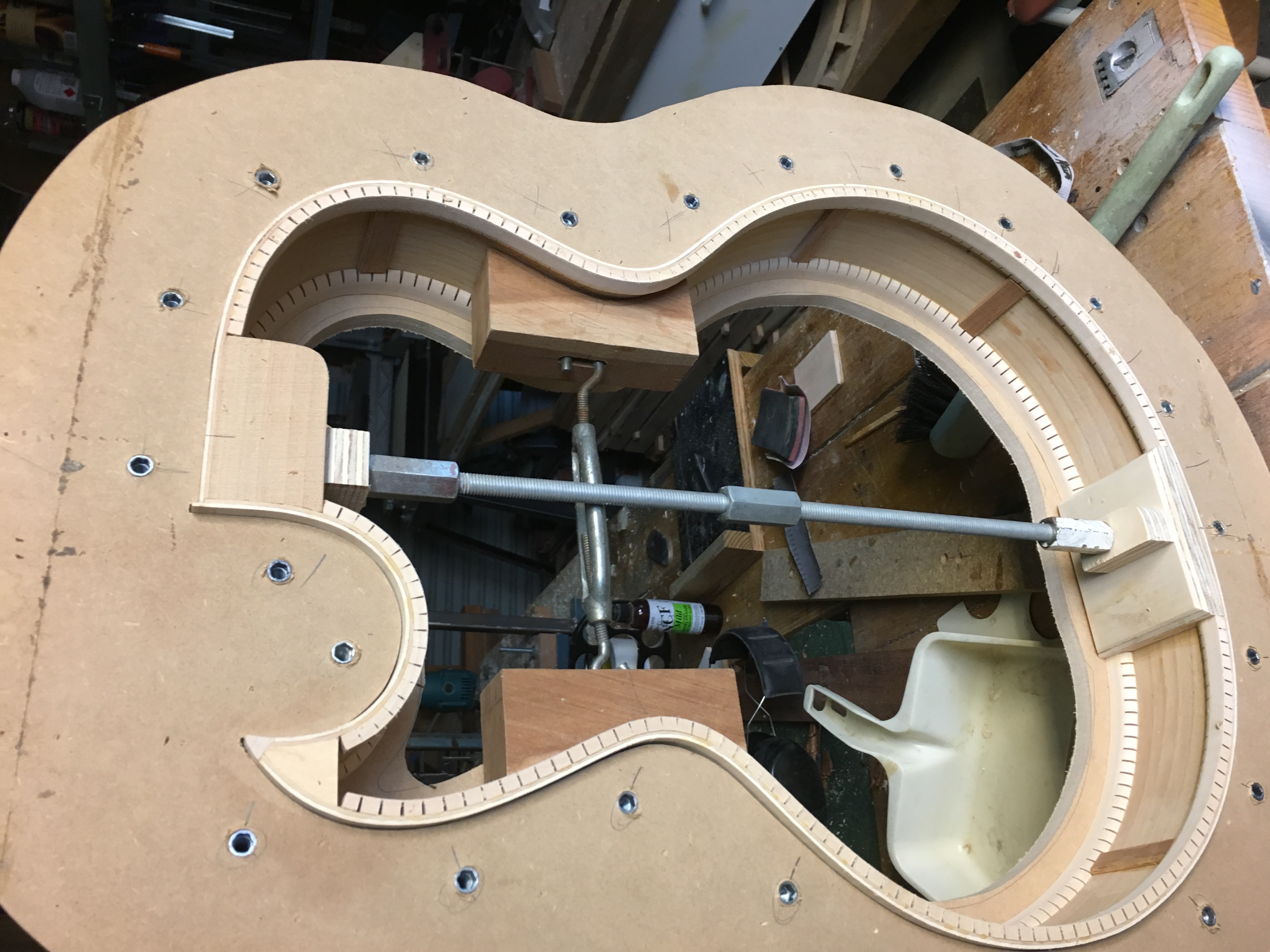

I had been using solid mahogany or Sitka blocks parallel to the sides but have changed recently to ply tail block as seen here but still got the solid neck block parallel for the better gluing to the plates.
In view of this discussion I'll give the ply a go in the neck position on the next build.
Rod
Rod
