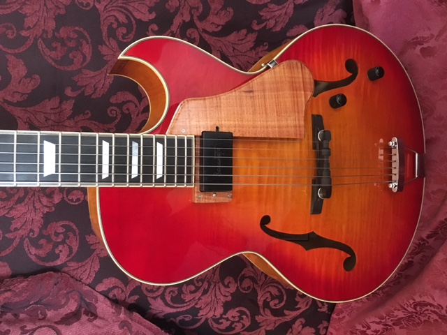

So i've got the sides finished and just starting on the neck, this one is a copy [ with some small aesthetic variations of the cherry burst build from last year.

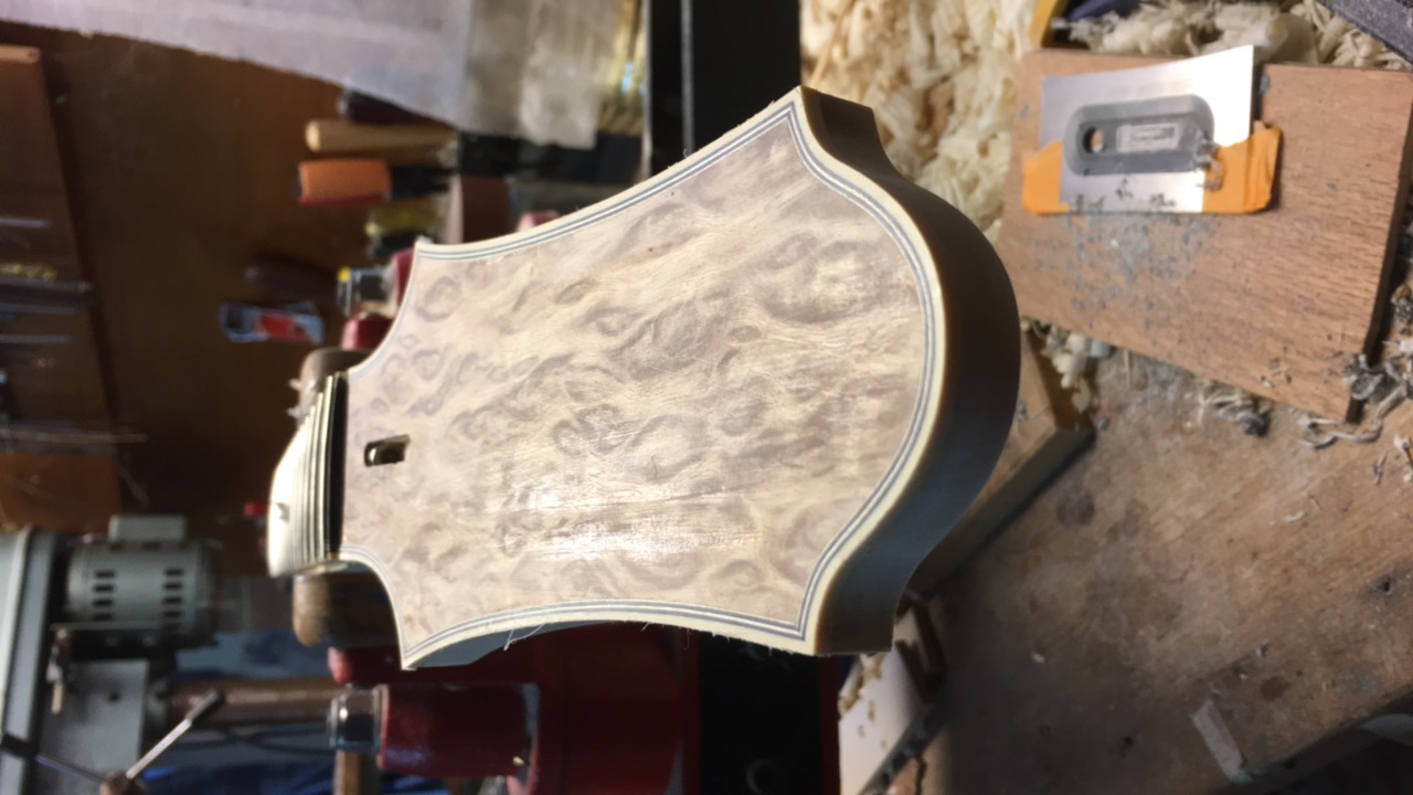

PS can any of the mods turn that pic up the right way? i don' know how it got like that!

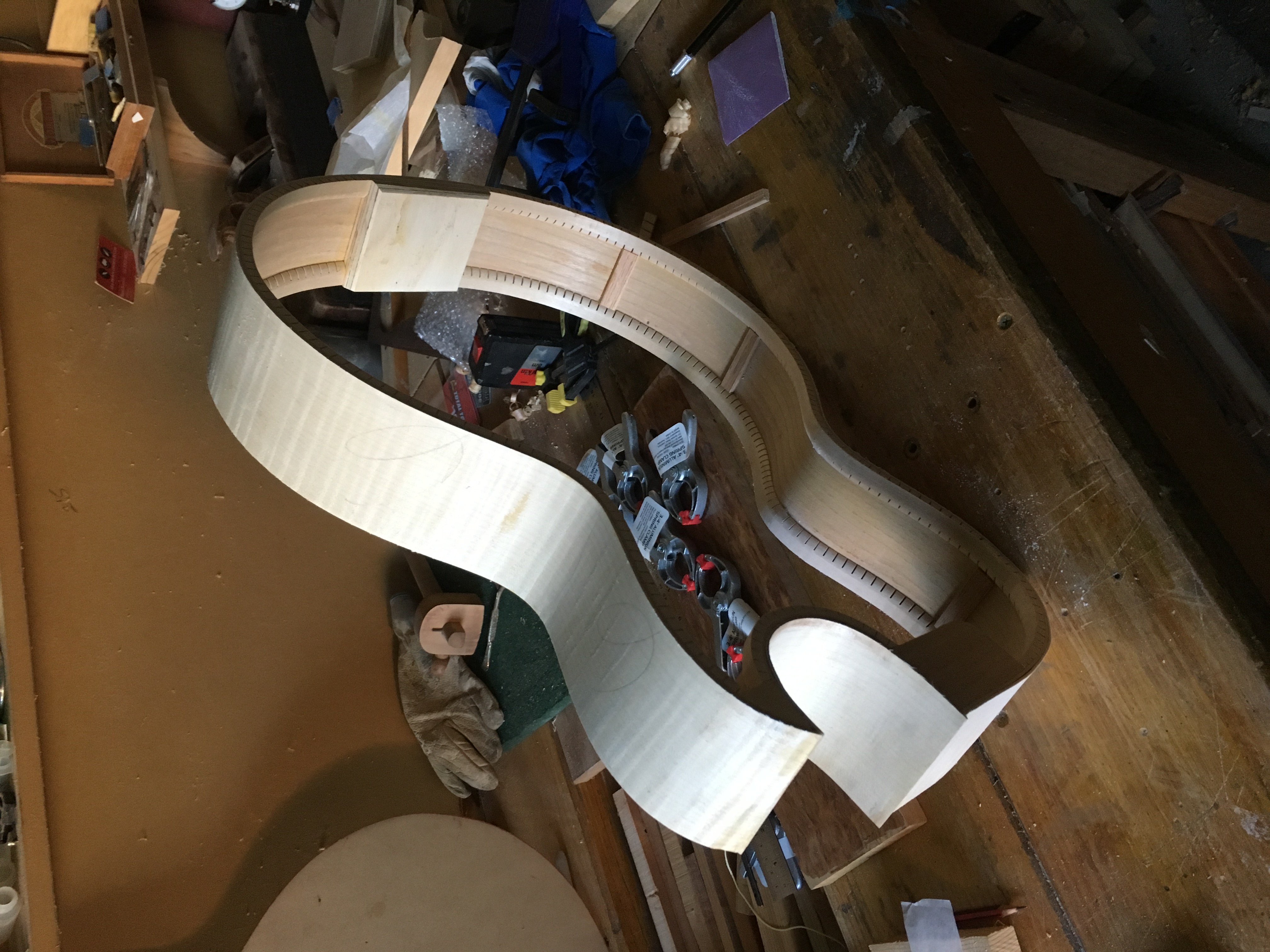

Laminated sidesand plywood tail lock

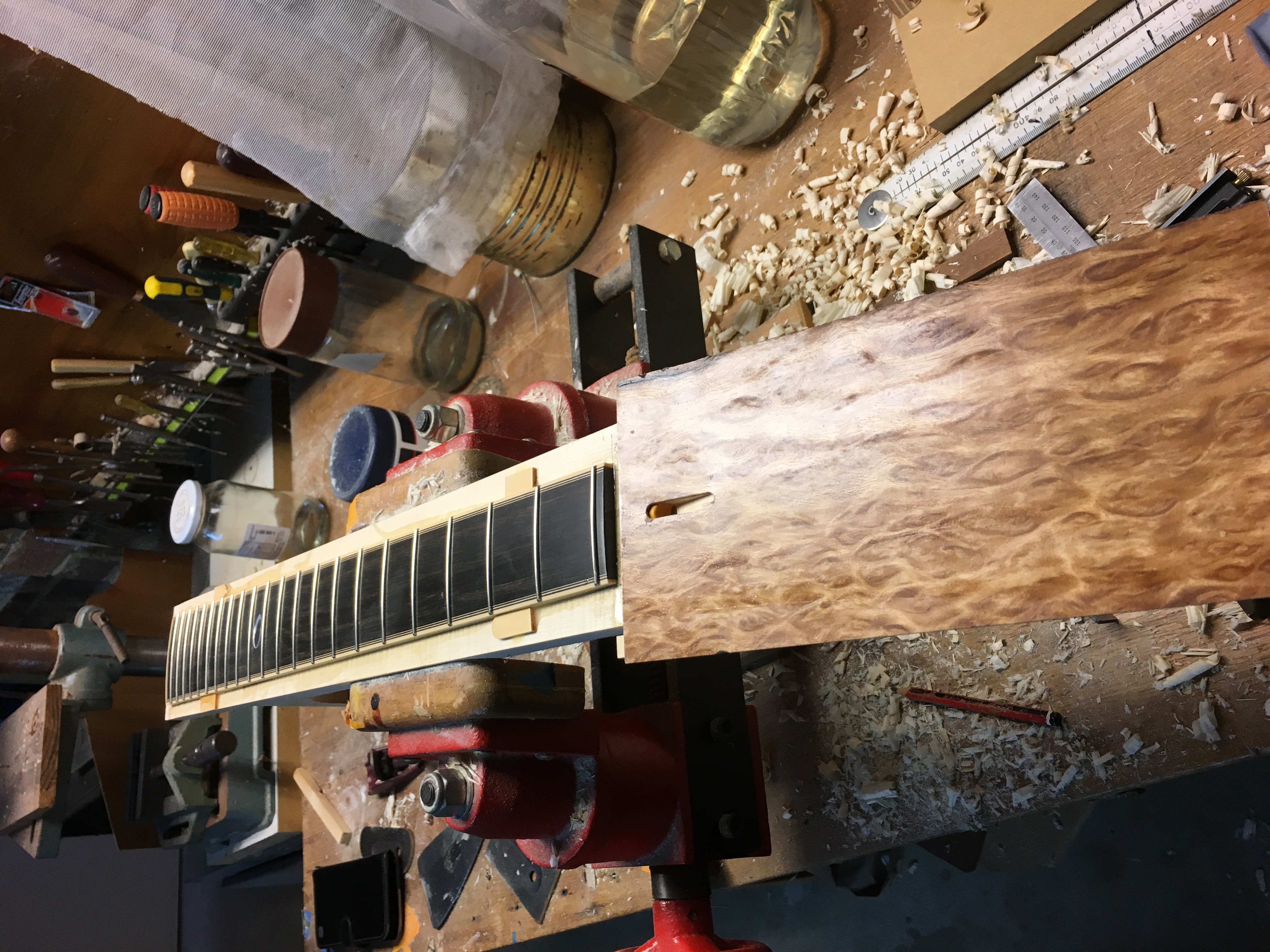

Bound ebony fretboard

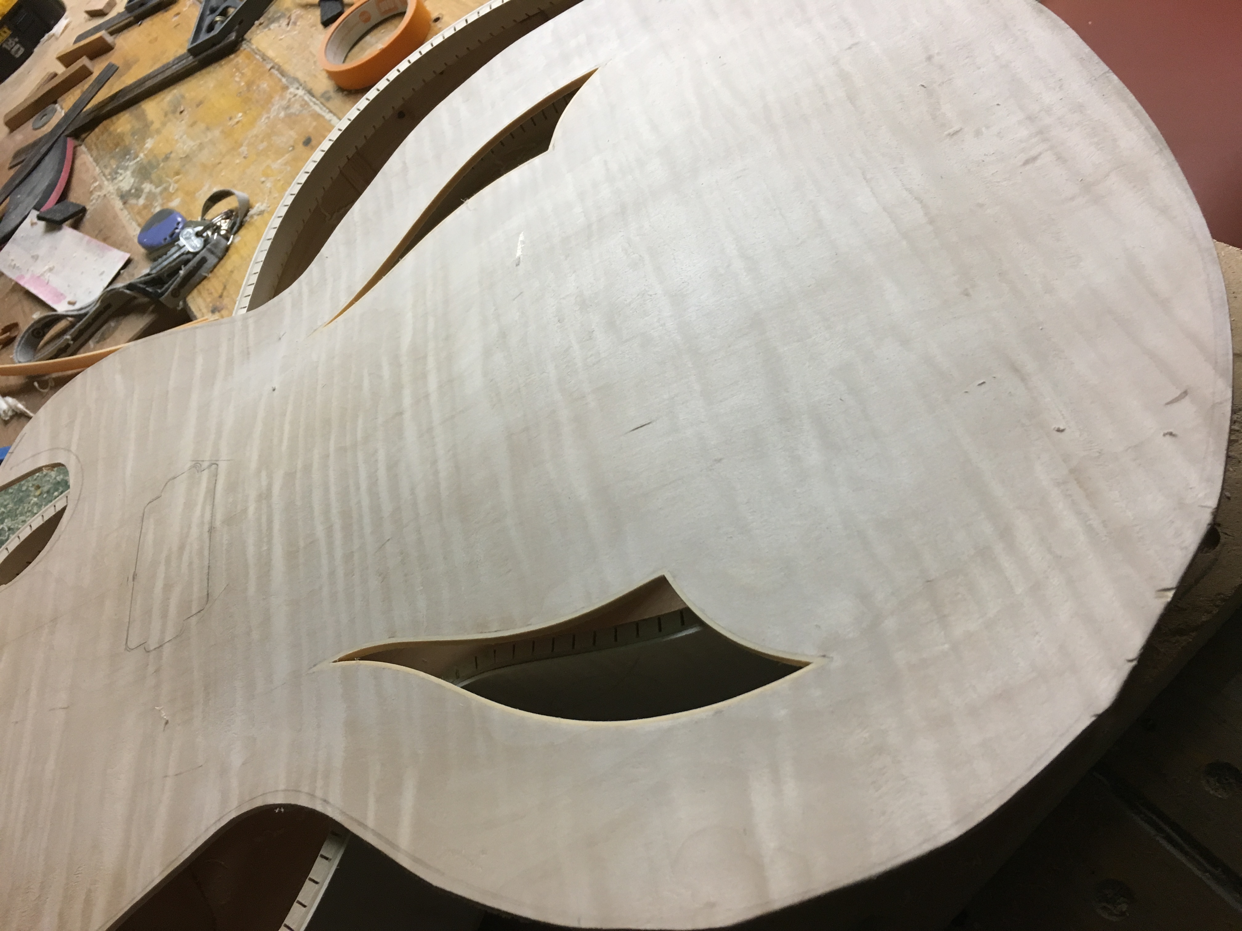

It's a beautiful guitar. One day I'll make an archrival style guitar. But first a silly question. Why are the tops carved? Why not steam/heat pressed or steam shaped a bit like sides are?

David,a typical arched plate be it front or back varies in thickness from 5-6mm down to 3mm at the thinnest point it would be impossible to bend the timber in every direction around the 360 degrees required without it cracking or splitting just about everywhere. a bit of homework for you, take a piece of aluminium foil and cut a circle about 30mm in diameter and place it over a milk bottle and push it down into the neck of the bottle with your thumb, now take it out and have a look at the shape of the foil, nice and smooth on the crest and bloody wrinkly around the edge, the foil didn't crack but it still looks crap around the edges, and the foil is much more forgiving than timber.
So in a nut shell!! it's easier to carve arch tops to shape than press them into shape,,,,,,,,
i hope this answers your question..

From my understanding there were alot of reasons pressed laminated archtops appeared - reduced production costs, ability to create a more uniform product, stiffer tops and reduced tendancy for feedback are a few reasons I've seen fielded. As for differences in tonal quality there are a some great sounding laminated top archtops but I think it would be hard to match the sound of a hand made solid archtop.

I'm referring here only to Davids question regarding the bending of a solid top, laminated tops are totally different animal which I might add I have been known to use in the past, in fact the two guitars referred to in this topic are laminated tops and backs.

The laminated sides, are you buying them laminated and bending or laminating them into the mold
One of the local store owners has asked me to teach them how to build a 175, so ironically I happen to need to make a mold. Having seen the body profile you had, it looked tidy and neat.
I am currently drawing the body up in cad, to cnc make a body mold for him, personally I am going to make a Benedetto Archtop at the same time whilst he is doing his 175.
Steve ,, no cmc's in my shop, i do everything with the old elbow grease, make a template, transfer to mdf cut it out on the bandsaw, refine the bumps with files etc.
I bend my sides and laminate them inside the mould, all my instruments are done that way.

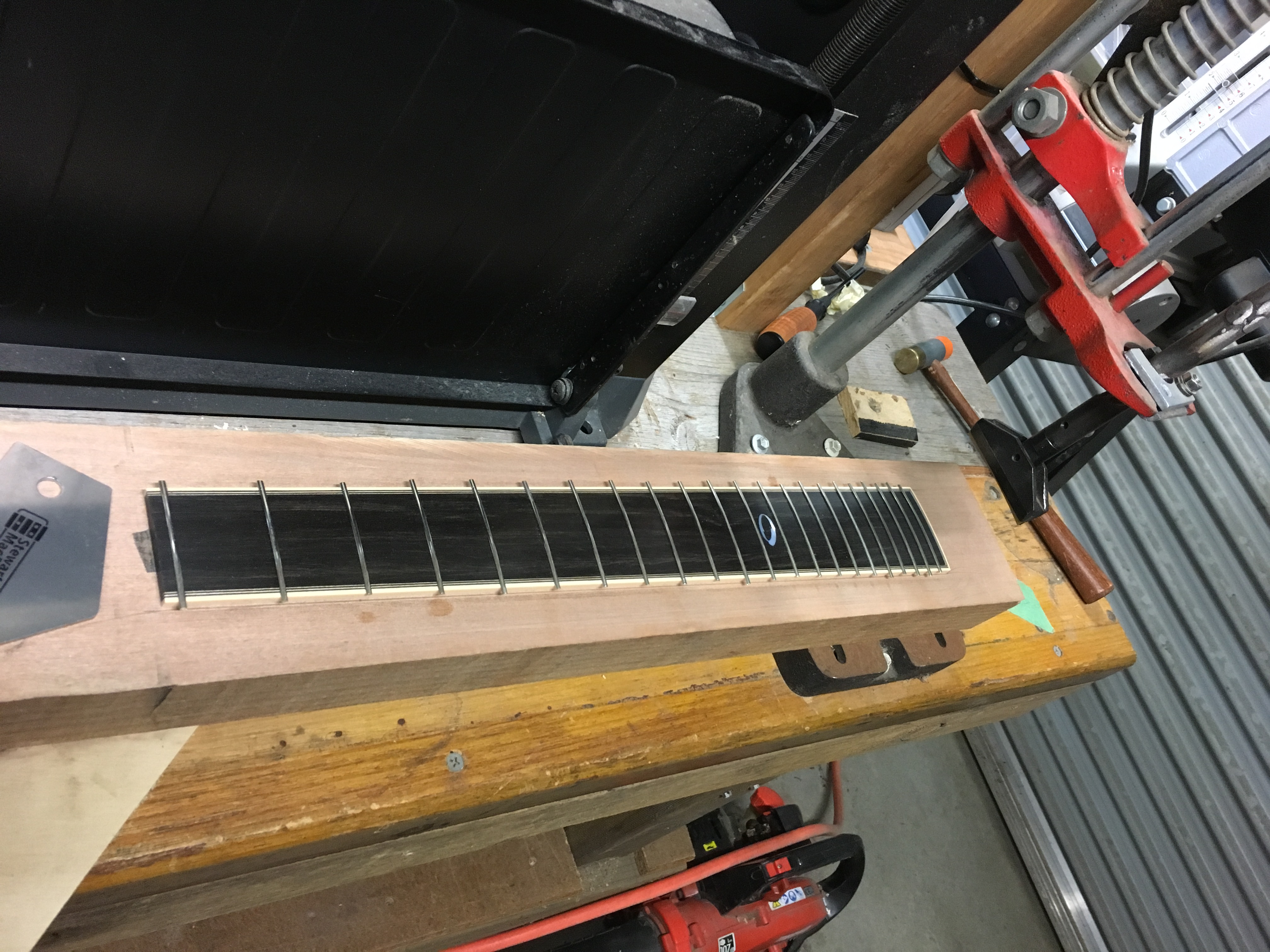

Post by rocket » Wed Sep 13, 2017 9:44 am
A bit of progress.
