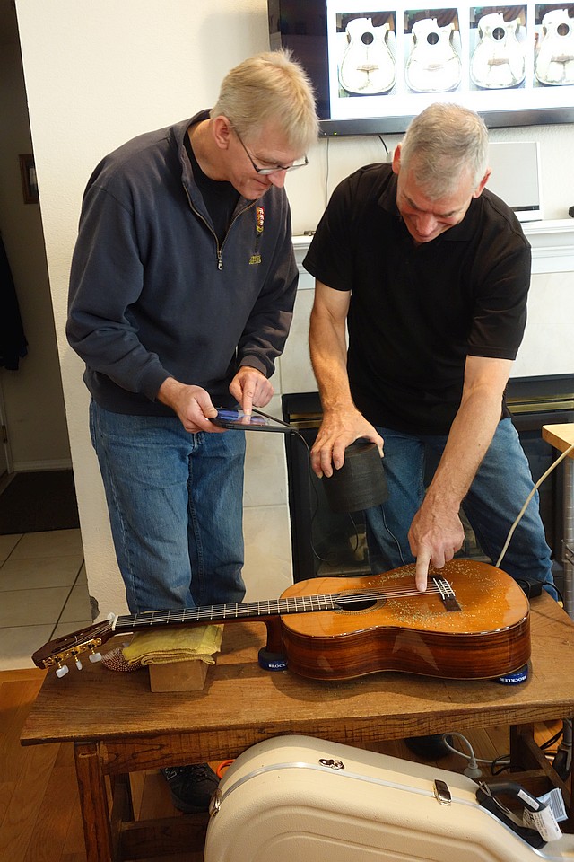

Robbie came up with some new ideas for driving a Chladni speaker. I couldn't fly out my 10kg sig gen/amp, so Robbie and one of his students built this self contained speaker/amp unit driven via a bluetooth link from an app on an iPad (will work from a smart phone if you have small enough fingers)! The speaker unit is the black cylinder behind the iPad.

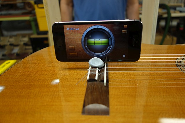

Yet more hi-tech with an alternative bridge rotation measurement device - a smart phone app. Plenty accurate as it turned out.

How good is that, no jig required!Trevor Gore wrote:Yet more hi-tech with an alternative bridge rotation measurement device - a smart phone app. Plenty accurate as it turned out.
