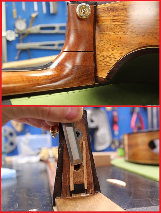

Post by simso » Fri Apr 21, 2017 4:38 pm
Smashing though this backlog of guitar repairs.
Another one of interest for folks
How to spline a neck heel
http://www.mirwa.com.au/HTS_Spline_Neck_Heel.html
HTS Spline Neck Heel.JPG (133.87 KiB) Viewed 7667 times

Post by jeffhigh » Sun Apr 23, 2017 12:24 pm
Can't see the point in this spline, it gives little or no material near the critically stressed area at the outside of the break.
Just gluing it up with HHG and setting the insert in with epoxy would work well.
Re: How to spline a broken neck heel
Post by simso » Sun Apr 23, 2017 12:45 pm
Al good, and a fair question.
Normally glue is sufficient to repair a broken neck heel, many heel fractures that is all I do as well, that is glue it and refit.
The fracture on this neck was located at the insert, the splines add side strength to that location and go to the depth of the insert only, there was also a requirement to replace some of the wood that was also missing at that bottom insert location.
