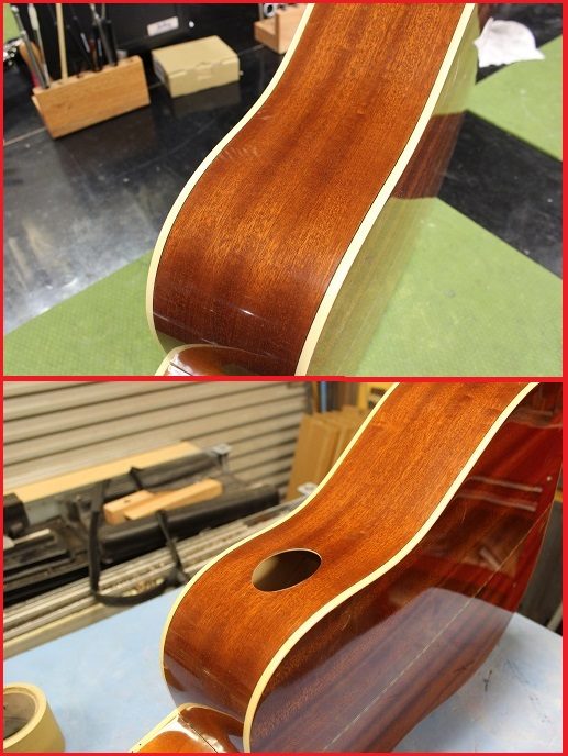

Post by simso » Tue Mar 28, 2017 7:49 pm
Had not realised I had not uploaded this one, so for your perusing pleasure or to rip me a new one for even thinking of doing it. :)
http://www.mirwa.com.au/HTS_Install_Soundport.html

Post by simso » Tue Mar 28, 2017 7:50 pm
The jig I used was from a business called luthiertool, Chris makes IMO some of the nicest tools out there, expensive but nice
