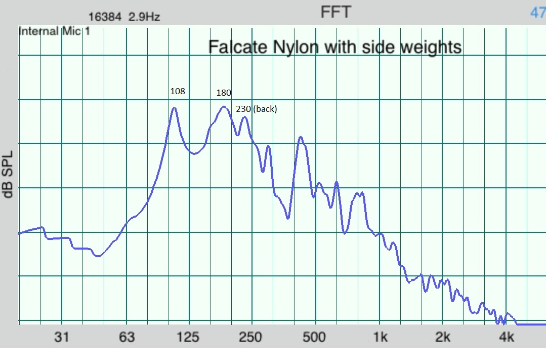

While TallDad is now off chasing a buzz, this thread has kicked me into gear to do some Frequency Response Curve (FRC) analysis of the falcate braced nylon guitar that I built about a year ago and have been a bit unhappy with the sound (top 3 strings lack clarity and sustain – especially the G string).
I had downloaded VA to my laptop a while ago but didn’t have a microphone to hook up to it, so I never got around to using it. On Craig’s suggestion I also have now loaded the FFT app onto my iphone – and found that using it is a piece of cake. In 10 minutes I was getting all sorts of interesting data, and I think I have diagnosed some issues with my Engelmann/sassafras nylon falcate. But I haven't done this sort of stuff before - so please tell me if I have got it all wrong.......

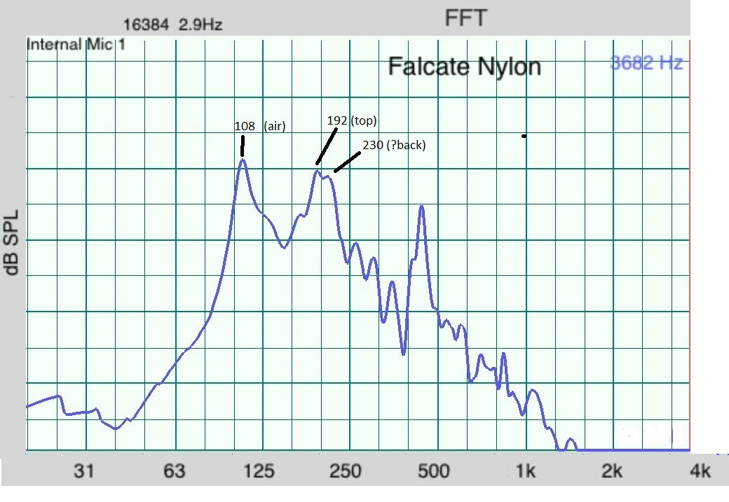

Here is the FRC plot. I think a relevant issue is that it has a fairly live back (sassafras not being very stiff). This is a L-00 sized guitar – i.e. fairly small bodied.
My reading of this is that the peak at 108 is the main coupled air response, and then there is a double/overlapping peak at 192 and 230. I think the 192 is the main top resonance – which is a bit higher than ideal, and rather close to the frequency of the open G string (196). That might have something to do with the poor sound around that frequency? I also hypothesized that the 230 peak was the resonant frequency of the live back. This seems to be confirmed when I repeat the FRC with the back dampened by a pillow – the 230 peak disappears.

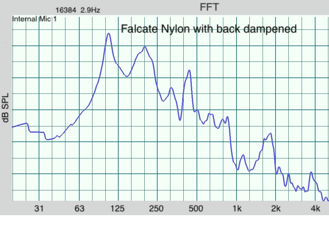

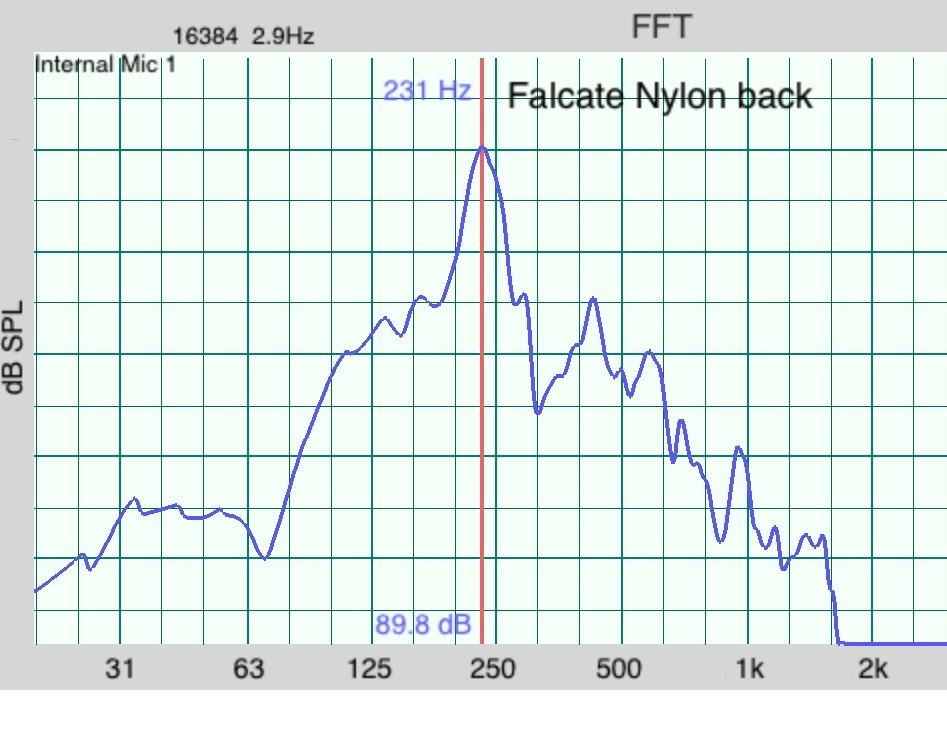

And if I dampen the top and just tap the back – lo, a strong peak at 230.
So – could my sound problems be related to the main top resonance being too close to G, and also fairly close proximity of the top and back resonances? It seemed like a good idea to bring the top resonance down a bit. I could also consider killing the back resonance by adding some bracing – or, alternatively, always playing it with a pillow on my lap.

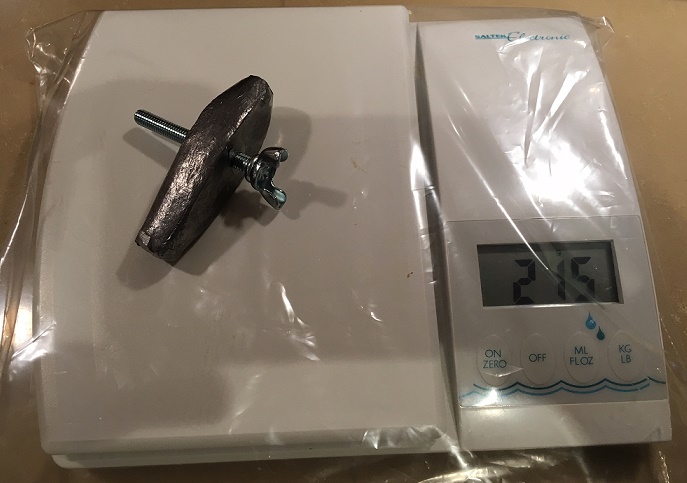

I consulted the Good Book looking for divine guidance. In the Gospel according to Trevor, Chapter 2, Figure 2.4-2 I received the wisdom regarding the effect of side mass. I had installed side mass loading struts when I built it, so now it seemed like a good time to make use of them. I picked up some lead fishing sinkers from the local tackle shop and drilled them out to take a wingnut. Two weights at 215 grams each should be enough to make a bit of a difference.

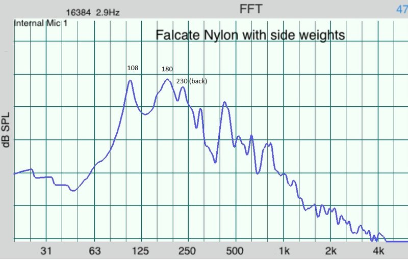

Here is the repeat FRC once 430 grams of side mass is screwed in place. As prophesized by Saint Trevor, the main top resonance has dropped from 192 to 180. The other peaks are unchanged, but the top and back are now a bit further apart. I tell you, Brothers and Sisters, this is some miraculous sh*t right here.
So – does it sound better? That is an entirely subjective matter – and I also changed the strings while doing this work, introducing another confounding variable. However, yes, praise the Lord - I think it is better.
And this is now one heavy guitar.

Interesting work Mark. It is fun to see the graphs play out and the effect of the mass. In your case I like the idea of stiffening the back. You might flatten the lower bout back brace a bit and glue a brace on top to make the back a bit stiffer. The top will rise as well (but you can tune it to 190 with some mass) You should be able to separate the top and back peaks. I like the overall sound of the 180 Hz classical guitar I made but they sort of wash out on the high notes on the E-string. I find the 190 the best balance for my taste in sound.

Thanks for the comments John. I am totally new to this stuff so I am learning a lot. It has been really fun to play around with. I know most people are collecting their FRC data using Visual Analyser. I found the FFT app to be great to use on my phone. It requires almost no set-up, and you can add a title, capture the plot as a screenshot, and then email it to your computer. I think it cost me $AU16.

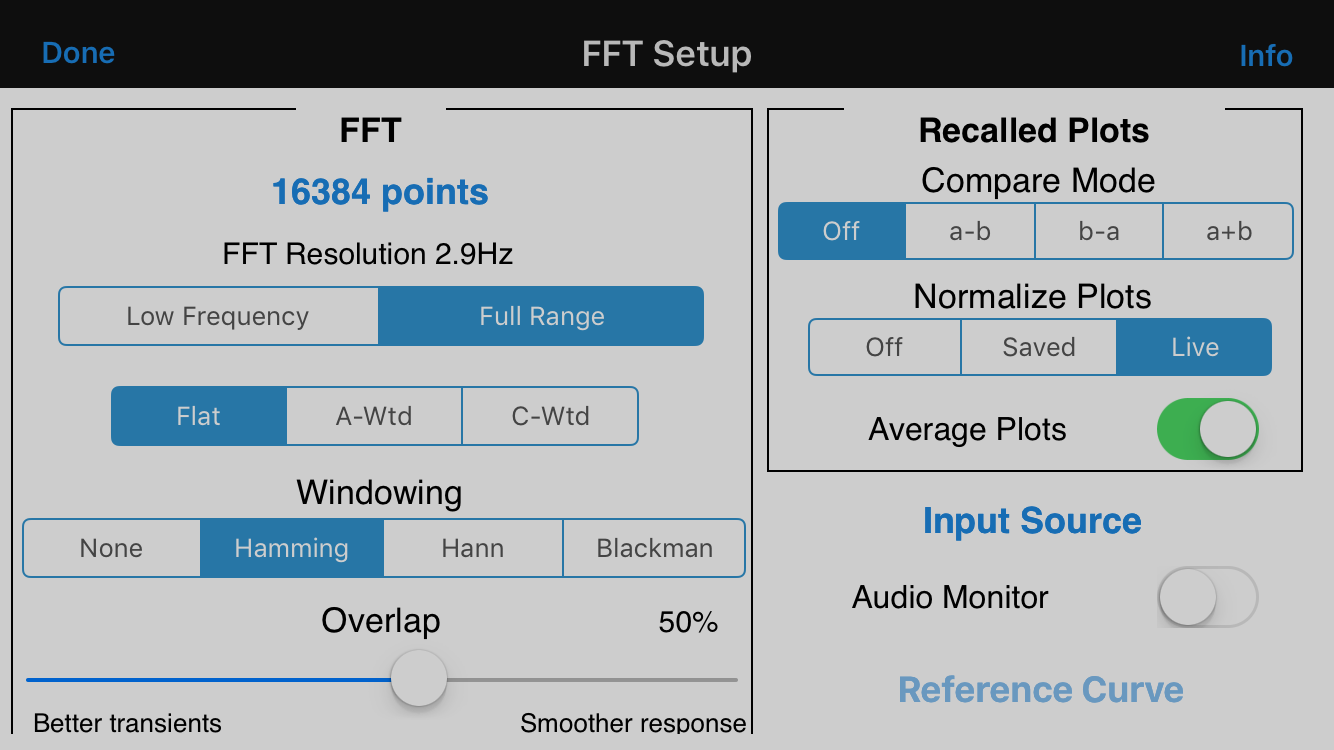

Re: Adjusting sound

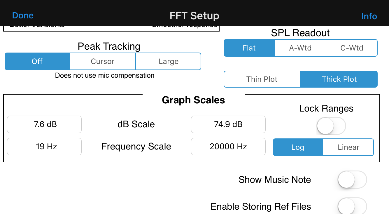

Craig will have more experience - my recent posts were my first experience with it and I chose settings pretty much by trial and error. However, to get you going here are some screen shots of the settings I used. I set smoothing at 1/12 octave, and graph decay at "peak hold". [ If Craig says something different - do what he says, and so will I next time.

FWIIW, I use the default settings on the settings page. On the main display, I use No Smoothing on the smoothing options in the lower left corner and Peak Hold in the lower right. I have not utilized the many custom options because 1) FFT seems to work fine with the defaults and 2) I'm lazy. Don't let that stop you from trying though, there are probably some improvements hiding in the options that I have not even considered.
