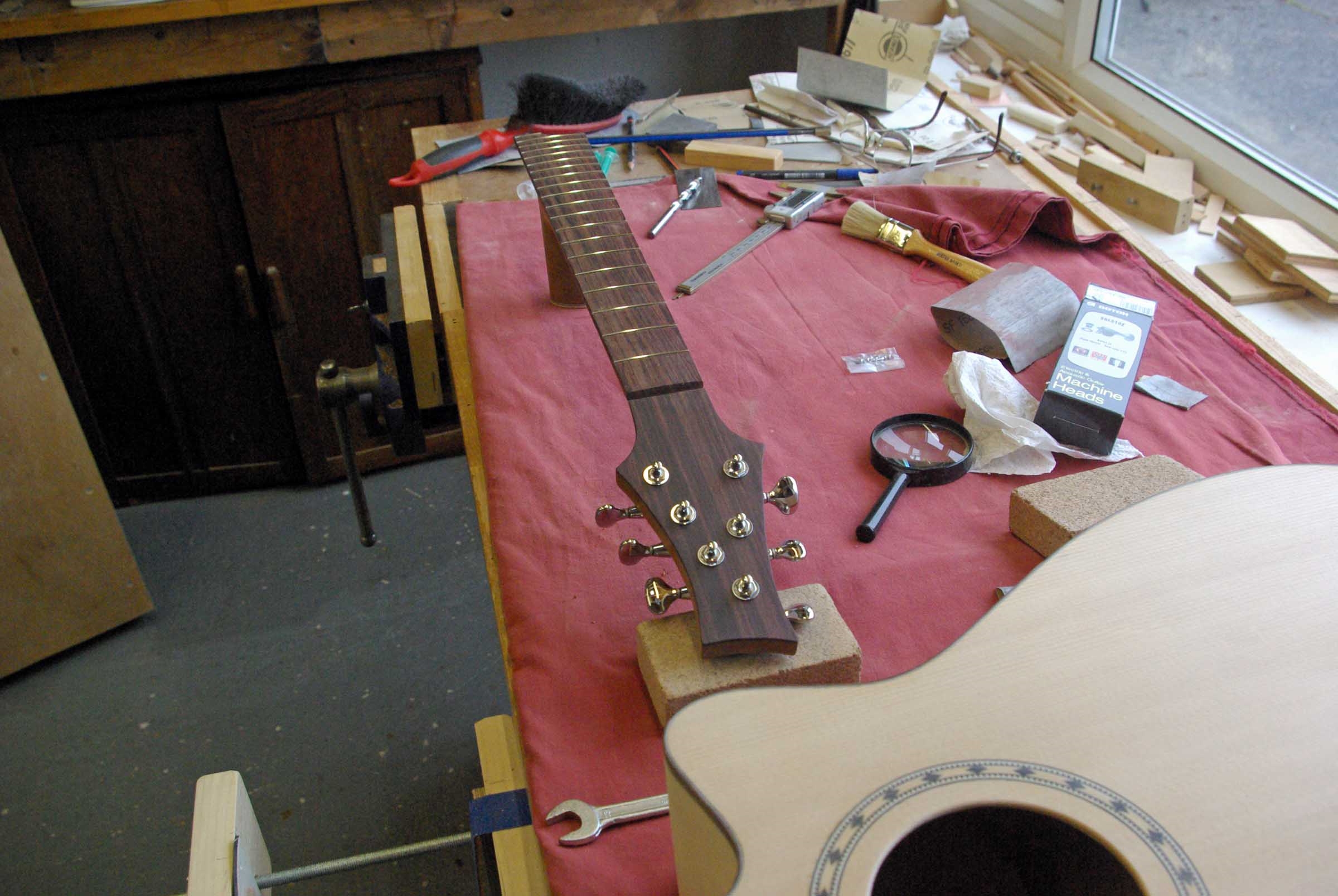

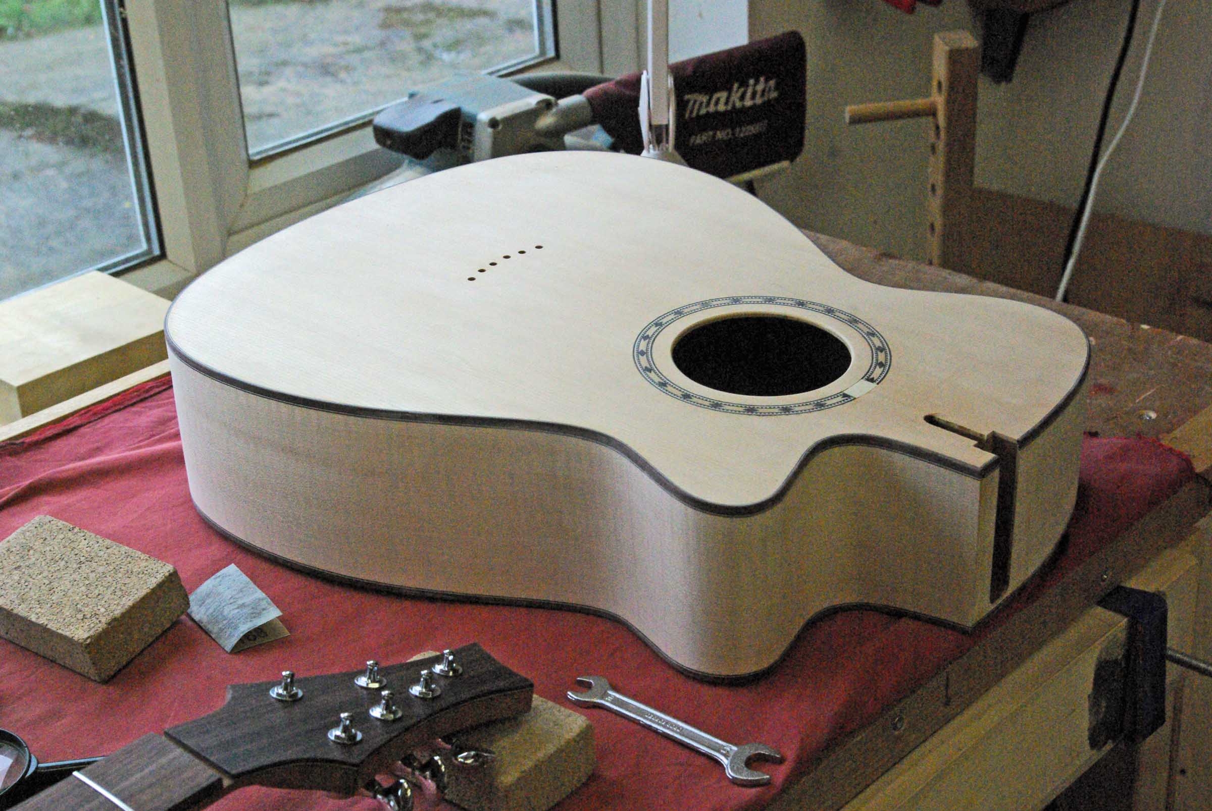

Just to show that we haven't all gone to sleep in the UK's Southwest, this is a build that was badly delayed over the summer due to gardening duties.
I have finally reached 320 grit in the great sanding, having found numerous 'topographical defects' as Trevor so nicely puts it. And this time I made sure the machine heads all fit before spraying lacquer rather than mess the headstock up after.

Thats so pretty Dave. I often think it is a shame these instruments need to be 'finished' with an oil, wax or lacquer when they look as pure as that.

Tall Dad while it's true the Spruce has been yellowed a bit by the lacquer, the ripple Maple looks grand under a finish. As an (amateur) player I do appreciate a pretty much bullet proof finish which is why I stick with nitro rather than try to learn French polishing.
I have finally got to fine sanding the lacquer on this one, having had to take off the whole finish from the top because of a lack of spraying skills. I'm a bit like Martin - damned good at removing finish. You need to know about taking lacquer off talk to me!
Just wish I was better at putting it on.
As an aside you will probably noticed that the cutaway side has a bit of cross ripple. Having had such a hard time getting the sharp cutaway shape bent I really didn't want to mess about trying to correct this. I decided it was a hand built guitar and this would be a feature! I had thinned that side down to 1.8 mm so really didn't have much room for manoeuvre. I have done some work on my bending rig so hope the next one will remain flat across the width.

Nice work Dave! The rosette looks very interesting and nicely done. Care to post a straight on shot of it?

Sorry Craig but it is a commercial one. (Obviously chosen with care!) I have been concentrating on my building skills so far saving the time on rosette making. I do intend to do the rosette for my next build which is going to be a cutaway classical.
I am on grit 2400 micromesh on this one so should be done with polishing tomorrow. Neck and bridge glueing, nut and saddle. Should be stringing up soon. Will put up some pics when done
