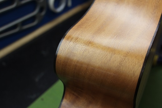

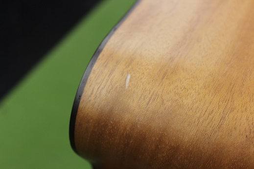

Having a nice diverse range of repairs coming through at the momment.
http://www.mirwa.com.au/HTS_Steam_Dent.html
Before
After
Before
After

Thanks, trying not to make them too long or complicated, hence the here's how we do it, with a follow up photo of the finish, on my earlier ones I was just showing the repairs and leaving the last shot without it being the finished product, simply a link.
Decided, may as well make the final photo a shot of the finished job with links to colour matching.
