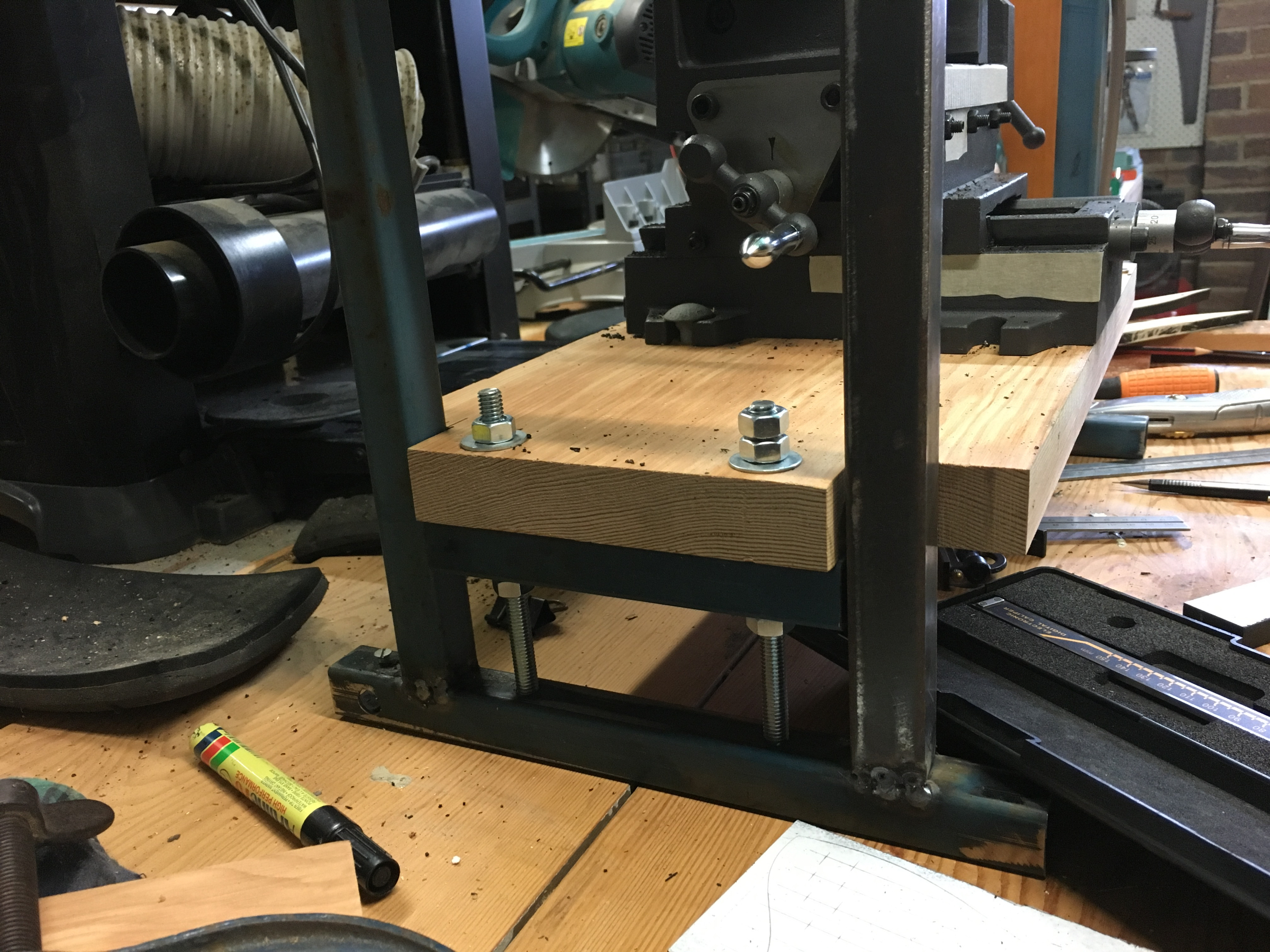

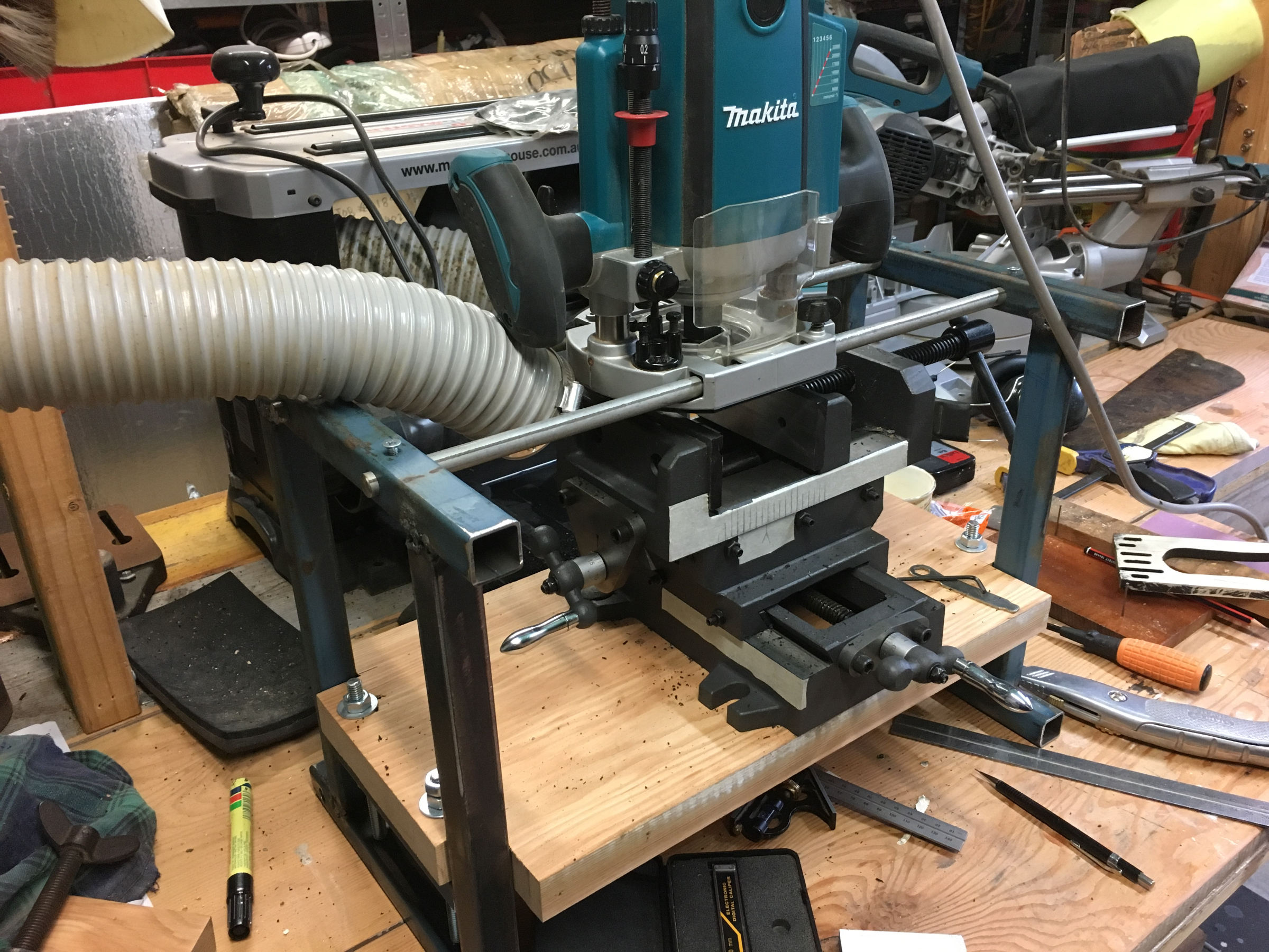

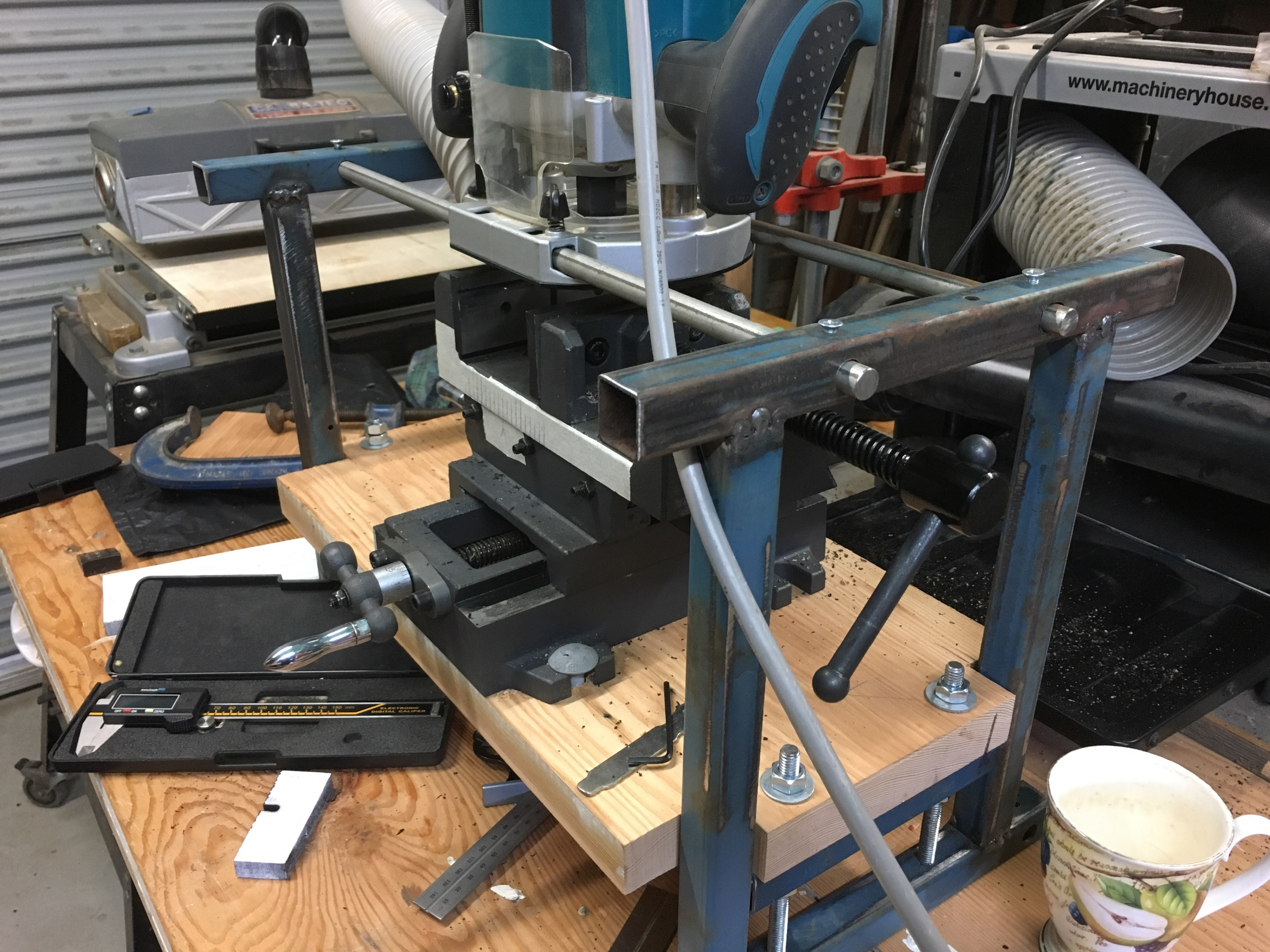

Recently I bought a two way drilling vice with an idea of using it to hold and guide small pieces of work while machining with a router, I came up with this assembly.

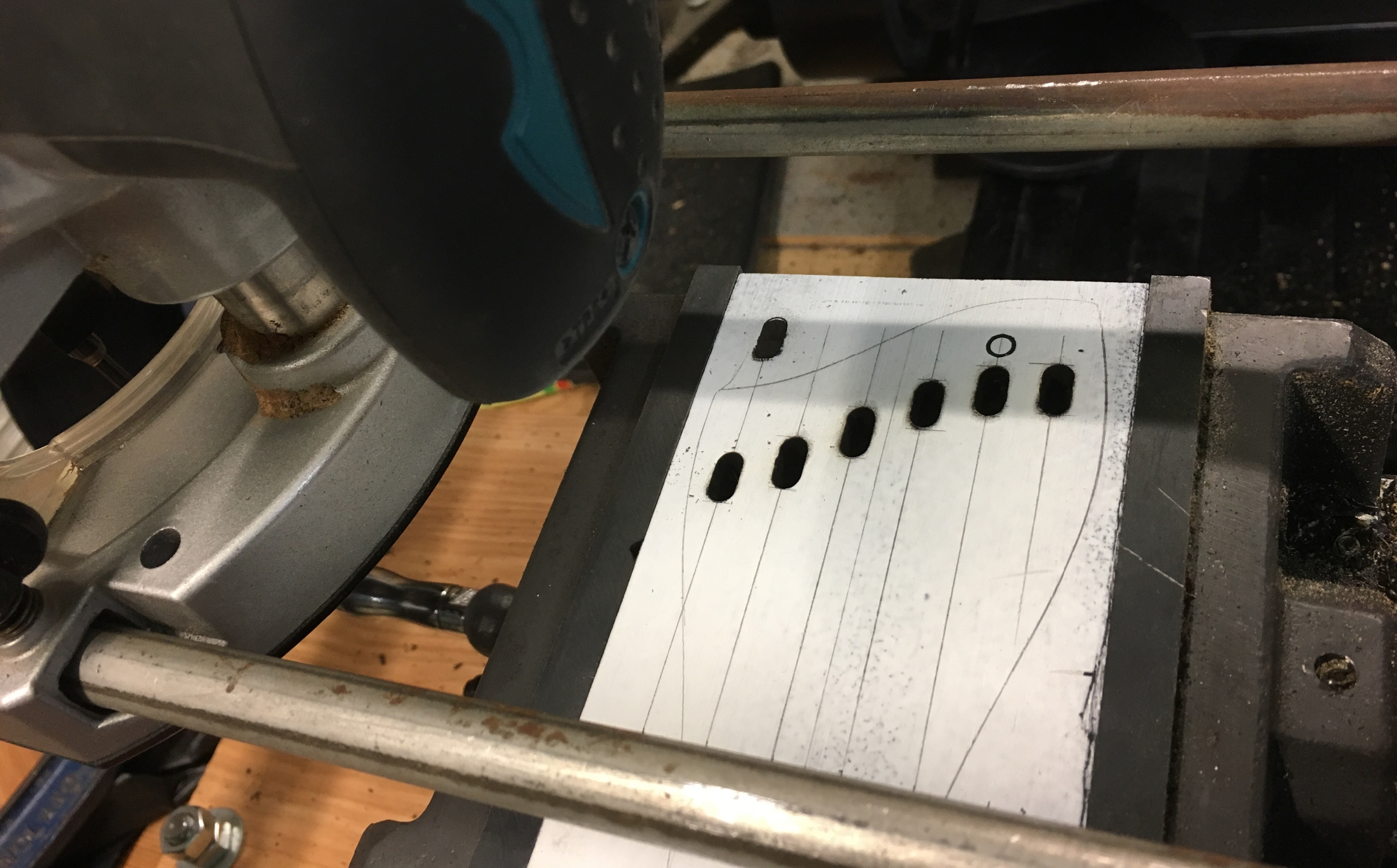

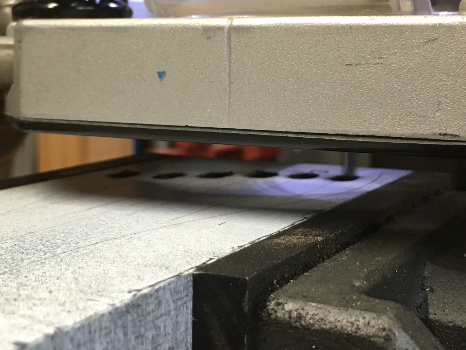

The vice sits on a adjustable height table beneath the suspended router. Only used it once to cut the slots in this tailpiece, seems to work pretty well.

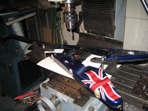

That's a cool Jig it's a hand cnc perfect for bridge slots,don't tell anyone but I use my drill mill for heaps of stuff :lol: rehashing oval bridge posts.
img 2flyin v mil.jpg (47.84 KiB) Viewed 7754 times

routout wrote:That's a cool Jig it's a hand cnc perfect for bridge slots,don't tell anyone but I use my drill mill for heaps of stuff :lol: rehashing oval bridge posts.
I didn't know Gibson had released a Cronulla Riot Flying Vee??

That was 2007 :D Post holes ripped out most accurate way I could think of,what Rod has done there is great lots of uses and gets you thinking of different Ideas :cl .
