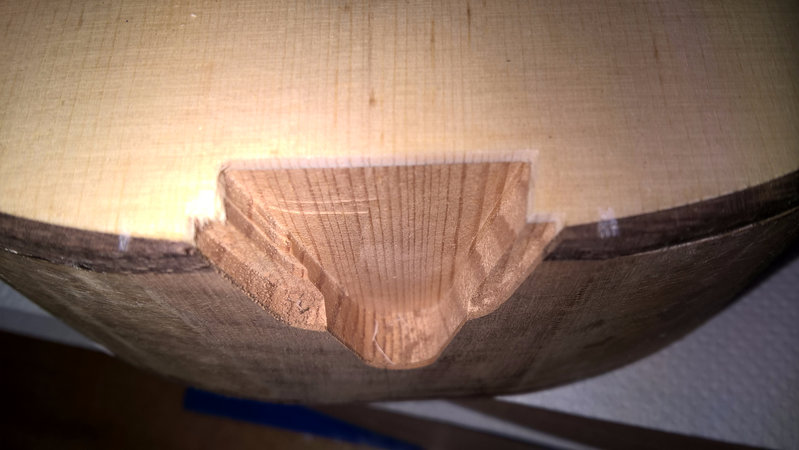

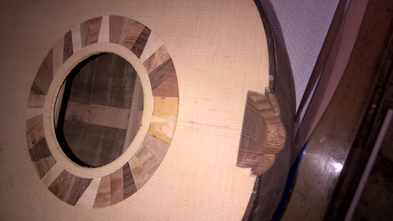

Hi Folks,
my young fellow is building his first tenor ukelele and as you can see the router elevation slipped during the cut.
(We did so many good practice cuts - why does that happen)?
The RH cheek is still quite full and holds quite well but the LH one has a lot of meat missing and the neck can lean away from that side fairly easily.
It would be great to rescue this after all his effort.
Any advice?

If the gaff area is going to be covered by the heel block/neck then I'd square up the gaff area, glue in a patch and then re-rout the mortise.
When I do my mortises I rout a small central area to final depth with a straight cutter and then work out towards the final outer limits of the cut with a dovetail cutter. The depth setting on the router is never changed.....I think this is usually the recommended method when running a dovetail cutter.

I always say, turn your mishaps into features when building.
It pushes our skills and makes us come up with new ideas that people go wow.
For me, I would possibly recut the mortise larger, and then cut a piece of wood to fit the hole that is diffent and then recut the mortise again, this will give a nice feature to the area.
