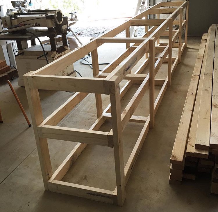

Post by demonx » Wed Sep 28, 2016 11:57 am
Longest of the workbenches is now framed off, having a coffee before I start another.
This one measures in at 4.8m long, 970mm high and 650mm deep. Made to fit between my heater and a doorway, with the height just right for me to work without bending over.

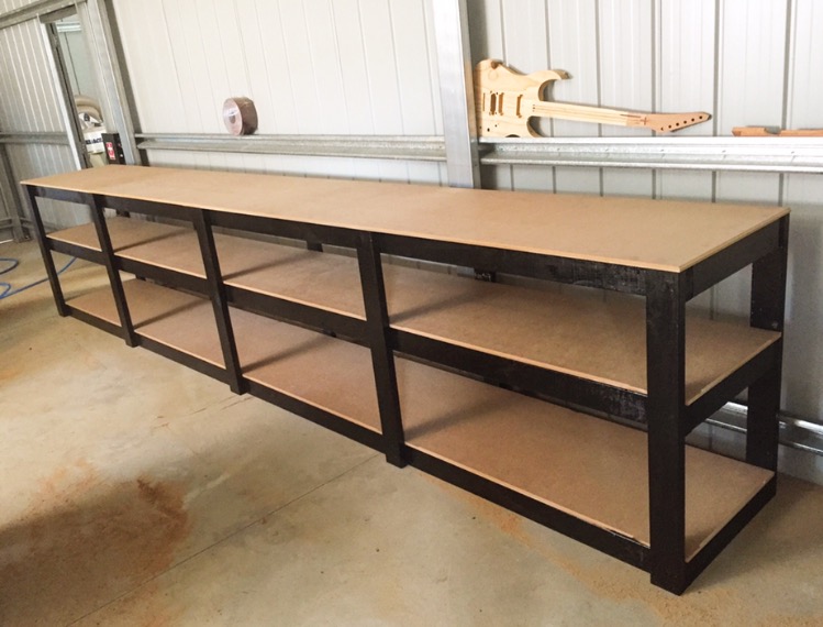

What are you going to use for benchtops?

Just MDF. It's cheap, easy to rip into size and if it ever gets wrecked it can be pulled off and it's cheap to replace.
In saying that though, I've got a "bash the crap out of it" bench that is used mostly for working on cars and metal work, jobs like smashing out bushes on car A frames, and the MDF on that bench as dirty as it is has never needed to be changed and it's lasted for about a decade, so it's good value.

Ive got MDF on my benchtops...when it gets worn I turn the tops over and get a second run out of the stuff. Some of the benches are dressed with a sacrificial masonite topping which gets ripped off if it gets tired.

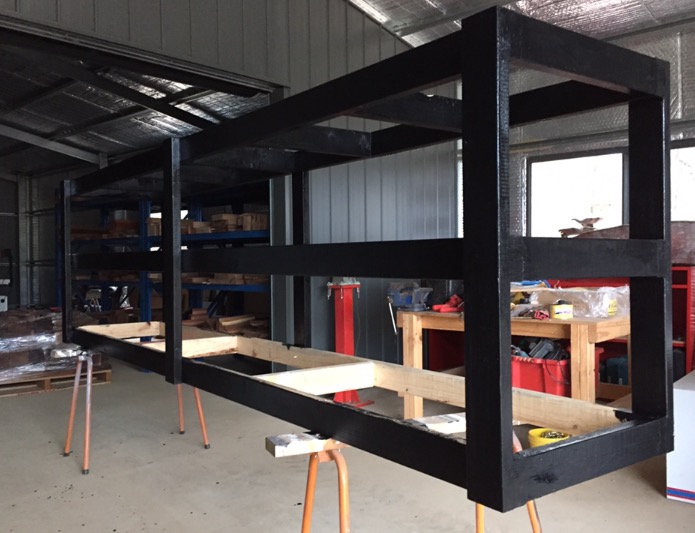

This is the second one I made today 3.3m long and will go behind the CNC to hold tooling and jigs etc,
I threw a thick coat of black on the two of them this arvo to take the pine look away. Unpainted parts won't be seen once shelving is in place.

Post by demonx » Thu Sep 29, 2016 12:48 pm
The big one is now shelved and bevelled, as is the CNC bench. Only four more to make now...
