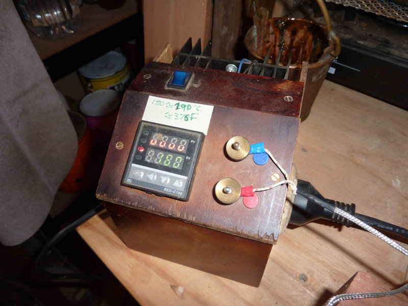

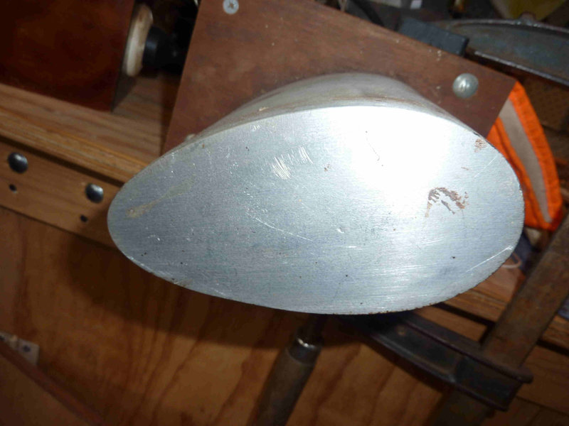

I made my bending iron this way. I shaped a piece of 19mm craftwood into what I would describe as a sail mast profile, having looked at various commercially available bending irons, their dimensions and shapes. The curves that I used were based on the curves that were on a Selmer style body shape, with the aim of being able to bend the cutaway on those instruments on the smaller radius end, because it is a rather tight bend. Therefore other bends of a larger radius would be no problem. I then used 2 wood screws to join another piece of craftwood in order to copy the shape I had made with a pattern following router bit, I repeated this several times to build up the height of the bending iron, and stacked them all up to make a form using long wood screws into the holes left from each copying process, so that they all lined up. Then I sent the form to a guy who was sand casting aluminium. I got the idea from a luthier who made his from old salvaged aluminuim alloy car engine pistons- he melted the aluminium himself, which I tried but gave up due to lack of a good heat source and crucible. So I located the foundry in the yellow pages, the gentleman did the job for $20. In the meantime I ordered a set of ceramic heating elements from eBay China which cost very little with free postage, along with a Chinese PID controller, an SSR (solid state relay) a heat sync for the SSR and a temperature sensor for the PID. Make sure the PID has a low DC output to drive the SSR which is used to switch the high current heating elements. I think I got the heat sinc for the SSR from Jaycar, along with some heat sync paste.I forget the correct name of the stuff. I had some hi temperature resistant glue (Pyrogrip in Aus). It is used for gluing the door seals on wood heaters. So... I made a box for the PID, the SSR and heat sync along with two terminals for the temp sensor to connect to and wired it all up with an on off switch and a power socket and lead. When the Aluminium bending "iron" turned up, I drilled a series of 10mm holes for the ceramic elements and glued them in with the high temp glue, along with a hole for the temp sensor, which I tapped in as it was threaded. I then cornered an electrician I ran into outside the local hardware and he gave me an offcut of "insulpanel" which is used to make custom fuse boards. This I used between the iron and the wooden base that I mounted it on. The Chinese PID/temp sensor combination gave an innacurate reading so I calibrated the PID using a surface thermometer. The whole rig cost less than a commercial one. Pix following after I take them! If you want to search this forum, there are posts about heat bending irons, pipes, methods. Whatever works for you. I have used a hot pipe as well. A word of warning, leather gloves and a leather apron are a good idea. I heat bent some sides one day, after a while concentrating, I had warmed right up and went to take my jacket off only to find that I had melted the nylon zipper at the front and fused the zipper permanently closed. So now it is a pullover!Cheers! Ross

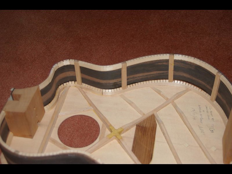

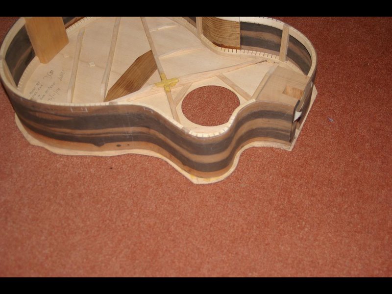

I've built 2 Macassar guitars and had no trouble bending with a heat blanket and mould. I don't think steam is the way to go, use an iron like the guys have suggested or a heat blanket. Wayne

wow ,thats look nice!56nortondomy wrote:I've built 2 Macassar guitars and had no trouble bending with a heat blanket and mould. I don't think steam is the way to go, use an iron like the guys have suggested or a heat blanket. Wayne
