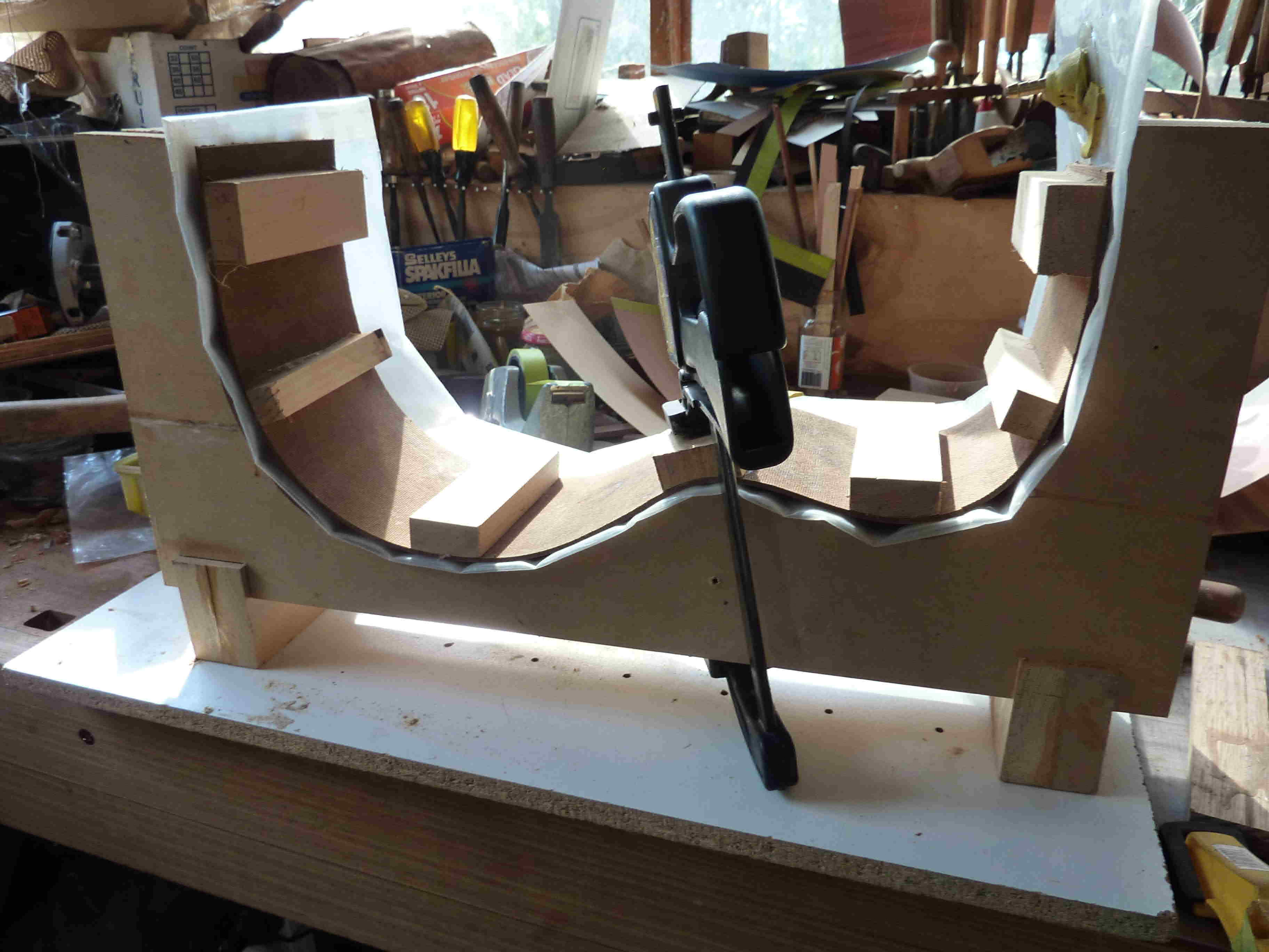

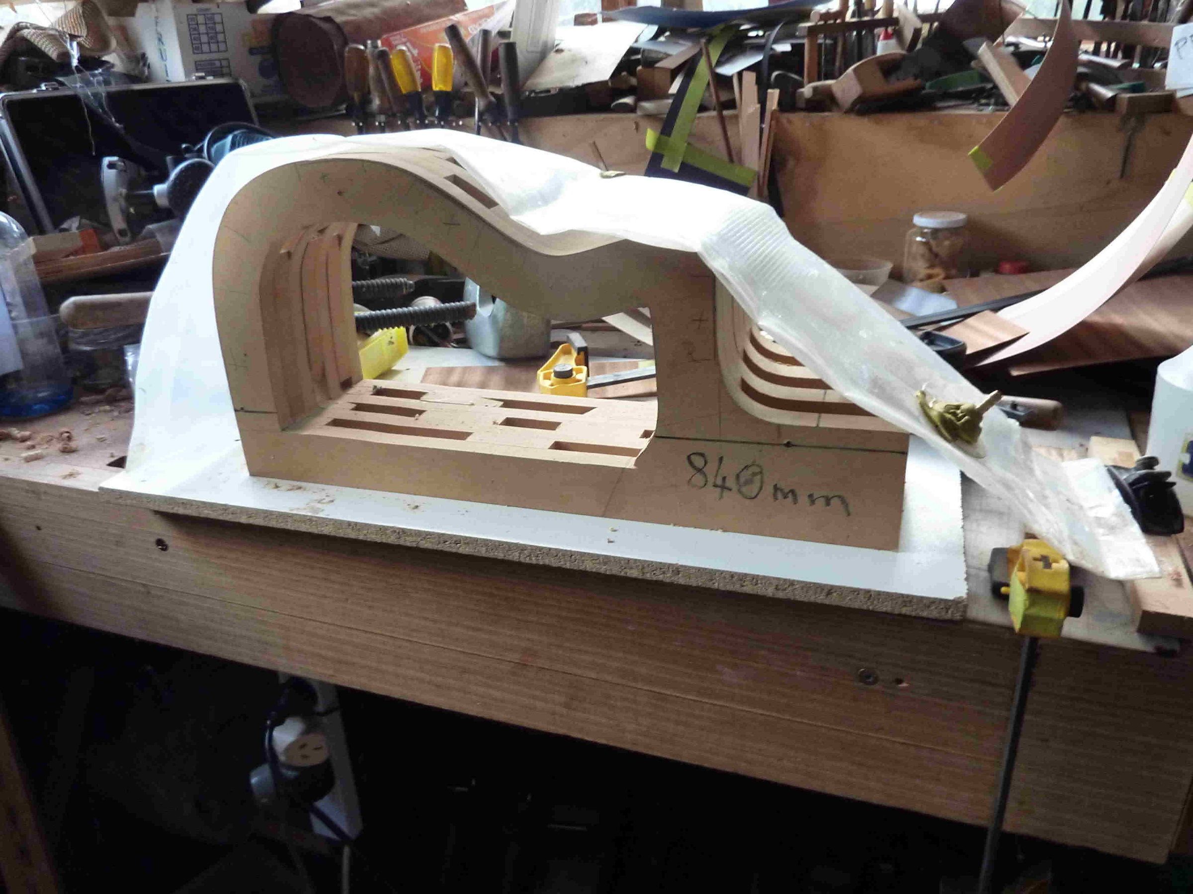

Thanks for the replies guys! I use an internal side mold as distinct from an external mold that the guitar is assembled in. I bag the laminates and create a vacuum then clamp the whole thing onto the mold. This is the way suggested in the Michael Collins book Building the Selmer Maccaferri Guitar. I know that some of the high end Selmer guitar builders use HHG as per the originals. I have an epoxy laminated back and a solid back (the epoxy one is for a selmer build, the solid for an OM). The solid back has more ping, less damping. The Selmeroid guitars have a certain sound...many high end Selmer builders and players have an opinion re solid vs laminated and most say that there is a difference in sound between the two. It seems to have a bit to do with sustain, which may or may not be a desirable attribute, depending on the player, and the guitars use. Gypsy rhythm players like a "dry" percussive sound-GY guitar afficianados refer to such properties as "reverb". Some like a solid back. Another advantage of a laminated back is that the arching can be similar to a carved back-this affects the tone and the projection, arched backs don't need braces...arched laminated backs, unbraced, can be very strong across the grain and very light which may affect the attack, particularly the projection of the bass, which in the Selmer "petite bouch" small soundhole pushes a column of fairly directional air out supporting the highs and mids coming off the top. That's what I have heard these guitars do. The ones where the bass isn't quite working tend to sound thin from a distance, the good ones have a rich "thump" behind each chord or note and support the mids giving them what I would describe as "body".

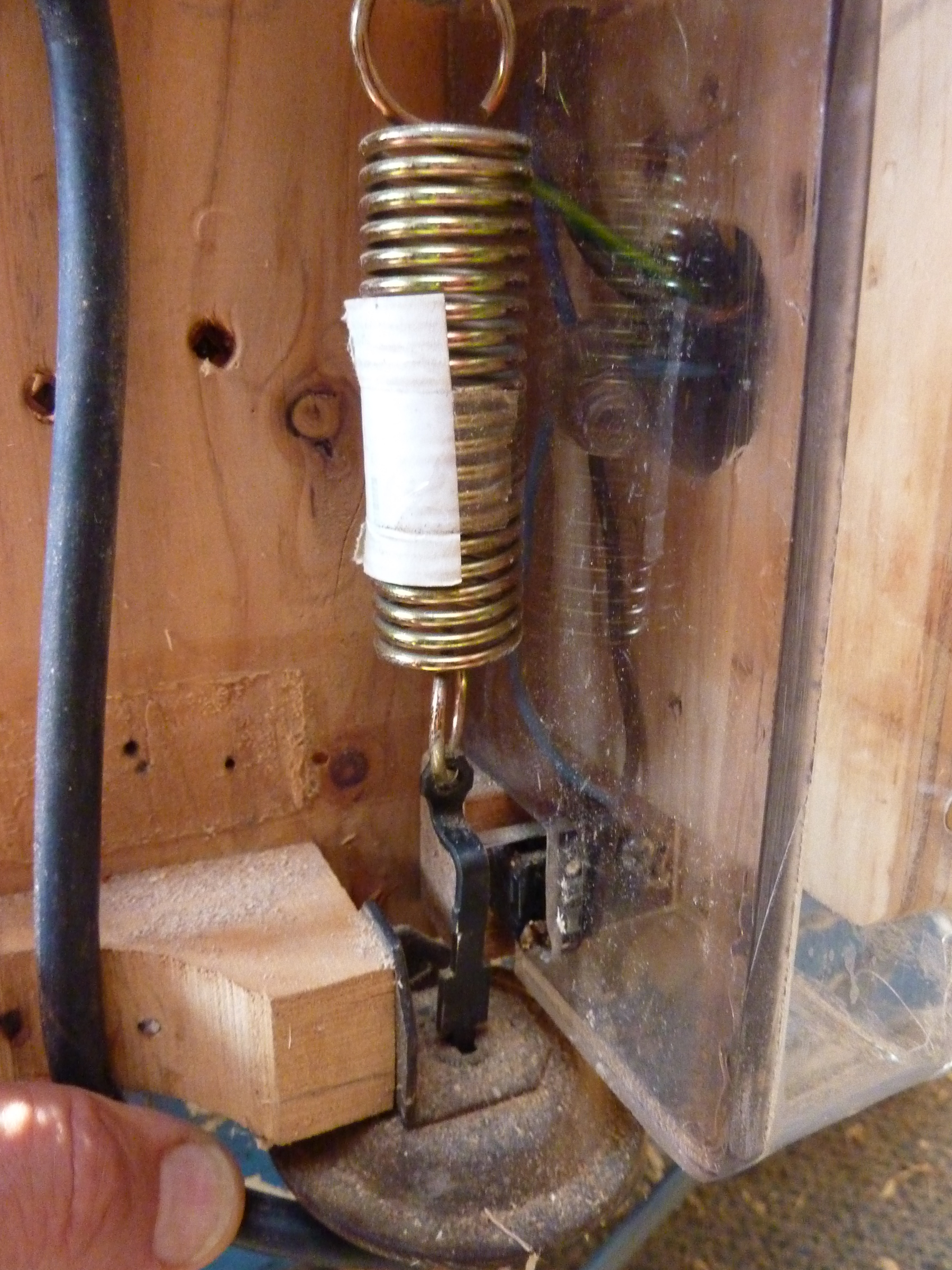

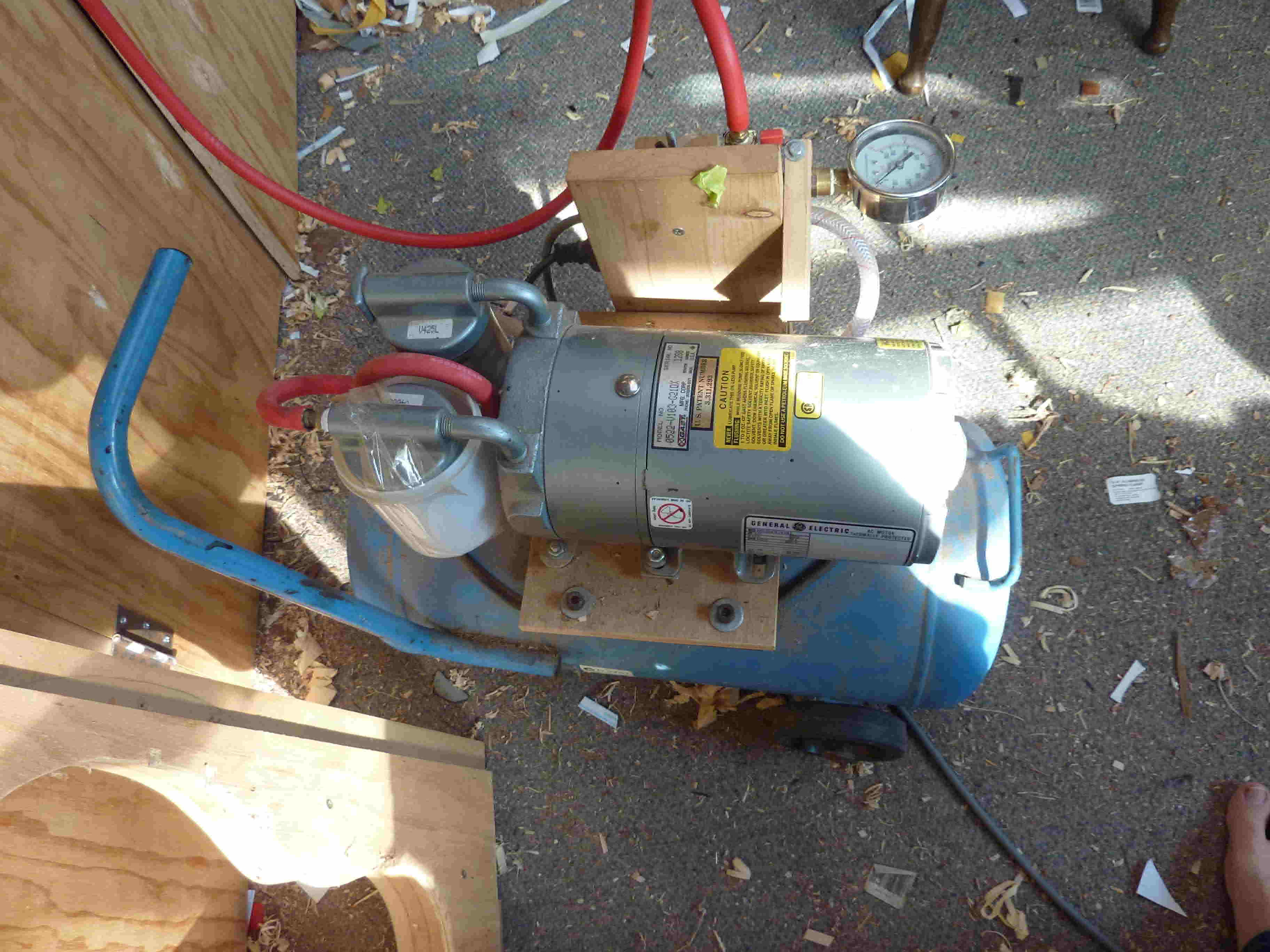

This post is for Gary-attached pix of my vacuum set up-messy shed in need of a cleanup yesterday! The pump was purchased for a bargain price off ebay, the rest of the pump scrounged from the local tip, eg the pressure cylinder was an broken Supercheap Auto compressor tank. I only paid for a non return valve, the pressure guage and a few fittings. The vac switch is an old Holden vacuum advance, a spring and wingnut to control switch operating pressure and a microswitch. Rotary vane pump not the best for the job, but as I said-CHEAP! New vacuum bag on the way, this was my first bag to see how the whole thing would work. The forms are made so that the laminates already under vacuum in the bag can be clamped into place while they dry. I have clamping cauls for both molds, but only one shown. Bagging prior to shaping in the mold is the best way IMO. For some laminates I pre bend the cutaway side. The grain runs logitudinally on the outside and inside veneers, the core material is cross grain. The core pieces are cut to size then shooting planed in a clamp made from two lengths of timber. They are then joined using superglue and masking tape to clamp the join. So far I have used 0.6mm maple veneer outside, pearwood inside and a 1.2mm mahogany core. The original Selmers had three thicker veneers from what I have read, but these thick veneers are hard to come by these days. The reason I don't use the guitar mold for the job is that it isn't wide enough to support the full width of the sides. My backs are now laminated in a similar way, but within the bag I lay the laminates on a carved back form which resembles an archtop back carve. I then have a little hassle mating the braces accurately to the actual back shape but seem to manage. If I change the back mold in the future I will make it a concave form, which could also be used to sand and fit the braces more accurately and faster. One of the advantages of veneers is that the visual possibilities are not so limited by structural requirements-I have seen laminated burl and other attractive backs. Good gypsy jazz guitars are noted for their extremely light weight which has a lot to do with the back and side veneer construction and the fact that the necks are reinforced with no truss rod. CF is a good material for this these days, the originals used duralumin.
Ross
Ross

Hi Ross,
Thanks for the photos, looks like a good method, similar to the method some builders use to laminate arched doorways in situ.
It would probably be best to use the 207 hardener for laminating to avoid the bleed through resin blushing / turning white over time as is likely with the other hardeners, same as with grain filling (learnt that the hard way). This is the reason I am using the bote cote epoxy as it is intended for clear coating. The bote coat also gives a longer work time and the manufacturers claim it contains less harmful / allergy causing chemicals. It is certainly more pleasant to work with. The thixotropic epoxies have fillers added, you can do this yourself to any desired consistency with a filler like the west microfiber blend.
