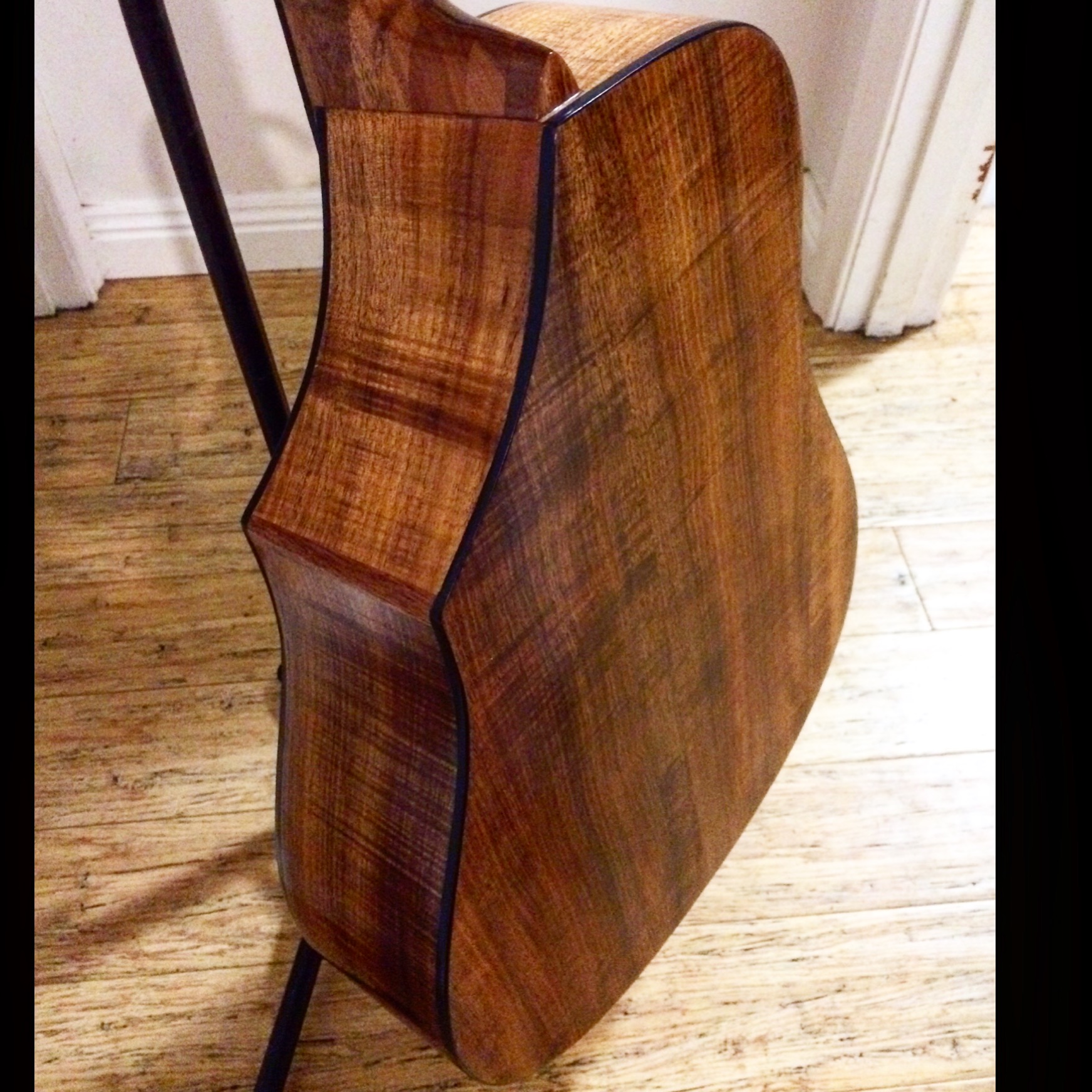

You can cap the tip, which is what you'll see on a lot of guitars. Heres one I did in blackwood with a blackwood cap on the tip:
About the split, if it was with the grain, easy to hide, the way it's torn down, much more difficult. If you look at my cutaway in this pic, it actually split, then I repaired it and the damn repair split. I repaired it with superglue and clamps and did the old glue and sand trick to hide the break. It's barely visible as the grain hides the repair.
