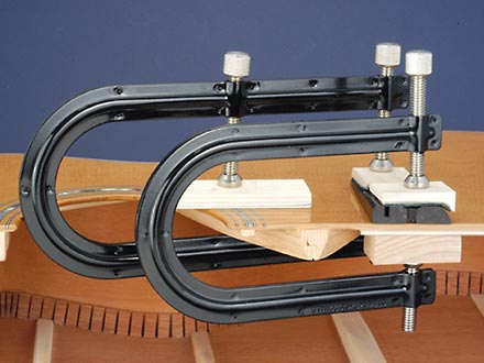

Clamps for bridge glue up......I generally use long reach clamps specifically designed for bridge work. A caul for clamping up a classical bridge is usually custom made for each instrument as brace, bridge dimensions are variable. Its normal to make up a caul when the top is off the guitar but for a repair job one trick is to put a bright LED light inside the guitar and then trace brace and bridge patch (if present)layout onto a piece of paper laid over the top. From this drawing a caul can be made up. What sort of glue do you plan to use for the bridge glue up?

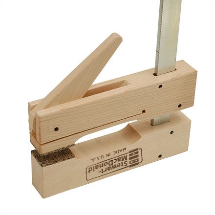

Titebond should do the job, Titebond I the preferred of the three variants of this glue.
The clamps I use came from Stewmac but if you're on a tight budget you may have to go for a more conventional clamp.....throat size is the critical factor. Long reach Cam clamps would be the preferred alternative but again theyre usually not a common item in a hardware store.
Spykerwolf
Posts: 8
Joined: Wed May 20, 2015 3:34 pm
Re: NZ: Beginner hobbyist, couple of questions
Post by Spykerwolf » Mon Feb 29, 2016 7:06 pm
Thanks Martin. I might just have to invest in the clamps now, and then atleast I know it's 1 less tool to get later XD
Will
Posts: 10873
Post by kiwigeo » Mon Feb 29, 2016 7:23 pm
Spykerwolf wrote:Thanks Martin. I might just have to invest in the clamps now, and then atleast I know it's 1 less tool to get later XD
If things are tight you can make your own cam clamps.....viewtopic.php?t=6812
